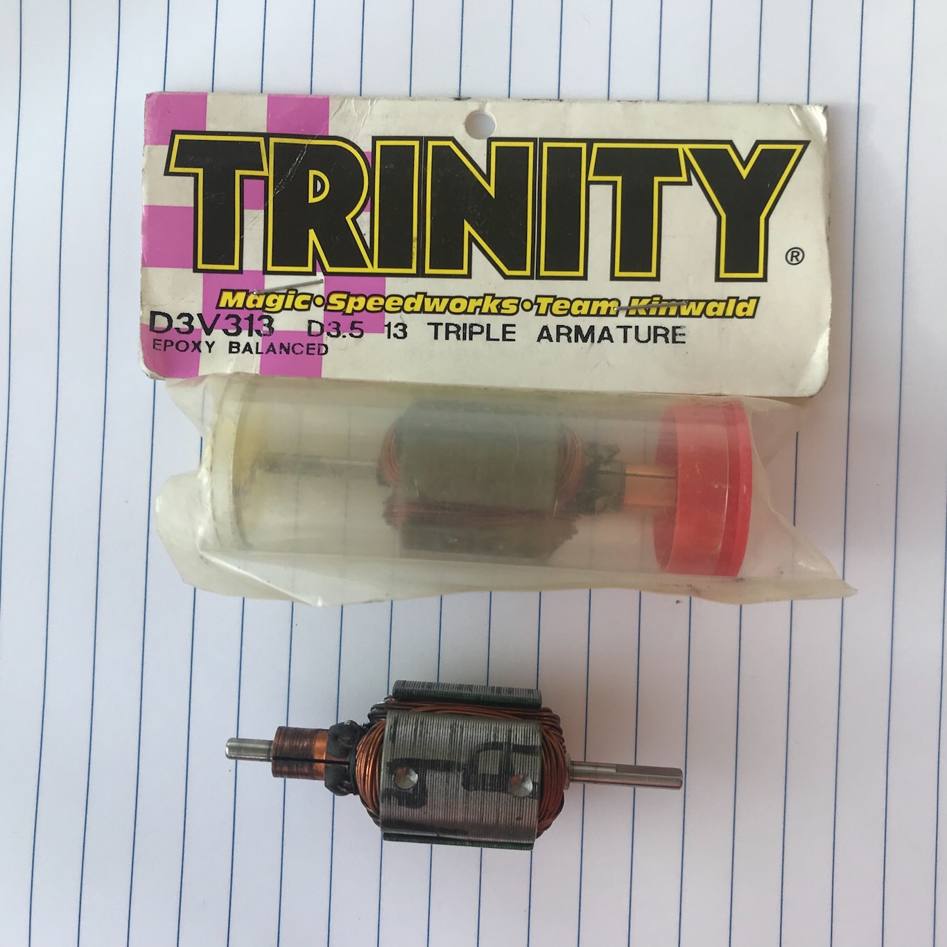

My question is if this Trinity armature could be used as a spare to restore one of the Reedy motors? I haven’t opened the packaging, but it looks identical in dimensions to the Reedy.
I understand the performance would change since the Reedys are 16 turn triples, whereas the Trinity is a 13 turn triple.
Is there some characteristic I’m not aware of which would impede swapping it in and having it work.
Here they are side by side:

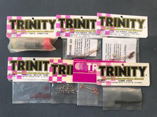

And here are a bunch of other spares which were also in the bin.

Yes you can swap armatures around.
Just make sure you shim leaving a correct amount of end float, that's really the same on brushless motors also.

Thanks. Good news then. I had to google end float. Something new to learn every day. It seems to be used interchangeably with “end play”. I found reference values of 0.25 to 0.5mm (0.010-0.020").
Thanks again. I’ll be checking my used Reedys, and keeping this in mind when rebuilding.
