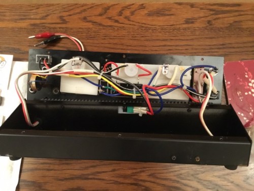

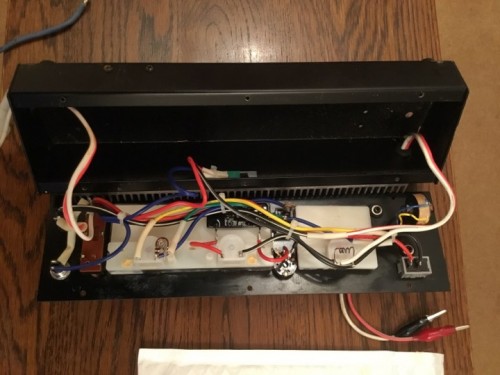

This is for the original black Dresser.
I have been asked about the wiring on these before too, so here is mine opened up for reference.
