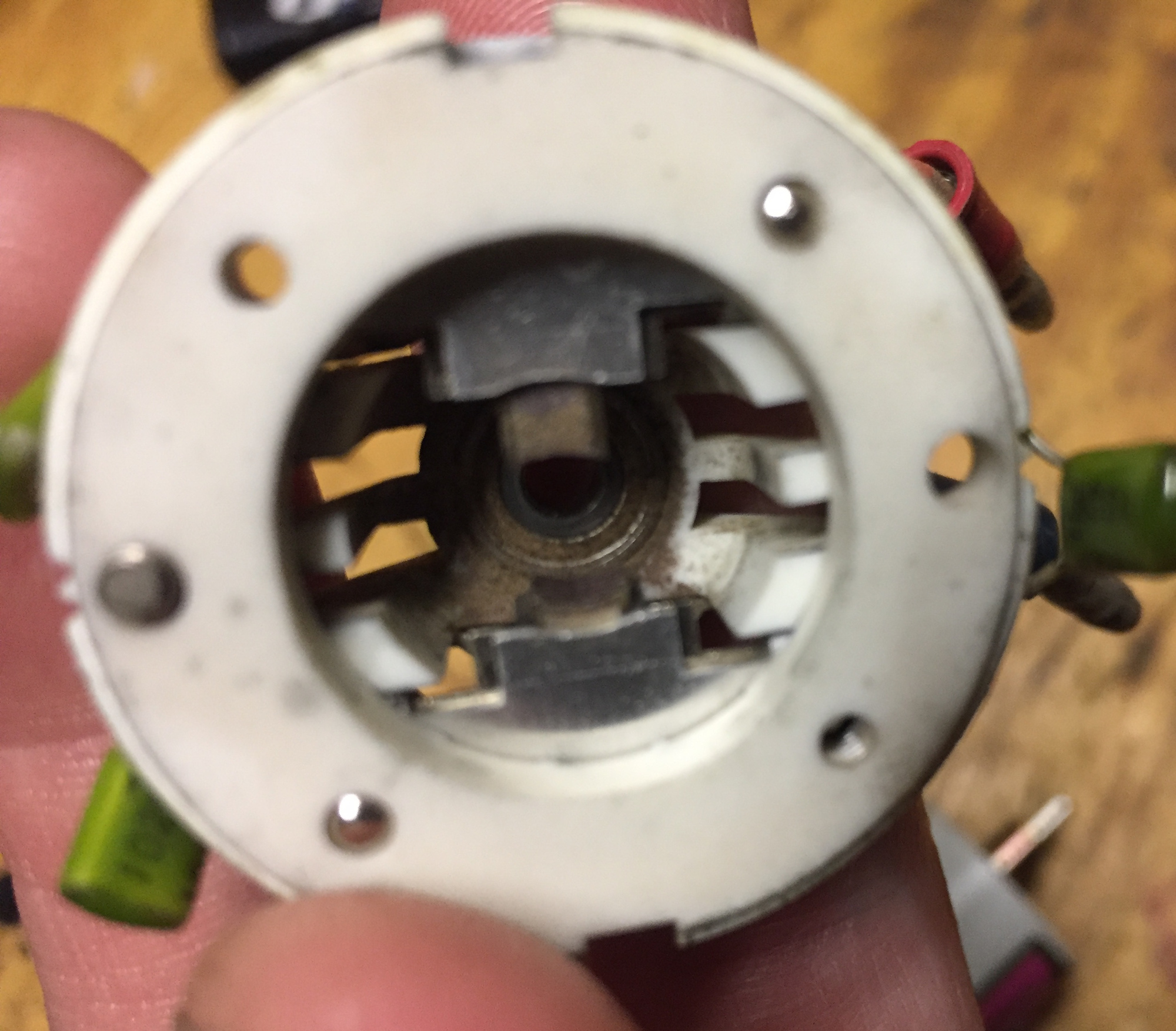

Hi all, I decided to go brushless with my RC10 build, which means the motors and ESC that came with my RC10 are suddenly available for hopping up my old-school Bandit basher. There are two motors, I've tried both in the Bandit with a Novak 610, and both are acting wonky. The one I really want to get going is a Diamond 12t. It really woke up the old Bandit, but after a few minutes, it stopped working. I took it partially apart tonight for inspection, stuck it back together, and it started working again. I'm assuming the problem will return, since I didn't really fix anything.
The other motor I tried is a Reedy Mr Outlaw. It got to where it would slow down and stop, but for a while it would start working again if I just gave the back of the motor a light tap. It's like something is just not making a good connection, on both motors.
I hadn't oiled the Diamond, but did put some oil on the Outlaw. Hopefully I'm just making a noob mistake....these are the first rebuildable brushed motors I've worked with.

From the last pic one brush looks to be at a different depth than the other.
Were the springs still on the brushes?
Do the brushes slide easily in the brush hoods?

Good catch! I noticed that but assumed the brushes would be under enough pressure once reassembled. That brush was almost stuck in the hood, very dry and a bit dirty. I cleaned and lubed both brushes and they move freely now, they spring in until they hit each other.
Now my problem is how to hold the brushes back so I can reassemble.
What's the trick?
Matt

No real trick, just release the spring, pull the brushes back and reassemble. Then reinstall the spring
The only thing to consider is that the brushes should be placed back in the hoods the same way they came out.
Brushes wear more on the leading enge than on the trailing edge.
If put in backwards they will tend to dig into the comm. They will spark and contact will be quite bad.

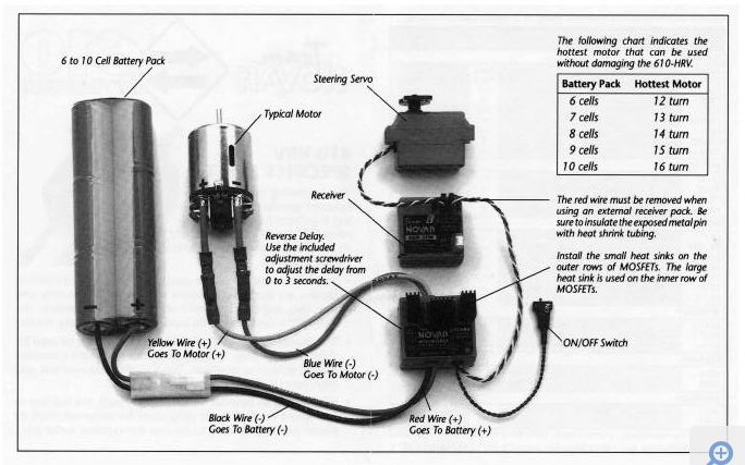

Well the motor runs GREAT! No problems with it at all. Except the Novak 610 seems to be a little overwhelmed, it overheats after a few minutes....guess I need to put a fan on it!

A fan is not a bad idea. You might also want to go a tooth or two less on the pinion or up a few on the spur.
A little slower on the top speed but a little easier on the ESC.
