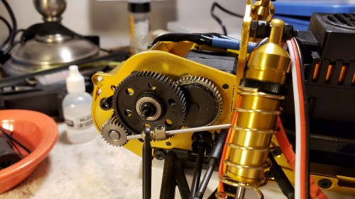

OK, last steps and now the car is DONE! Electronics. This step had to wait because I went on the advice of XLR8 and got the GoolRC motor/ESC combo. The problem was that the motor shaft is 5mm thick, so I had to order a new pinion gear with a 5mm bore.
But that guy's in now, and meshed perfectly...

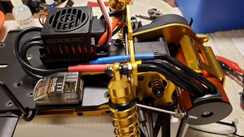

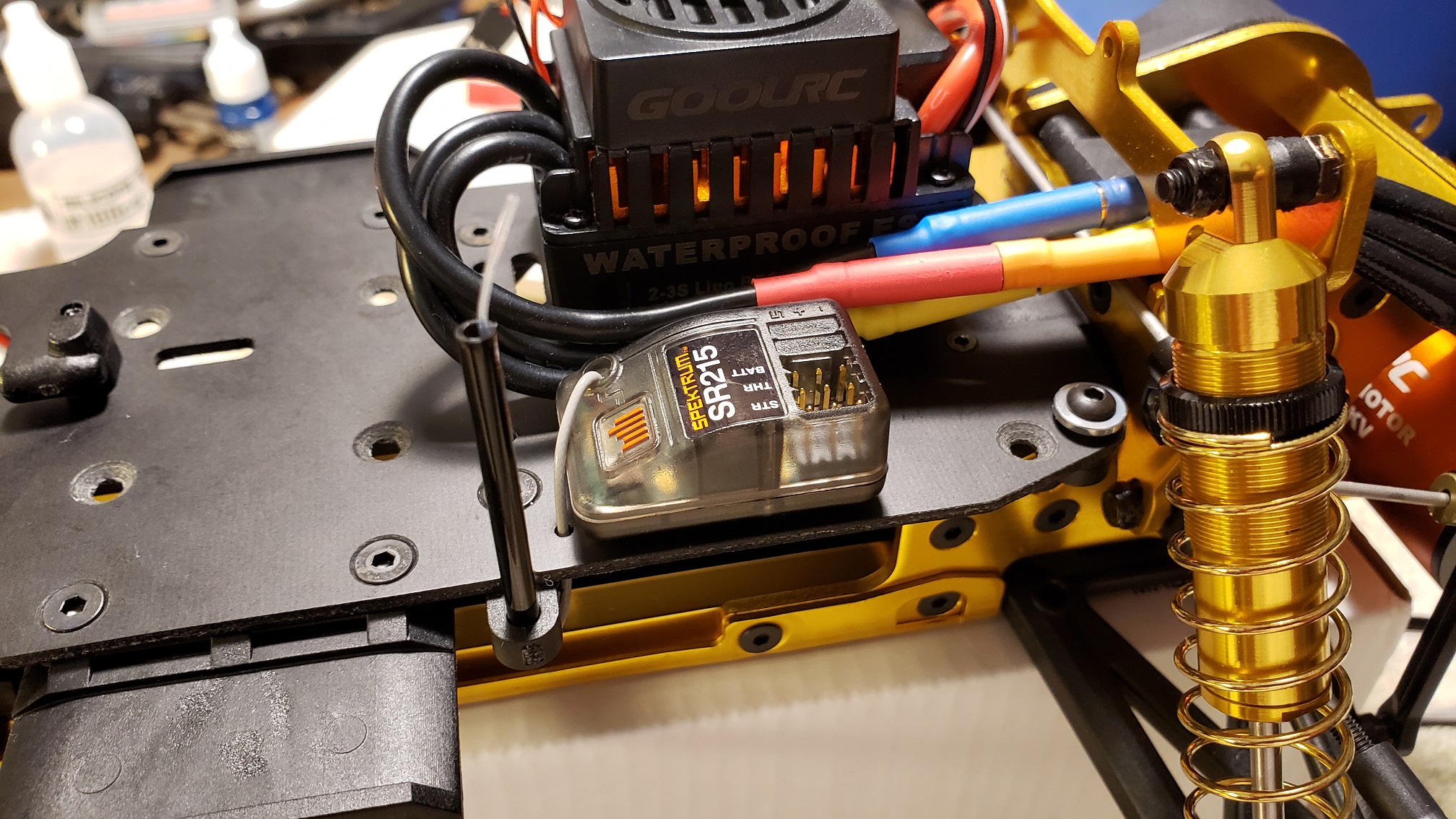

After that the receiver went in near the hole for the antenna tube
Then the ESC taped down so that the motor wires are nice and neat.

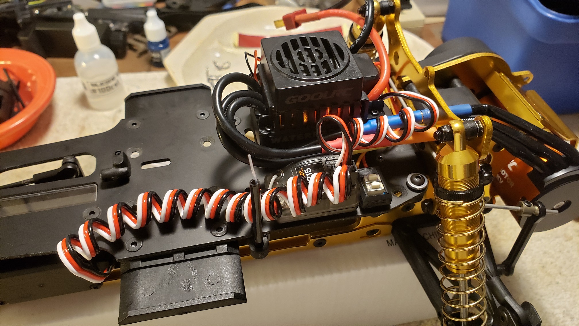

And, lastly the receiver wires from the servo and ESC, and mounting the power switch. VOILA! Complete!
