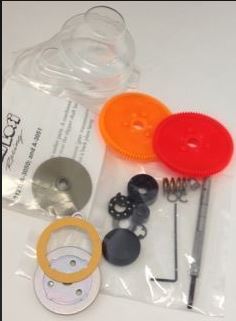

is this the correct slipper for a JrxPro? Looks like it’s missing some parts to me. Thoughts or help appreciated.

It looks like you may have the correct trans input shaft for a slipper but no slipper???
My JRX Pro did not come with a slipper but I added one.

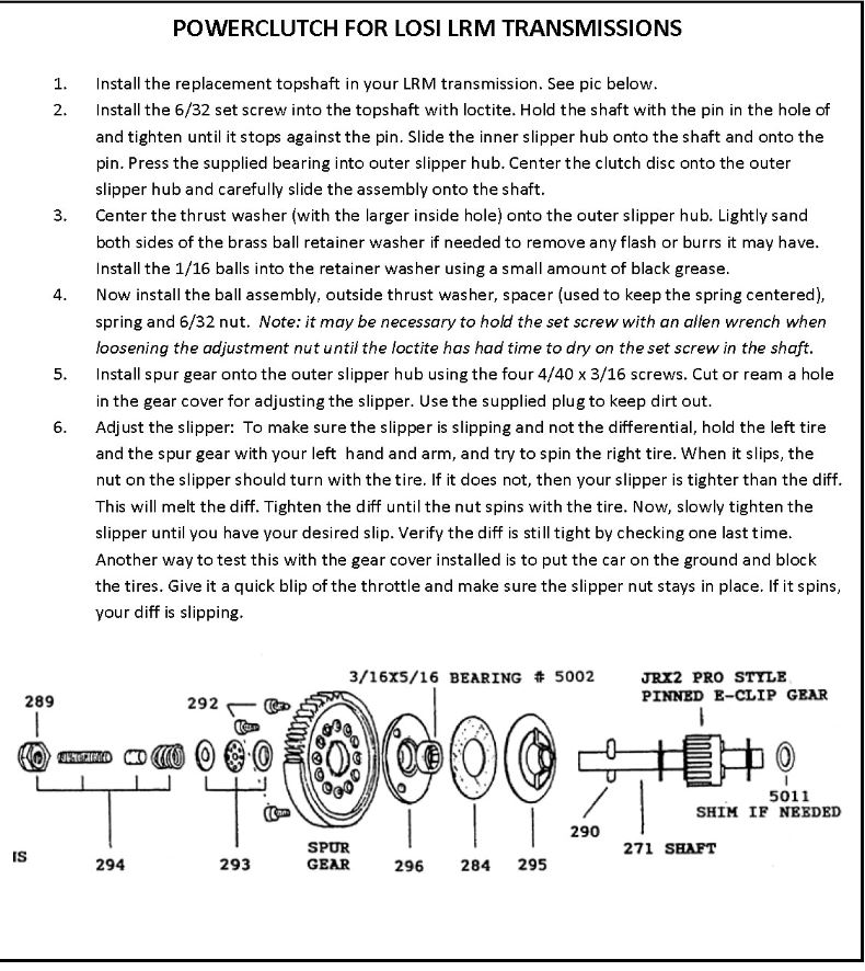

For a slipper kit this should be correct - losi a3110
http://vintagelosi.com/Instructions_files/Friction_Slipper_A3110.pdf
If your setup doesn't match or is missing parts Dan @ Sabula Tech is a forum sponsor and an excellent source for vintage Losi parts.
You may even find a solution @ Factoryworks / A & L on Ebay. Or better yet, GoMachV here on the forum. Jeff is also great to do business with.
The A & L Powerclutch is on the top and the original Losi is below.
Chuck
