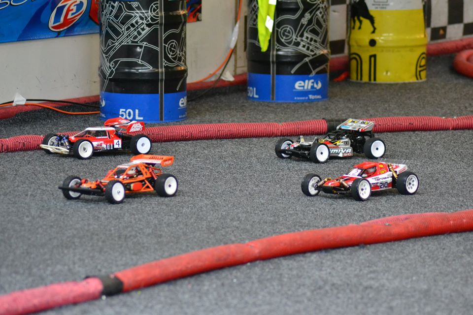

The race debut is done, and it lasted less then a lap on the open practice on Friday… The right rear arm snapped after a dodgy landing after a low speed jump.
I had a spare one, so replaced it. In the mean time I was practicing with my vintage Optima/Scorpion based 2WD. When I was ready replacing the arm, I decided not to run my 4WD “Mad Dog”. But when Sunday 4WD day come, the urge to run it got the best of me… So, I decided to race and only to wheel it over all the jumps. It felt the right ting to do sins I had traveled 750 miles (1200km) to the race. Actually, I didn’t qualify last, I had one guy behind me.
Losing 2-3 seconds every lap won’t take you to the A-main, but it allowed you to participate in the sponsor prices lottery.
I have to talk with “Dadio” about reinforced 3D printed rear arms, I want to race this car
