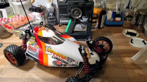

And back on topic, a few pics of the soon-to-be completed car.

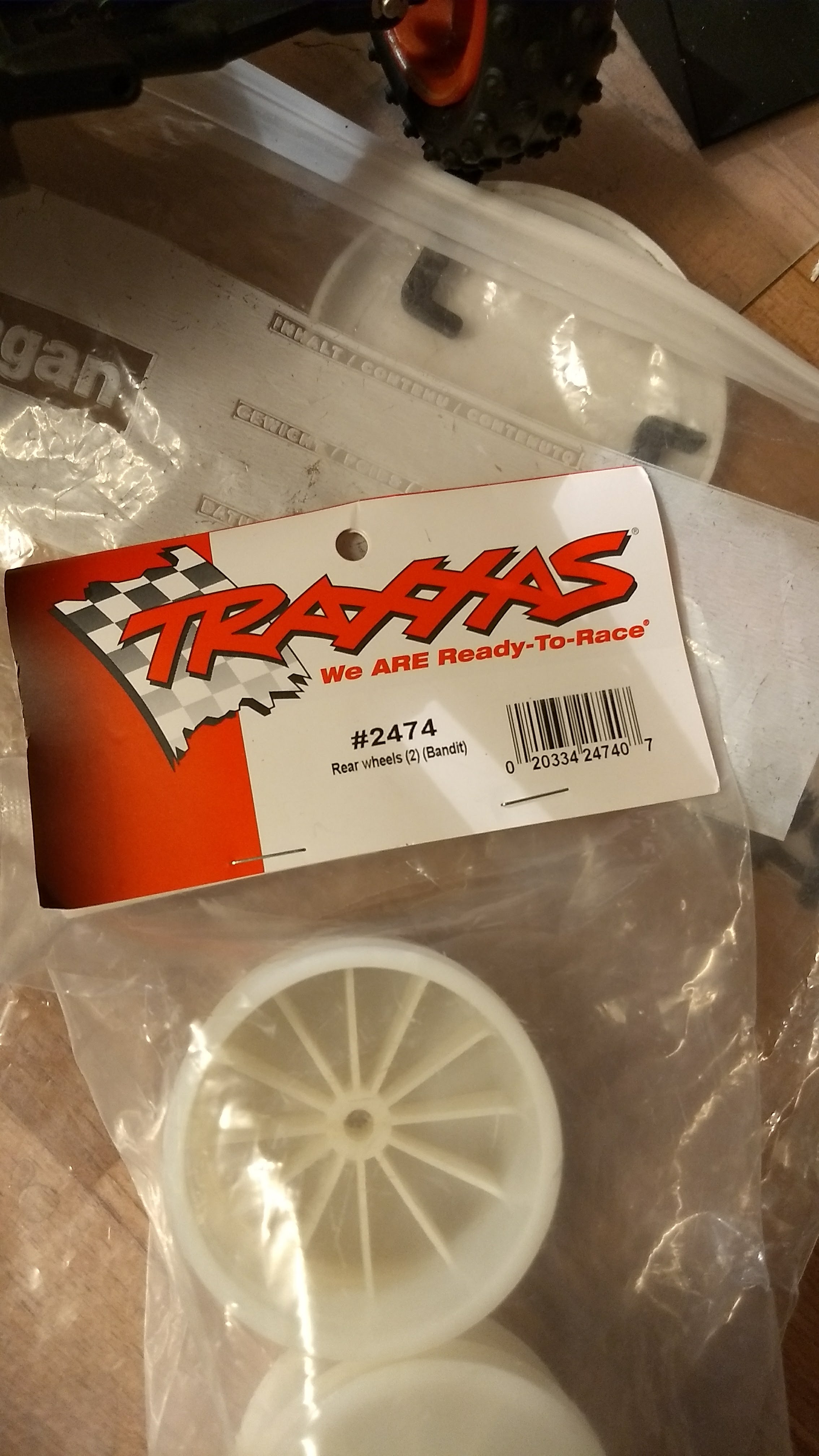

For now I have some already bored out Losi XXX rims in the acetone bath, but these seem to fit perfectly - unfortunately I am experiencing the "NIB" syndrom and I'm struggling to tear the bag opened as these are long disc'ed and the only ones I can find in the US would set me back $35-ish per pair ($5 for the wheels, $30 for shipping )

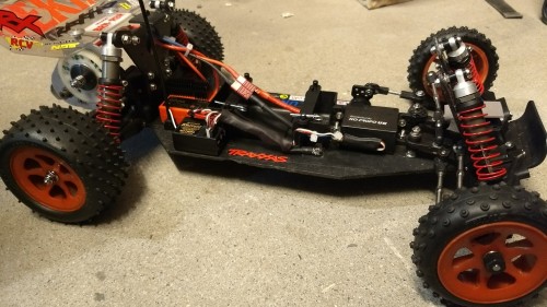

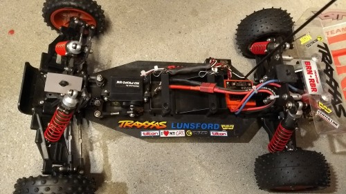

The car looks like this now:

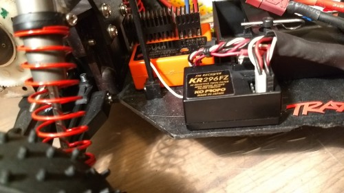

I have tried to tidy up the wires as they are all over the place, and there's the extra KO servo fet wire that doesn't really help either. Shrink wrap to the rescue!
Premium antenna mount - this is a cut servo mount from a late TLT-1... found it as scrap on the garage floor, the other half was used as a battery stop on my Xray T4 '17... a bit of body reaming, a drop of CA to make sure the antenna tube doesn't go away, and voila, (free) race material
Now I'm just waiting on AE bleeder caps and making up my mind about wheels/tires

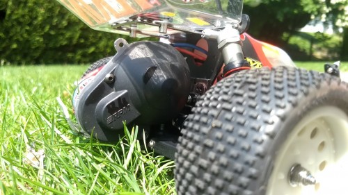

A couple of months after - back from the Savoyarde Vintage Meet this weekend:
It ran ! And it ran pretty well
In the meantime the car got a B4 gear cover which requires a smaller spur for a 2.6:1 IR (which is important as you will see further)

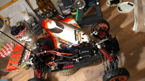

The good news is, I still have it and I still love this car dearly. And I still run it once in a while, last time just a few days ago. Just wanted to share a couple of pics of the car, dirty like it should be
As you can see, I overgeared it slightly
As it wasn't the first time it happened, It was time for a change to a bigger spur... so I can actually use a smaller pinion that grabs it. I realized when trying to insert them in the new one that the slipper pucks were actually seriously flattened... So I had to ream out the spur holes a bit. This design really sucks, but given how rarely I run it, I won't invest in an STRC shaft and AE V2 slipper parts I think.
But anyway - the car lives on and keeps running. It's very interesting to see it run outdoors, on unpreparred terrain... it really seems to "float" above the ground.
