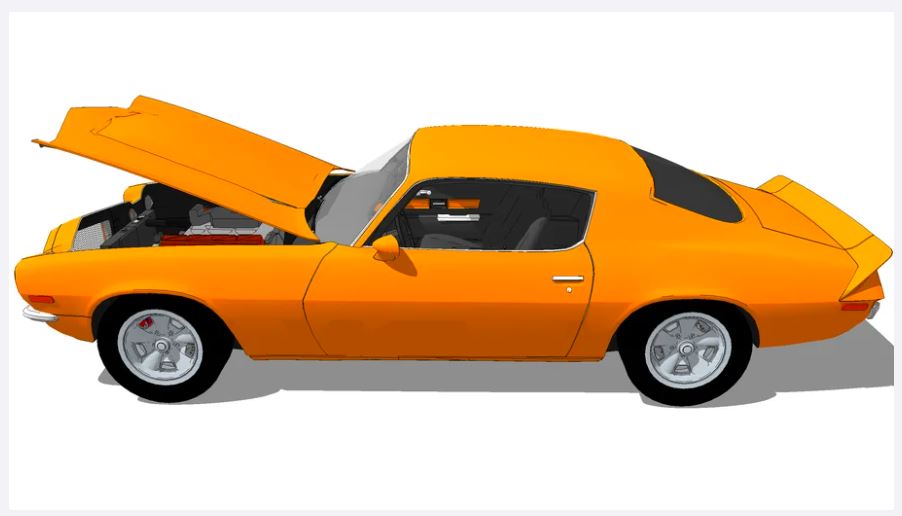

The 3D Warehouse contains many thousands of models like this Camero that are free to download.
https://3dwarehouse.sketchup.com/model/954e91323b045c38159f339e63a68ac1/1972-Chevy-Camaro
Would it be possible (or practical) to break this model into individual panels (hood, fender, door, roof, quarter panel, deck lid, etc.), add some connecting and support structure similar to the real car's panels, print the panels and fasten them together to make this body? I understand there would be a lot of post-printing work to fill and smooth the surfaces. What sort of problems do you think I would encounter if I were to try this?

WOW that's a bit of an essay question but I'll give it a go .
Firstly there are many types of 3d file you can download , many are basically for on screen graphics only because they comprise of surfaces without any depth , this works on screen but if you want to print them you need to be able to make them into a solid 3d part so you either need to look for an STL file or other 3d file or export the file to a programme like MeshMixer where you can try to convert them to a solid form and scale it correctly , scale is a big factor because virtual on screen objects often don't have any kind of real world measurement . Once you have that part done then once again in MeshMixer you can cut up the model into the discreet parts , after that you have to decide weather you want to rebuild it in a regular modelling manner or draw up a design for a chassis of some sort .
Although i have an intellectual understanding of how to do it its not something I've ever done and you might get half way and decide you might be better using all the stuff you just had to learn to just design one from scratch in the way you wanted it rather than trying to modify someone else's model in a way they never planned for , I've been looking for a Metro 6R4 rally car model file but i can't find one , plenty of files for they that are from rally games but none that are readily 3d printable .
What might have some legs is to 3d scan a full size car and work from that , it should be relatively easy to do that way , way easier than converting a graphics file to a 3d file .
I just tried to download and open the file , nothing i have likes it at all !

Although it appears like a dimension-less graphics image, the example Camero model is actually a 1:1 scale 3d vector surface model. I wouldn't be surprised if the model was actually created by someone who has scanned an actual car; it's very detailed and appears to be dimensionally accurate. Anyway, I understand that, as it is, it couldn't be printed because the surfaces don't have thickness, the body shell would need to be made into a solid before it could be printed. This can be achieved by extruding the shell inward some distance or by offsetting the surface then adding sides to form a solid. This is something that's commonly done within surface modelers and can be achieved using a combination of native and extension tools. I can do that no problem. I've seen many examples posted online where surface models have been made into 3d prints. It's not nearly as straightforward as it would be using a solid modeler but it is being done. With a solid modeler, every feature is automatically a solid.
So, taking the door as an example and assuming it's made into a printable solid, do you think it would be best to print it standing upright or laying flat? Also can you recommend a printer and material that would be appropriate for this type of work? I'm guessing the one you've used to print your SRB body would be suitable? By the way, how thick is your SRB body shell?
I'm going to see if a Metro 6R4 rally car model is available. If it is, I'll try to make it a printable solid and offer it to you to try out.

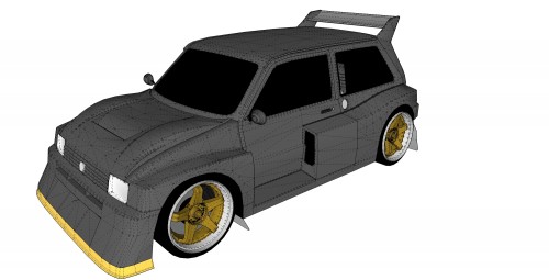

Hey Dadio, I've downloaded this very cool Metro rally car from the warehouse.
If you want, I can reduce the scale, make it a solid (1.5mm min wall thickness), export as an STL file so you could import the file into Fusion and determine if it could be printed. Just the body of course. Let me know?? :D

That's a very kind offer but I can't ask you to do it as I have no idea when I'll have a chance to try it , I've kind of got things wracked up on my to do list ,I really do appreciate it though .
