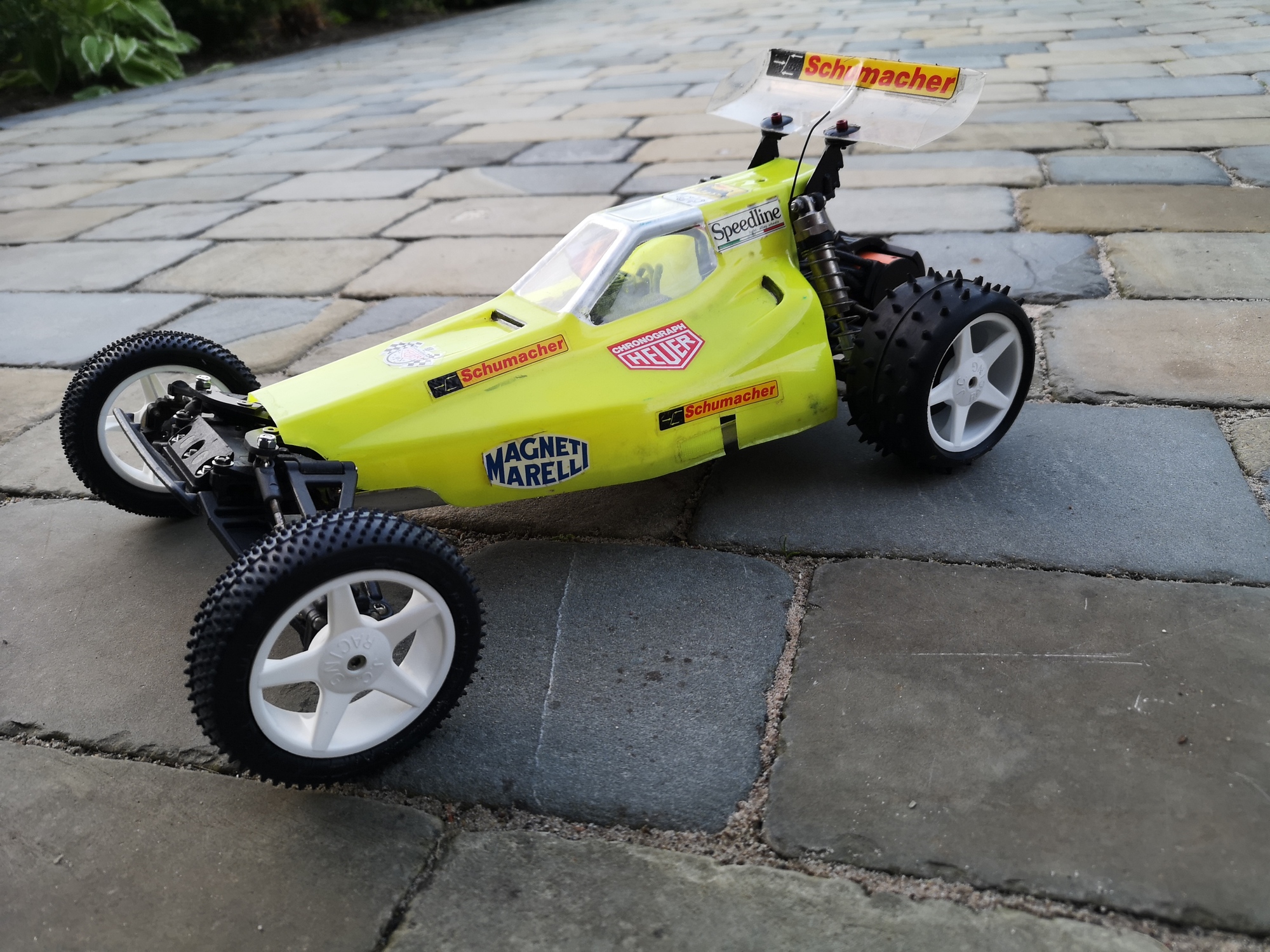

New to the Forum and haven't done R/C stuff for years, but with Lockdown i thought i'd get the old gear out.
Well eventually rescued this from my Dads loft were its resided for about 20years, original tyres were shot and wheels buckled from a carpet being on top of it, but after a clean up and some new bits its got this stage. I cut the nose of the body years ago when i mounted the shocks upright but have gone back to the lay flats.
Spent a bit of money on it so far, budget brushless motor and ESC, Lipo pack i already had from an MTB light custom setup, it just fits lengthways.
cheap servo and R/C setup.
i didn't want to drill the chassis to mount any of the newer kit, hence the blue poly foam plate that acts as an adaptor and uses existing chassis holes.
New wheels and tyres to run 2.2 tyres, now fully ball raced, rear strut C/F link and an attempt at linking the shocks.
What else should i do to get the front end to behave and have some level of turn in grip,
Can anyone share the dimensions of the pivots on the proper Aluminium rocker links, and i'll have another go in C/F.

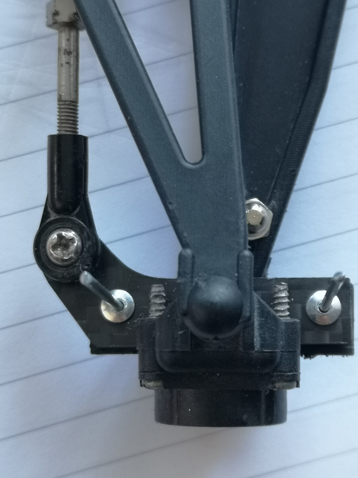

Well, steering mods are underway, trial fit of the new linkage in C/F plate, should increase the Ackermann angle.

Making progress on the front end, narrowed the bottom arms by 5mm,
Designed up and ran off new top mount arms that move the attachment point in 5mm to match the bottom arms, raise it 5mm to make the front arms parallel, and back 4mm to increase the castor angle.
Designed and ran off some new rocker links that need beefing up but have plenty of clearance.
New steering links to increase Ackerman,
and finally added links to attach the arms to the rockers.

Trial install
