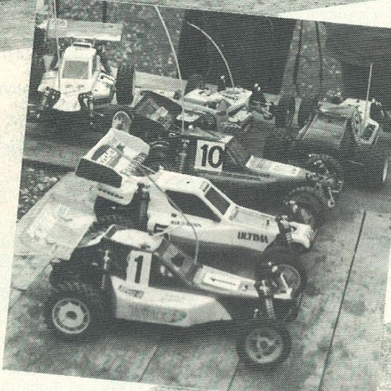

Some pics that I found, hope that these helps:
1987-11 RCMC US: 1987-11 RCMC UK: Moore #1 and Kondo #5 Some Japanese magazine 1: Some Japanese magazine 2: 1987-10 RRC Random Ultima(s?): Jirka
