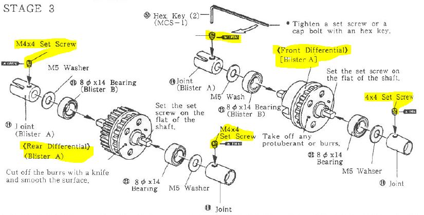

From the body on your car, it appears to be a Custom Special (last model in the series).
If that is correct, it was equipped with factory built gear diffs which are very reliable and don't require frequent maintenance. Also, your car looks to be in very good condition so I'm betting the diffs are fine. You can give the wheels a spin and confirm that everything is good. While holding the spur gear and preventing it from turning, the left and right wheels should spin freely in opposite directions and not catch or make clicking noises.
It's possible that someone has upgraded to ball diffs - these will spin as described above but with some resistance. You can easily confirm that it has gear diffs by the presence of 'set screws" in the drive cups. Ball diffs had integrated drive cups so they didn't require screws to hold them to a shaft.
Ball diffs do require maintenance as they can become loose and begin to slip or become gritty from dirt.
