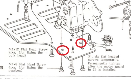

By the way, does anyone know what these two holes are for? I've had a look at a variety of Ultima buggy manuals and all chassis plates have them but they don't appear to serve any purpose. I can't see anything mounted using these two holes.
Maybe they're meant to function like scuppers to prevent dirt accumulating between the suspension arm and the trans??

Re: Ultima Pro XL wheelbase?
Yes, I guess they do align.
...and the right outdrive set screw would be very hard to access without the hole.
The manuals for the Ultima and Turbo Ultima don't show the holes but manuals for subsequent models do - even those that use a ball diff which don't require set screws.
I have a few old chassis plates and all of them have holes.
thanks Jeff!
thanks Jeff!
