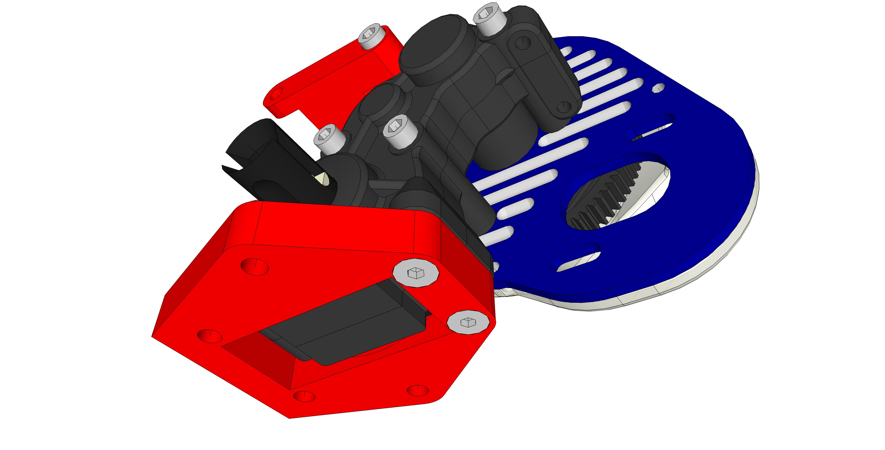

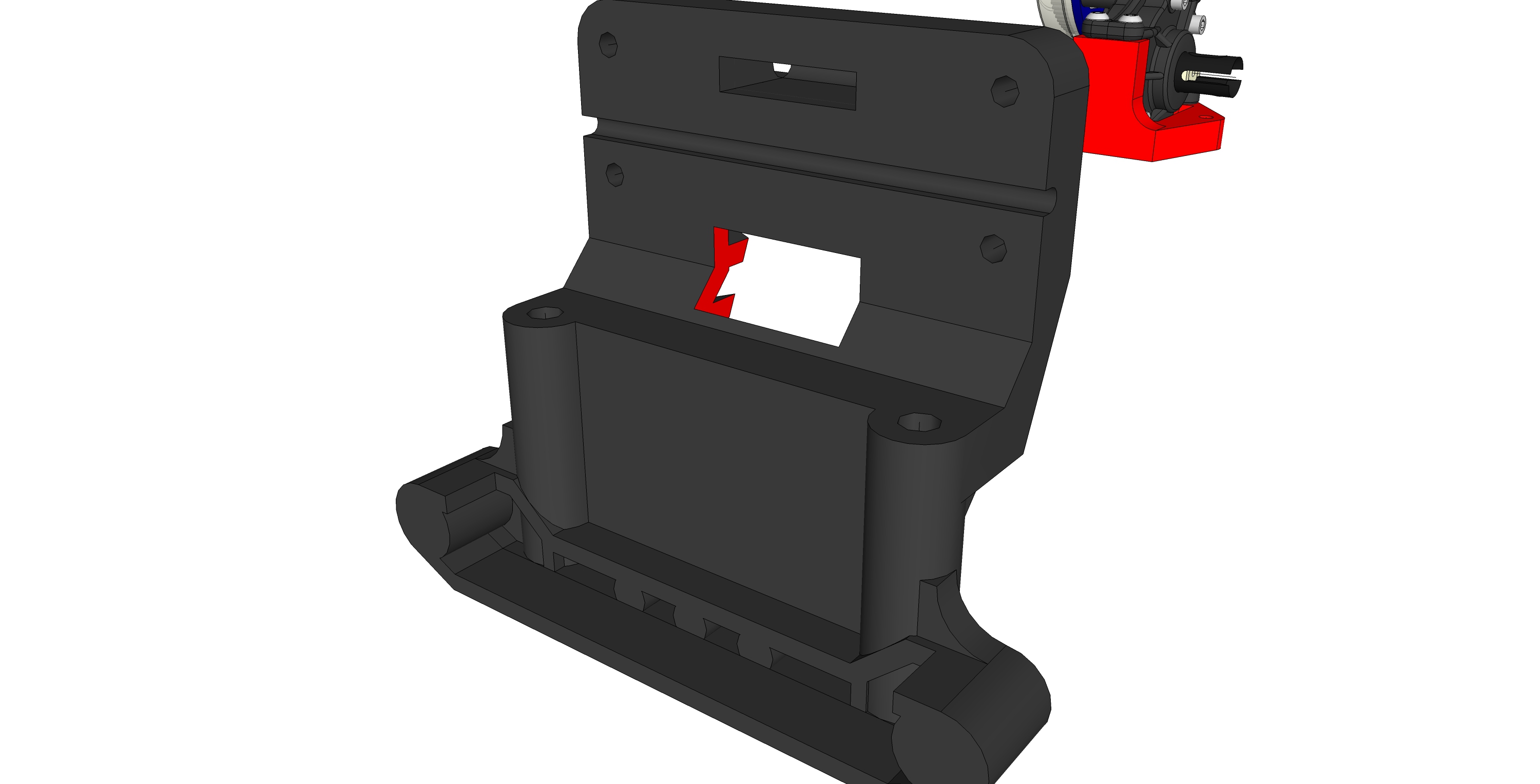

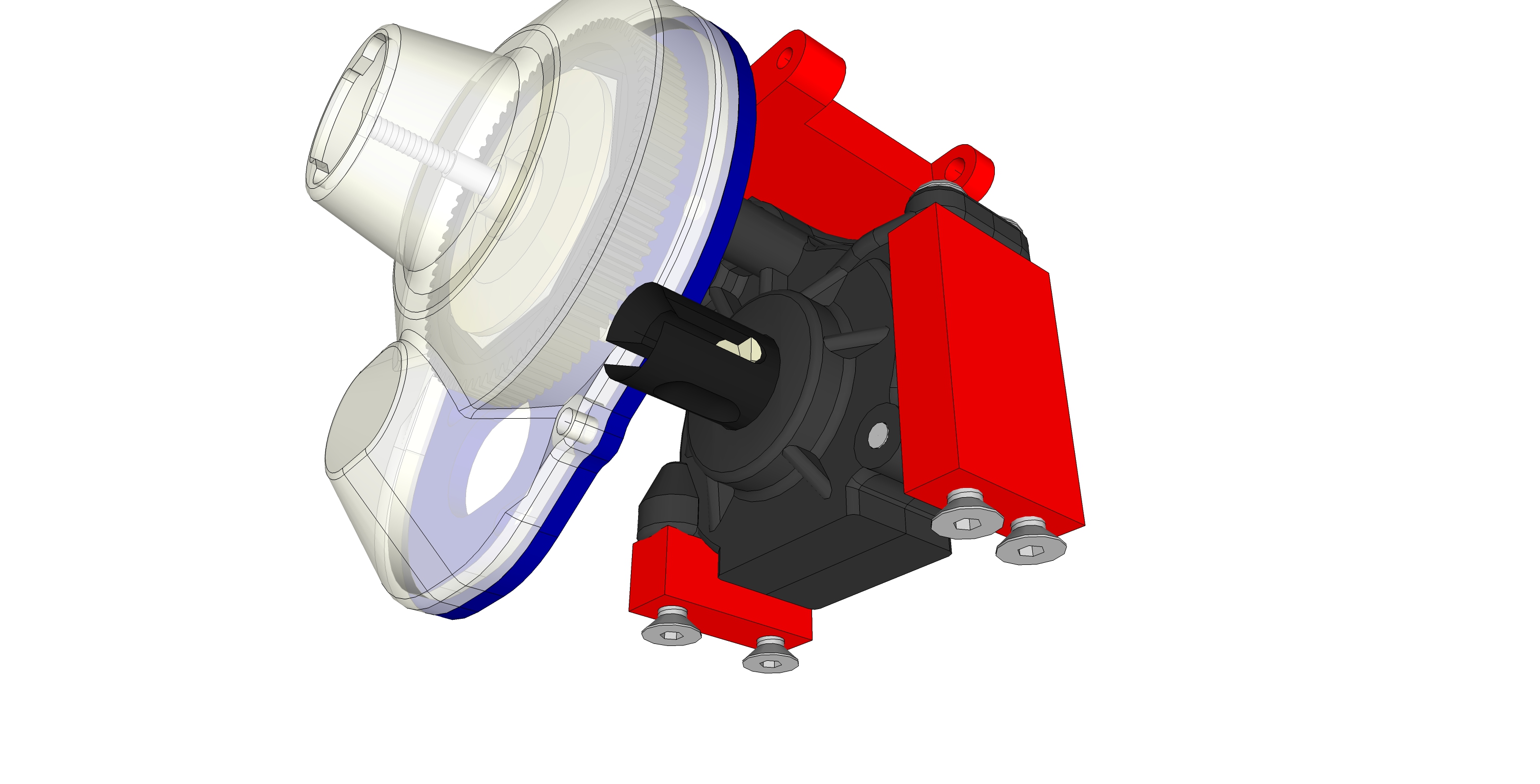

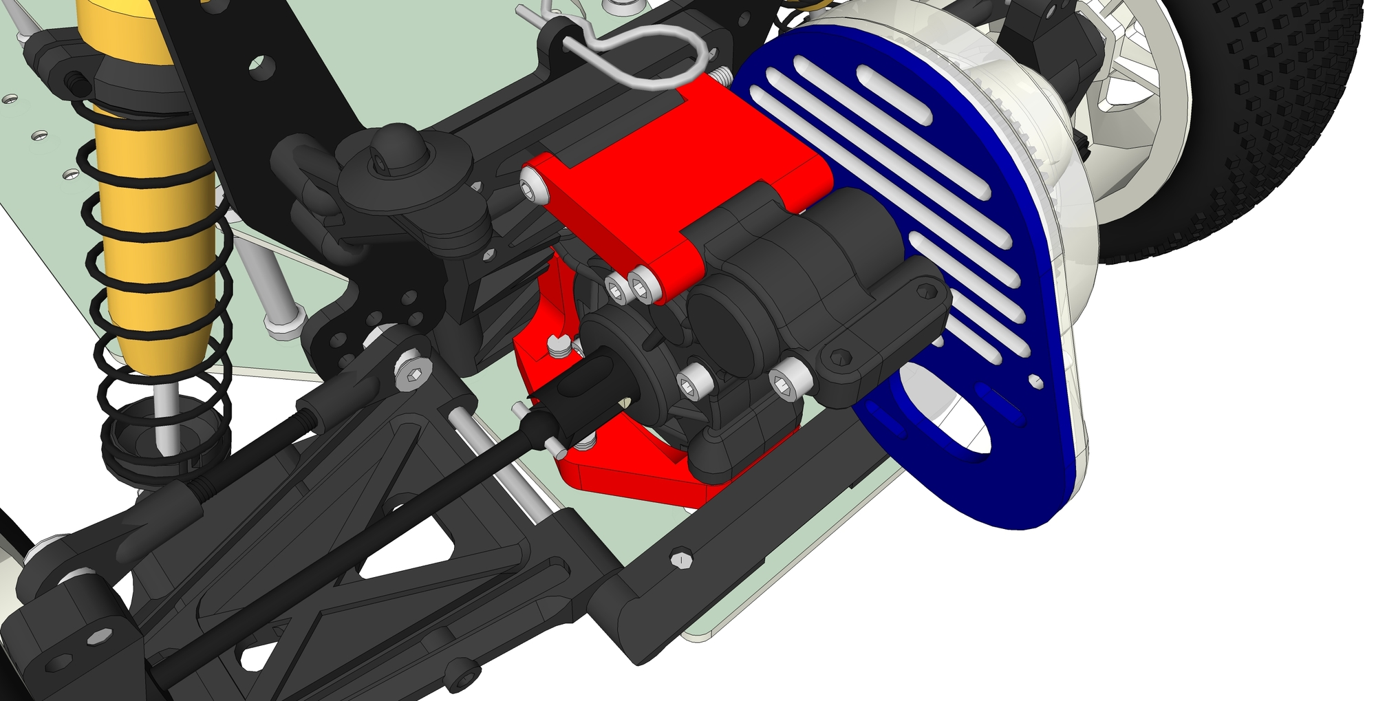

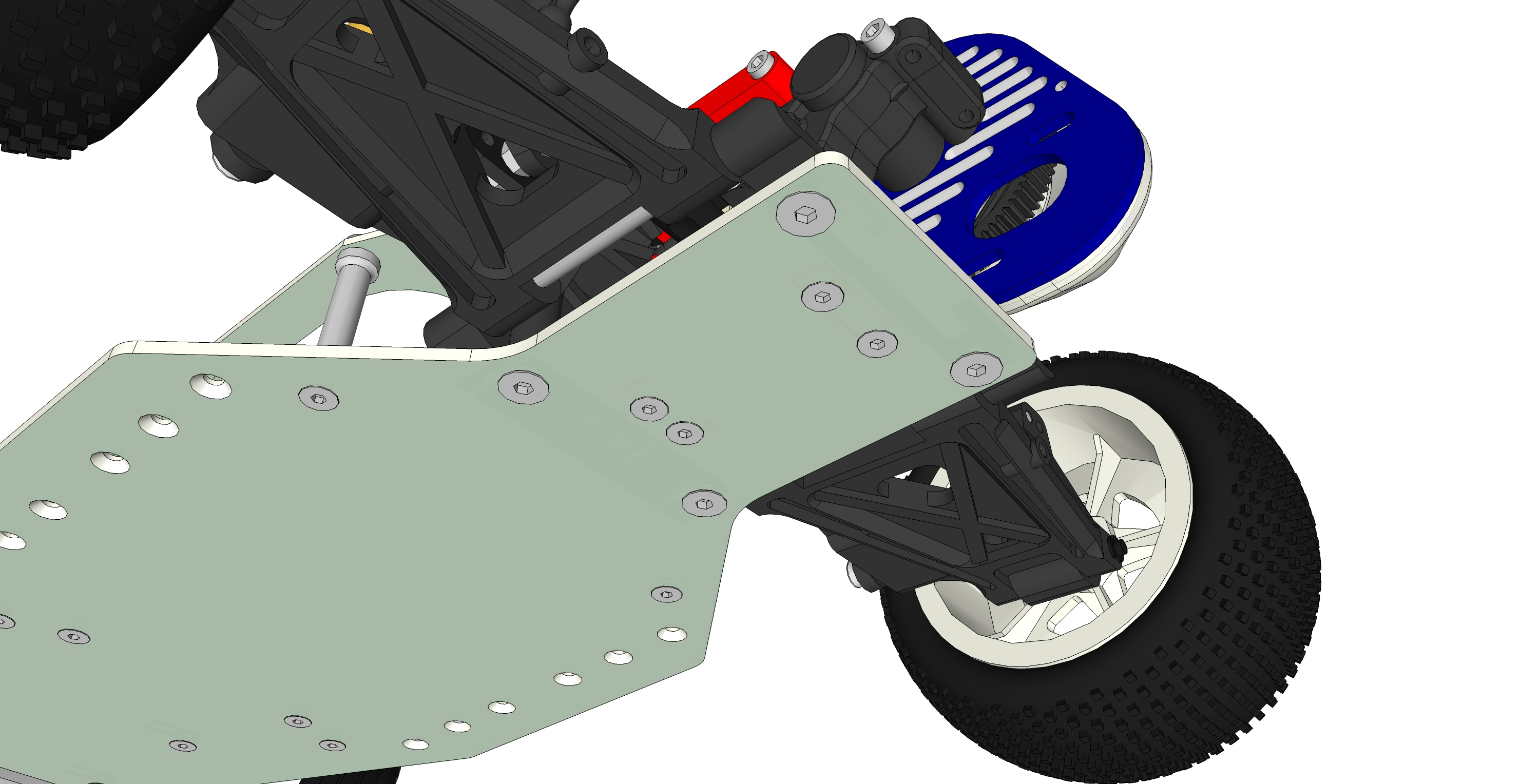

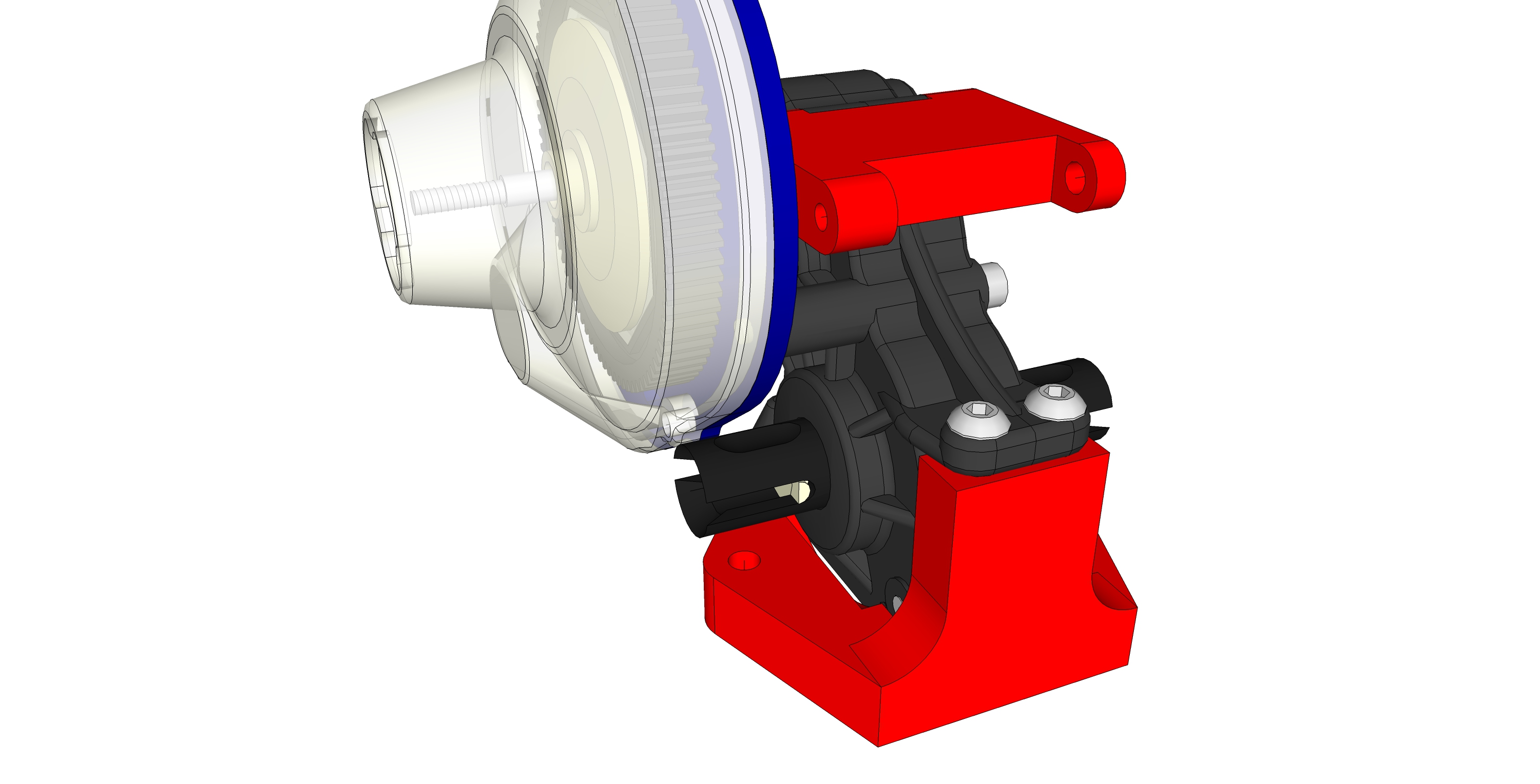

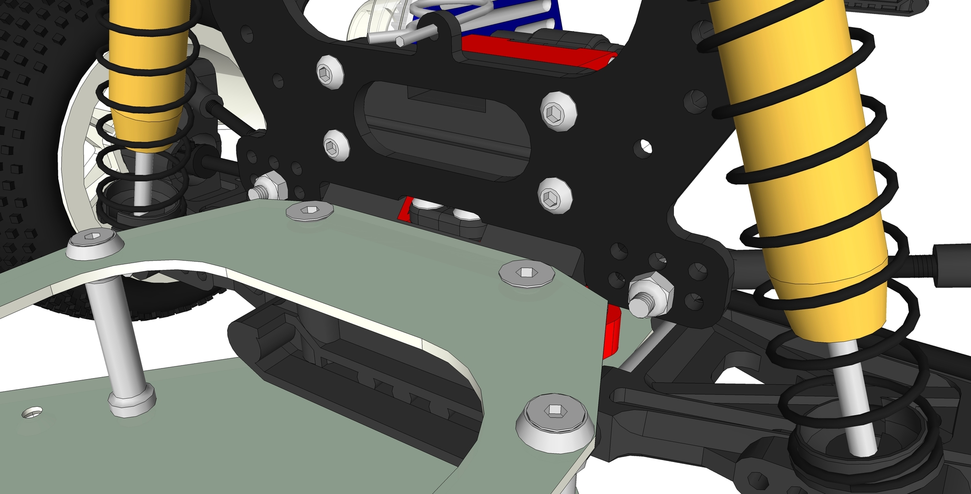

Having recently completed a B4 3d model and inspired by your original post, I couldn't resist the challenge of designing a cradle to mount a B4 gearbox into an Ultima chassis.
I was surprised at how well the B4 box actually fits the space and how the motor will continue set very close to its original location. Notice however that the Ultima's dog bones will be too short by 5.5 to 6mm.
The cradle bolts to the chassis plate using the existing forward gearbox screw holes and the two outdrive grub screw access holes. Unfortunately the Ultima's rear gearbox holes are slightly misaligned with those of the B4 box so they can't be used to bolt the cradle to the chassis. I believe the four M4 chassis plate screws plus the top bulkhead brace should be sufficient to hold everything in place.

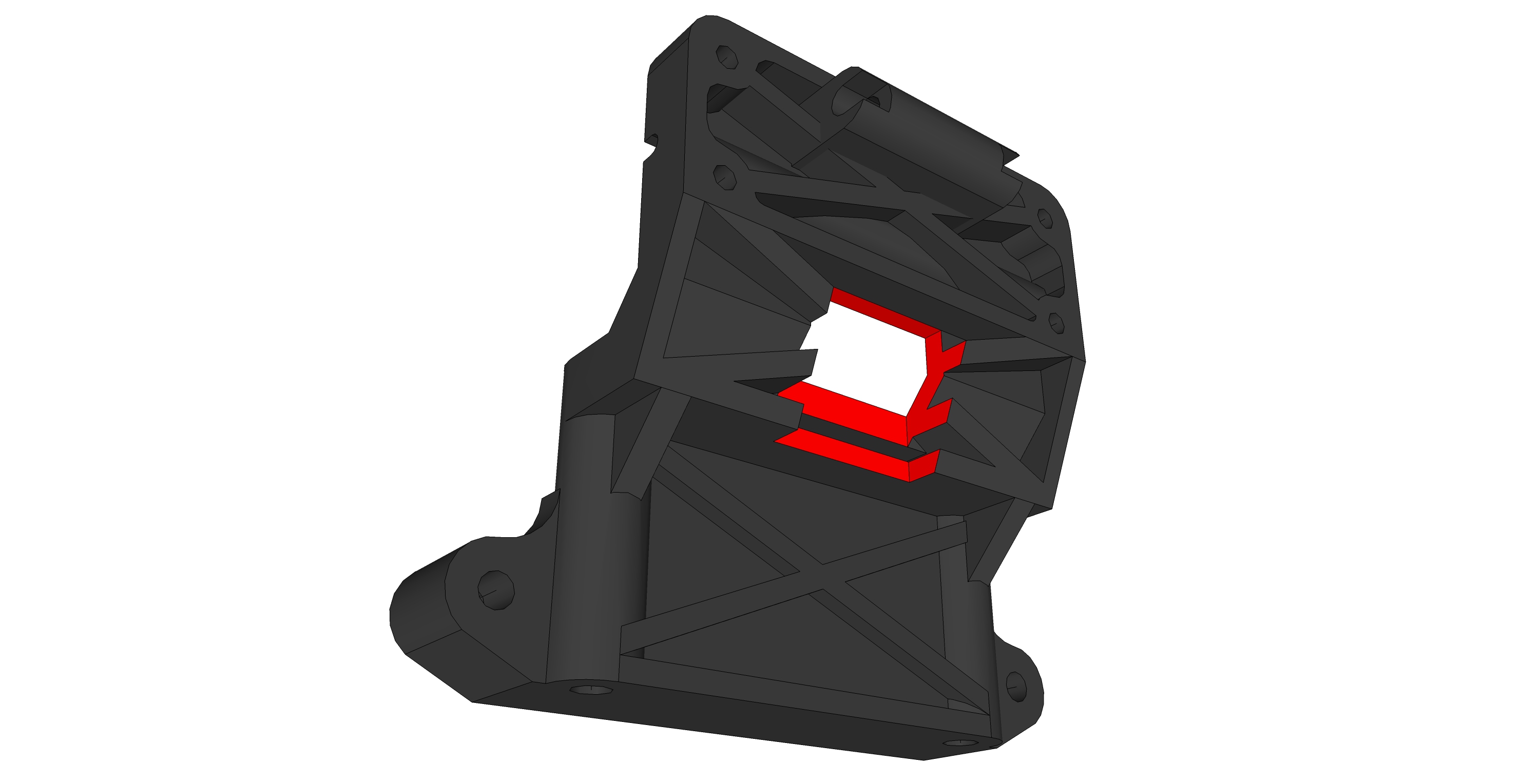

Also, the bulkhead will require a slot to accommodate the B4's forward mounting screws.
If you think this might be useful for your project, I can make available the stl files for printing.

Wow Doug, that's great!! Do you think I could get away with using the inner hinge pin mounts and still have a structurally sound transmission mount? I could run the B4 screws straight through the chassis and cradle to tie all that together so maybe those lateral mounting ears wouldn't be necessary. Also, I would likely be starting with a clean sheet of 4mm carbon fiber so I would only be transferring over the holes I'll need. Before I stepped away from RC, I had mocked up B4 rear arms, hubs, and wheels mounted to the inner hinge pin mount and it all lined up pretty decent. I figure with several Associated buggy iterations since then, I should be able to find a combination of parts that will work well. If that doesn't work, I can always still use the set of long Pro XL arms I have and get some newer hubs for it.
I appreciate your time and generosity with mocking that up and offering me the file. At this point, I would probably hack that cradle from a chunk of plastic by hand. Is there a way for you to provide me with the basic dimensions of it...? That would be a huge help!
Thanks!!
Thanks!!

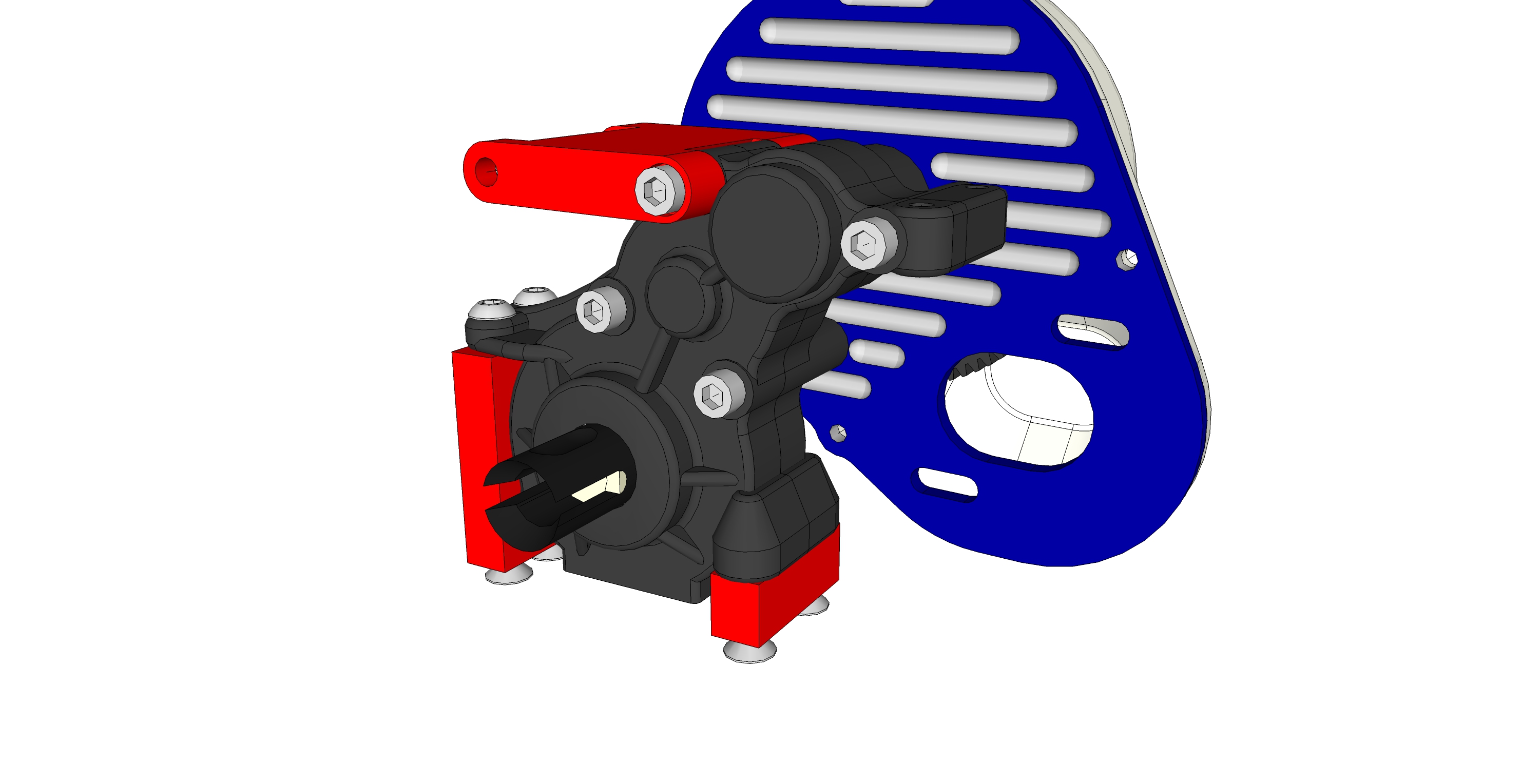

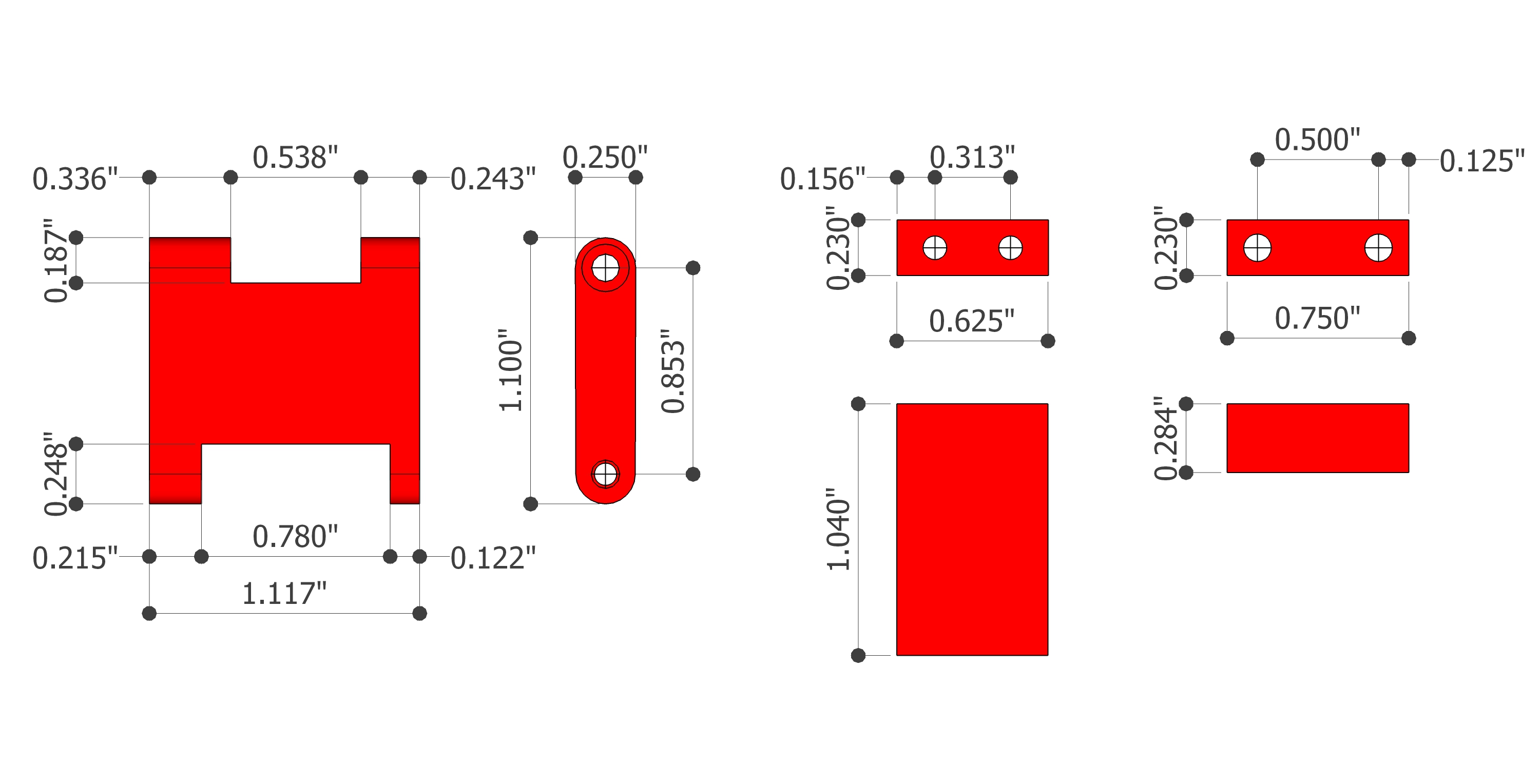

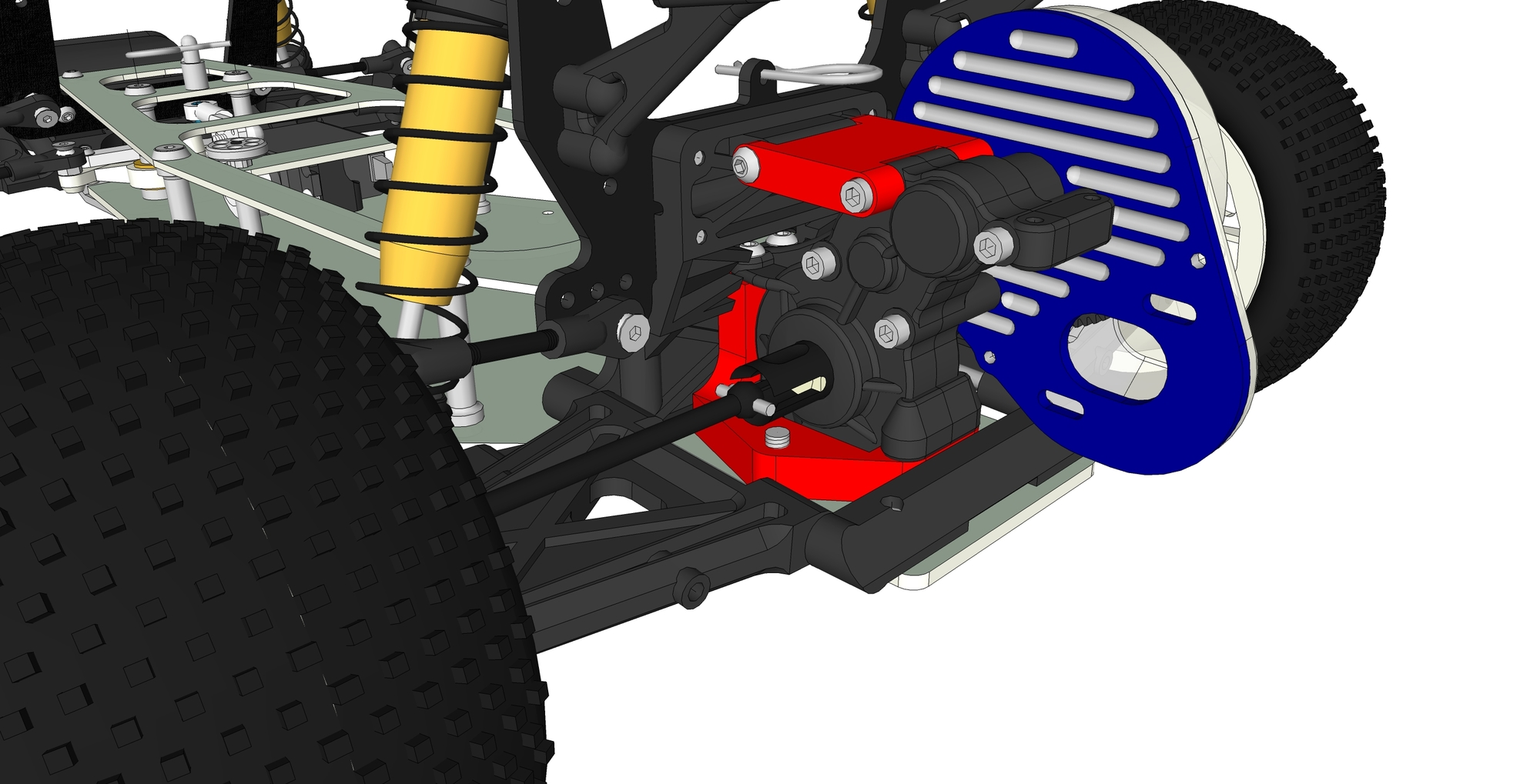

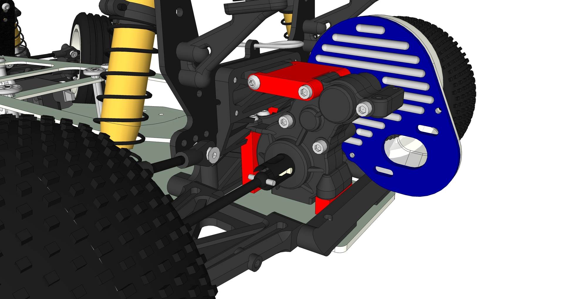

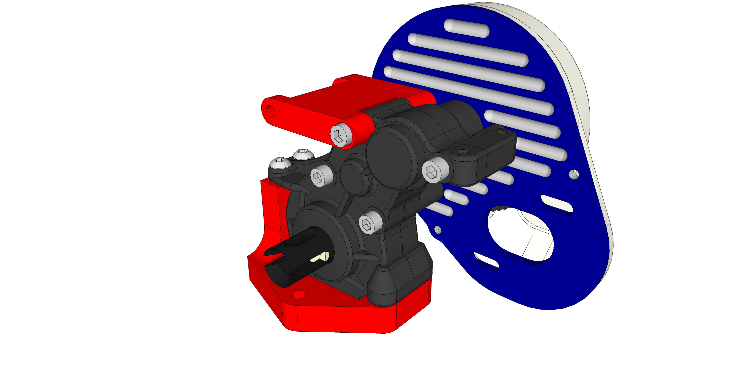

Since you're starting from a clean sheet, the gearbox mounting screws can definitely pass directly through the chassis plate and the cradle becomes two simple spacer blocks. At first glance these tall stanchions might look a bit precarious but I believe with the bulkhead brace, the mounting system should hold the gearbox/motor assembly securely.
If this is what you're after, I can supply all dimensions necessary to make the blocks and mount them to the chassis plate.

That looks bang on!! I would be very grateful if you would send me those, PM coming your way!

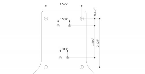

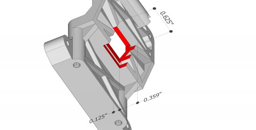

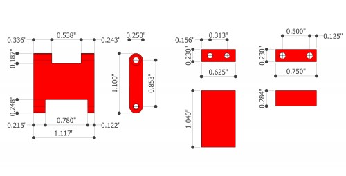

Re: Ultima Pro XL chassis length: help needed

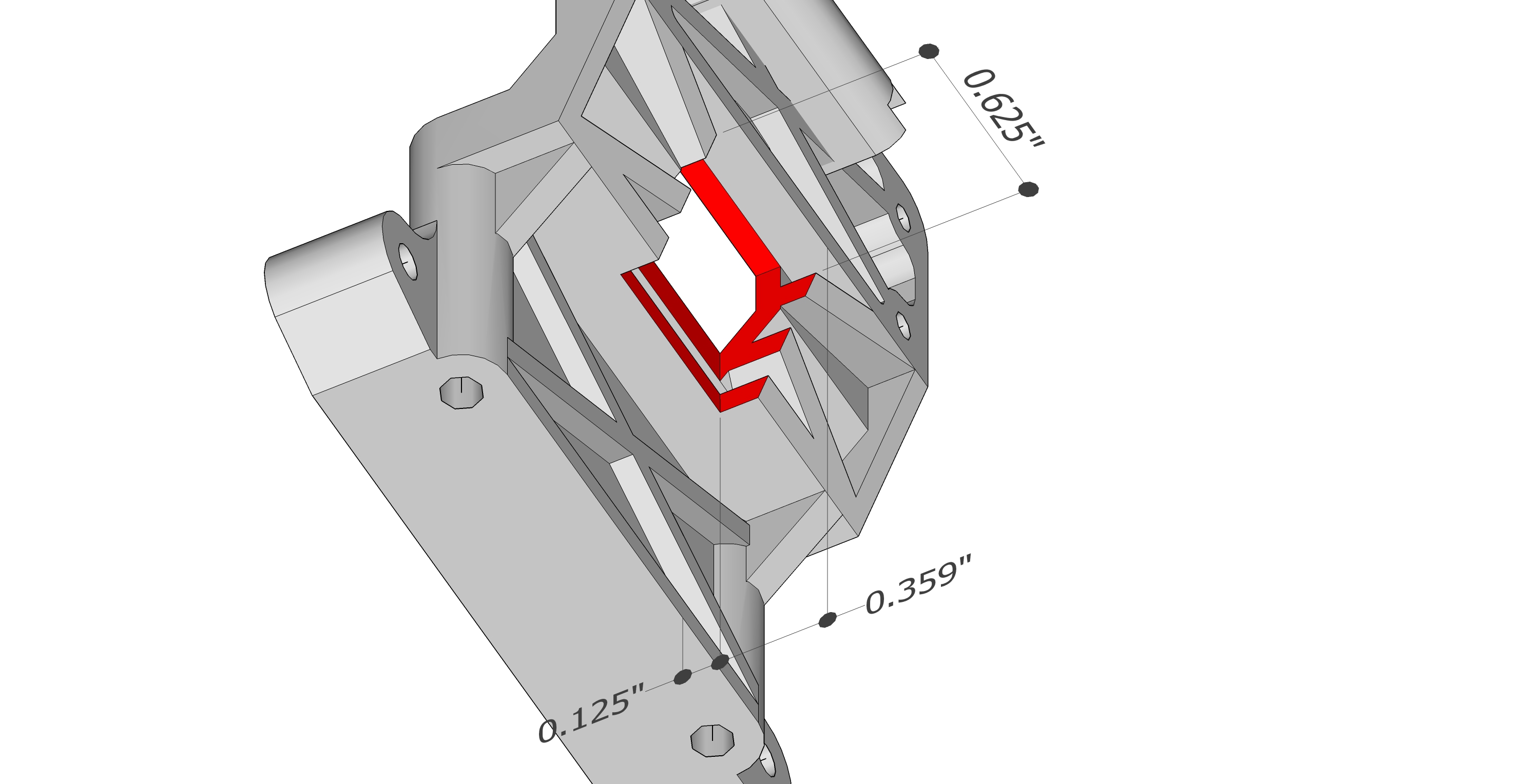

Thank you Adam. I'll just post the dimensions here for anyone else who might be considering a similar build.
Just click the images to enlarge them and let me know if any of this is unclear.
I hope you're able to retrieve you're stuff soon so you can begin working on this project.

Thanks ! This helps a lotXLR8 wrote: ↑Mon Nov 23, 2020 5:43 pm Thank you Adam. I'll just post the dimensions here for anyone else who might be considering a similar build.
I hope you're able to retrieve you're stuff soon so you can begin working on this project.![]()

Guess who has been reunited with their gear...? That's right, this guy!! I'm going to see if one of the local machine shops has any small chunks of aluminium or delrin sitting around they'd part with. Then I'll get the Dremel and drill press fired up and hopefully get these made. Finally.XLR8 wrote: ↑Mon Nov 23, 2020 5:43 pm Thank you Adam. I'll just post the dimensions here for anyone else who might be considering a similar build.
I'll keep you posted.
Edit to add: is there anything reading this that wants to print these for me...? Obviously not for free, send me a PM if so.
