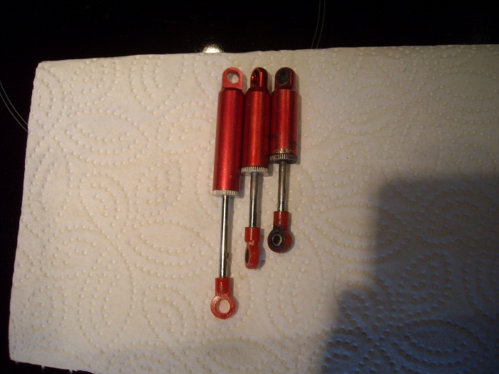

Here´s the picture that says it allSAND SUPER STORE wrote:to Dennis:
today I'm learning a lot ,is the fist time hear about third size of red shocks!!
it will be great to see that picture!!
all this kyosho vintage misteries always liked me!!!
The long one is the rear damper of an Optima and Optima pro
Do You have a picture of the Optima front bumper?
Thanks.
Gone fishing

To which car those the sort one go?DennisM wrote:Here´s the picture that says it allSAND SUPER STORE wrote:to Dennis:
Thanks.
