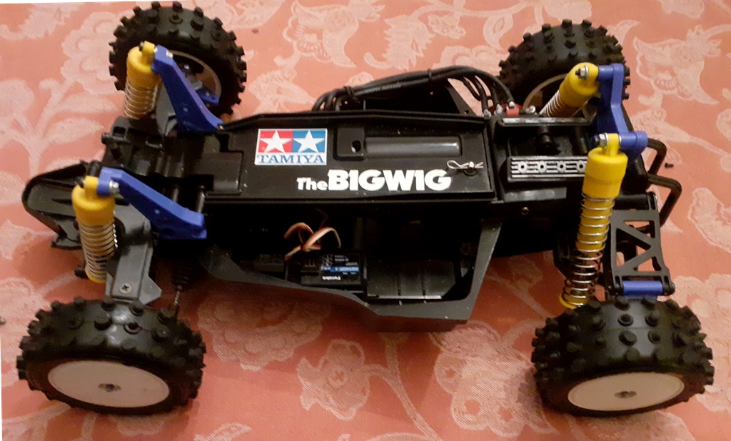

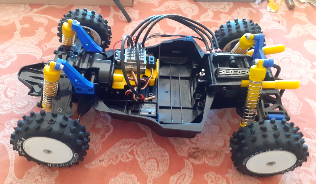

I picked up an Orion Ultimate Mod 8.5 motor, installed a good Futaba steering servo, with a few tricks to give it more steering, a nice Futaba rx with an internal antenna and the mighty Orion R10.1

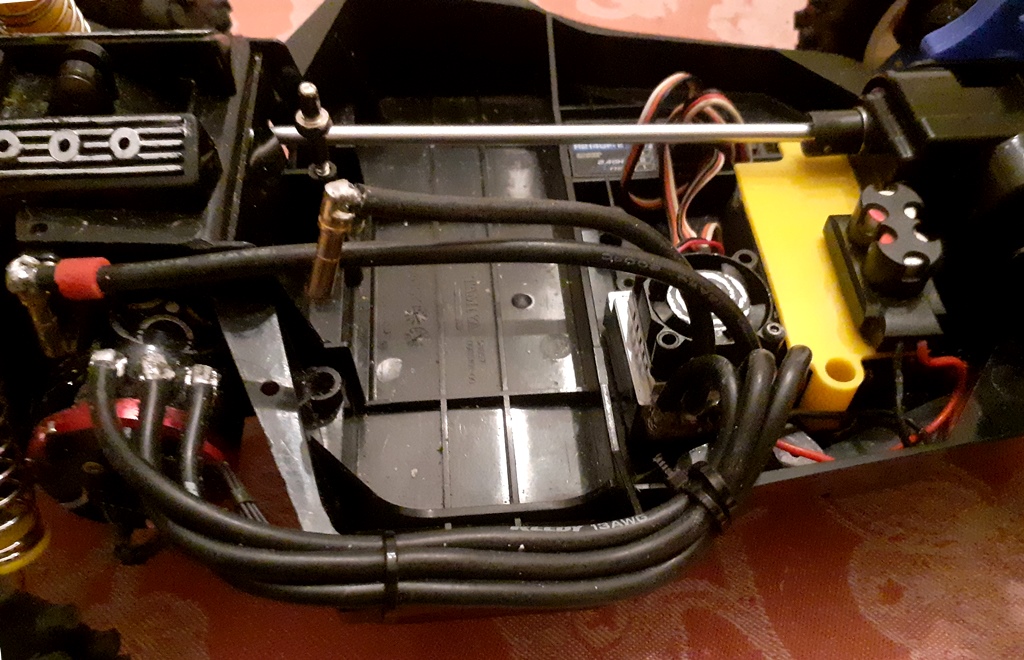

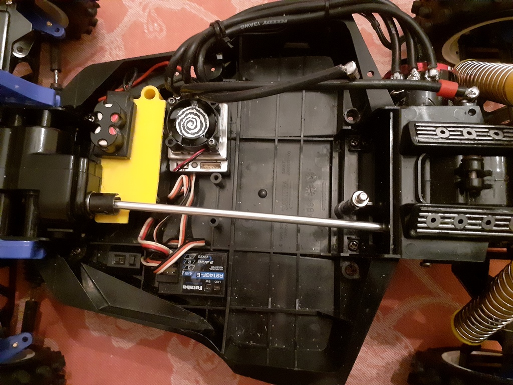

I tried a few different mounting locations for the ESC, in the end it had to go onto the chassis, the fan only just cleared the sub chassis, so I trimmed the yellow mechanical ESC mount and all is well.
I really had my doubts if it would hold the power.
The music wire drive shaft had to go, so I installed a re-release Super Hotshot one, which required two shock O rings in each prop joint to keep it in it's sweet spot, I guess the Bigwig has a slightly longer chassis.

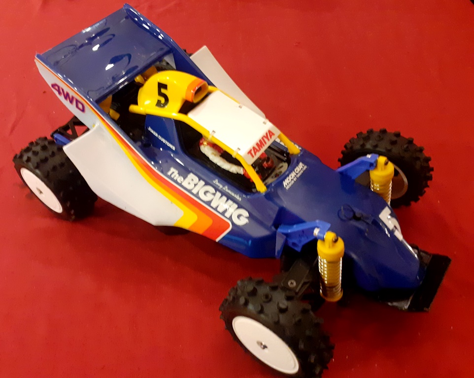

Maiden run was just zipping it up and down the street and it was FAST!
The only thing that lets it down are the stock tires.
I glued them the night before I ran it, it would have just blown them off.
I could get it up to about 60 KP/H and the car would go into a very gentle slide, unnerving but easy to get back into control.
I think all it needs are some decent wheels and tires and I may splurge on an MIP ball diff set, too.
A really fun car, so glad I made it totally mental.
