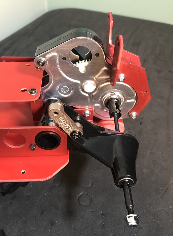

I have been making good progress cleaning and restoring this beast over the past week. Sold the pulling gearbox to fund new parts. When disassembling the front end, I was excited to see some CRP arms but got shot down in flames to see 1 stock arm..another “what the..” moment.
Installed some modern aluminum front arms instead..
A red Sharpie does a great job of touching up the scratches on the red anodizing!
Plan A to use a Thorp setup got scrapped when I realized I didn’t have the proper dogbones.. So plan B is a modern MIP ball diff and Tamiya CVDs which work great and are super smooth. New rear arms with Ampro/Shapeways shock mount reinforcements. It is looking awesome now! Next up is shocks, and body mounts.
-Brad

Over the past weekend I worked on the steering.. I have 3 of these Hot Trick steering assemblies for the 2 vehicles I am restoring. I disassembled everything, did an assembly line cleaning, rejected bent/damaged parts, and upgraded it with vintage Thorp and Dubro turnbuckles.
The Monster Beetle body is on the way.. Waiting for it to arrive to determine body & shock mounts. Glad I didn’t sell these aluminum wheels!!
-Brad
