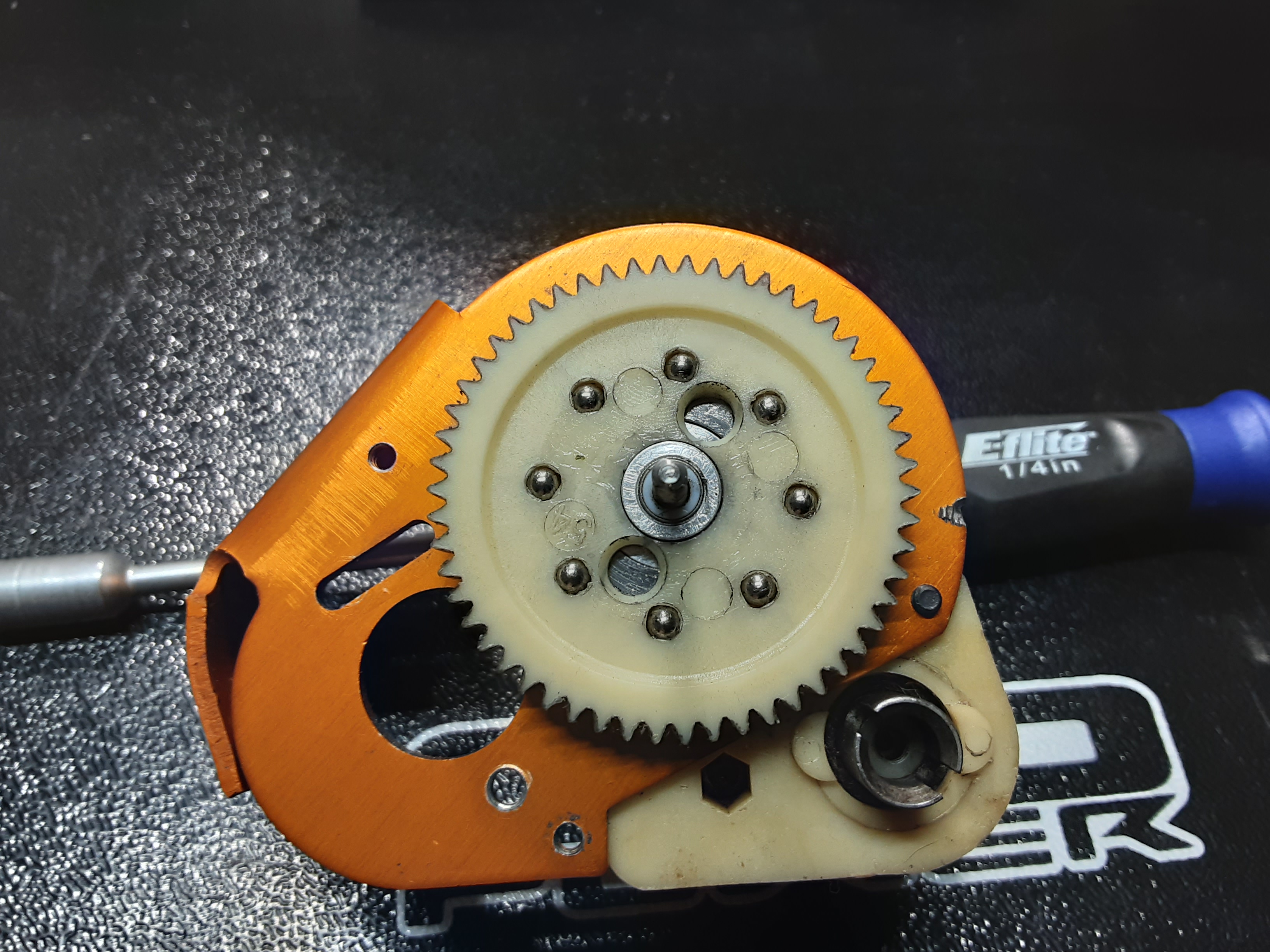

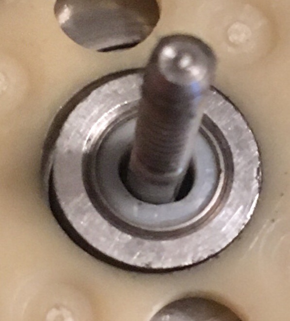

Is this much spur gear/diff hub gap normal?
Six-gear transmission. Every spur I have is like this...a few og nylon and a bag full of Kimbroughs.

Re: Is this much spur gear/diff hub gap normal?
No, not normal.
That is an AE 32P spur gear but I have modern 48P Kimbrough gears that fit the same.
But you should be aware that there are spur gears with different hub diameters out there.

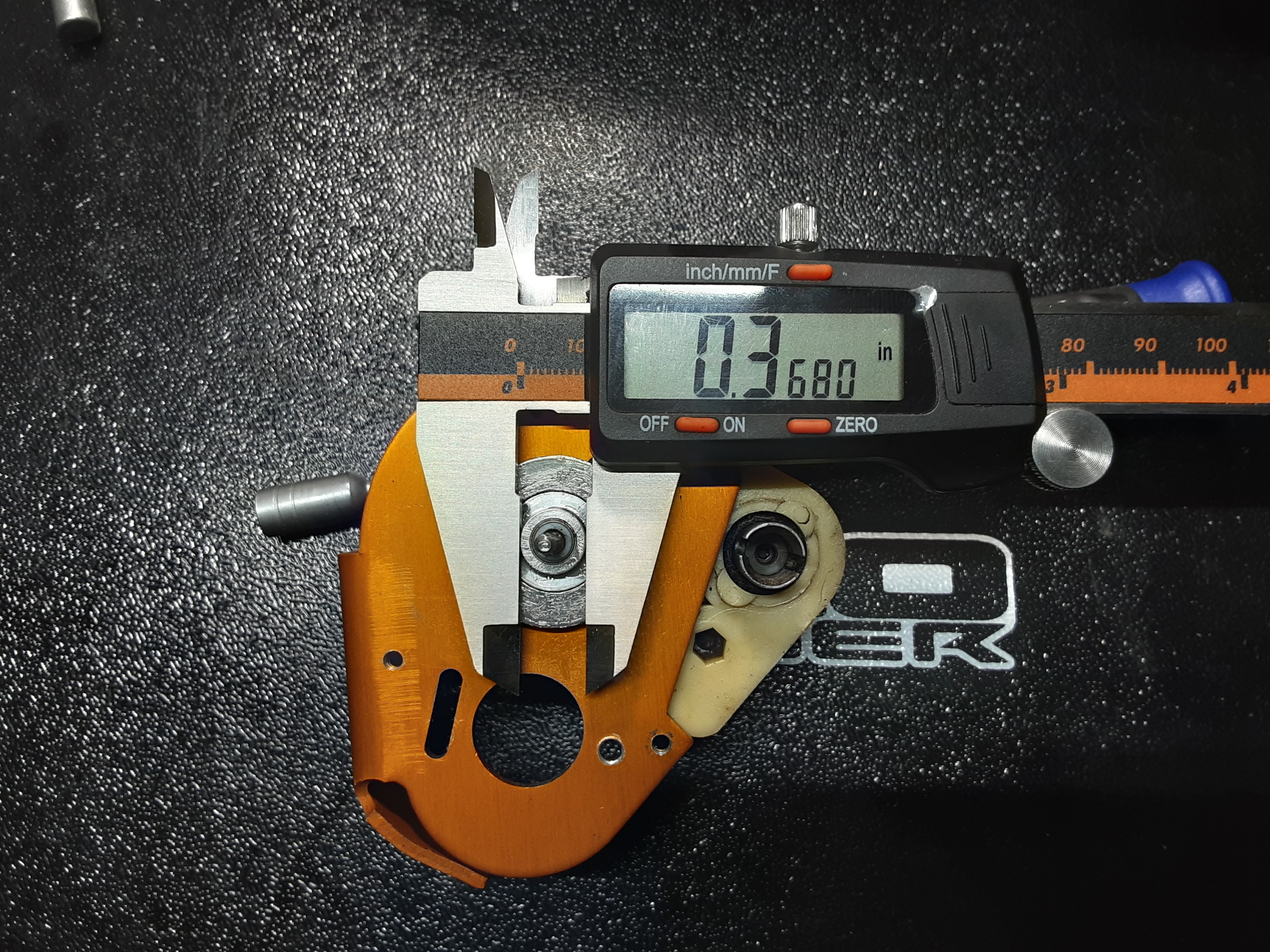

Thanks for the pic, mine mics at .366. Guess I left it in the dryer too long.
Assuming that both of our calipers are accurate, 0.002" isn't much.
But if you are sure that all your spur gears are standard (and still too large), you might can try a Traxxas gear. The center hub is slightly smaller.
