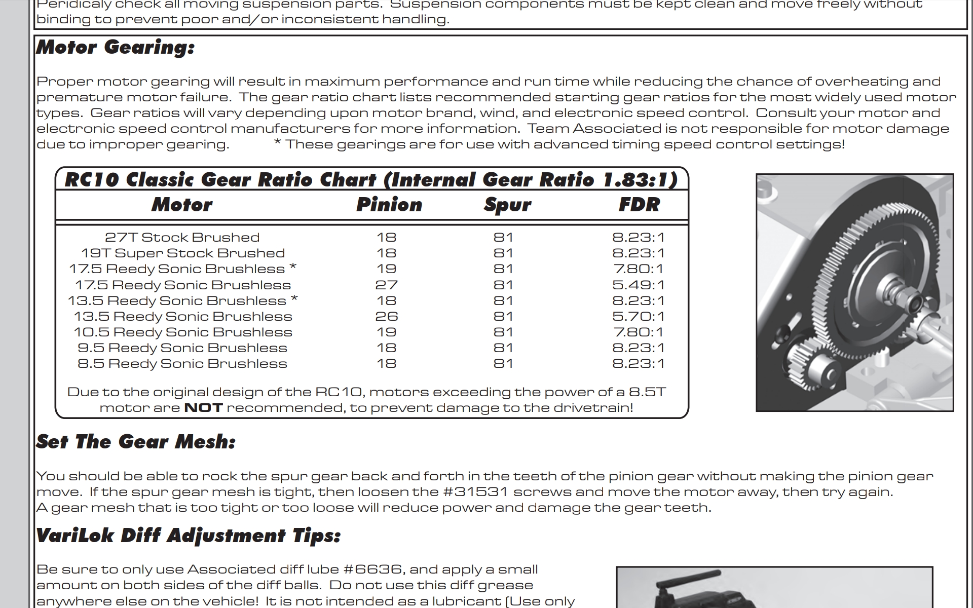

This is from the RC10 Classic manual. It even has a 19T listed.
I'm about to put a 19T Radon in a six gear car. I planned on starting with 81/18, 48P gears.
Keep in mind that early RC10 tires are shorter than modern 2.2 tires, changing the effective gearing.

That would put me at 54/11-12.
Which sounds about right because my smallest current pinion is a 13T. Of course.
