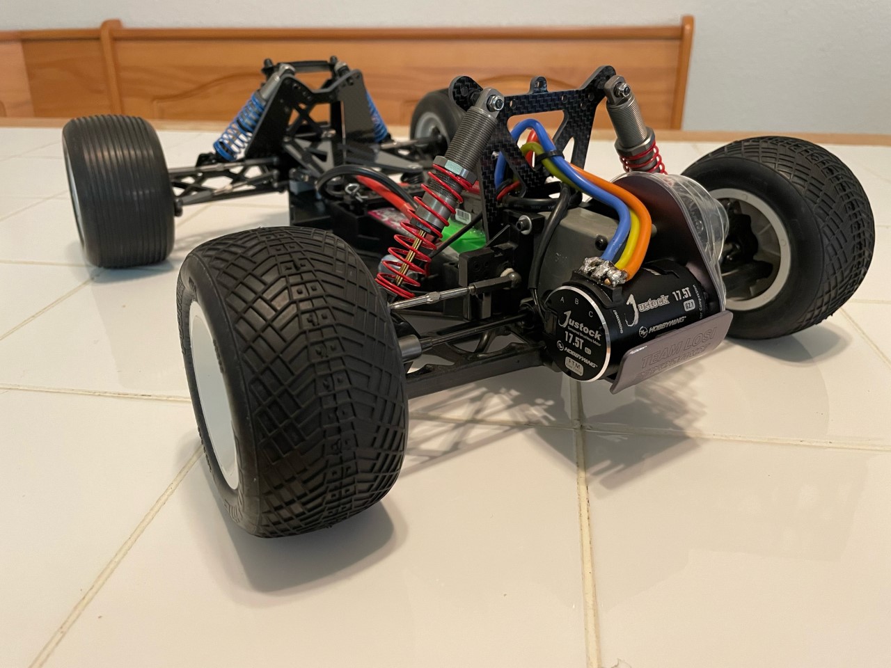

LXT Resto-Mod Racer Build
So a little background first... I started racing Losi trucks way back in the beginning, the late 80's, first JRX-T's, then LXT's. I continued until the mid 90's, when I got sick of having to buy the latest gadgets every few months just to stay competitive. After that I was out of racing and the RC hobby for many years, as family, children, and work obligations took over. I got rid of all my trucks (regrettably), and figured I'd never be involved in RC again.
About 6 years ago fate & circumstance intervened, and I found myself back into the RC hobby & racing again. I built, customized and fabricated a few trucks in that time, enjoying them all immensely, but still there seemed to be something missing. I still missed my favorite truck of all - my old LXT. Given their age and rarity these days, I never thought I'd ever be re-united with my beloved LXT again. After lurking here for a bit and seeing the beautiful trucks being built with NOS parts, I saw a glimmer of hope. I started watching and searching on eBay, just to see what was out there - at least that's what I told myself, anyway. Sure enough eventually I found the perfect truck for me. A newly built, never run LXT roller with all the right stuff - XX Retro-fit trans, Lunsford Titanium rods, original (neon green) LXT wheels with new Losi rib front tires & new Losi step pins in the rear - both in HT compound.

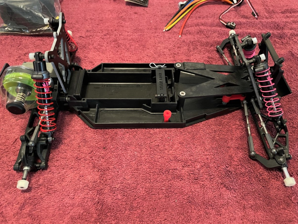

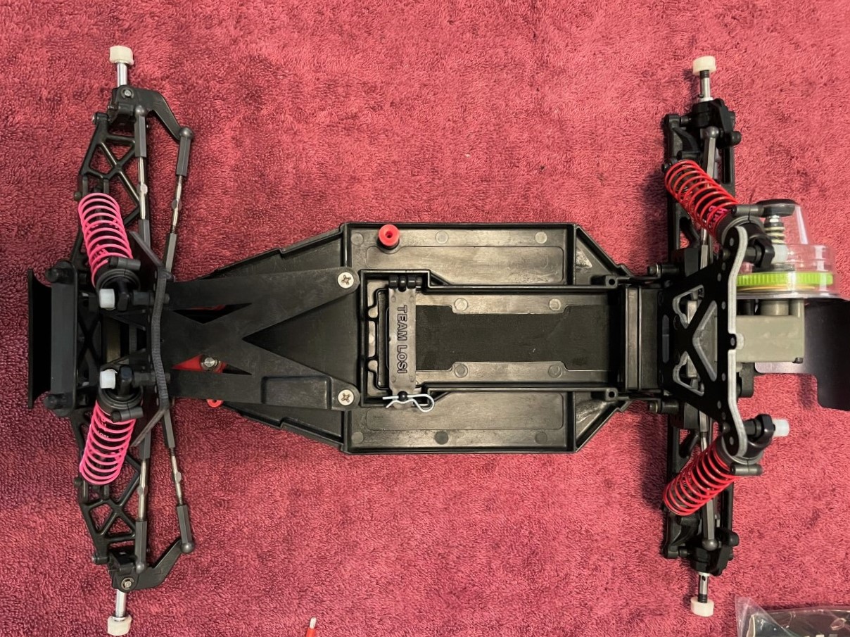

After making the purchase, I decided rather quickly that this would not be a shelf queen. With that in mind, I began collecting the pieces needed to make it a (somewhat) modern race truck. Knowing that racing can be hard on equipment, I started collecting a host of spare parts as well, while availability is still somewhat decent. So now, without further ado, here is the progression... from its first arrival in October to as it sits today.

Re: LXT Resto-Mod Racer Build

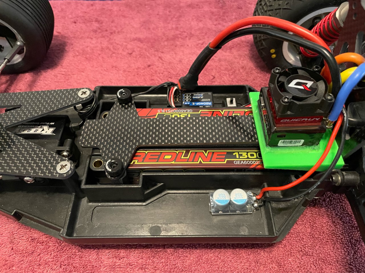

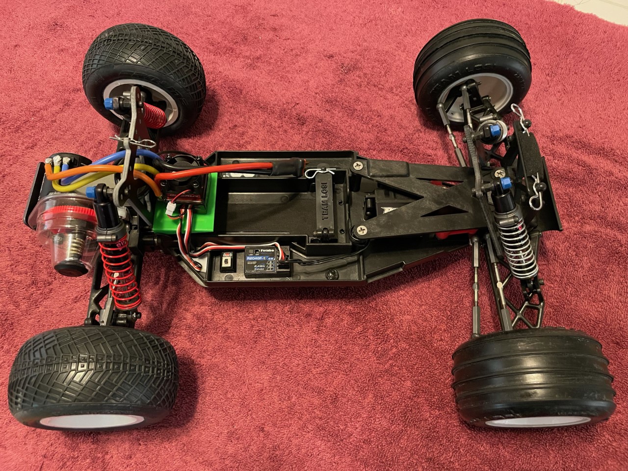

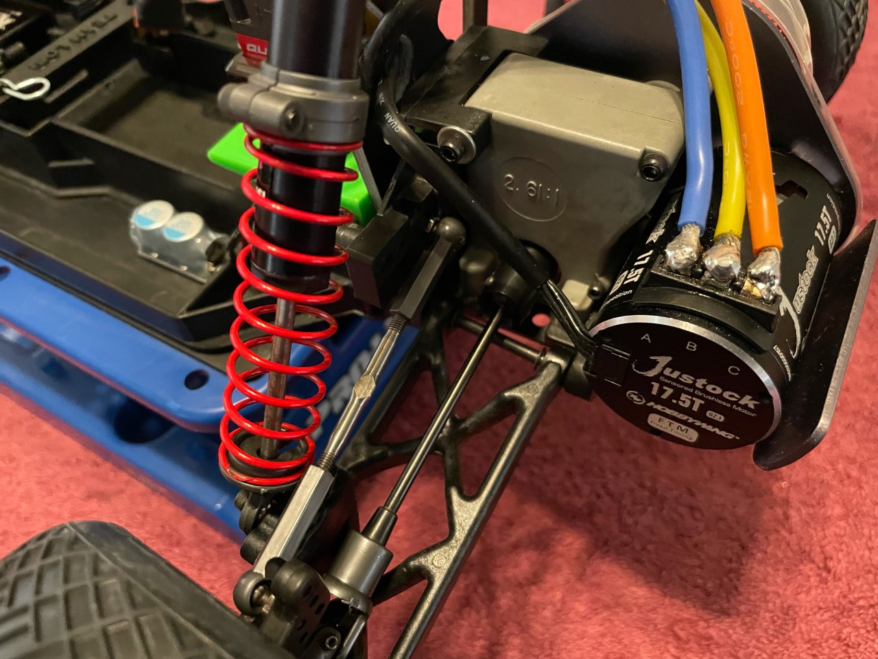

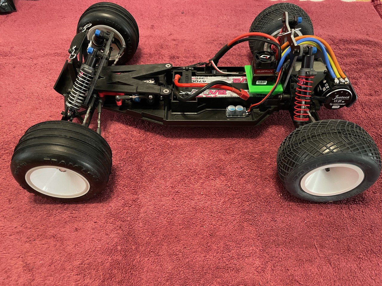

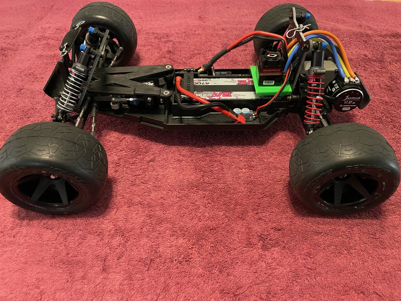

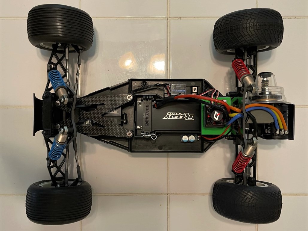

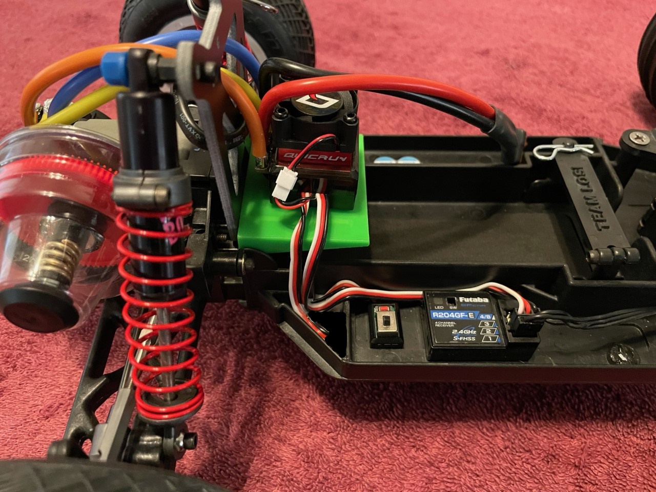

I started with some modern brushless electronics in the form of a Hobbywing Quicrun 10BL60 ESC and Hobbywing Fixed timing 17.5T brushless motor. I didn't want anything too overpowering for 30 year old components. Back in the day, I ran exclusively in the Modified Truck class, so I figured this would be comparable in brushless terms.
I found some miss-matched wheels in white that I mounted some modern rubber on, as well as some old HPI black Star 5 spoke wheels I used for my clay track tire setup. For radio gear I'm using a Futaba 3PV transmitter, and an R204GF-E antenna-less receiver. Also, had to change gearing to be a little better suited to a 17.5T setup. I started by finding an 86T Losi spur gear, but then lucked out and fount a vintage Kimbrough 81T that was compatible. For steering duties, I used a Reedy RT-1508 Hi-torque servo (just an extra I had on hand). After installing the servo, I went to hook up the linkage, and the steering arm cracked and split, as they commonly do. So, I purchased a 3D printed ball bearing replacement from Sabula Tech.

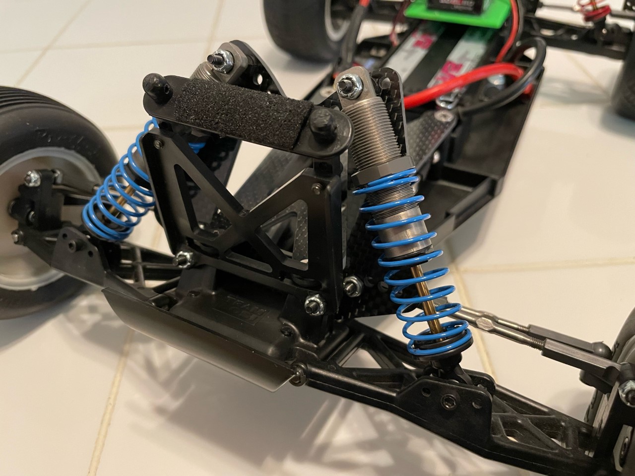

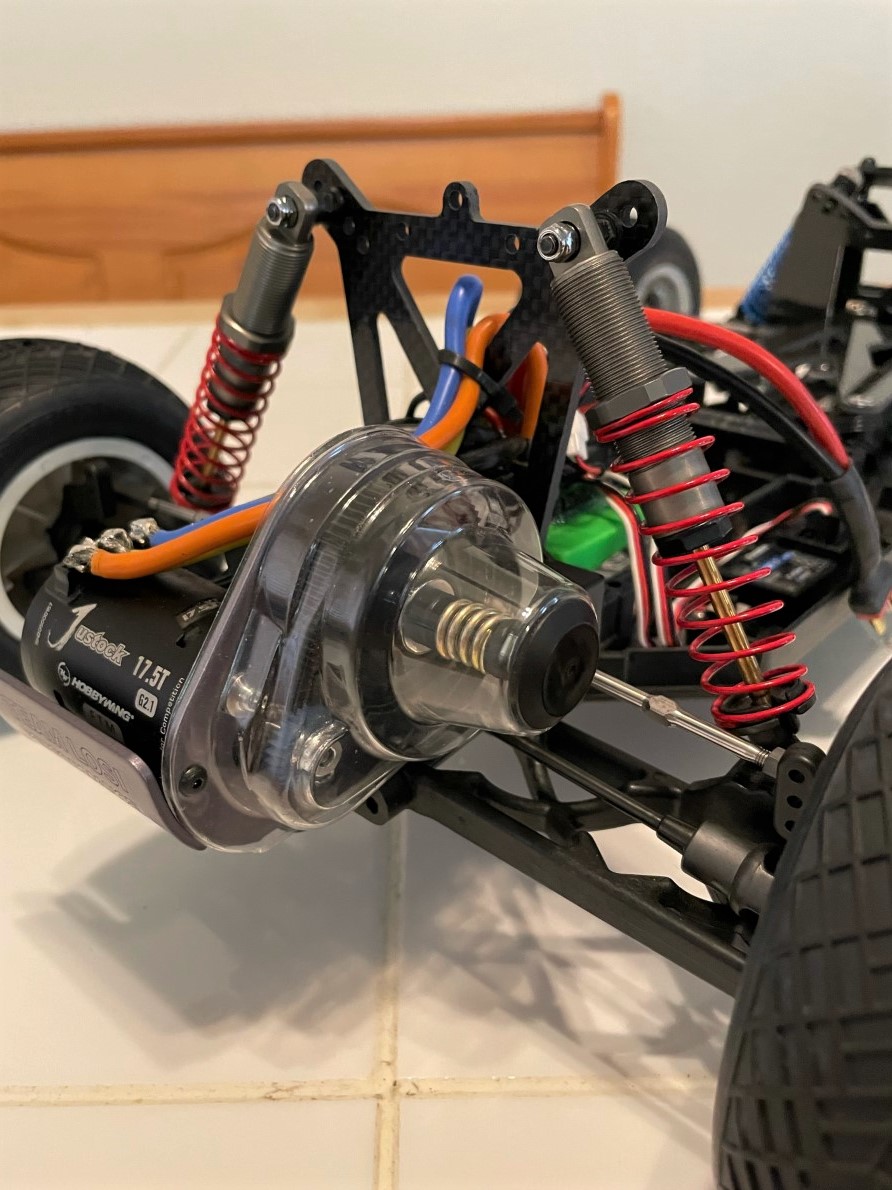

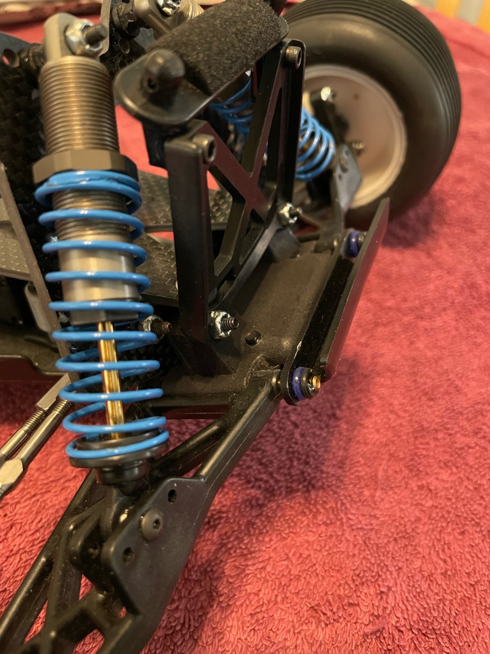

Just as I was thinking I was close to being finished, I came across some extra nice goodies that I had to have. Original Losi threaded shock bodies (XXT vintage, I believe), and some nice titanium nitride coated shock shafts. Found a really cool custom cut chassis protector in carbon fiber as well. And speaking of carbon fiber... Did I mention that it's my Kryptonite? That being said, I just had to get the Vintage RC carbon fiber shock towers & upper chassis brace.

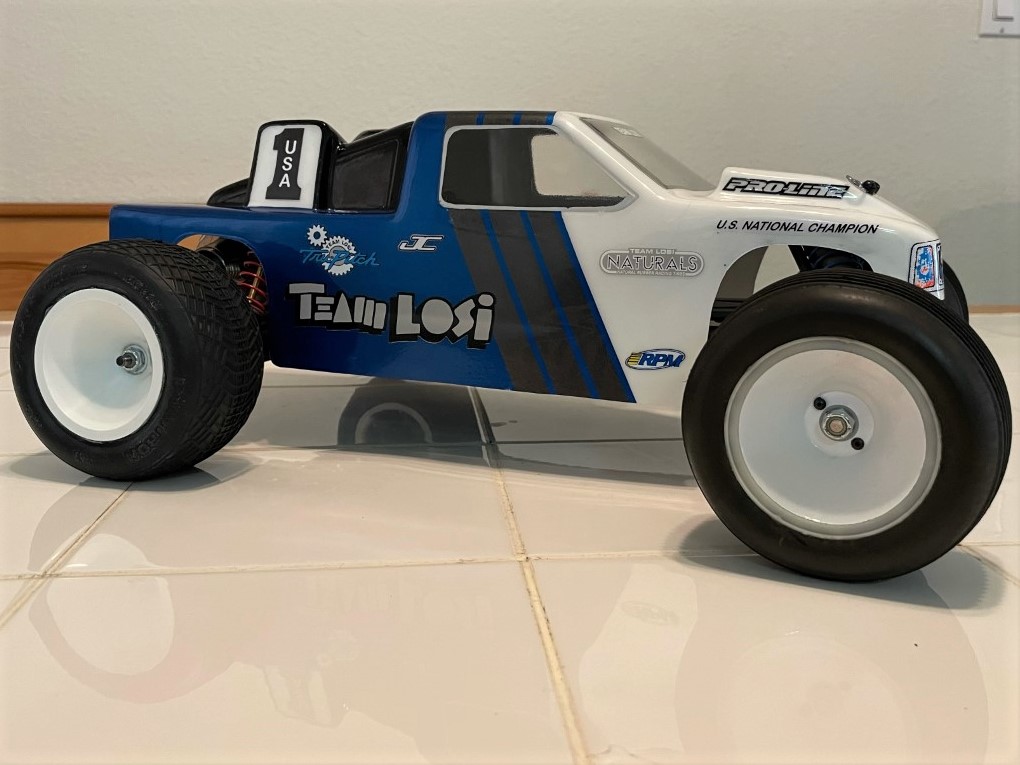

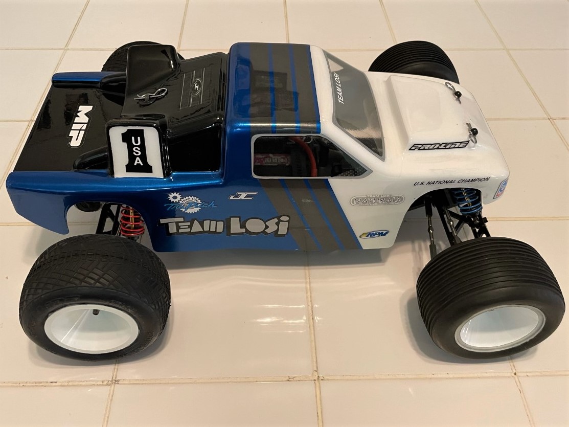

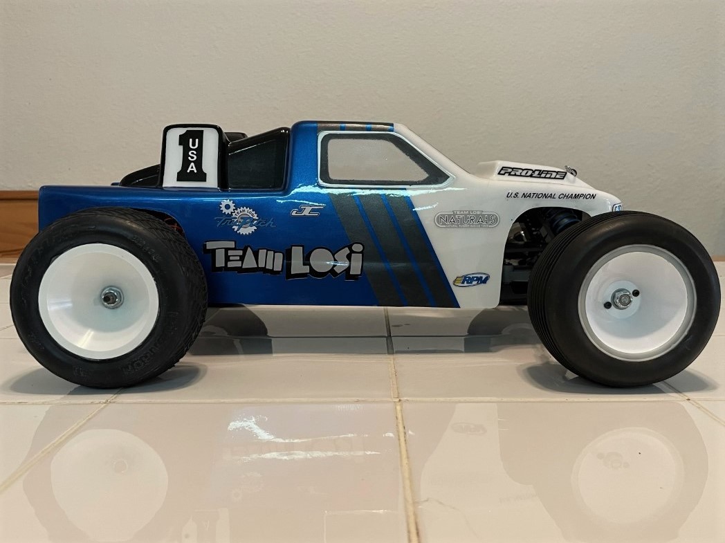

And, of course, lastly the body. I wanted a slightly modified version of a Pro-SE scheme with different colors. The gray in the stripes & the bed accents came out a bit darker than I wanted, but live & learn. Just an excuse to get TBG body & try again later.
- FlyingTigerDad
- Regular Member
- Posts: 16
- Joined: Fri Aug 20, 2021 10:25 am
- Been thanked: 19 times
Oh, and I almost forgot... MCI racing provided a custom colored decal sheet that I used to go with my choice of body colors. This also allowed me to keep the original sheet intact. I substituted the yellow accents for blue & the pink accents for gray.

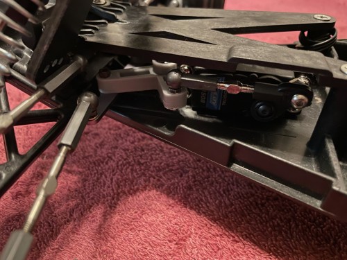

It's been an interesting few months since my last post with this truck. I took it out to my local home track, Hot Rod Hobbies, for its first initial shakedown run within weeks of posting pictures of the (more or less) finished truck. That didn't go so well & certainly not as I envisioned, or would have liked. After only 2 laps around the truck seemed to be handling pretty well, with the exception of being a little too sensitive in the steering down the straight. At the end of the second lap, it drifted a little wide on the straight coming into the big sweeper, and proceeded to just barely graze the outer retaining wall with the right front wheel. Well, apparently, that was enough to do some major damage. The front bulkhead broke where the inner front arm hinge pin goes through, which allowed the arm to get pulled back enough for the lower shock eyelet to get pulled on and broken as well. Needless to say, my day was done before I even really got started.
I went home, disassembled the front end, assessed the damage and took stock of what I needed to replace. I had another shock eyelet in my spares, but not the correct front bulkhead, so I decided to order a strong looking 3D printed one for a replacement (actually ordered 2, just to have an extra). Not satisfied with just that, I also ordered a Factory Works front hinge pin brace with the hopes of eliminating the possibility of that type of damage from ever happening again. Factory Works specifies that the inner hinge pins need to be replaced with slightly longer ones when using their brace - going from stock of 1.6" to a minimum of 1.7". I went looking for these, but could only find some TiNi coated ones that were 1.9" long. So I got these & figures I'd use some spacers if needed to take up the extra length, which I wound up using a few o'rings to accomplish this & keep it a little flexible as well. You can see what I'm talking about here...
I also moved the top of the front shock mounting position back to the factory setting - I had it one hole out from there, but as the manual stated, steering was just too sensitive on the straight.

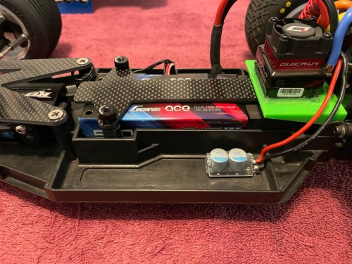

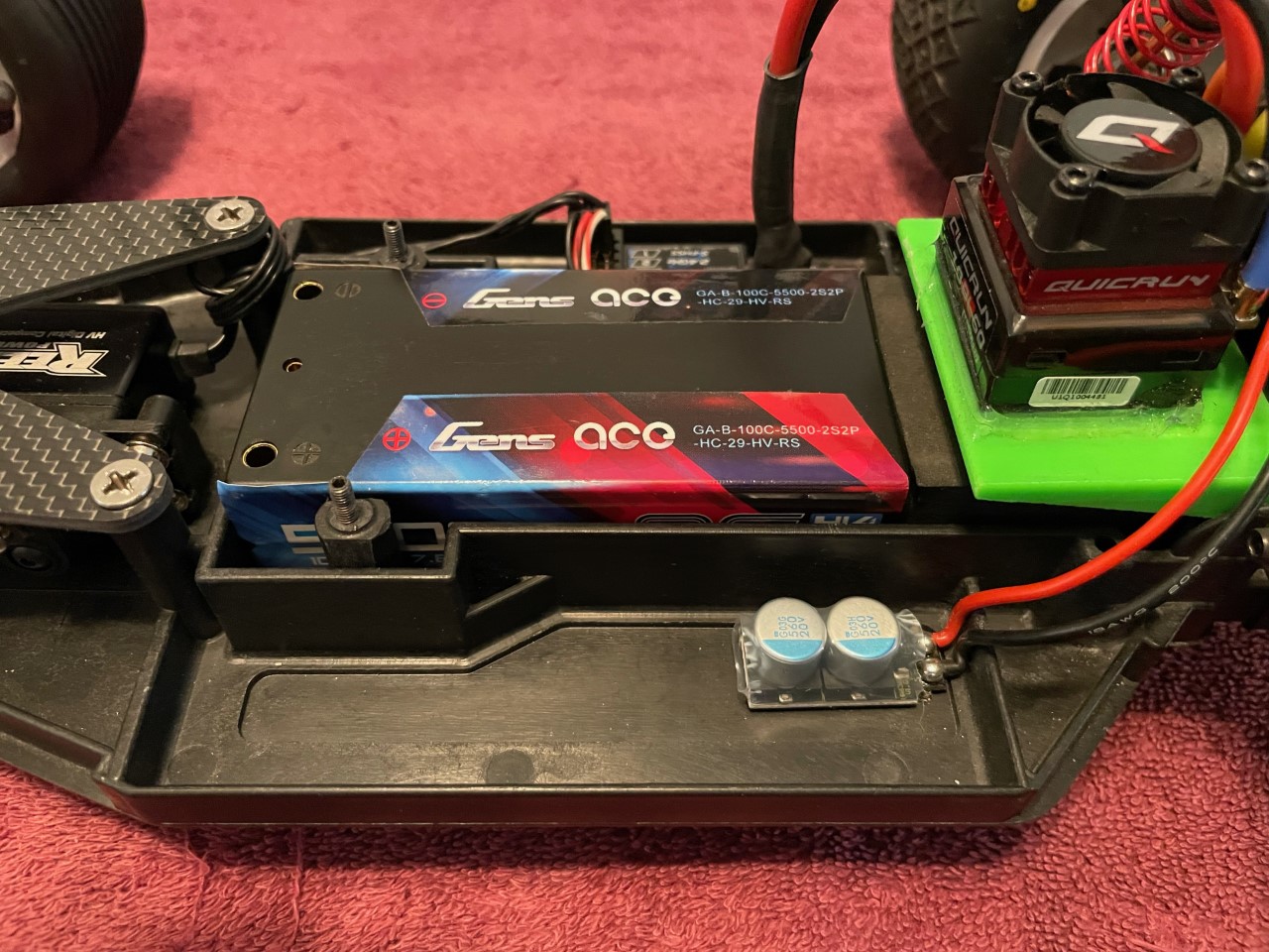

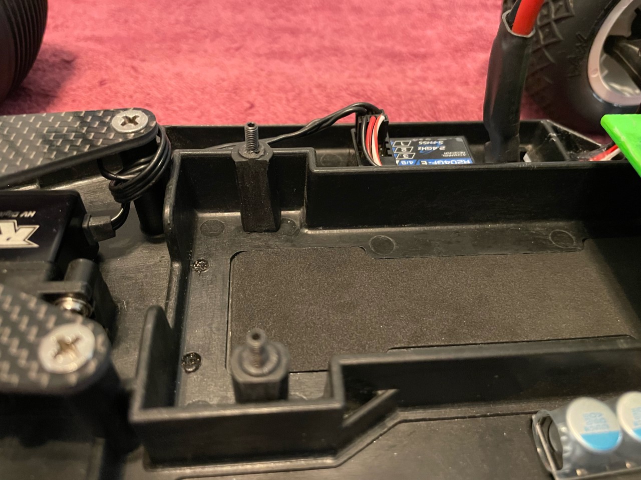

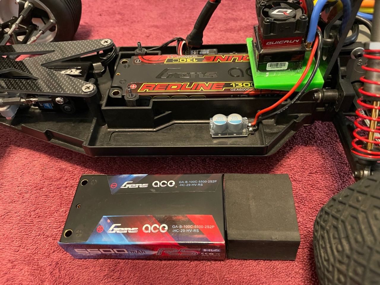

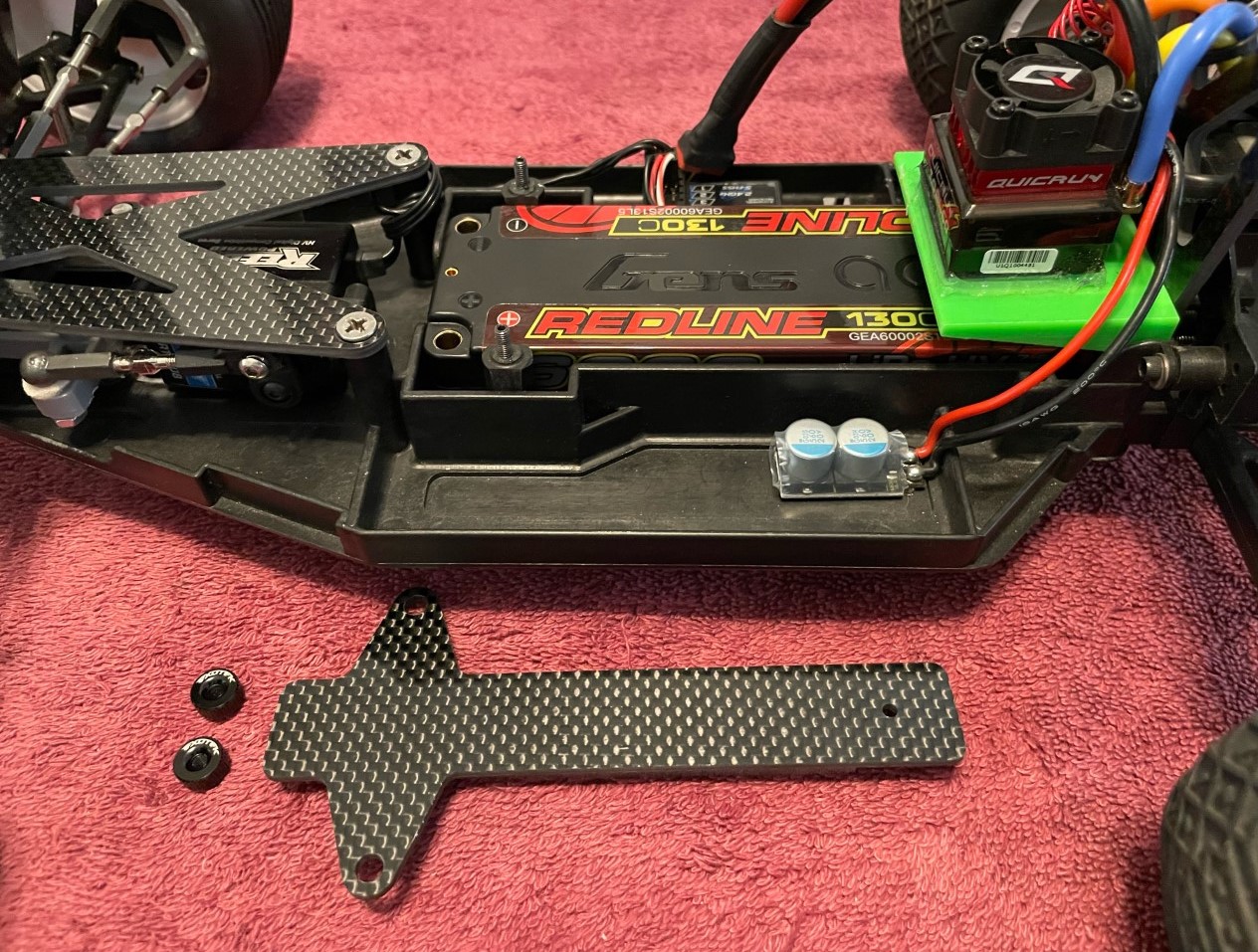

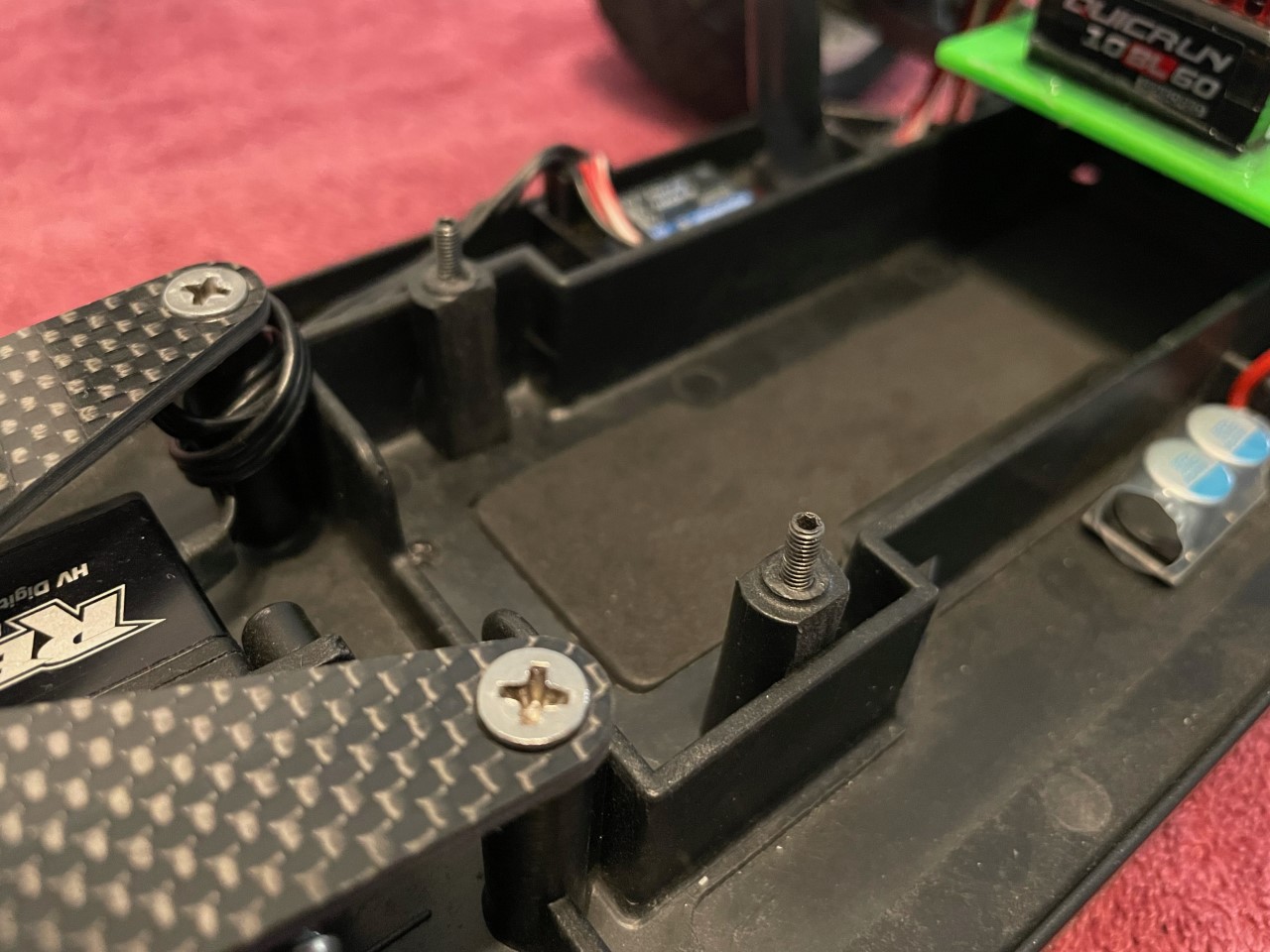

One more thing that I've wanted to address is the fact that with the current battery retention method, it can only accommodate full sized battery packs. Shorty's will fit fine, but they have nothing to hold them in the back & keep them from falling out. I could have used the Vintage RC setup, but it seemed too involved, and wouldn't be easily adaptable to run both the standard 2S & the shorty's. I decided to fabricate something on my own, which I'm quite pleased with the outcome. I removed the factory Losi front battery mount and replaced it with 2 posts (modified Traxxas Slash body posts) that were dremeled to fit. I then used an Exotek battery thumb nut kit to mount two studs into the posts for the nuts to go on. Lastly, I used an Associated Factory Team carbon fiber (couldn't resist
) battery retaining plate from the T4 that I cut to the proper shape to fit for what I needed. Now, with this system, I can run both standard packs & shorty packs with only having to insert a foam block spacer for the shorty's.
