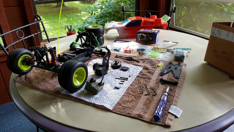

Success! As you can see the dawn bath scrub brush treatment worked wonders. Much tedious/Fun stuff remains.. rebuild transmission, diff, hydradrive, install electronics and rip wheelies!

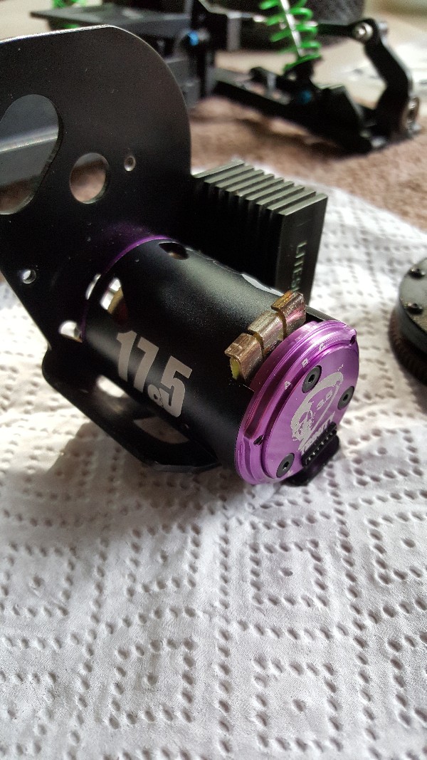

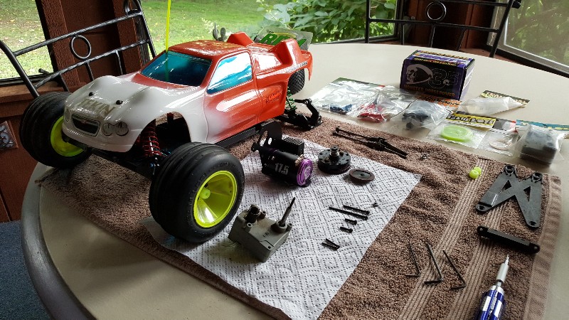

Picked up this gem for a song $35 NIB.. apparently they were de approved from ROAR for their windings being too thick.. the seller also had two sets of rear 2.2 tires which he bundled for an additional $30.

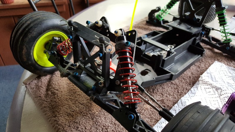

The rear shock tower took much fiddling as I had to dremmel off the head of one of the counter sunk screws which was stripped. I plan on cleaning up the look of the Hodge-podge body mount that was necessary to fit aftermarket bodies.

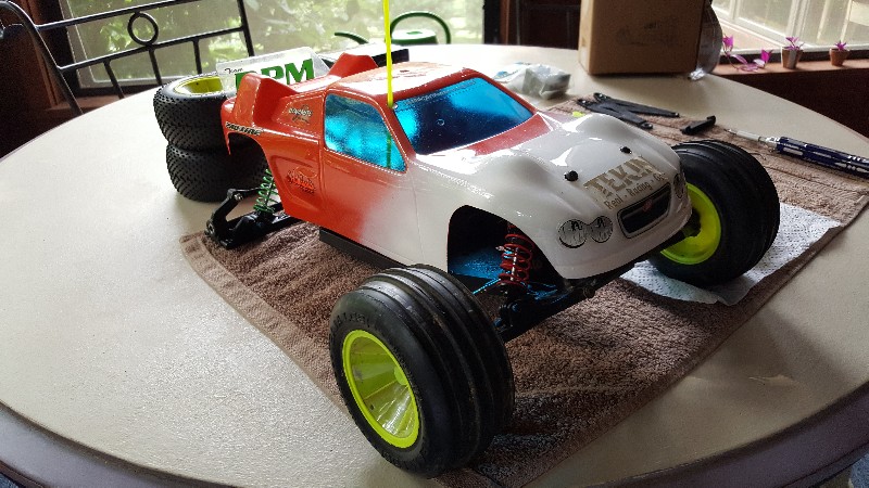

I must have sprayed this body just be for losing interest back in the day because it's never been on its lid. Wacky colors but... I like it! I'll probably snag a TGB factory body to use while displaying.

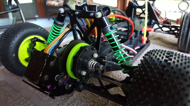

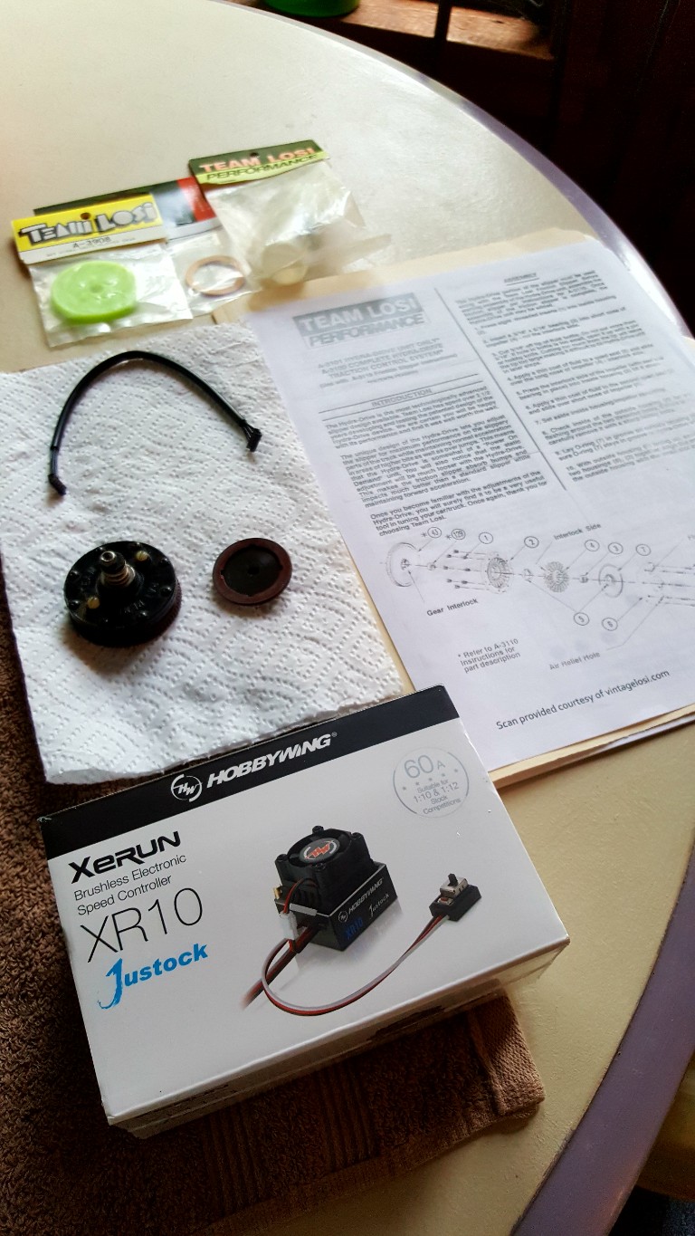

Some progress, shes a roller! Transmission rebuilt utilizing a new case as the old one was over tightened at some point and cracked the mounting holes. Still useable though, and I've learned me lesson regarding NOT throwing away serviceable parts... the diff was fiddly but pretty strait forward and now spins very nicely.
Question for those in the know why no grease on the three transmission gears? I couldn't find any reference to this in the manual and the old housing was bone dry. Does the plastic/metal gear teeth combo not require lubrication?

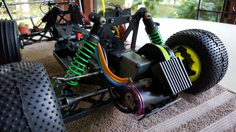

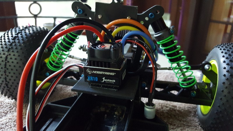

LOL! I had not noticed Mr. O.C.D. happy face. He is no more. Last night I mounted up the ESC, and soldered everything neatly-ish into place. Unfortunately the Speed Control was jussst to0 chubby to fit in the channels paralleling the battery tray. Which would have been great keeping COG low, so up it went high on the nicely made sabula mount.
Side note for running wires cleanly. I borrowed a trick from mountain biking inter-looping two wire-ties one one the left rear suspension brace and the other fed through that then around the three motor wires and sensor wire. This allows for height adjustment while not pinching anything at odd angles.

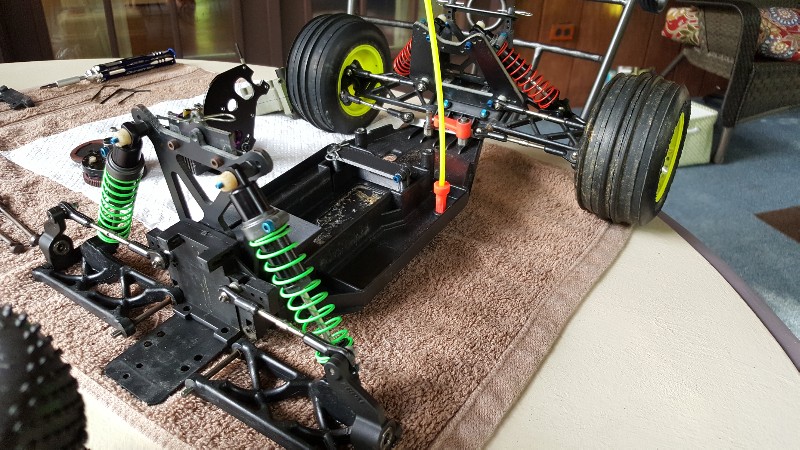

How things sit at the moment mocked up. Hydradrive could use new seals as they were pancaked pretty bad so I'll hold off until I come across a rebuild kit in my price range. If anyone has suggestions for mounting the capacitor cleanly I'm all ears.
