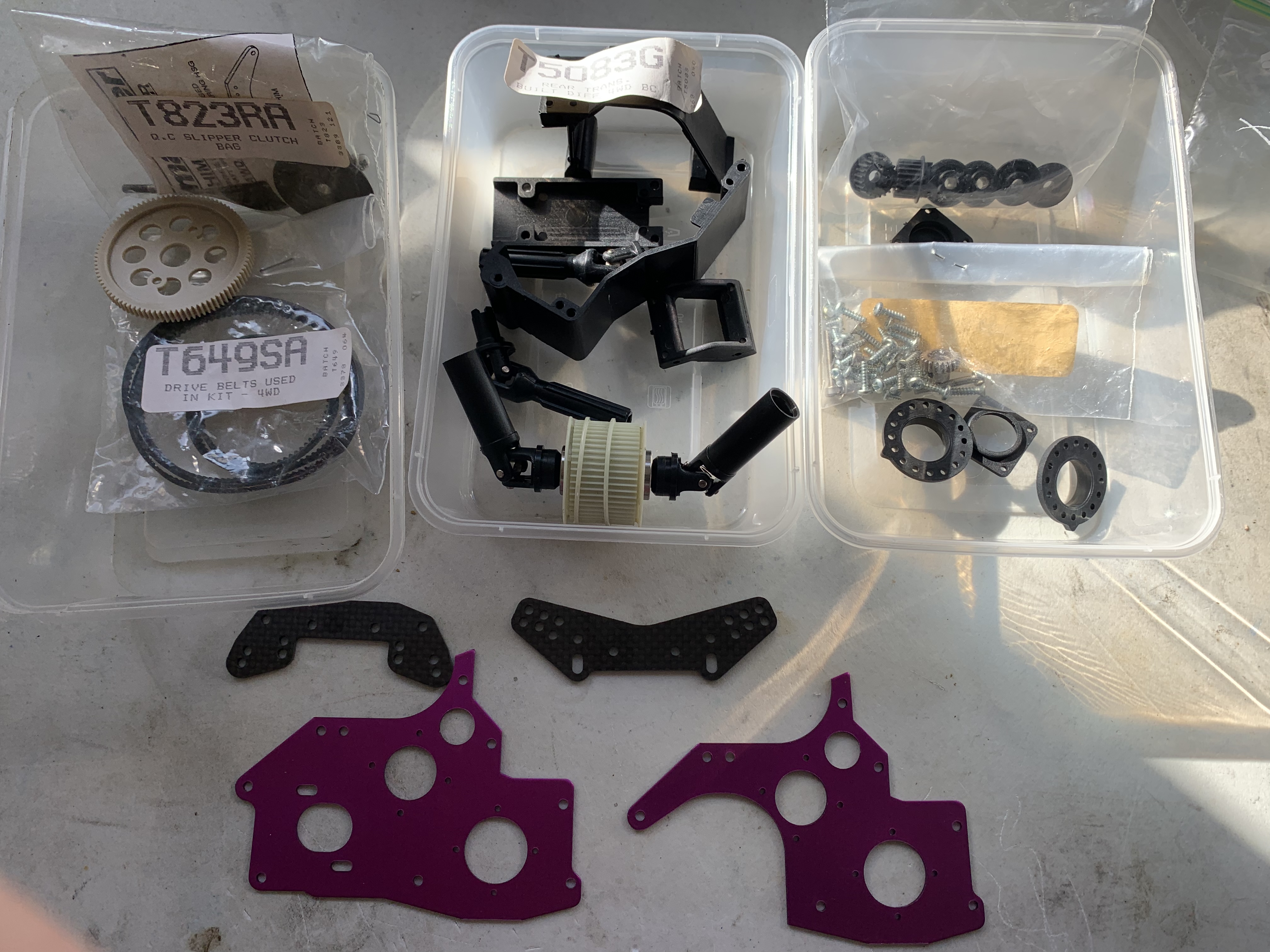

Well I’ve had this sitting on a shelf in a box for long enough.
Bought it a few years back but it was missing a main chassis battery straps and sticker set. I’ve picked up a fibrelite US Nats chassis and a few other bits to throw on it so here goes

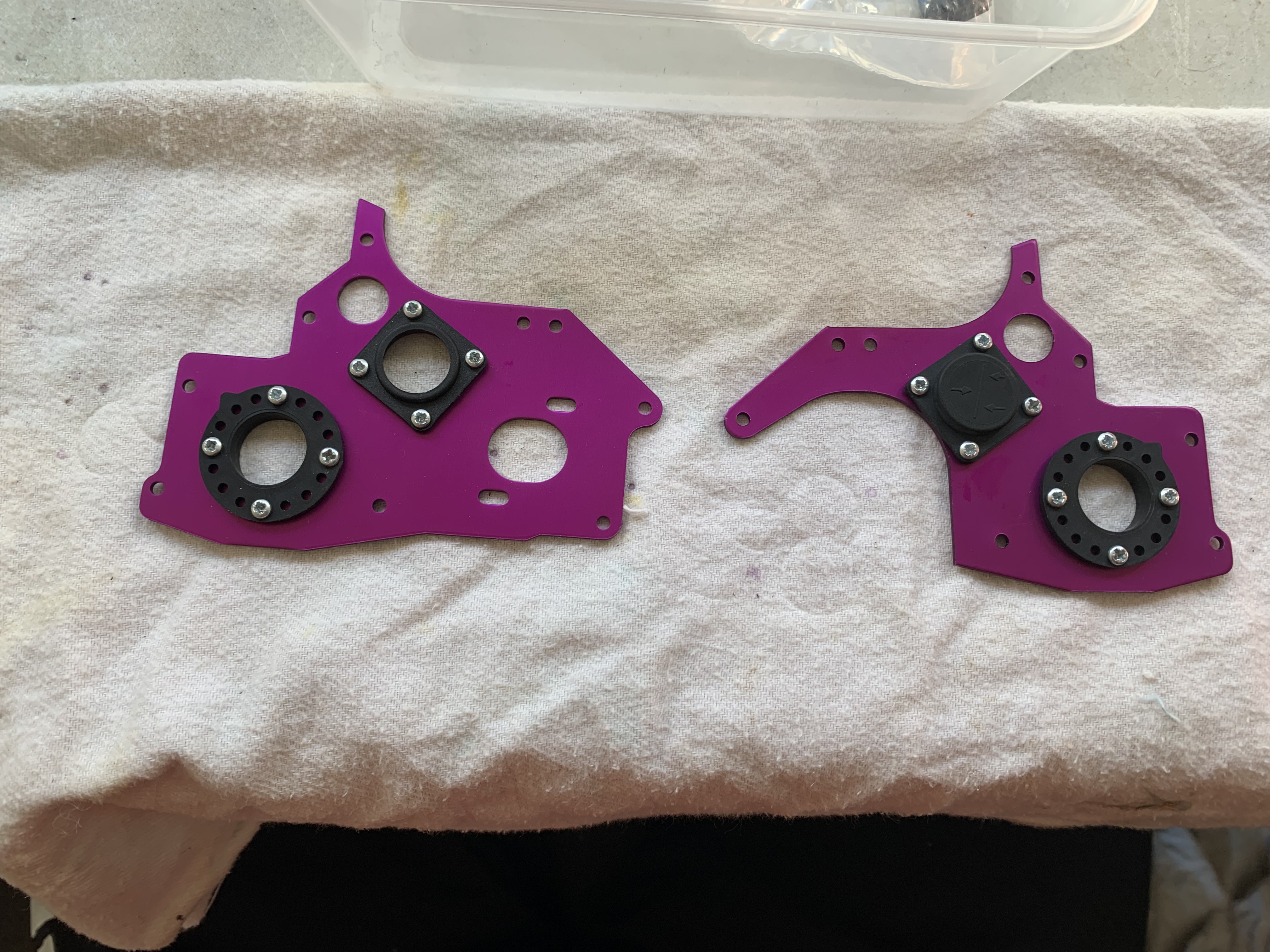

Side plates ready to go,
diffs come prebuilt on the works. Feels really smooth so I won’t bother pulling it apart just for the sake of it and the layshaft setup in these only takes a couple of seconds to do

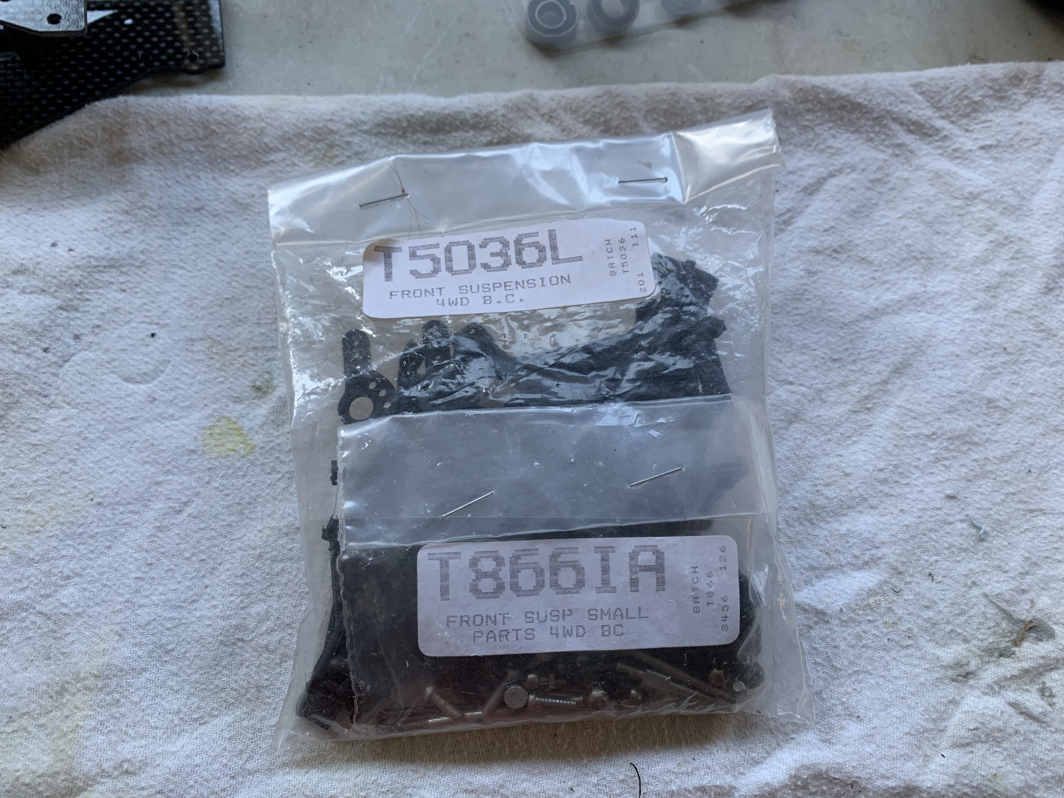

On to the chassis and front end next. Unfortunately I found my first problem …… can’t find the carbon centre track rod, I have a feeling I may have left it with a friend of mine that borrowed the carbon parts to create cutting files for them. Oh well guess I need to chase him up or order a new 1 from somewhere.

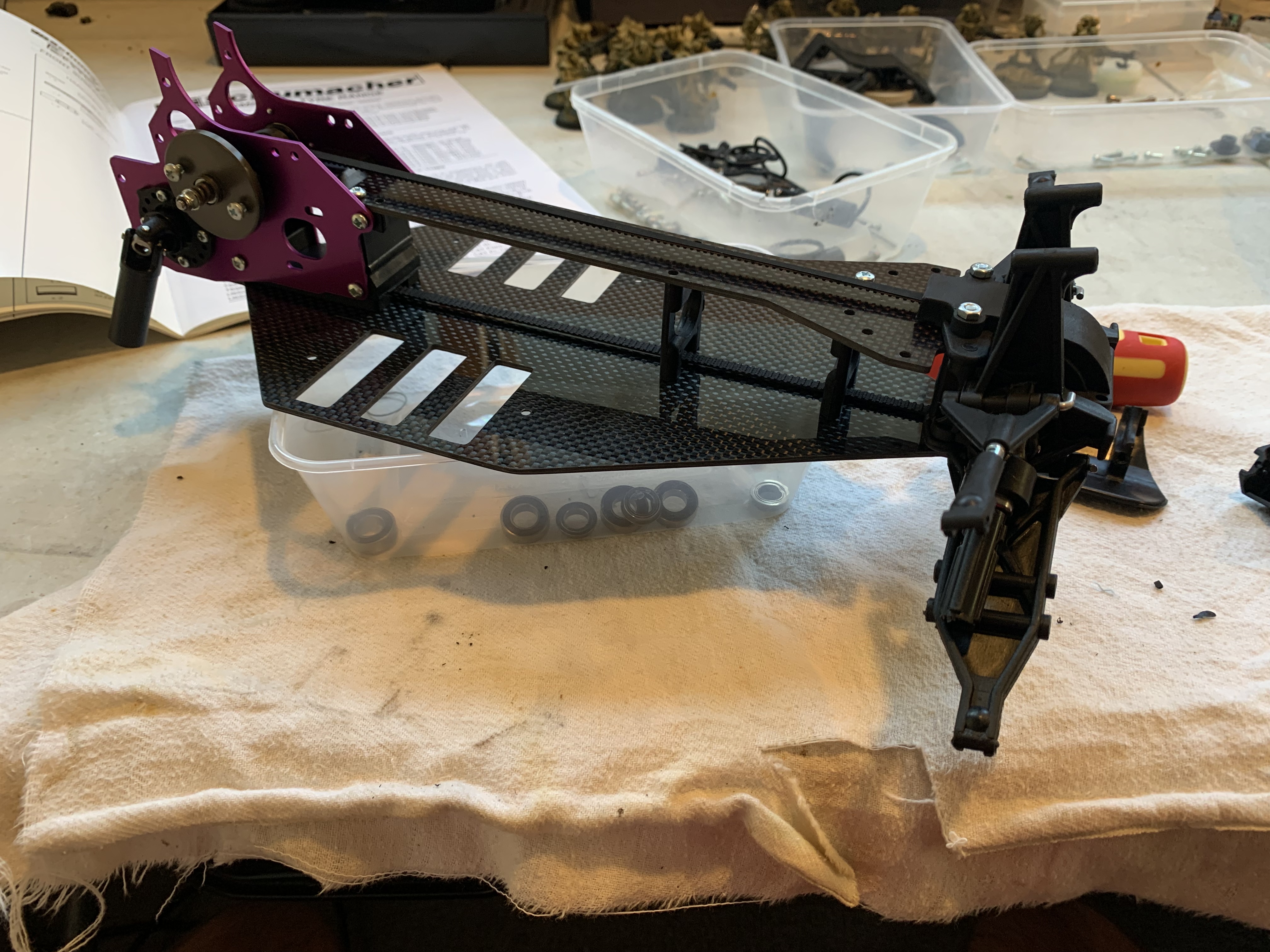

One thing with the works rear hub carriers is you definitely need to put the inner bearings into the bus before attaching the hubs to the arm, if you don’t they won’t go in passed the outer pivot pin
Rear suspension ready to go on-
