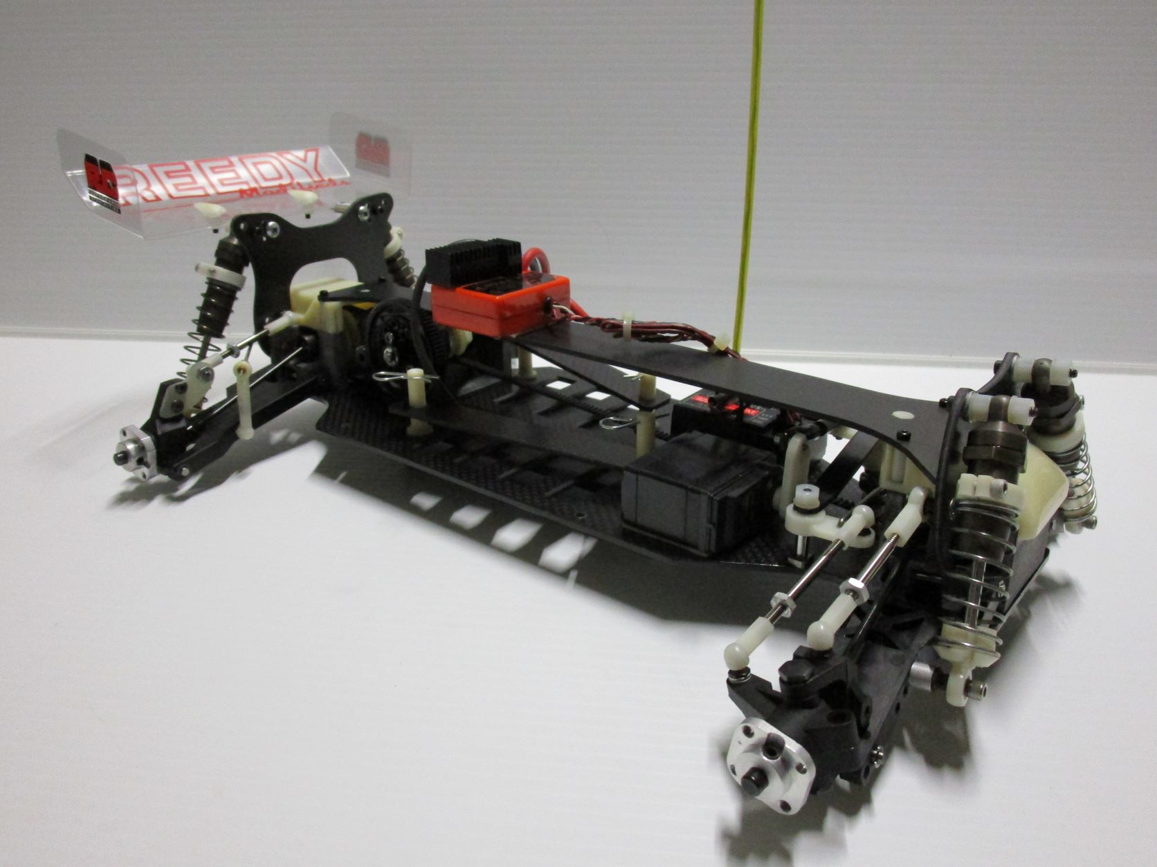

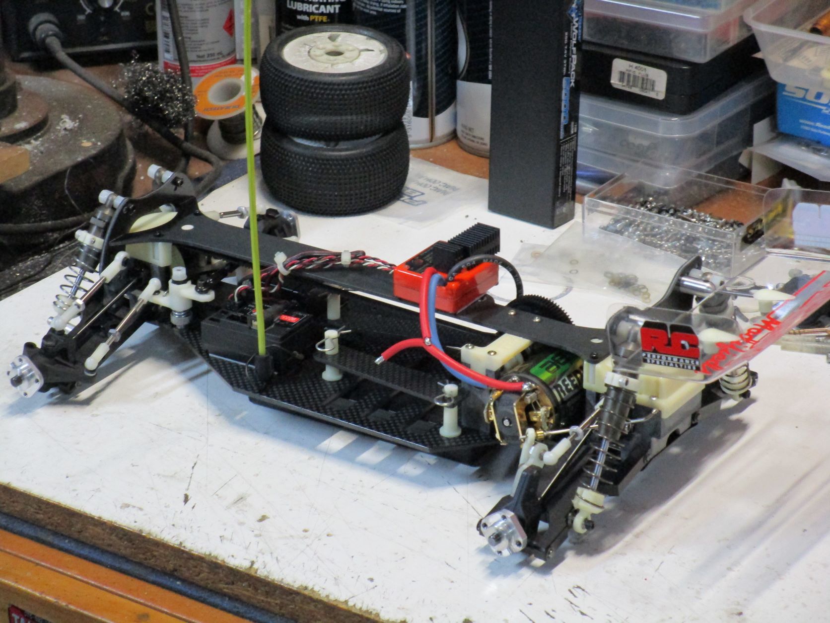

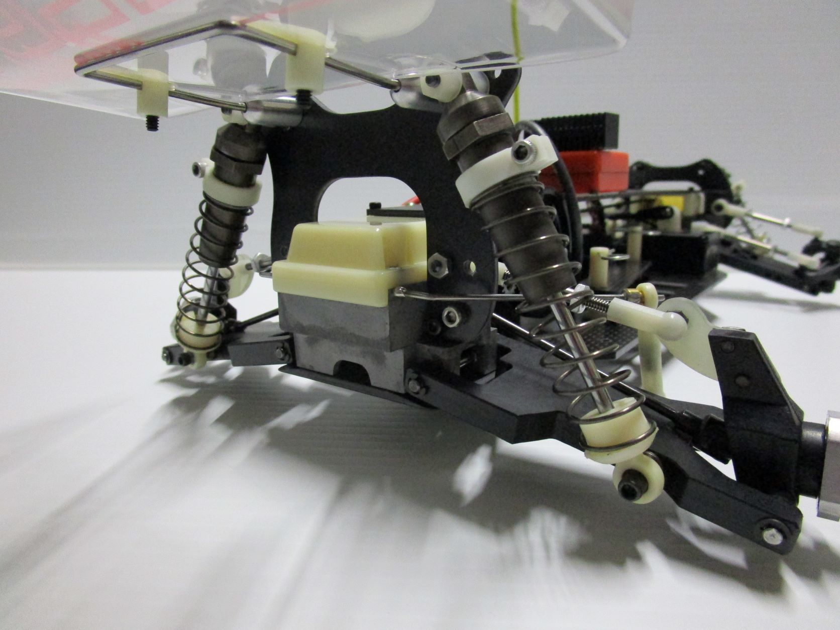

Wow cant believe how long this has been :| but small update have cut the battery plates and the 10L body posts for the battery postie thingies. Ignore the shocks they are just temporary .
Also made another rear tower as the camber link was abit off.
Cut a body so i think the forecast is for rain this w/end so that will work :D

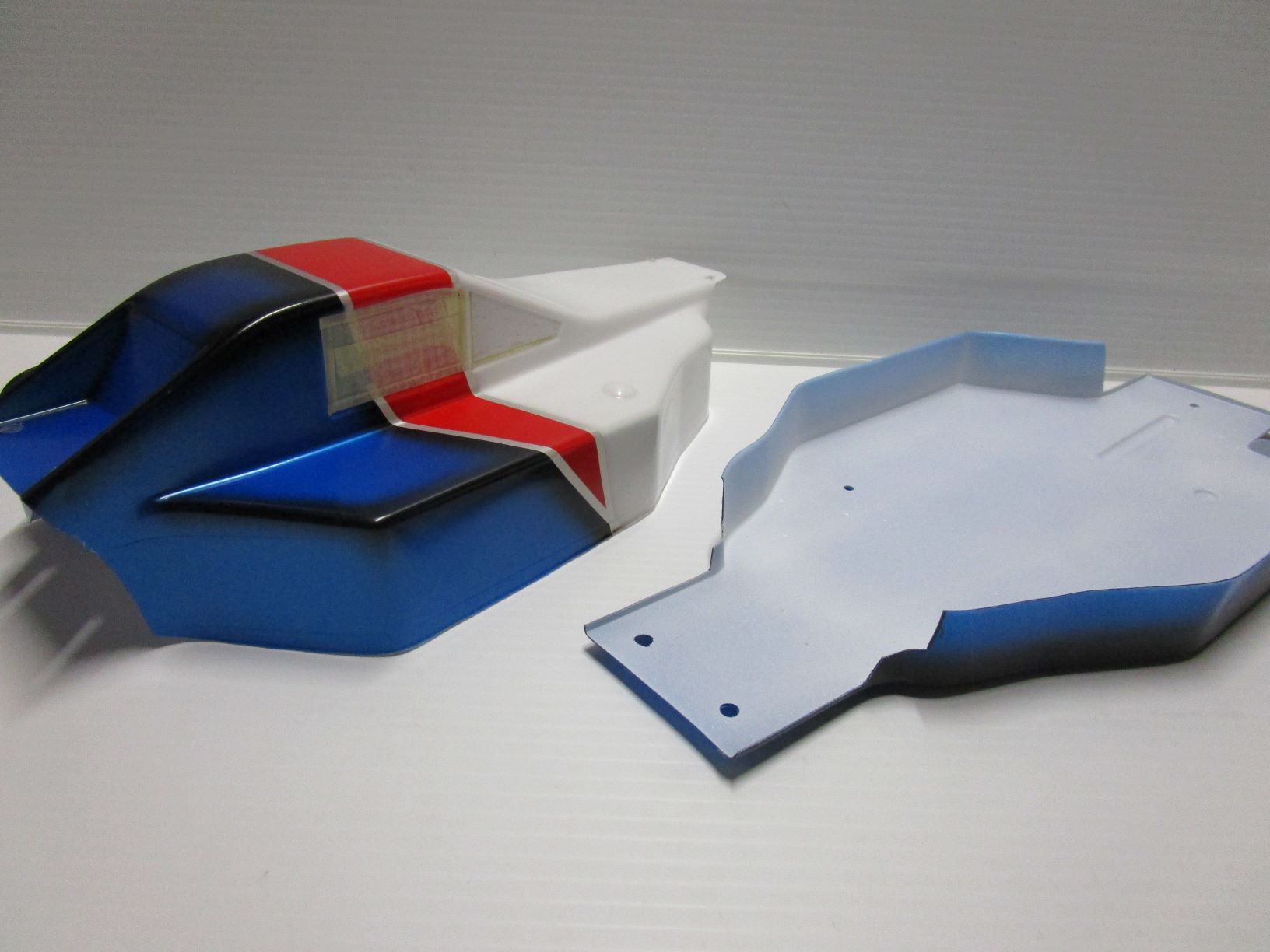

paint done

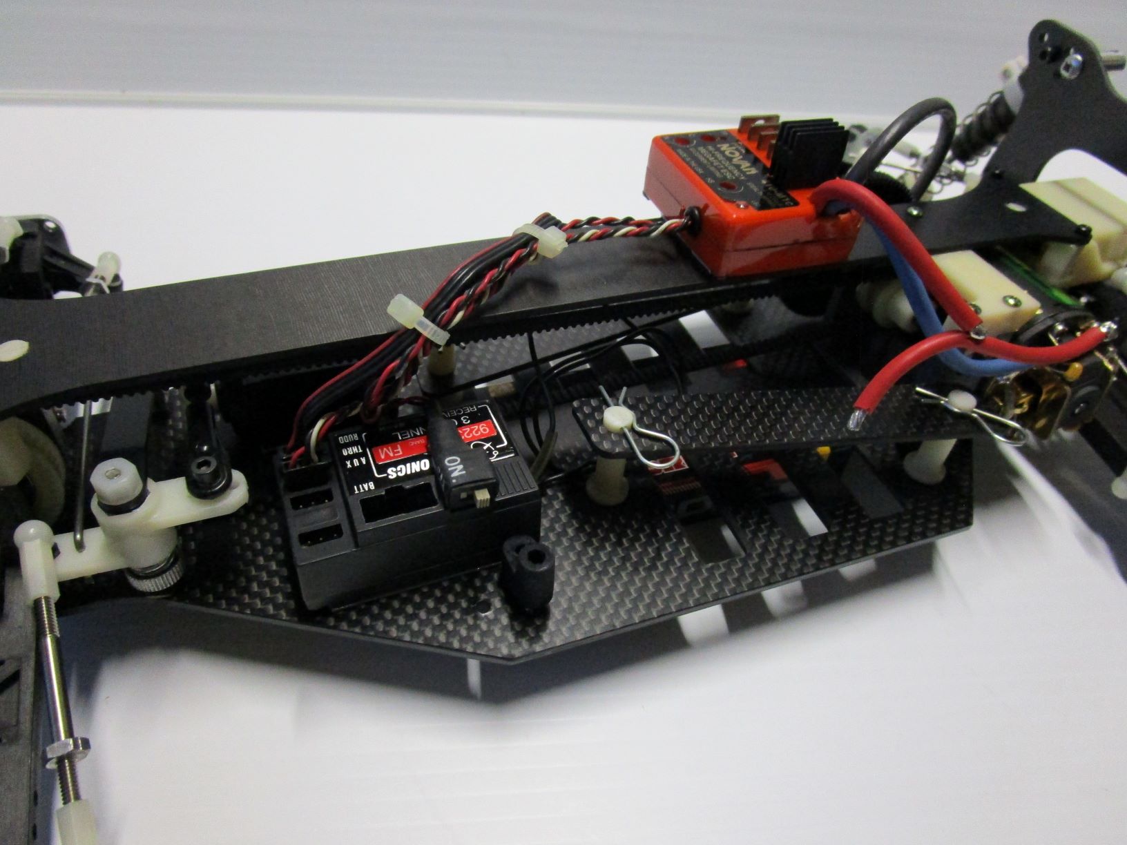

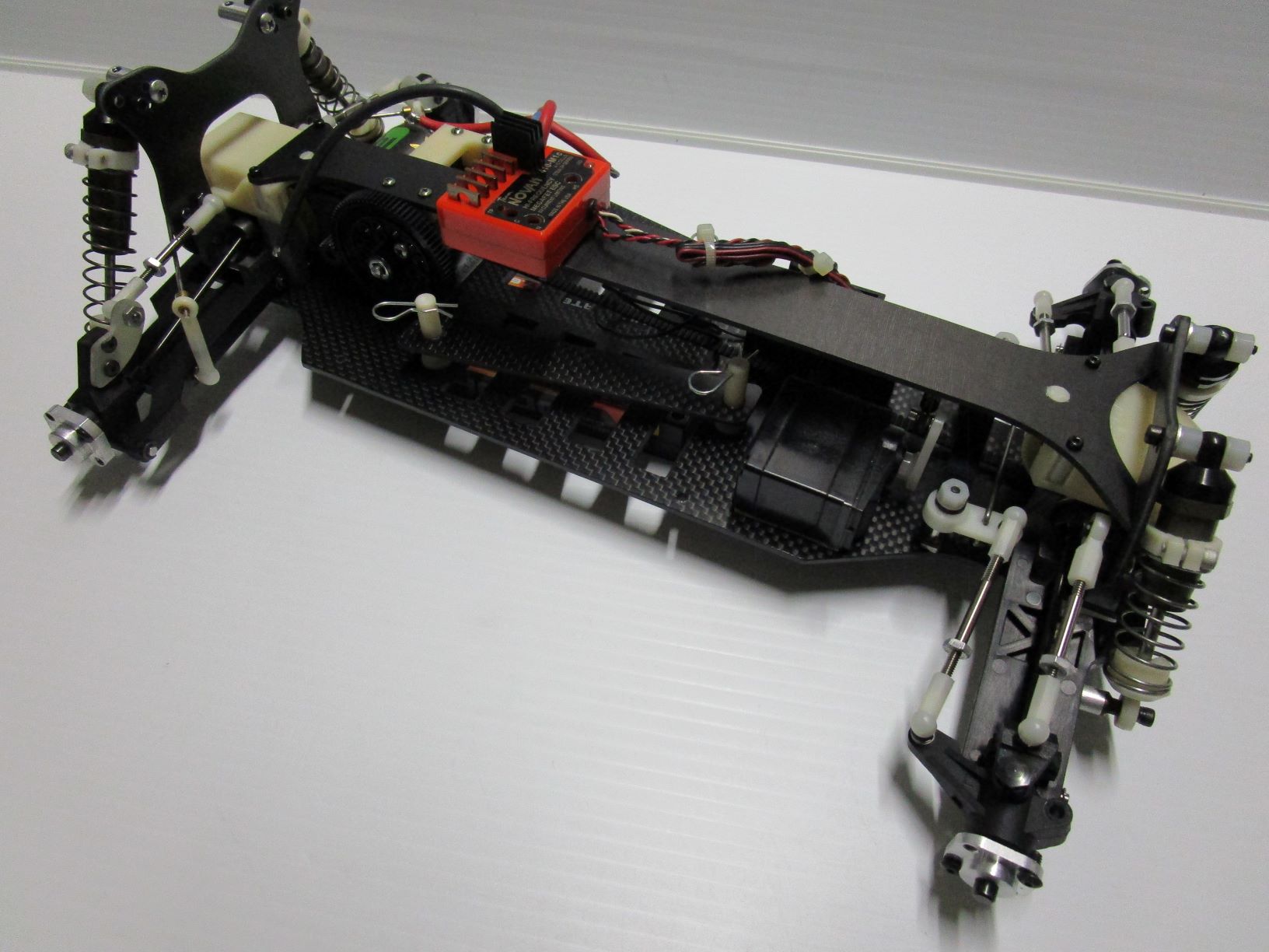

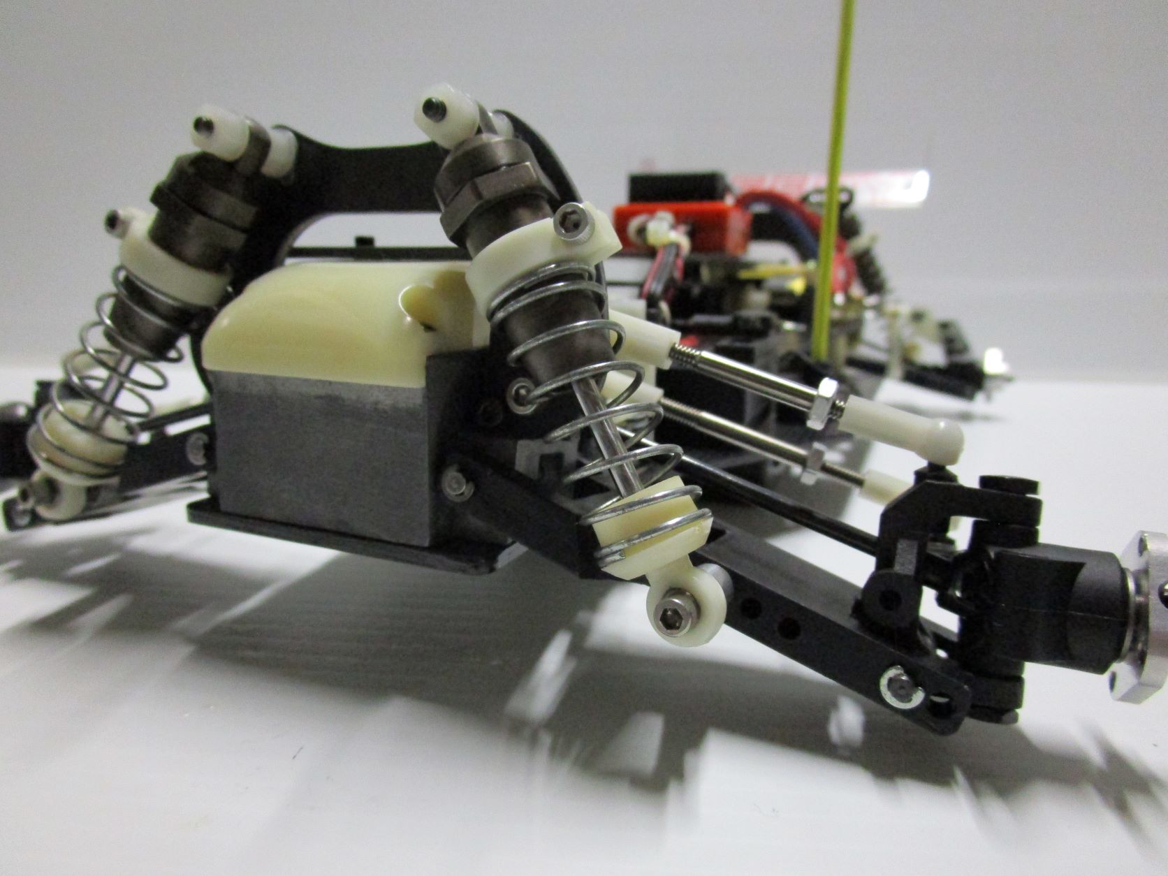

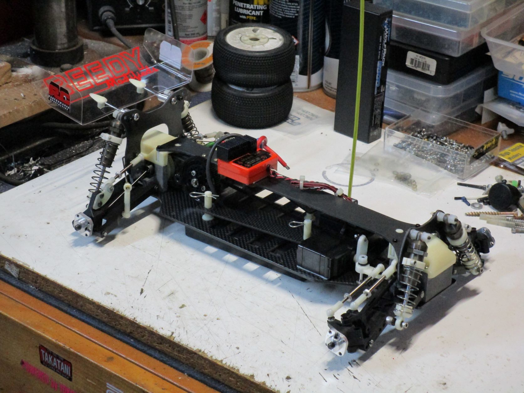

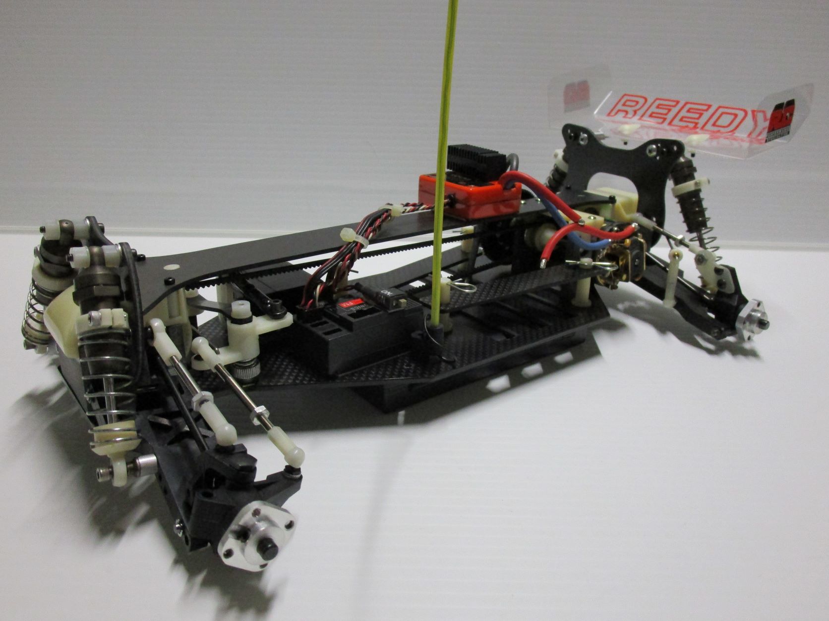

Few more pics
I think the chassis might be finished?
Only taken four years can i blame covid :D

Awesome build! Quick question on the rear arms as far as how much longer they are compared to stock rear arms?
pedro
Posts: 241
Joined: Thu Jun 12, 2008 4:24 am
Been thanked: 77 times
Re: Cliff Letts 1990 roar winning yz10
Post by pedro »
mikea96 wrote: Tue Oct 18, 2022 11:58 pm Awesome build! Quick question on the rear arms as far as how much longer they are compared to stock rear arms?
Just did some quick measuring looks like the stock ones are 63.5mm centre to centre and the ones i made are 74mm this was all just guess work but they seem to be about right.
