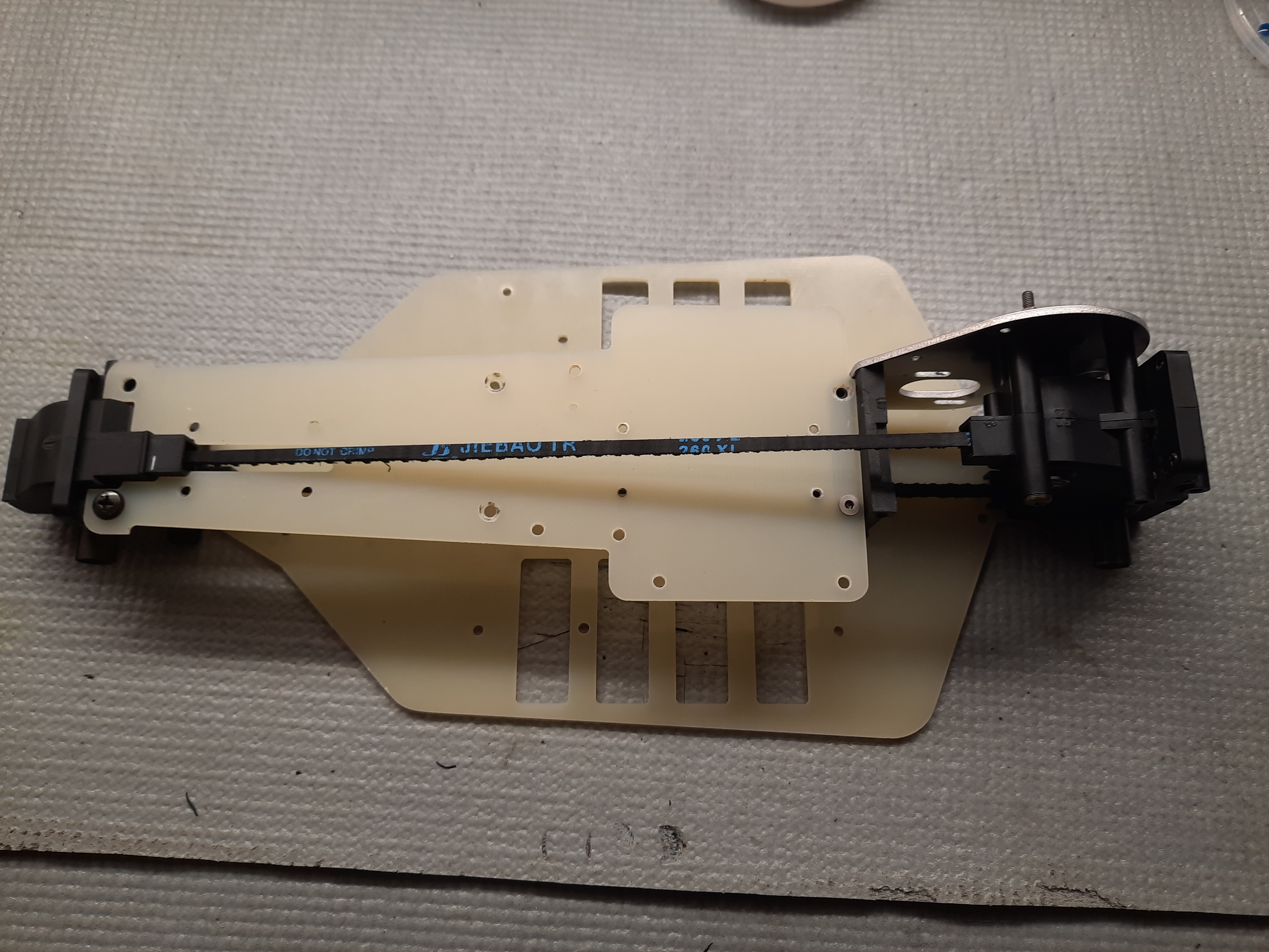

Next build is a Mid Optima with the JG (John Gudvangen) LWB conversion kit. The kit was available in both Fibreglass and Graphite. In 1989 the Fibreglass kit was $65 USD, the graphite kit was $129. The chassis is 25.4mm (1 inch) longer than the SWB chassis, with the regular Kyosho LWB chassis being 18mm longer then the SWB.
With the top plate being wider for mounting electrics, JG offered a "Midi" shell with a wider cab. I bought the kit used. The belt that was included was a 254XL, which is for the 18mm longer chassis. I sourced a 260XL belt which I had to cut down to 3mm width. This belt seems to have the correct tension. Longer belt covers were also needed.

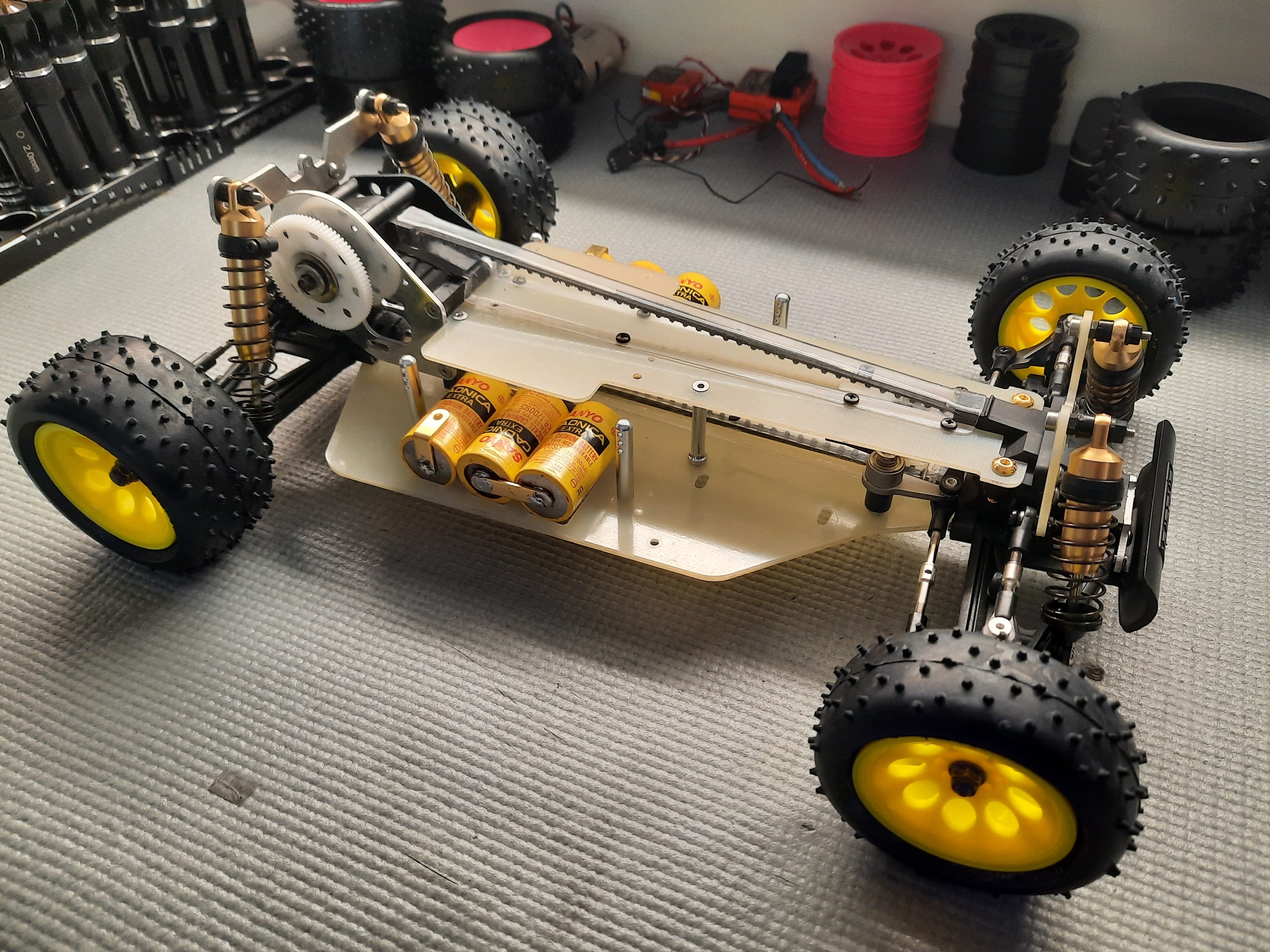

Mocked up gearboxes, belt and modified MK11 Stinger alloy bellcranks.
I've ordered some 5x10x4mm flanged bearings for the bellcranks.

Just used some calipers and a X-acto knife. I ran the calipers along the belt and scored a slight groove for the knife to follow.

Fitted the Stinger MKII alloy bellcranks. Went on with some minor modifications - trimmed the servo arm, flanged bearings, and an inner bearing spacer on top of the bellcrank posts.
I managed to get both front and rear JG shock towers NIP. The turnbuckles are Q-World, they aren't vintage but they look okay, rears in transit. A vintage spur adaptor has been used to fit a RR 48dp spur. I'll need to make some battery hold down straps for the alloy posts. The belt covers are from the JG kit, which are longer than anything made today.

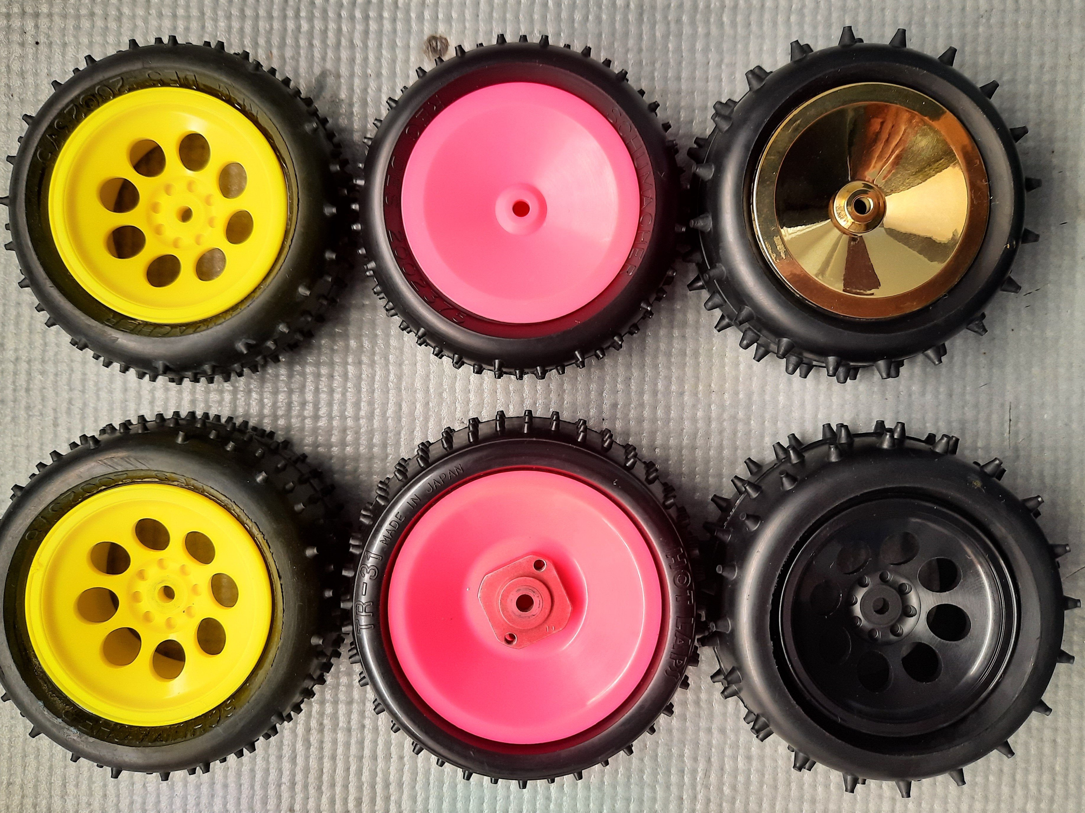

Don't know about wheels and tires, I have a selection to choose from. I have some adaptors to mount Yokomo rims and some new TR31 tires. However, these tires may be too late for this build era (for a club racer) and I think there's something wrong with using Yokomo parts on a Kyosho?

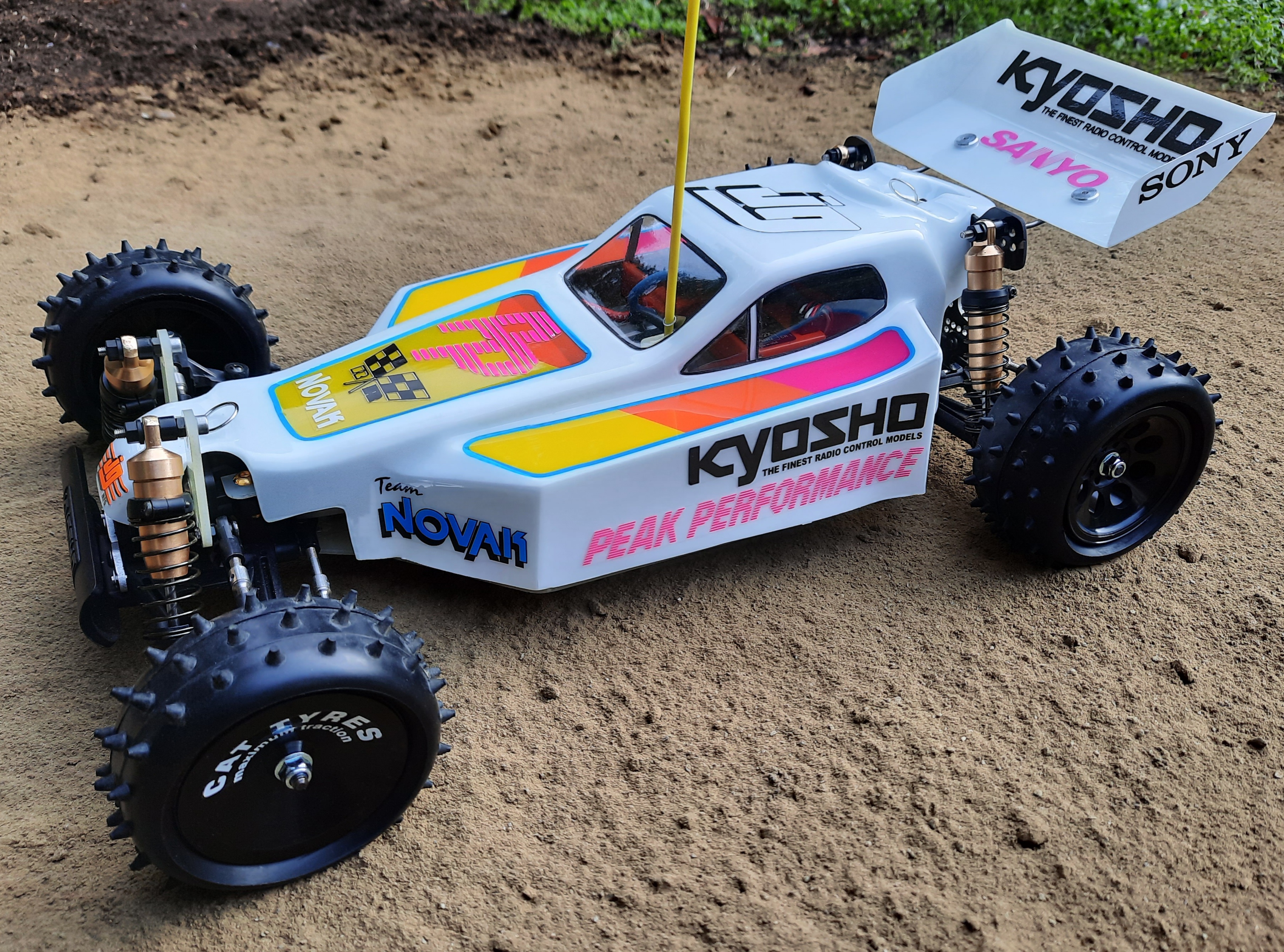

Super Rad Homz. U have a BOTY contender i expect it to be entered before december. no exceptions!
