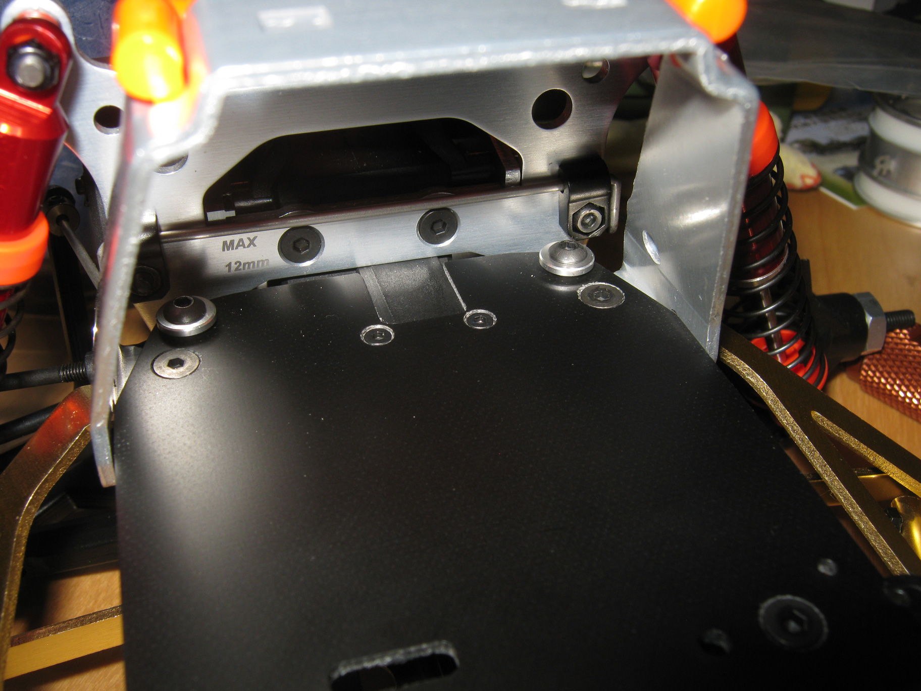

First I attached the lower tray:
Getting this to click into place took way too much force, I had to resort to pliers to push the last bit into place, as I could not exercise enough force by hand. The problem are the countersunk holes at the rear plus the part being a very tight fit in general.

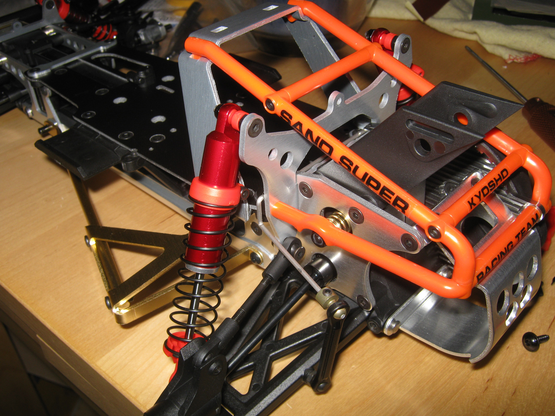

Parts needed for the front when using universals (note: universal spacer shown in wrong location, see later):
Assembled front end:
But!
The universals come with a spacer. According to Kyosho, on the Optima and Javelin (but not Turbo Optima) this spacer should be placed on the outside of the uprights. This results in the problem shown above, the inner part of the universal does not go into the diff outdrive far enough.
The same problem exists at the rear:
So instead of what Kyosho says in their instructions, put the spacer on the inside of the uprights, like for the Turbo Optima.

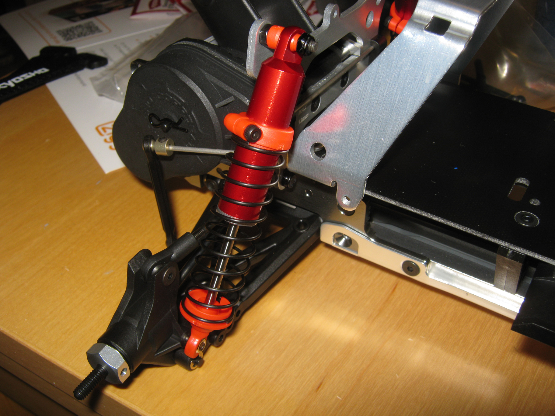

I then finished the assembly of the shocks:
More issues here, the lower spring perch doesn't fit onto the eyelet properly unless you spread it out with some pliers while putting it in place. I also hope the upper spring perches won't suffer the same fate as on the vintage shocks, where they often end up splitting.
Attached to the car:

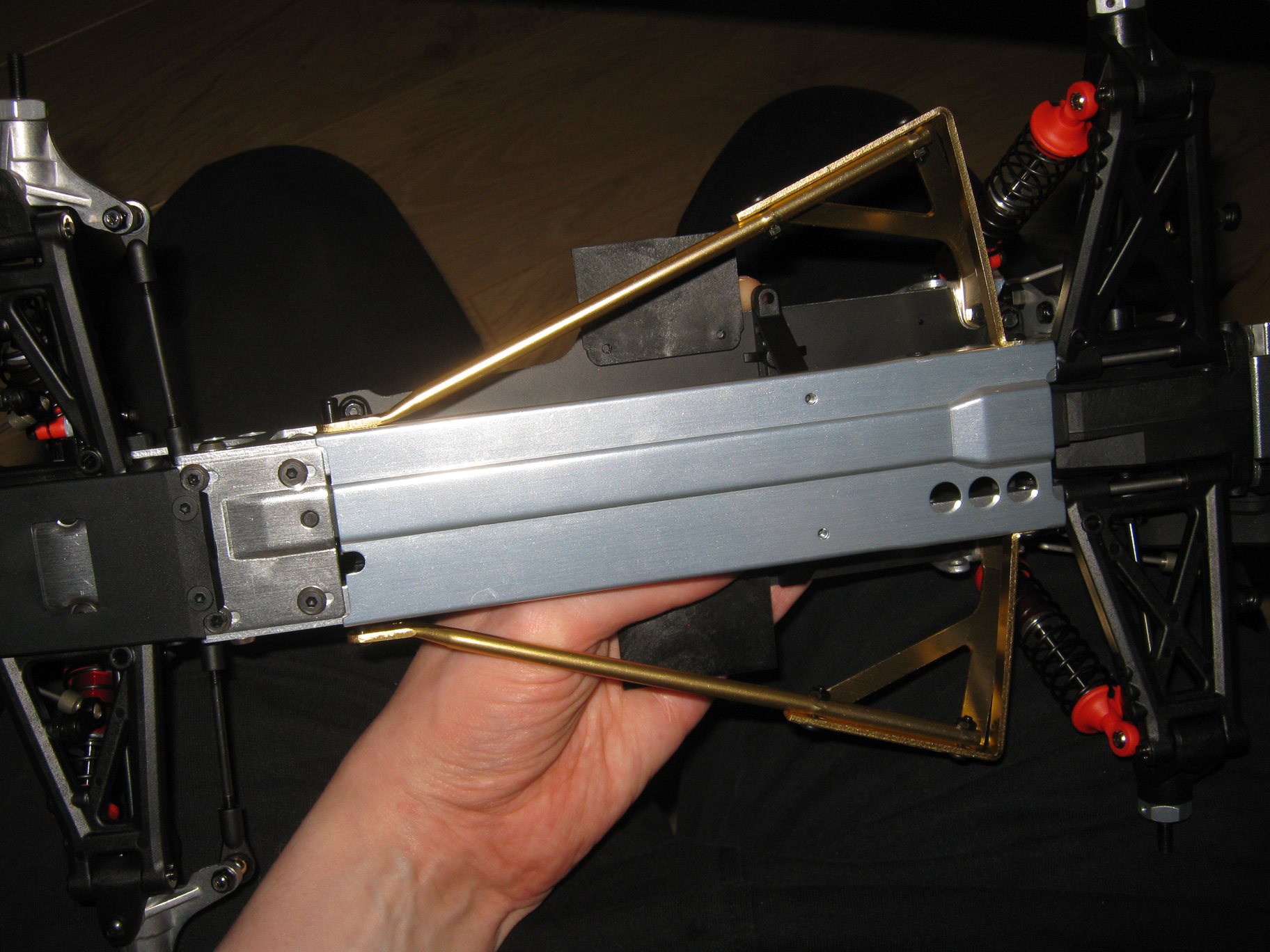

I then added the alloy side guards:
