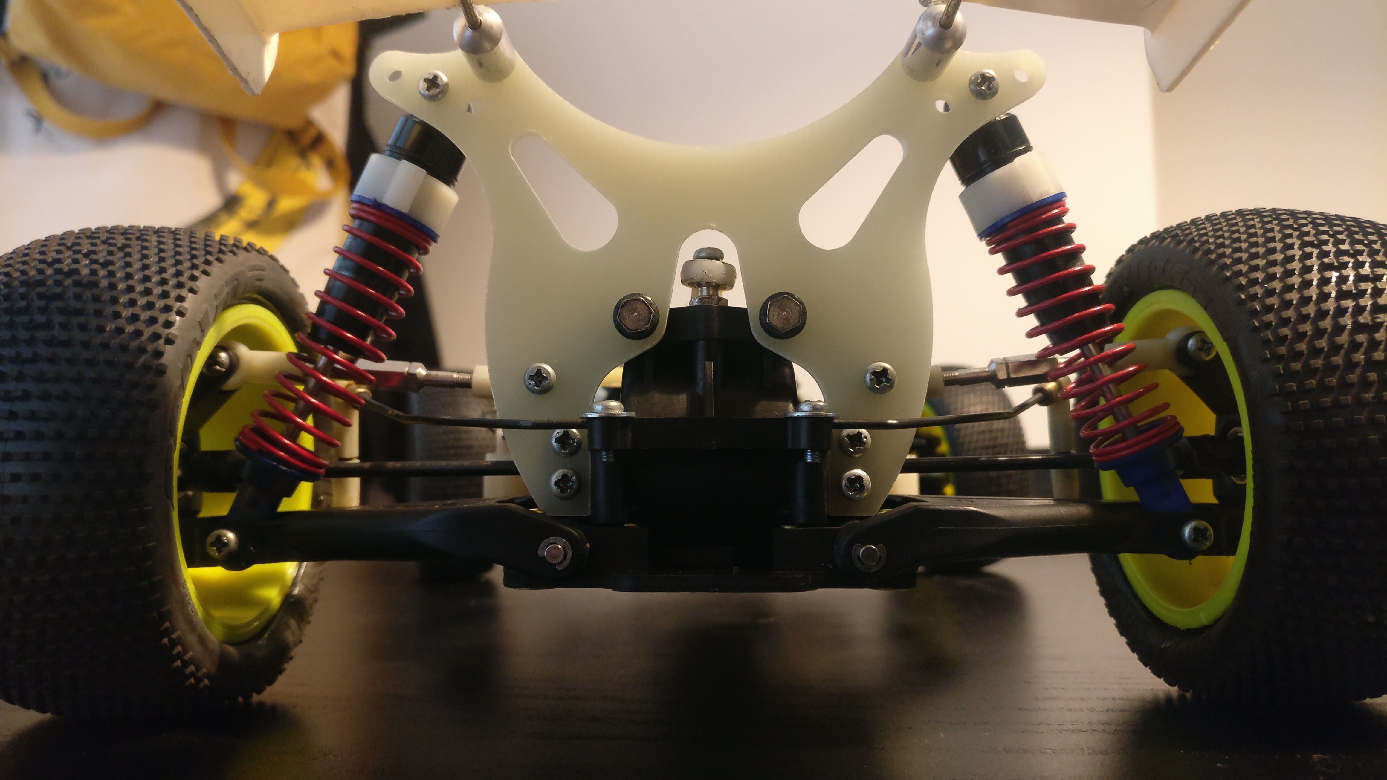

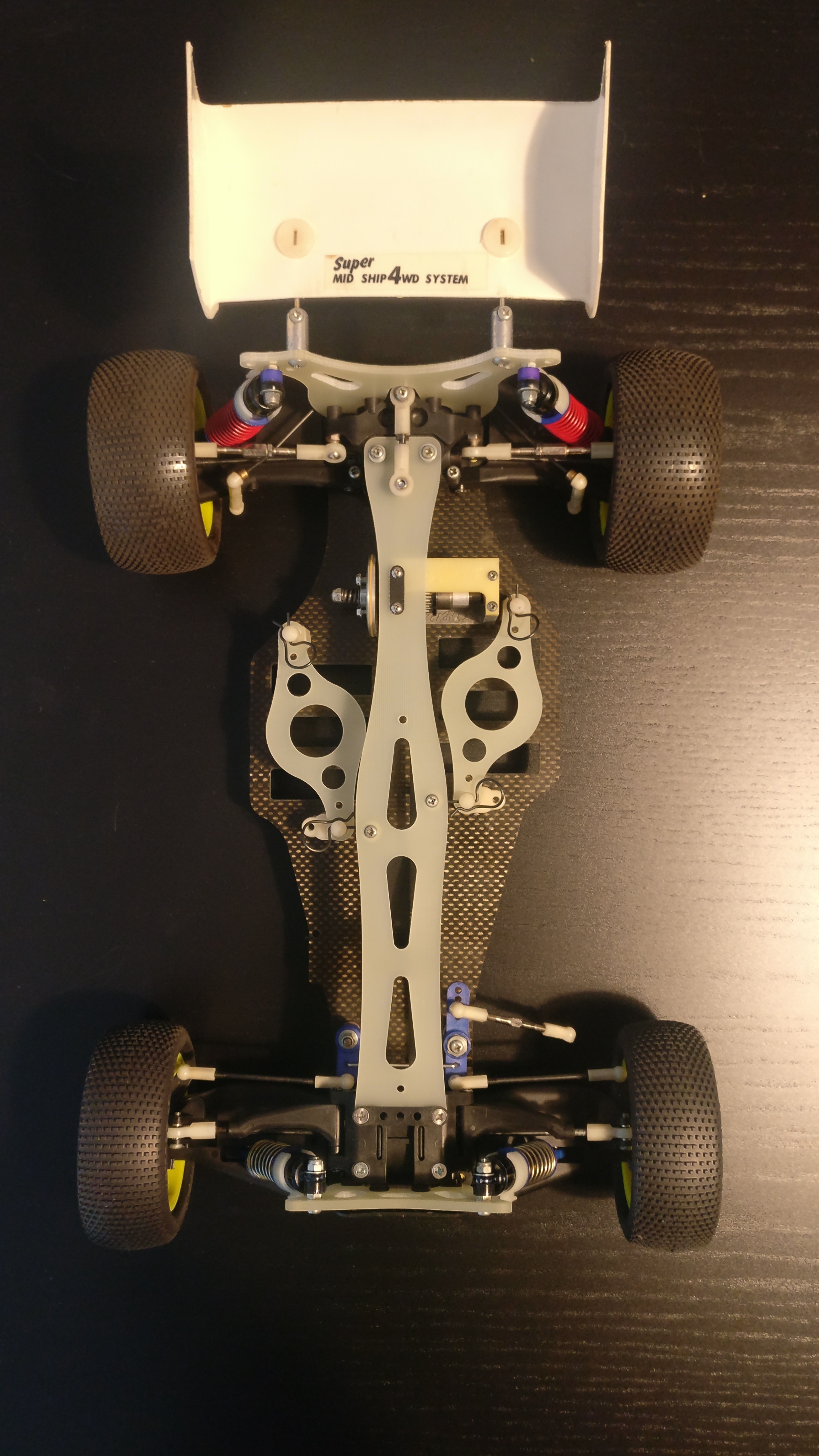

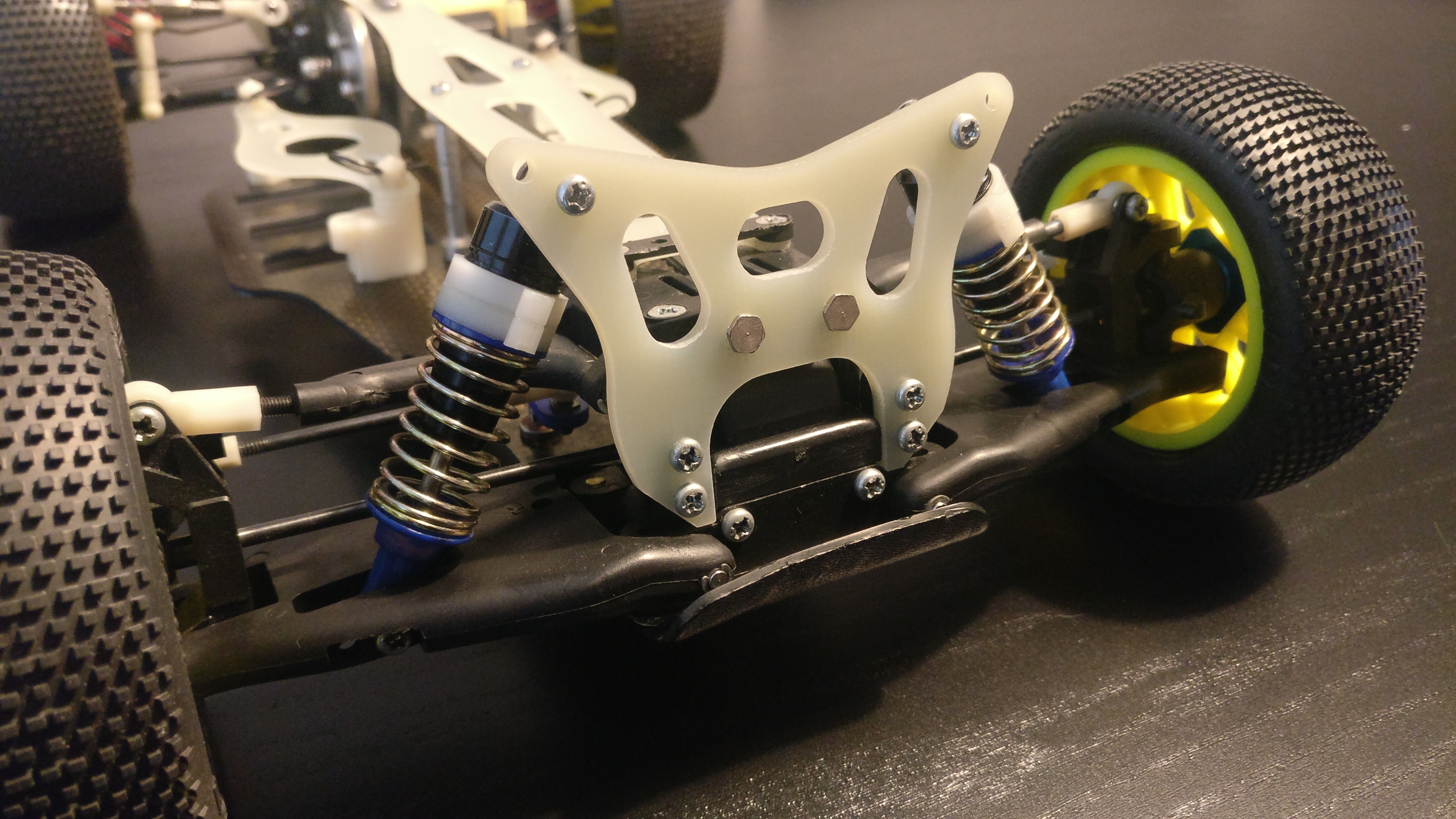

As look would have it, after I posted this a few days later a nice YZ10 was posted on the local classifieds and I picked it up for a nice price.
I think it looks like a YZ10 Super Dog Figther from 1994.
It seems to be in very very good condition.
Can you help me confirm what it actualy is?
Thank you!
Thank you!

Possibly a 93 wcs or 94. Anyway my dream yokomo.goncalopimenta wrote: ↑Thu Nov 03, 2022 10:54 am hey Ryan,
Thank you!

Yep looks like a 94 with the TCS fitted not a 93 WCS

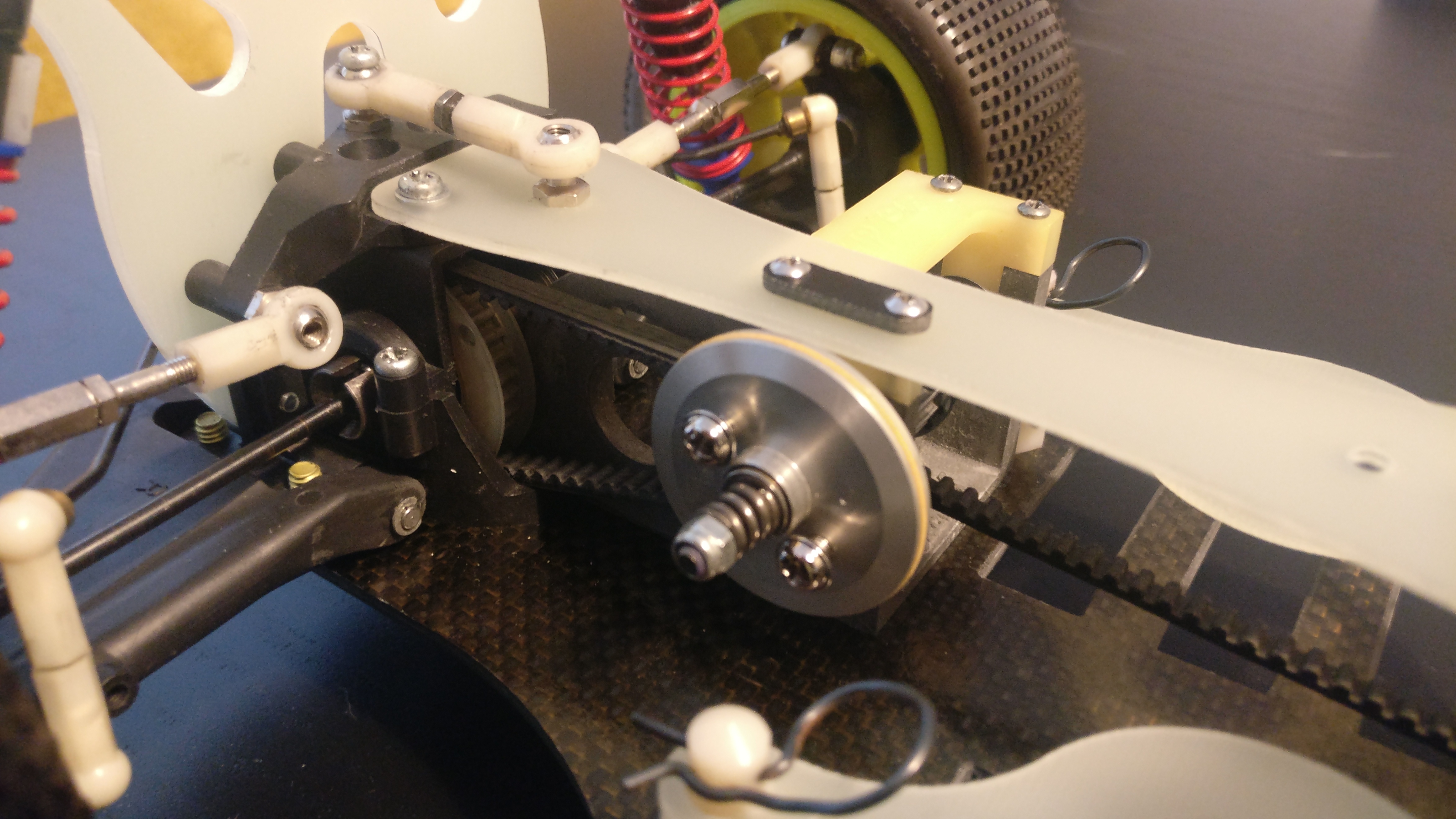

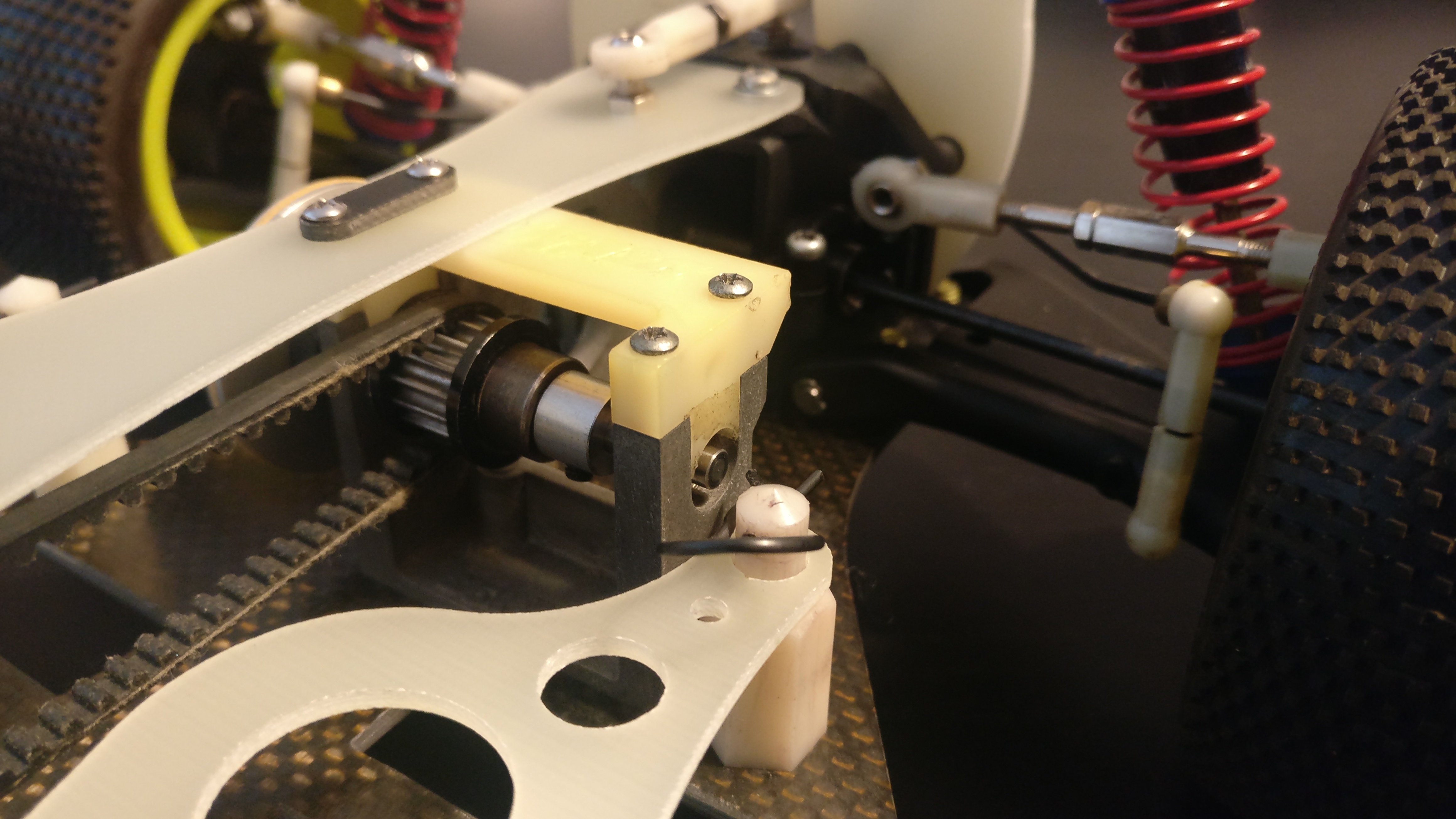

@RyanTQ10 I actually think I prefer the looks of the pre 94 cars with the bulkhead in front of the shock tower
but this one appeared and it looked so good I couldn't say no. I guess I'll keep my eyes peeled for a pre-94 to show up. I'll eventually take it appart for cleaning and then a soft restoration. The front bumper is cracked and the shocks are slightly stiff. Everything else seems fine though, this car only appears to have been used a couple of times.
@Retro rc can you explain to me what the TCS is?
Thank you!
Thank you!

We can trade cars if you wantgoncalopimenta wrote: ↑Thu Nov 03, 2022 5:49 pm @ RyanTQ10 I actually think I prefer the looks of the pre 94 cars with the bulkhead in front of the shock towerbut this one appeared and it looked so good I couldn't say no. I guess I'll keep my eyes peeled for a pre-94 to show up. I'll eventually take it appart for cleaning and then a soft restoration. The front bumper is cracked and the shocks are slightly stiff. Everything else seems fine though, this car only appears to have been used a couple of times.
@ Retro rc can you explain to me what the TCS is?
Thank you!
The TCS is basically a slipper
