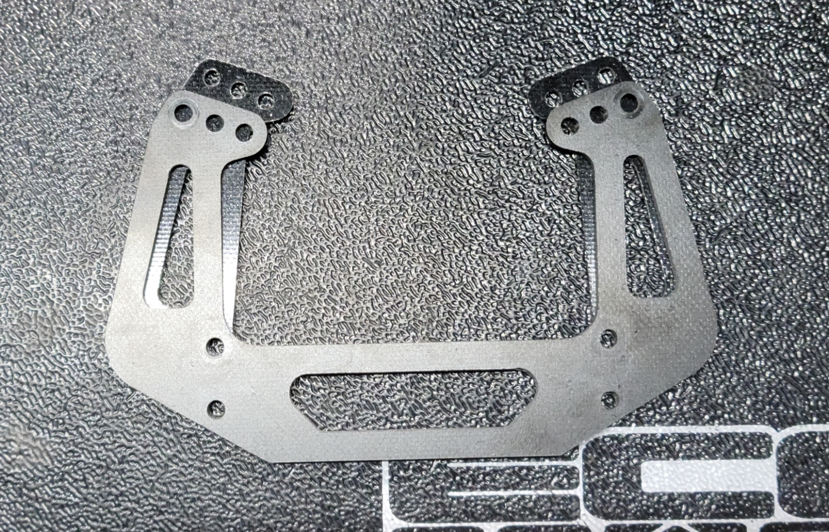

As anyone who has tried to use Andy's front arms with .71 shocks knows, it just doesn't work. Unlike the newer AE and RPM arms, they don't have the outer holes.
While putting together information on different shocks, I noticed that the length difference between .56 and .71 shocks was very close to that between .71 and .89 shocks.
Knowing that Jeff makes towers for use with .89 length (and big bore) shocks, I got him to make me one.
This one is the A&L style but he also has Worlds and Team Car styles.

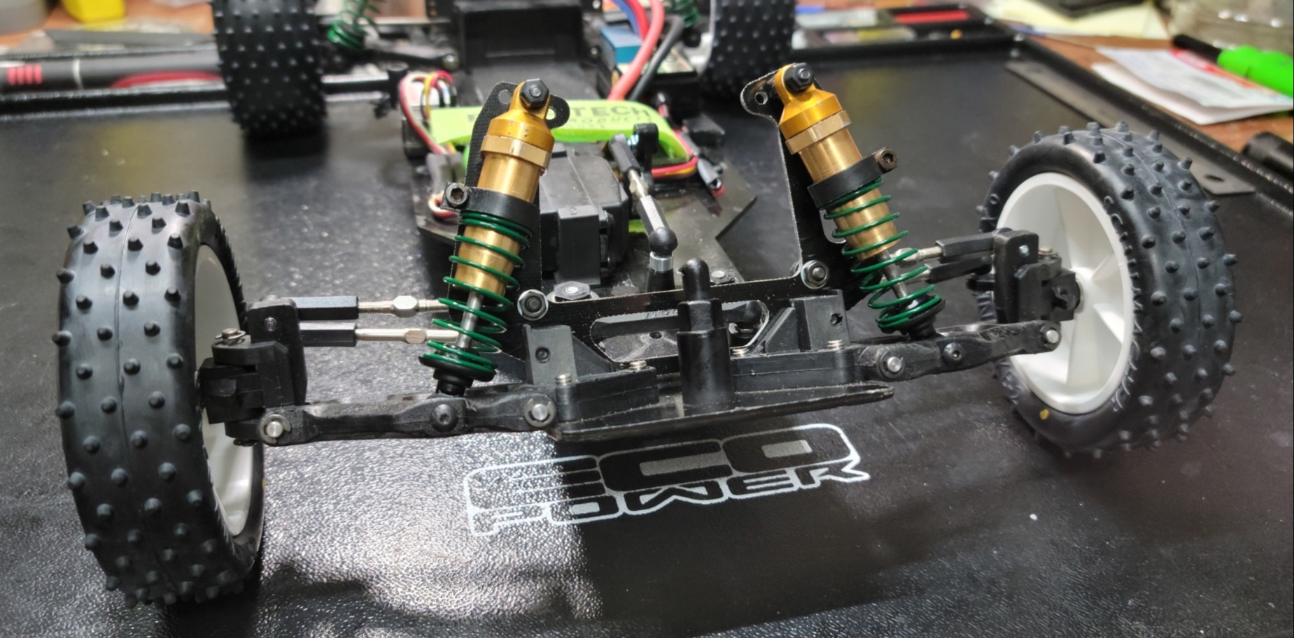

At ride height, without any limiters.

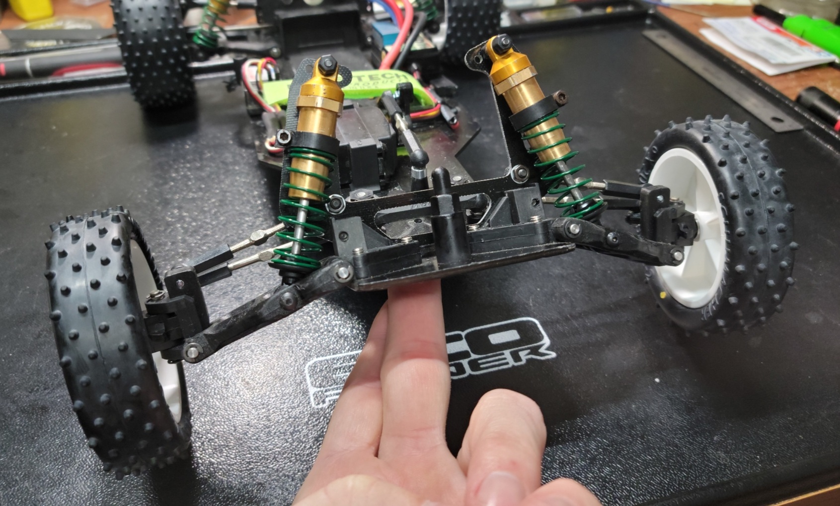

Bottomed out, with about 1/8" of shock travel remaining.

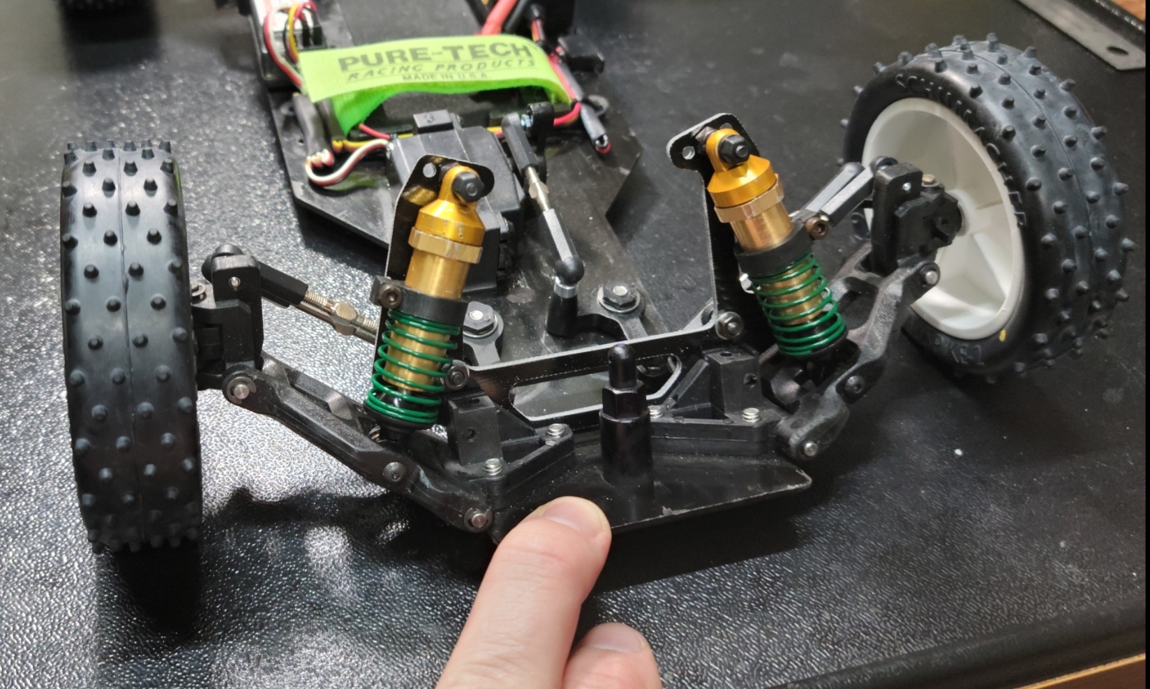

Full droop.
