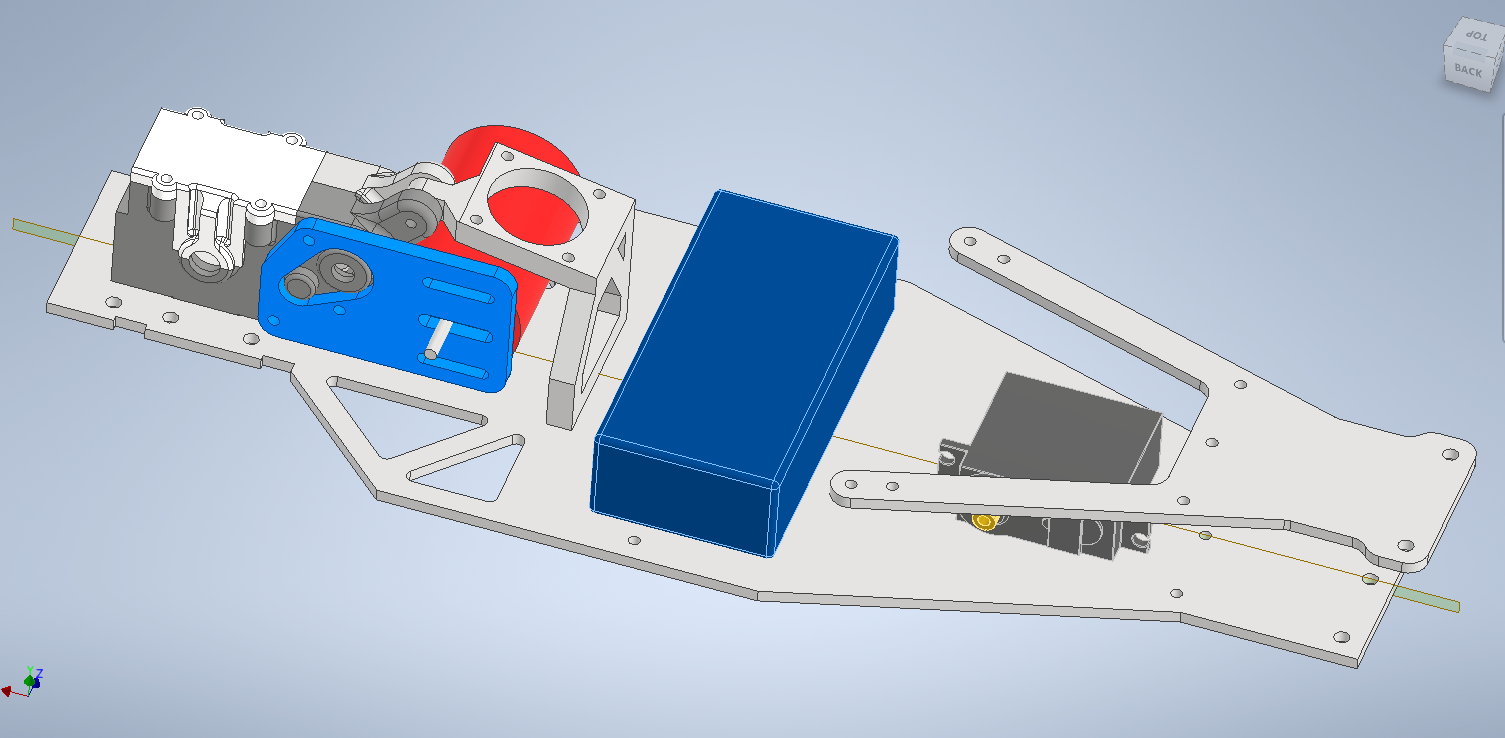

It's been a while but I'm back to working on my MM Rustler project. I've decided to design a new version which is why I've started this new thread. It's been a long time since I started my original mid motor conversion and in that time I've gotten way better at 3D design, bought myself a 3D printer, and tried a bunch new designs that I want to implement into this car now. There were some things about the old car I never liked that I want to fix, and with my 3D printer I can make parts I couldn't before. I also want a standup transmission I can use to run this car on outdoor dirt.
I plan on being able to swap between a laydown and a standup config, but I've started working on the standup because I know it's going to take me until the start outdoor racing season for me to get this project ready to race - I'm realistic about how long it takes me to complete projects, lol.
Anyway, today I finished the CAD work and I've started the first batch of parts on my 3D printer. Here's what the design looks like now:
The design is based on the same idea I've used on my DEX210 and my TLR 22 5.0 in the past. It's a double deck design that pushes the battery all the way back to the motor in order to get as much rear weight bias as possible. The design also has a separate rear camber link plate that will be easier to adjust and has an integrated sway bar mount. And while it's not something you can see, I can now make changes to the design of one part without breaking a whole bunch of other parts (my old design files are horrendous to work on, part of the reason for a clean break, lol).

The printed parts went together pretty nicely! I've got some very minor corrections and a few tweaks to make, but for the first time ever I've printed a prototype that didn't have massive glaring issues that needed multiple iterations to fix. Feels nice. I'm pretty much ready to move on to making final parts.
The rear arms are something I didn't mention in my original post, but I redesigned my long rear arms from my last build. Instead of machining them out of delrin I want to experiment with rigid polyurethane resin casting. My old arms were a major pain in the rear end to make, but resin casting is pretty fast and easy. And unlike my previous arms, these arms have 3° of toe-in added in at the hub. I wanted to be able to use the Nitro Rustler suspension mounts (available in 0° and +/- 1° for tuning) and I also wanted them to work with the stock Traxxas transmission case, too.
