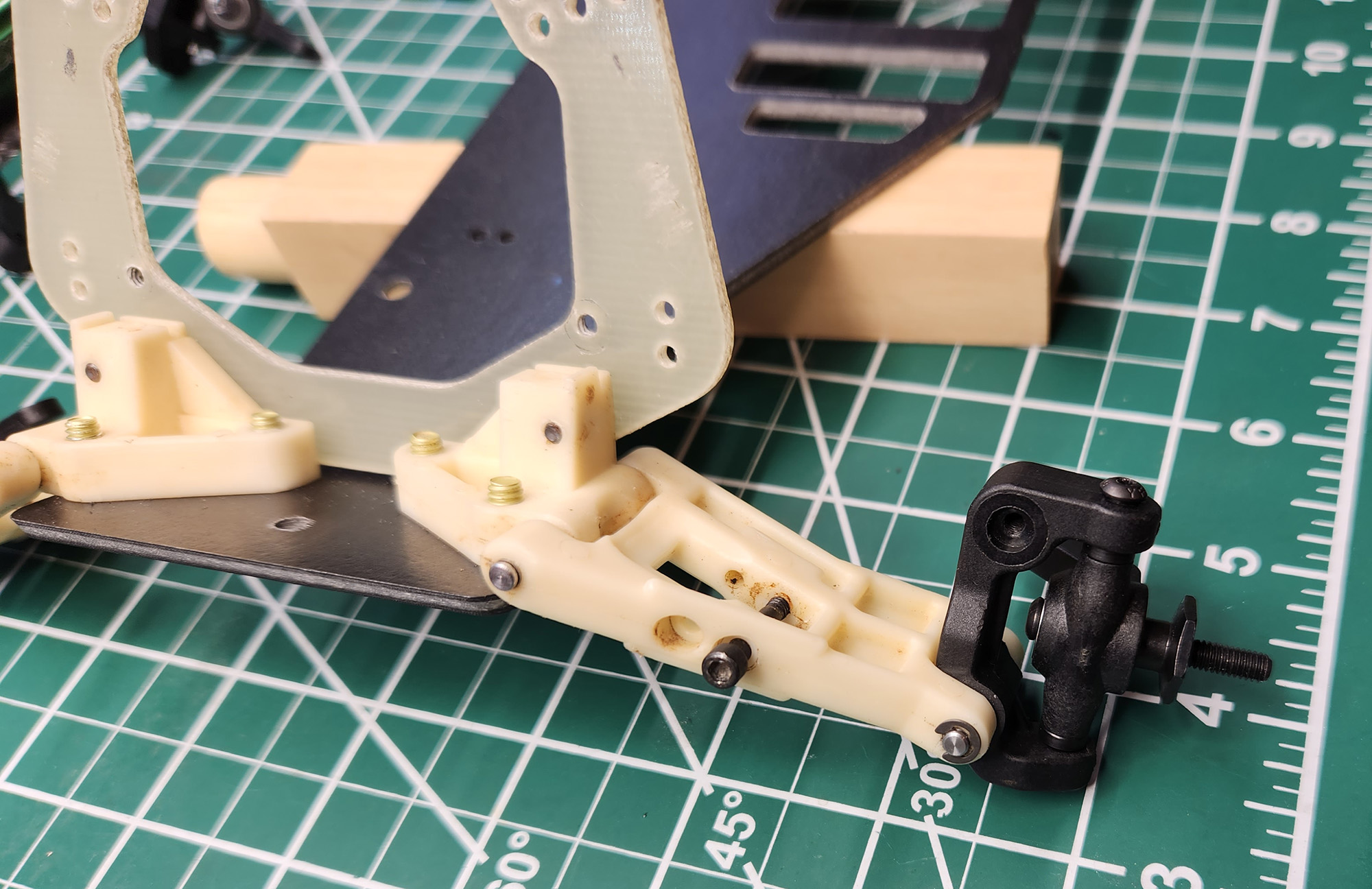

Thanks JC! I didn't really know where to start. The Bandit parts are about $20 total, and require very little trimming for the narrow arms. I may need to change out to wide arms, and those look like they will require more cutting, but should be doable. I like to stick to Traxxas stuff when I can because it is available everywhere, and super cheap.

The trimming is normal. I've used it on a couple 10T's for years and never broken it. Even with the trimming, there is more material than the original RC10 blocks.

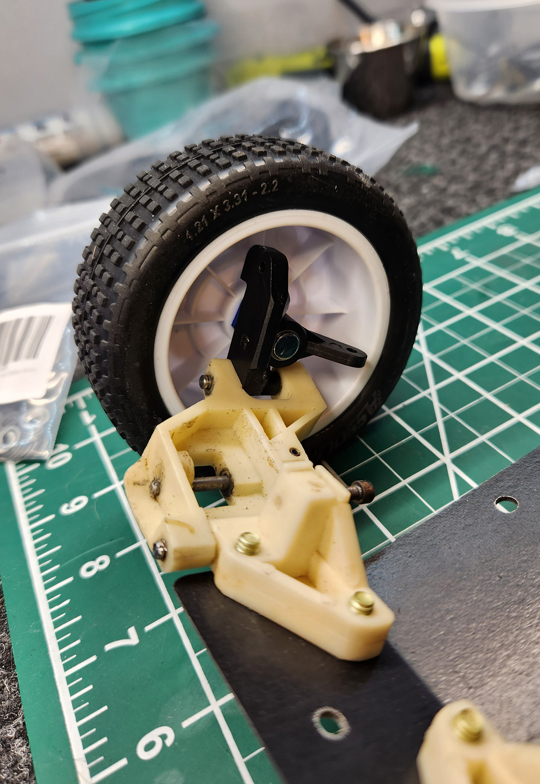

DR10 caster blocks narrowed by 3.3mm at the pins, and drilled out to 1/8". Now we are getting beefy.
