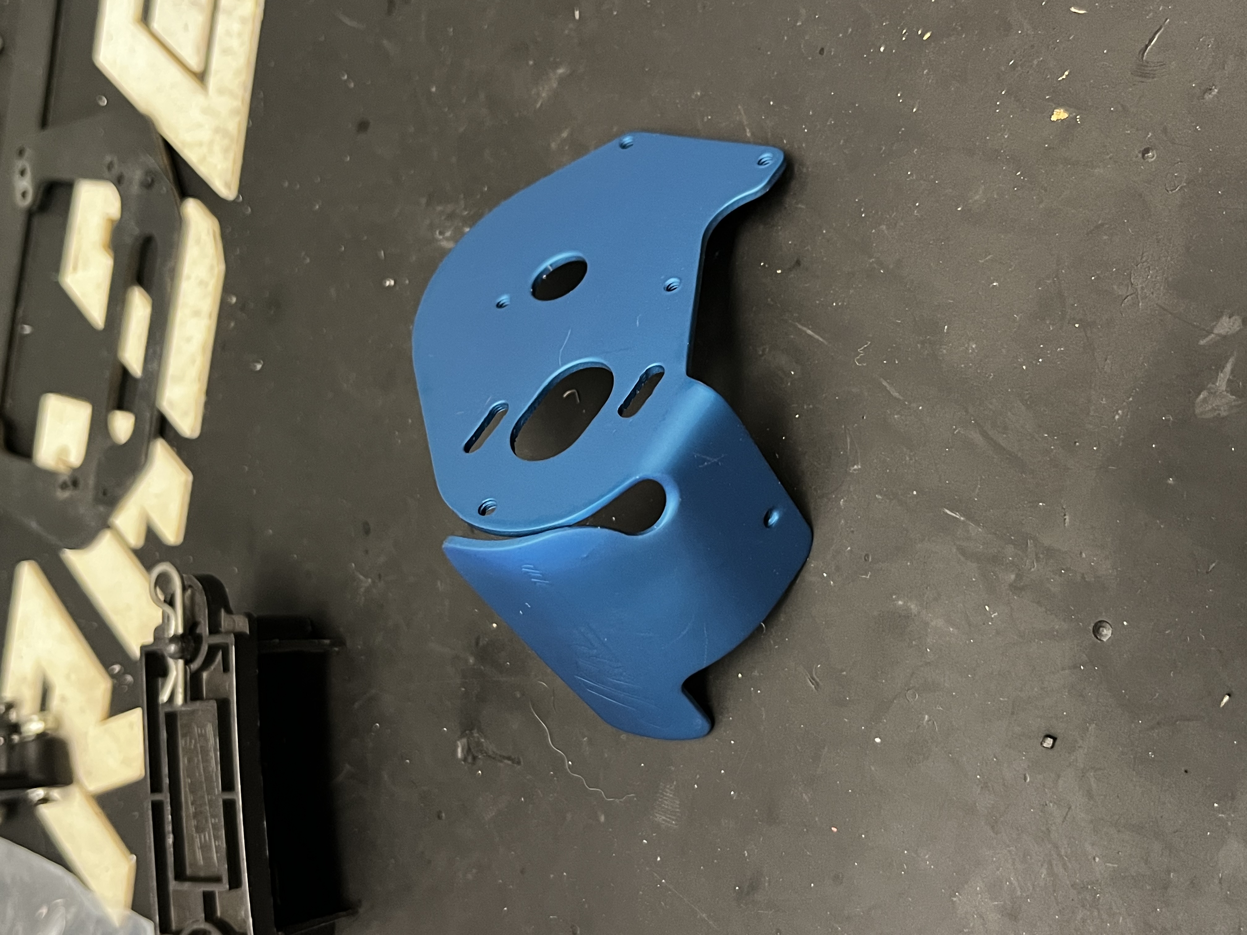

Came with this motor plate says JRx2 and it’s like a flat blue anodizing…. This custom? Or?

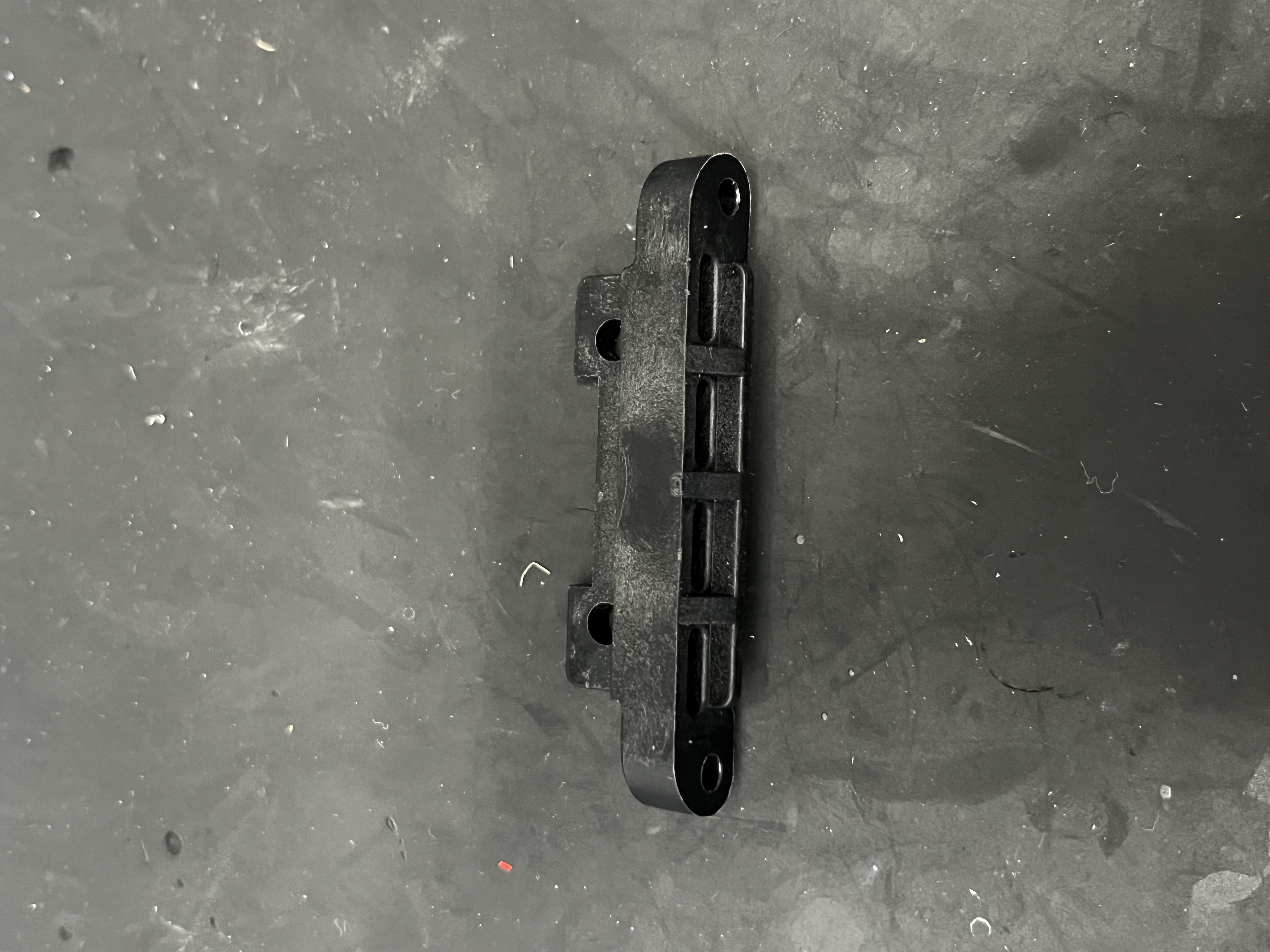

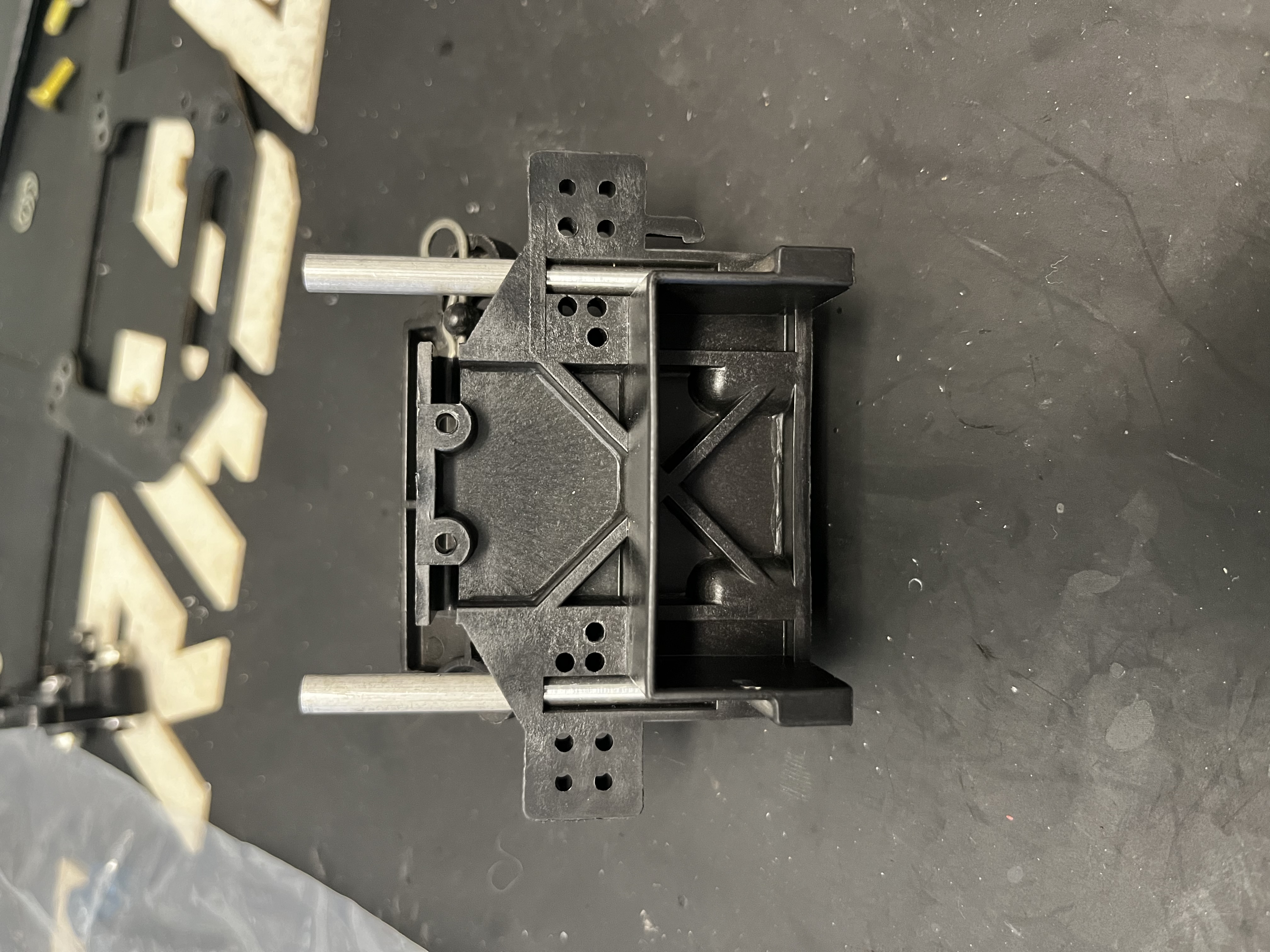

This bulkhead? jRx2?

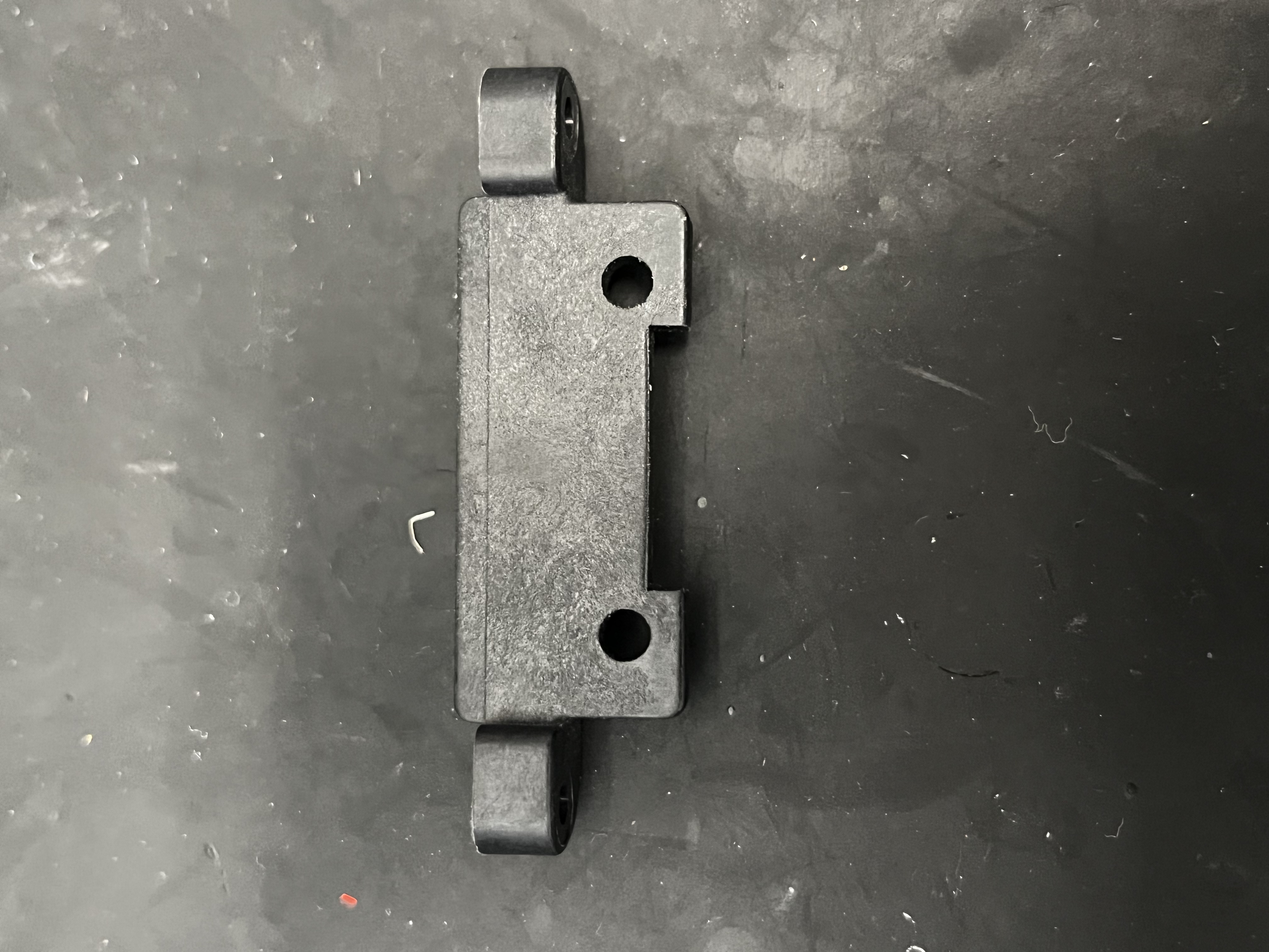

Rear arm mount?

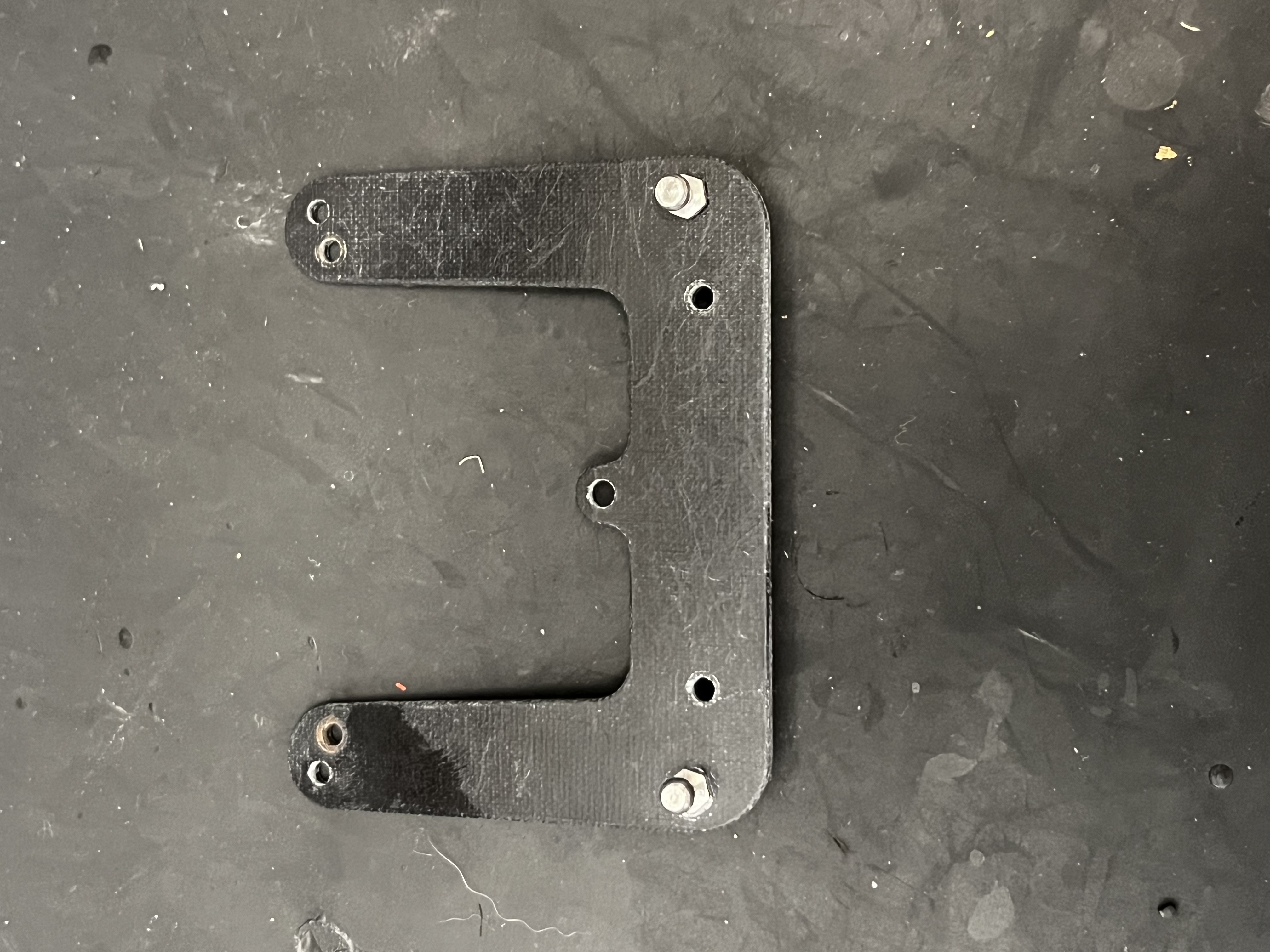

Battery hold down?

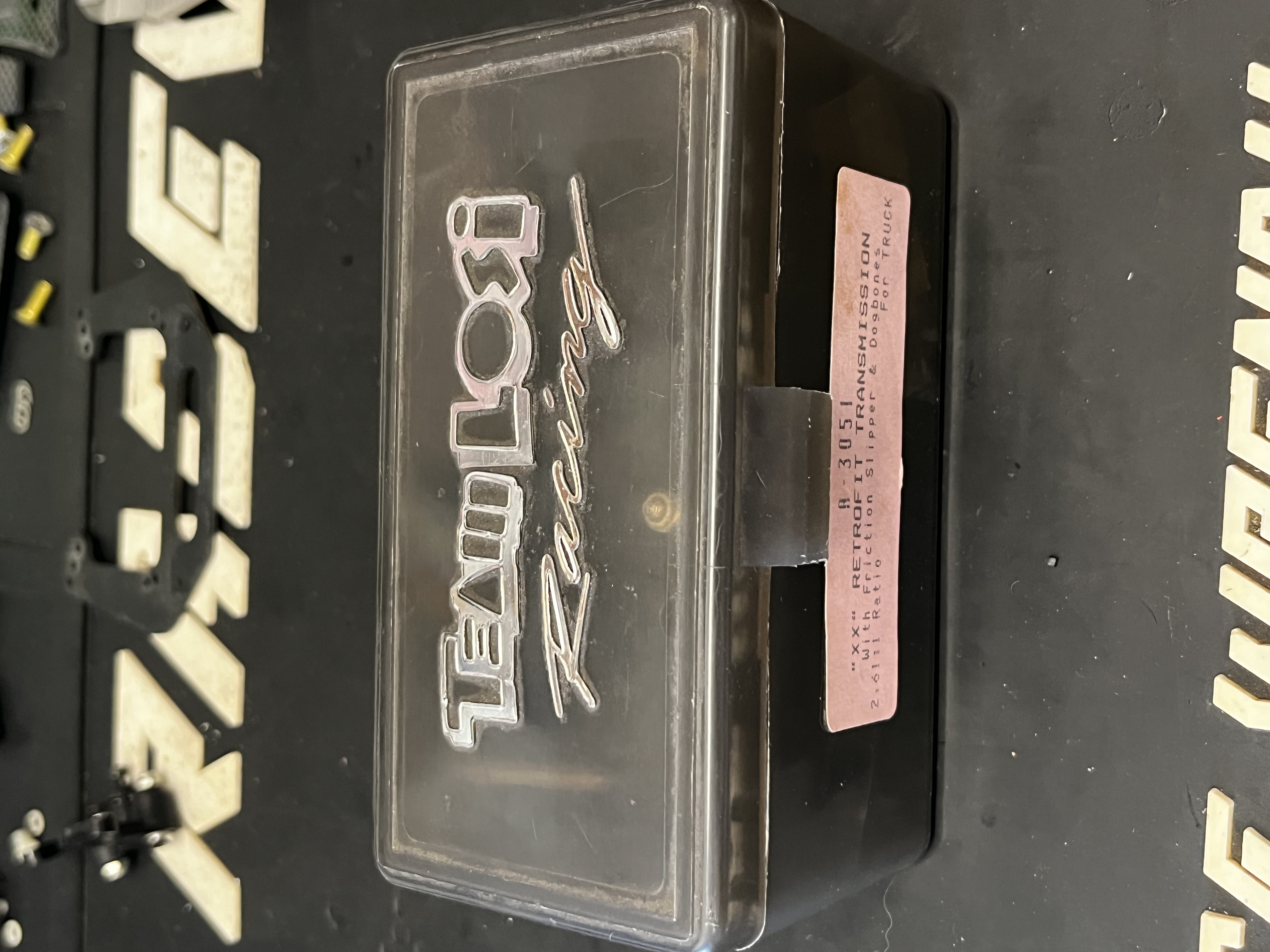

Guy threw in this box for the Retro trans as well never seen it before and happy to have it cause I just rebuilt and installed one in the JRxT project I’m working on..

You have a rear bulkhead with wing tubes, early style square battery box, Jrx2 front shock tower.. The rear suspension mount is for use with the H arms. It should have a small number on it..they made 4 different ones with different toe-in and anti-squat. The motor plate is custom.. Losi only made powder coated yellow and purple ones.

So x2 and xT have same rear bulkhead but the x2 has wing tubes? Thats the only difference?

Yes, they're both the same part. The wing tubes just press in.Andybellus wrote: ↑Tue Aug 08, 2023 2:47 am Appreciate the reply!
