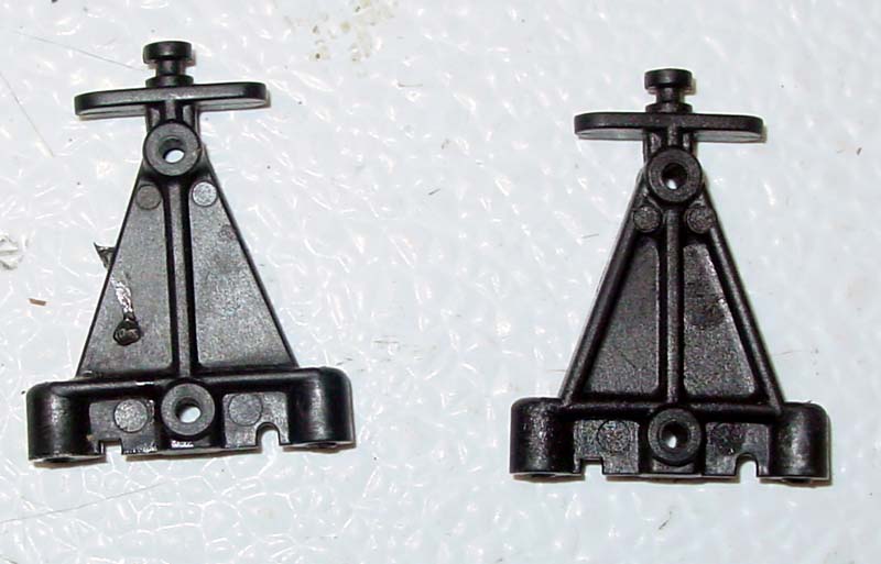

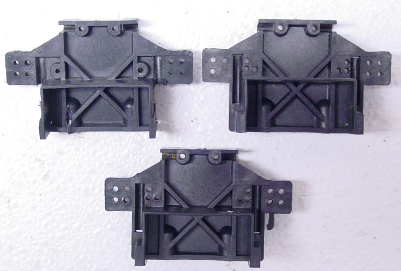

I was building a pair of runners from several incomplete cars and my used parts stash and noticed some variations among the parts.
There are 3 types of rear bulkhead. The upper left one has been hacked up by the previous owner, but you can see on the front how it is different aroud the lower shock tower mounting holes. This area was filled in on the other 2 so that the inner camberlink ballstud holes could be added. there are 2 versions with the inner holes, one with 2 holes, one with 3. There are 2 side bulkhead types, one with a support ridge around the outside, and one without. The rear links that go side to side come in 2 variations, one with 4 holes, one with none.
The lower links have 3 variations, one with 2 shock mount holes, one with 2 shock mount holes and vertical reinforcement ribs, and one with 4 shock mount holes with the vertical ribs.
The upper links came with 2 variations, one has 4 support ribs, the other has only 3. this provides better clearance for the shock when the link is placed so that the flat part is down and inboard. The 2 junior chassis plates have some differences, I am not sure if one is from a 2 and the other a jr-T, or if it was just a running change. What I believe to be the newer of the 2 has a recess for the servo saver and under the transmission, as well as a raised area for the antenna mount. This also has un-drilled holes marked out on the bottom corresponding to where the long wheelbase optional holes are on the lxt/pro-se chassis. There are several motor plates at least 4 different front bulkheads, but I don't have all of them for a comparison shot.
any others I missed?

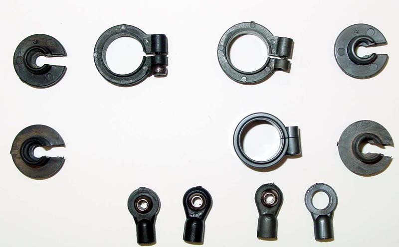

Re: Some losi parts variations
Here are some variations on the shock parts.
There are the older. thinner lower shock mount eyelets compared to the newer thicker eyelets.
The clamps were originally the thin type, but broke easily. they were updated to the wide type which is still available. I have NIP thin in both black and grey, but have never seen the wide ones molded in black. The one package I have of black new style eyelets with black spring retainers has a pair of grey wide shock clamps, so I do not think that black wide clamps were made.
The lower spring retainers have 2 variations, the older ones have a longer shank, the newer ones are shorter and have a small R molded into the outside. These were both available in black or grey.

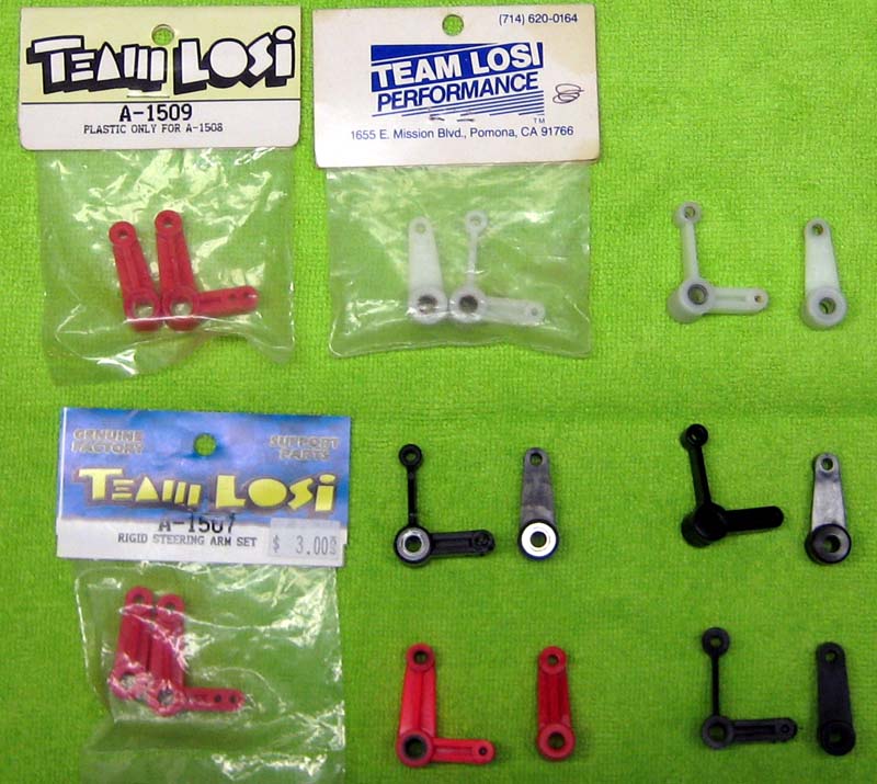

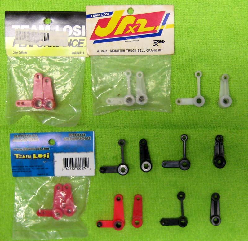

one more set.
Here are 8 different pairs of bellcranks. I do not know which ones came in what order, I assume that white were first, then black, then red.
The variations I have are:
1: Red Rigid ball bearing with 2 ballstud holes
2: white Servo Saver monster truck with metal sleeve inserts
3: White servo saver
4: Black servo saver ball bearing
5: Black servo saver
6: red rigid 2 ballstud holes
7: red rigid single ballstud hole
8: black servo saver, larger diameter rack mount, small diameter post mount.
The last pair (lower right) is an oddball. Compared to all other servo saver types, It has a larger cuff around the area where the shoulder screw attaches it to the rack(same diameter as the rigid ones), and a smaller diameter barrel where it mounts to the aluminum post on the chassis(unlike any other). It also has the idler arm shaped like the ones in the rigid arm sets, not like the servo saver idler arms.
If I come across any others I'll add them. added 9/13/08
9: Red Rigid ball bearing with single ballstud hole:

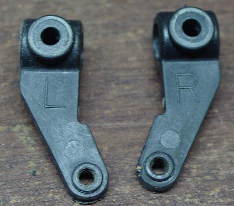

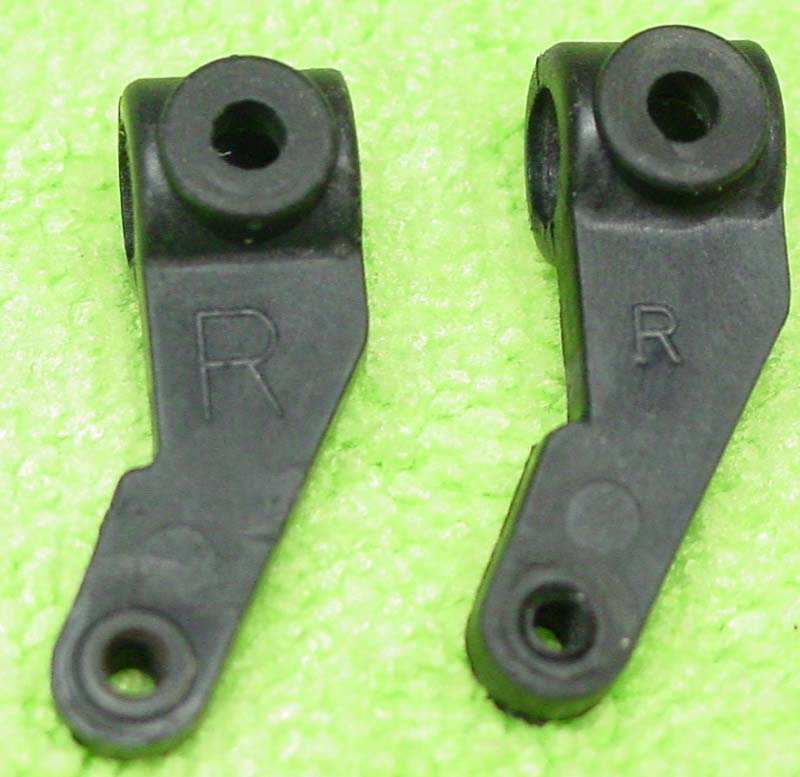

It's been a while and I've accumulated a few more.
This first one I just recently discovered.
There are apparently 2 versions of the spindles.
One has a big side indicator letter with a support rib that is sharply 90degrees to the arm.
The other has a small letter on top and the joint between the arm and rib have been filled in, looking kind of like a weld.
I only have one of the "big R" variety and no matching left. Edit 9/13/08 I found a matching pair of the old style: Next is just a rehash of an older post. I had been trying to get nip links to build up another car and somehow I ended up with 3 different sets. Luckily I have since been sorted thanks to a couple members. Next post: motor plates

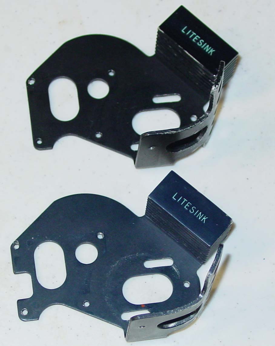

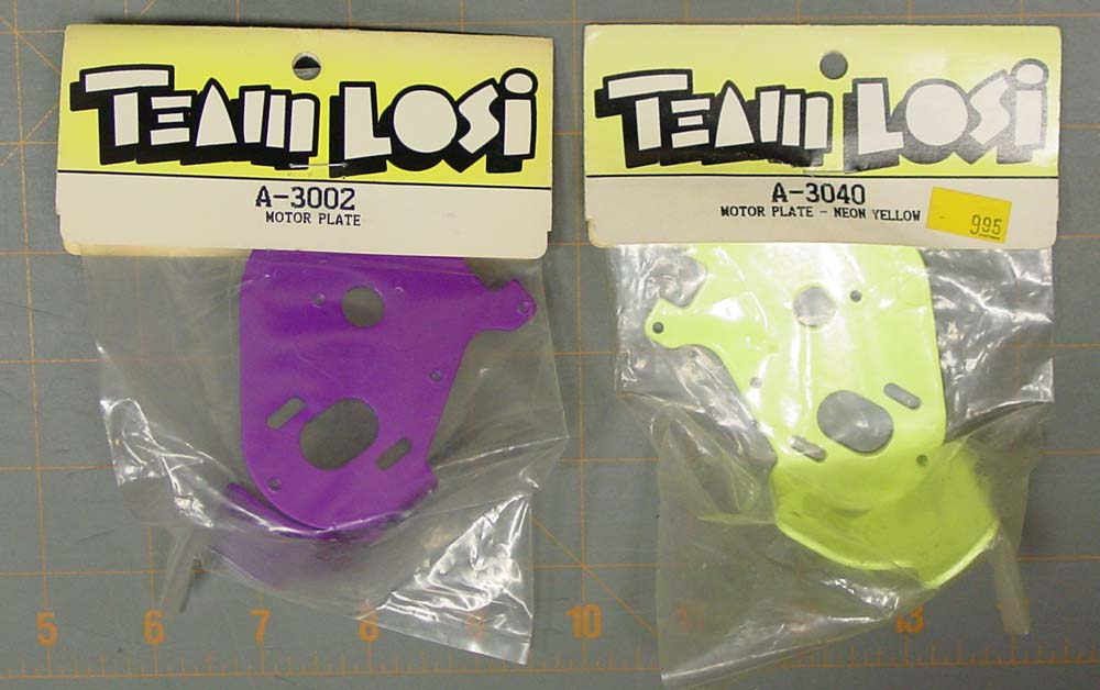

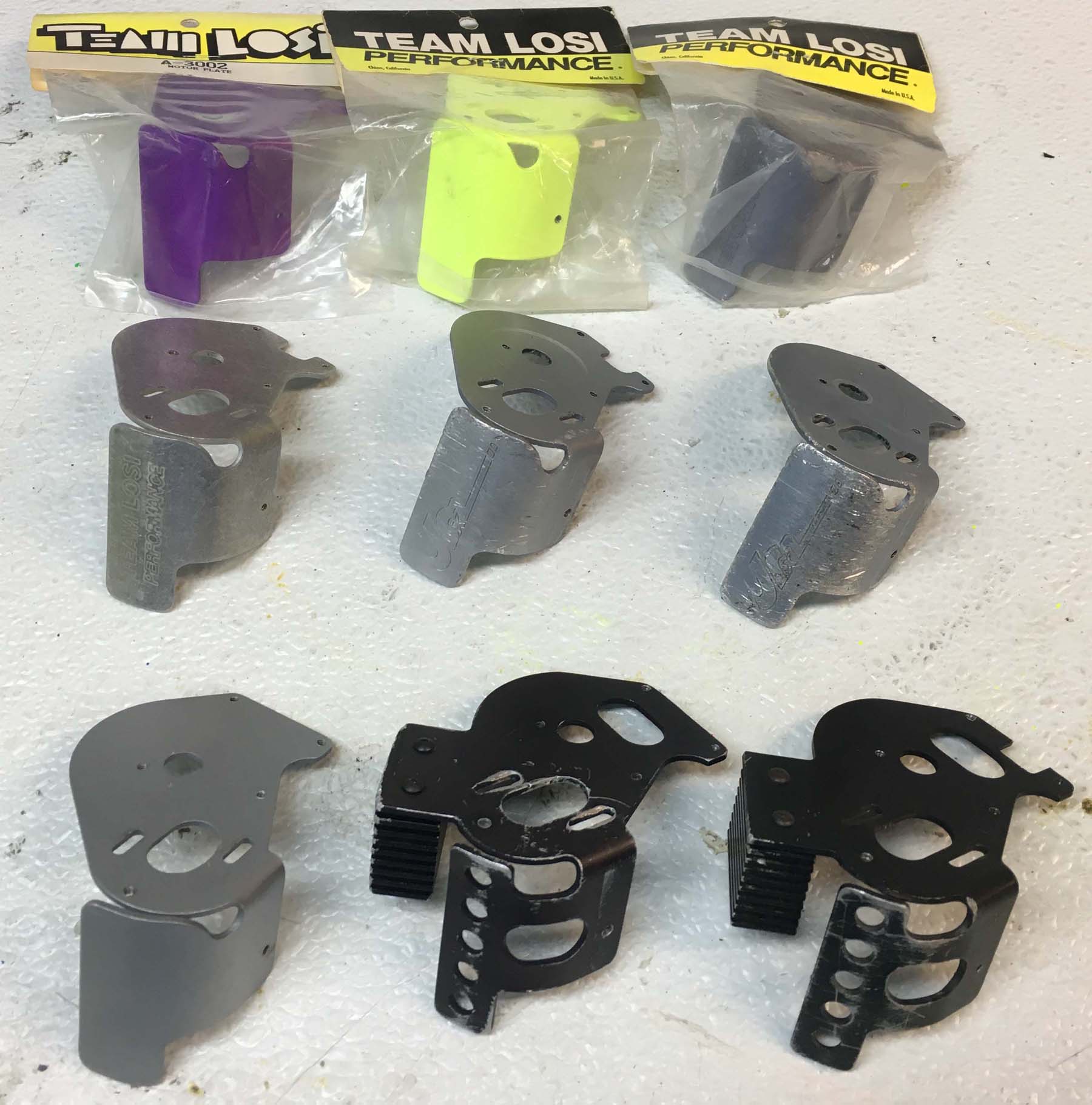

There are quite a few motor plates, and I don't have all of them. Here is what I've got:
No logo no notch(just got it today thanks to Jay)
JRX-2 no notch
jrx-2 notched
team losi performance notched
Team losi performance notched purple anodized
I also have a Team losi performance notched, dark anodized, but it is mounted on an xx retro trans, and that is entirely too much work to get the plate off just for a picture
The last(I think) variation is the yellow anodized counterpart to the purple one. I'm still searching for that one. Not exactly Losi, but who doesn't like the litespeed heatsink plates?
As far as I know both the notched and un-notched versions share the same part number as did all the losi versions, all just running changes. The 2 notched plates I have are in a dark blue finish, but the un-notched one is Black. I don't know if they changed color when they changed over or if that is just random variation in their anodizing which seems to be different at times from my experience with some of their other items I have seen.
edit
Purple anodized,
yellow powdercoat,
dark anodized "team losi logo,"
no-anodize logo(pre-production sample),
notched JRX-2,
solid jrx-2,
no logo,
litespeed heasink, and
litespeed notched.
JRX-2 no notch
jrx-2 notched
edit
Purple anodized,
yellow powdercoat,
notched JRX-2,
solid jrx-2,
no logo,
litespeed notched.

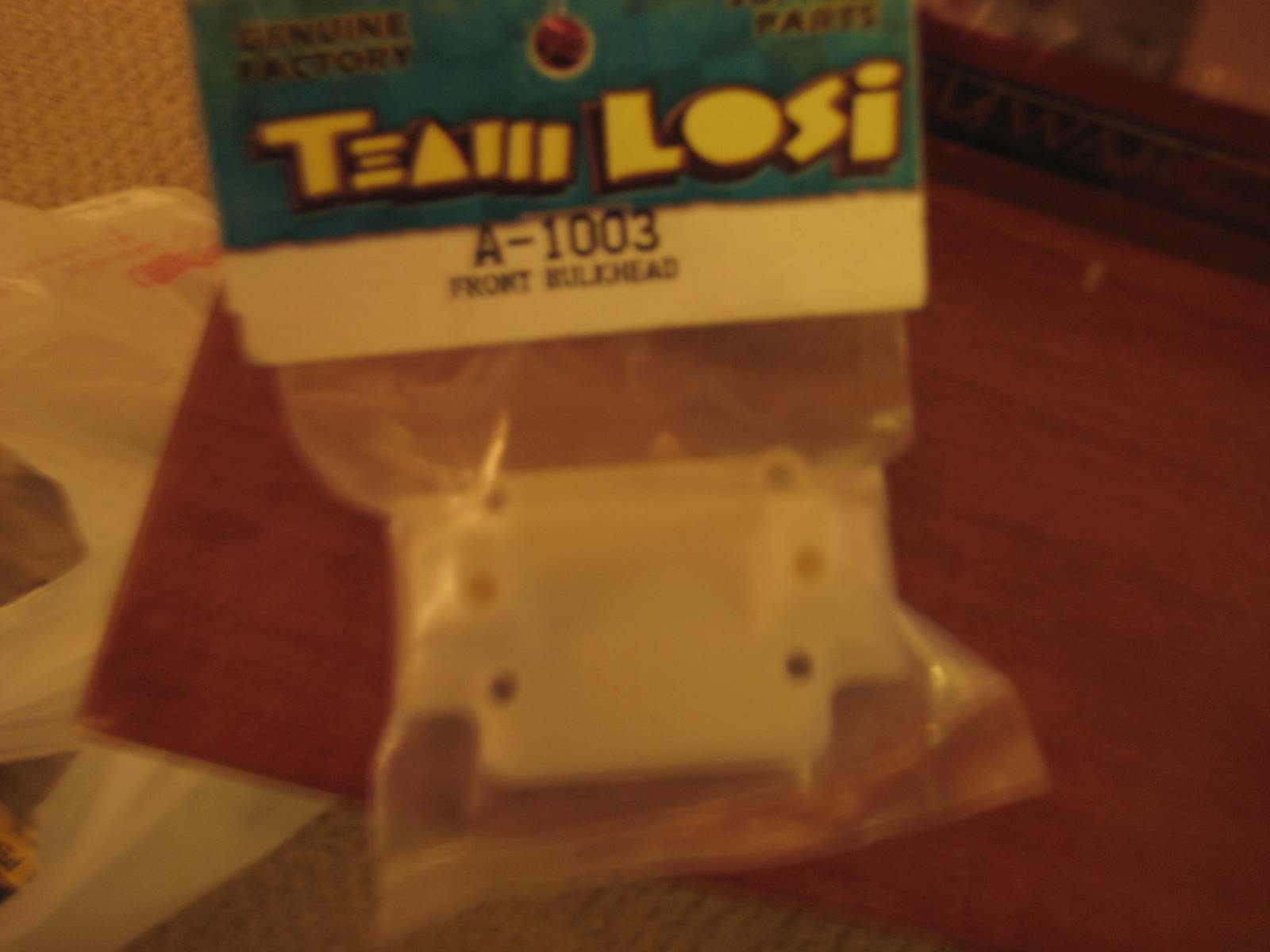

Anthony, where does a white front bulkhead fit into the scheme of things? Found this yesterday in a box of Losi things and thought it was kind of odd. Not the best of pictures but you get the idea.
This is all very interesting!

i have a yellow, it is powder coated, not anodized.aconsola wrote:The last(I think) variation is the yellow anodized counterpart to the purple one. I'm still searching for that one.
--Joey --
Vintage A&L and Factory Works
JKRacingRC.com
JKRacingRC.com
- mrlexan
- Posts: 6250
- Location: Upstate SC
- Been thanked: 12 times
Anthony does too (nowJK Racing wrote:i have a yellow, it is powder coated, not anodized.aconsola wrote:The last(I think) variation is the yellow anodized counterpart to the purple one. I'm still searching for that one.
