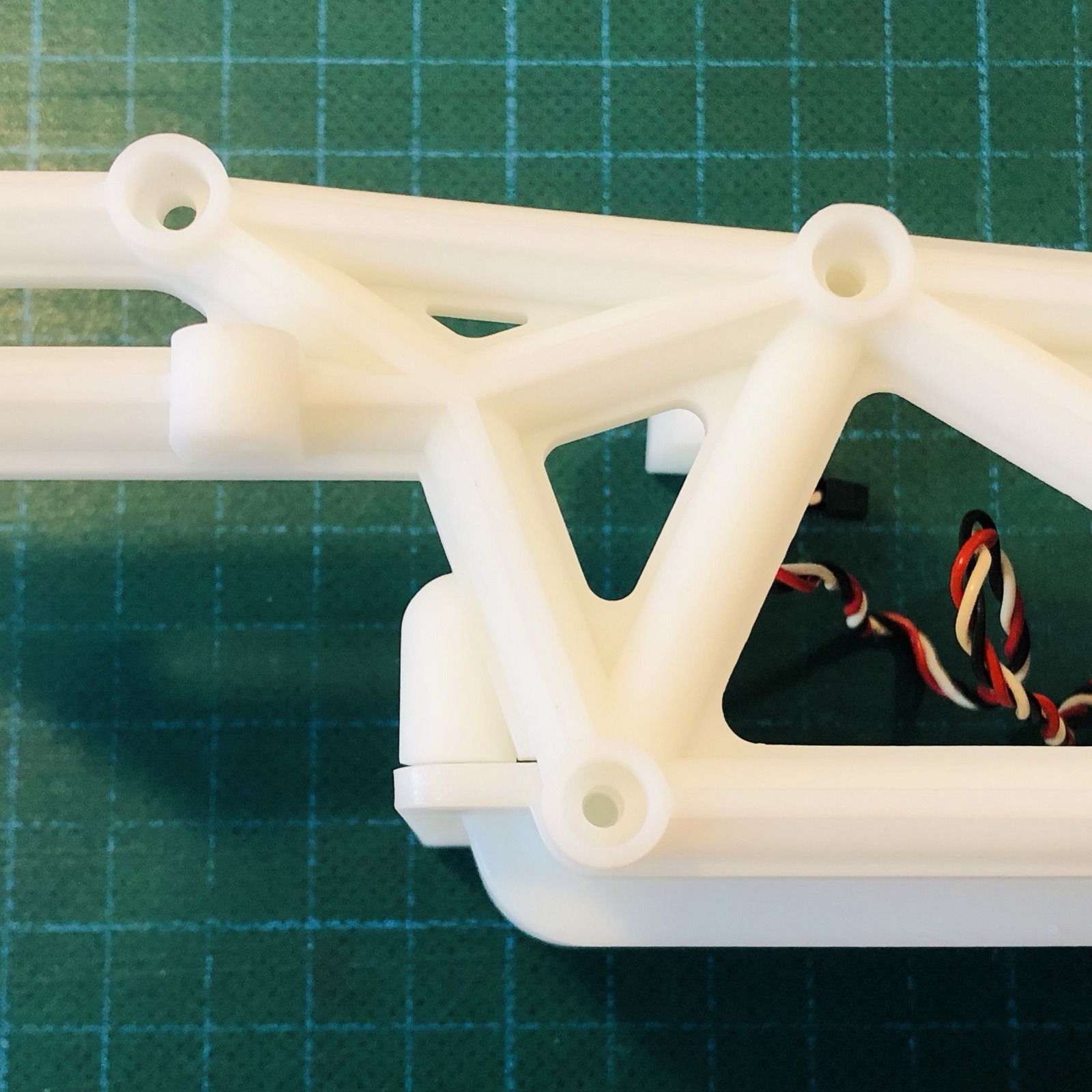

And here are the parts I printed.
Here the parts are white because they're printed in SLA resin. The final product will be MJF PA12 black dyed nylon for the best shock resistance.

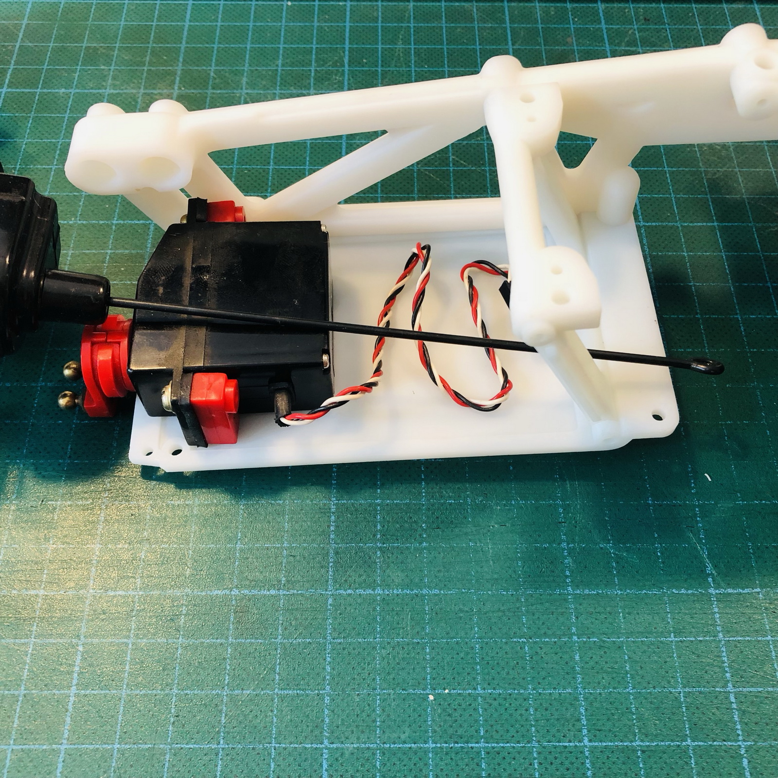

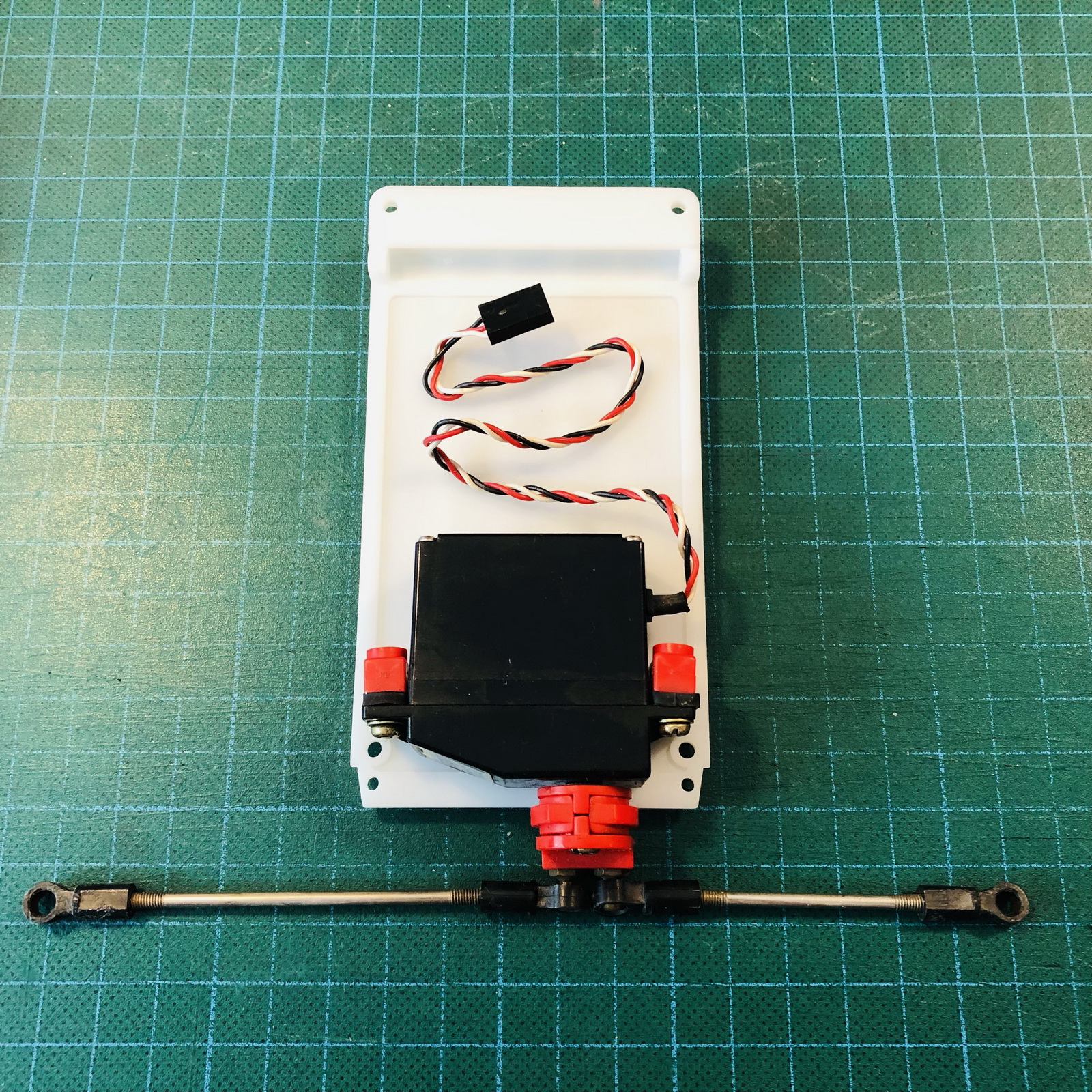

I start by attaching the Steering servo on the Bottomplate

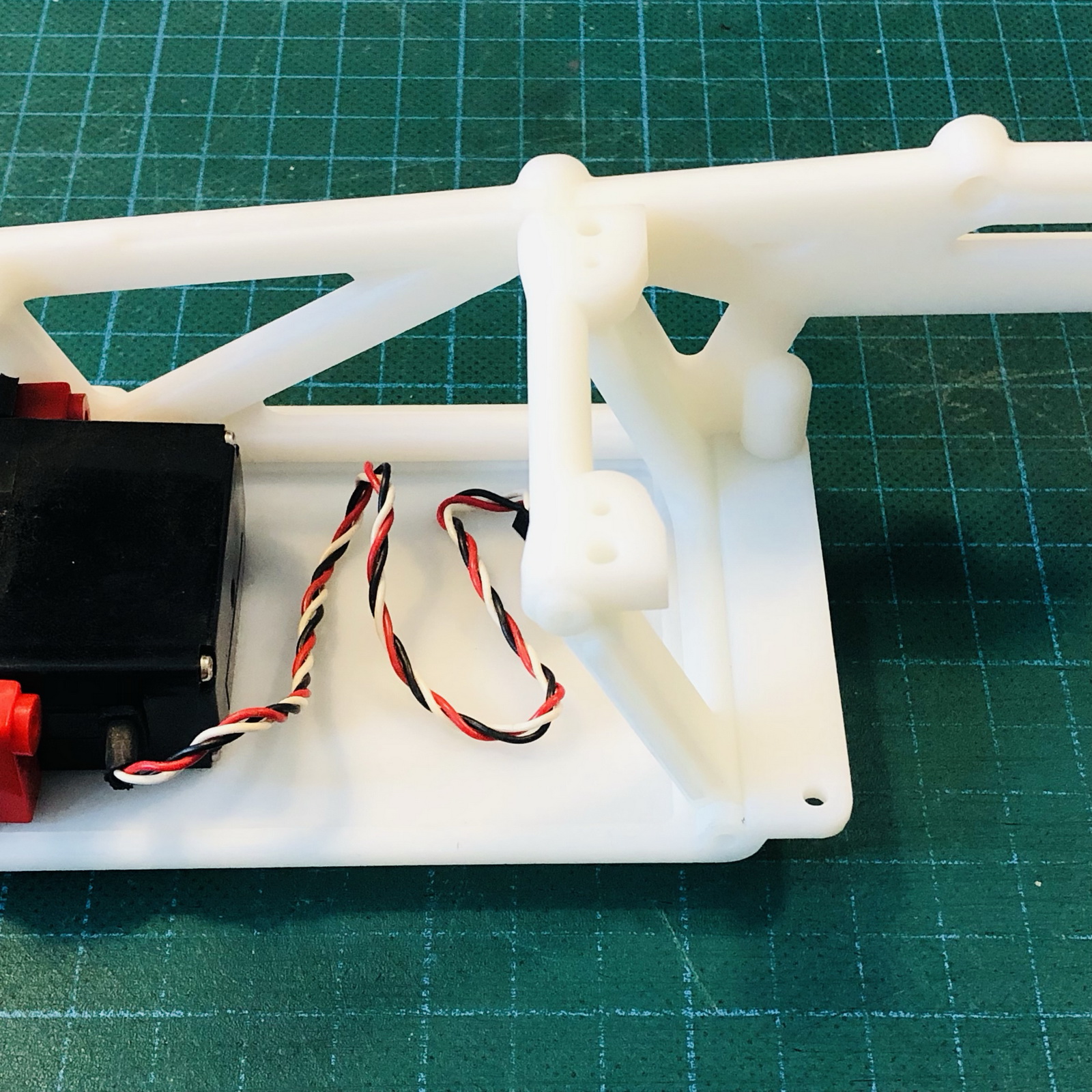

Next I carefully slide the Centerframe on the Bottomplate.
optimaforever
Posts: 82
Joined: Tue Jun 30, 2009 1:38 am
Location: brussels, belgium
Has thanked: 10 times
Been thanked: 26 times
Re: Spaceframe Chassis for Hotshot
Post by optimaforever »
Then we snap the whole onto the Right Frame.

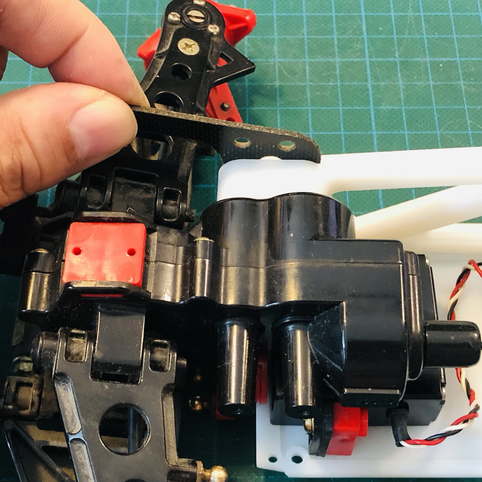

Next is the Driverplate. I attach it to the rear gearbox with 2 M3x30 screws.
optimaforever
Posts: 82

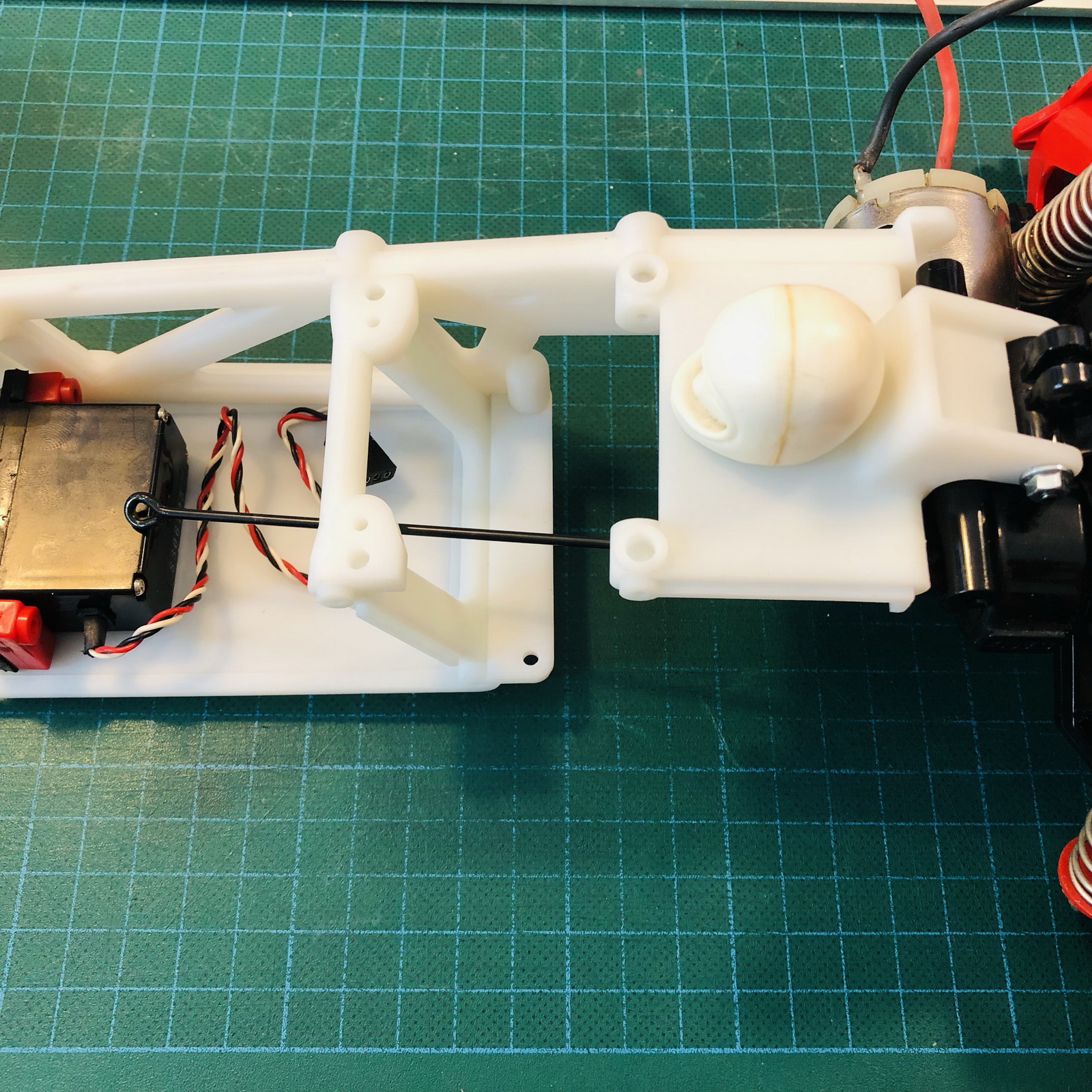

I almost forgot to attach the driver head. M3x8 Flathead tapping screw to the rescue
optimaforever
Posts: 82
Here I can confirm that the lower M3x30 screw doesn't touch the propeller joint.
It is written in the OG Hotshot manual but the lower M3x30 screw is too long and touch the propeller joint IF you forget to slide the 5mm spacer onto the screw.
If it is the case, adjust the screw length (add collar, spacer, or simply use a shorter screw).
