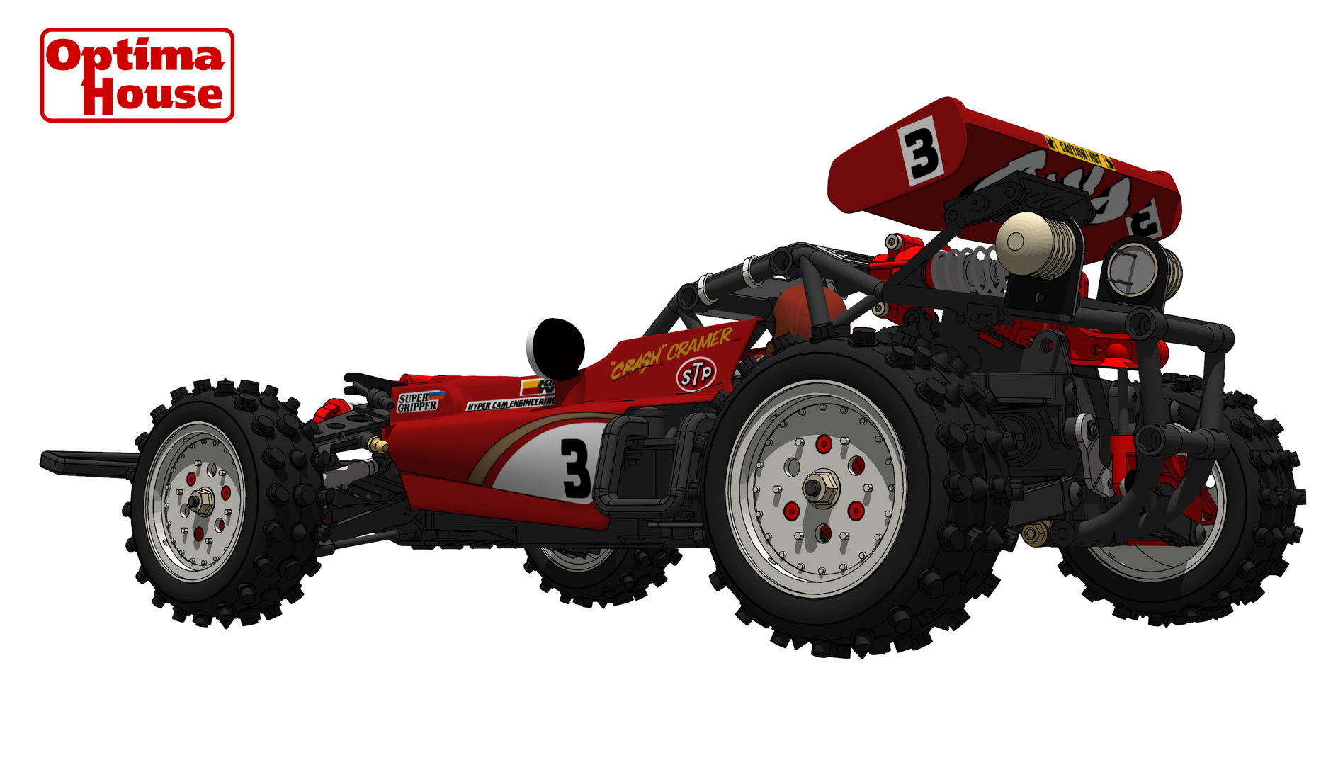

I also modeled the driver head.

And the Hotshot and SuperShot bodies

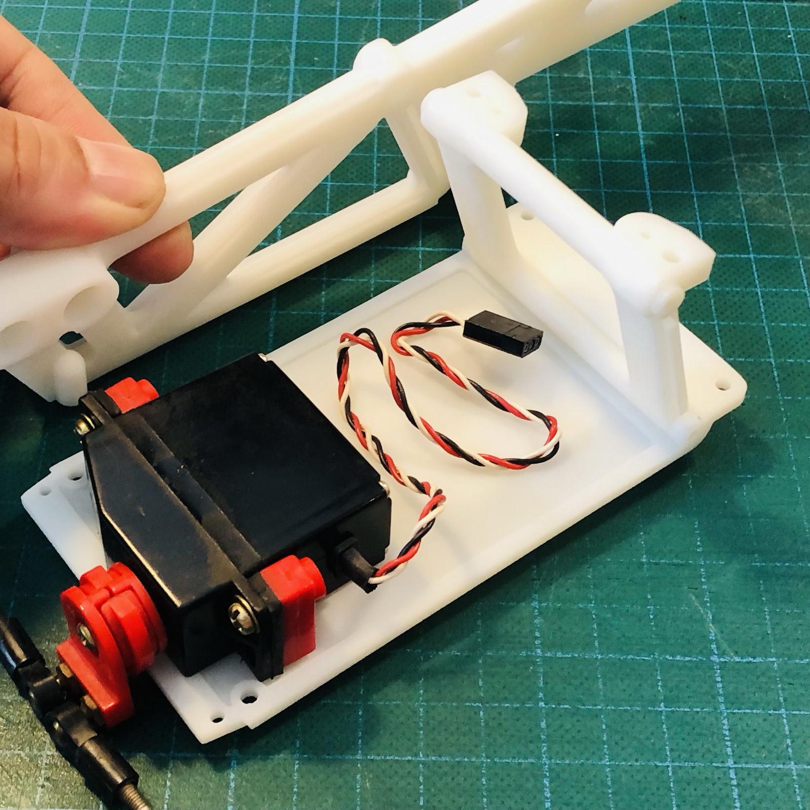

I start by attaching the Steering servo on the Bottomplate

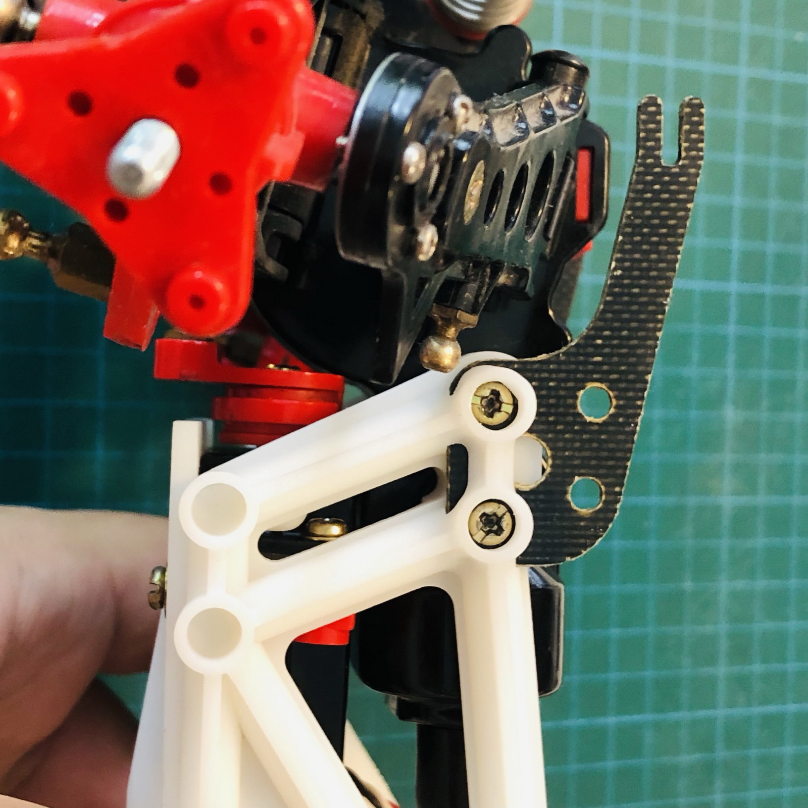

Now I place the front stailizer brackets in front of the frames.
Check carefully if the holes are aligned
And use M3x15 tapping screws to attach the frames to the front gearbox
