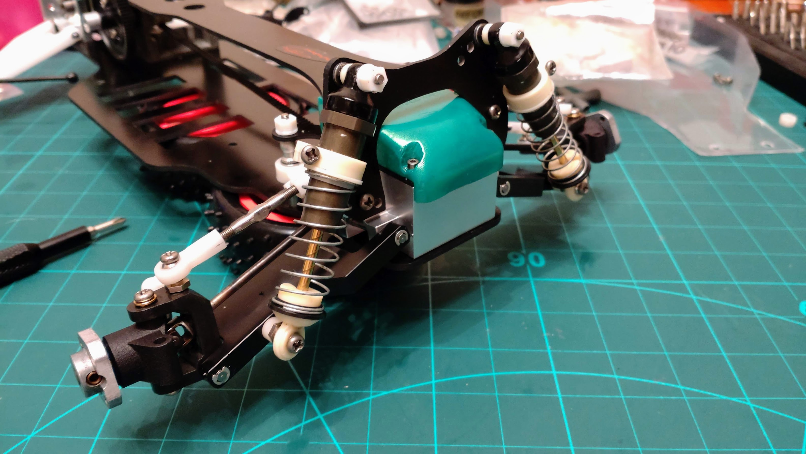

Shocks are vintage associated 0.71 for the front and 1.02 for the rear. I only had some blue anodized shock caps in the parts bin so these were given a quick rub down then primed using Tamiya plastic primer and them painted with a Tamiya black.
The white plastic parts are from FAN RC, but I've since retrobrighted some original Associated parts which came up great. One problem I had with the springs I'm using was they were slightly larger diameter than the shock retainers (not a FAN RC issue as the originals are the same) to fix this I used some black Yokomo shock spring centring collars, I also used some Yokomo white collars on the spring retainers to prevent the springs rubbing on the shock bodies. The original Associated parts have this little guide built in.
This is not quite keeping with Masamis Yokomo as he used spacers, I do have some of those and I might change to them in the future but I'm not going to be that precious about it. The screws are titanium and were procured from AliExpress.
These shocks (in this size at least) are getting harder to come by and expensive but will so be available from FAN RC in the near future.

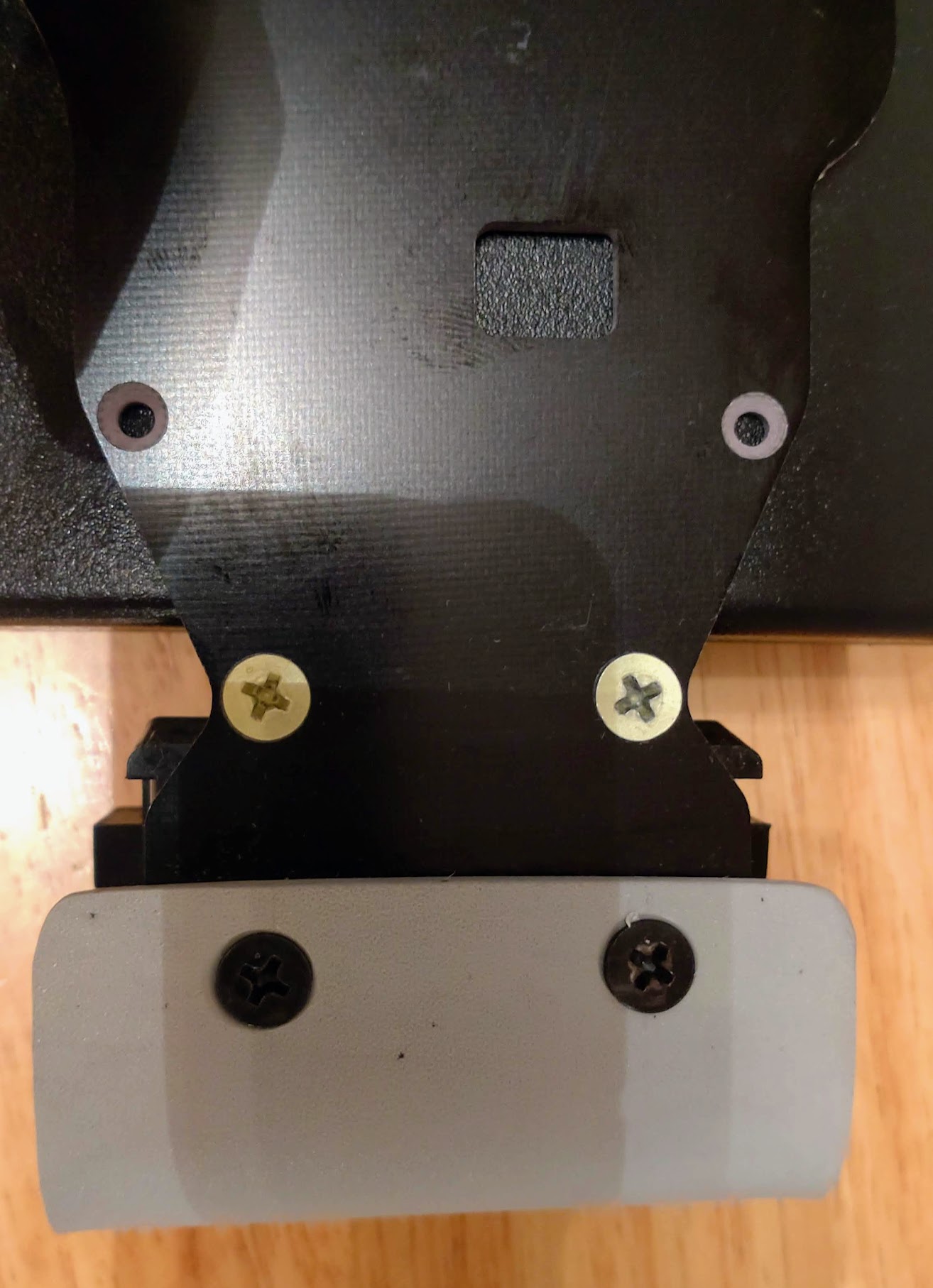

The bumper is homemade from 3mm 'kydex' I used a heat gun and wooden spoon handle to achieve the bend. It is grey because I ordered white kydex sheet but was sent grey, either that or I'm colour blind
I've used a nylon bulkhead for mock up purposes but I'm waiting on some FAN RC aluminium ones which I'll use in the final build.

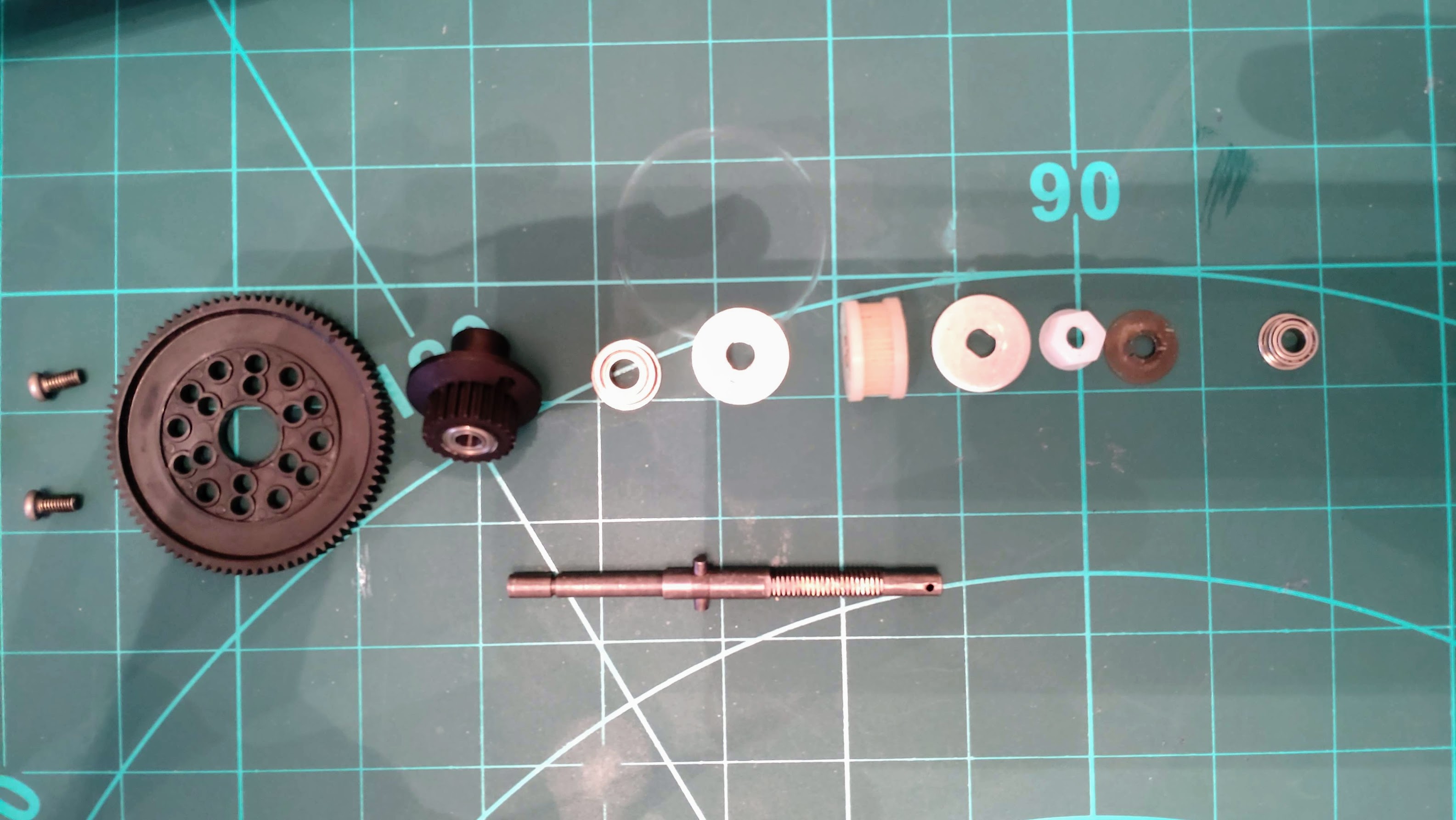

Thought I would do a mock up of the chassis, all fit together perfect. I'm still waiting on a 2mm gear adapter so used a 3mm slipper and layshaft for the mock up. I also found a alloy heatsink layhaft cap in the parts bin - I might keep this on but strip the anodizing, not decided yet.

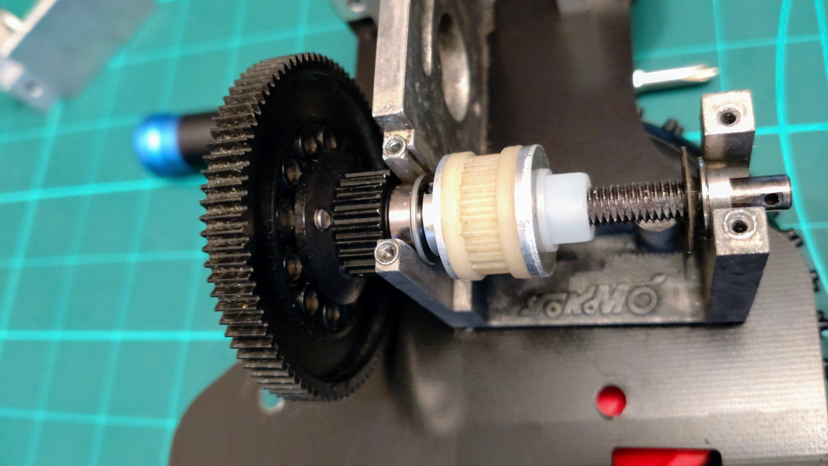

Detail of the layshaft - using the 2mm belts and pulleys. Using a M5 nylon nut on the front pulley as Masami did on his car back in 89

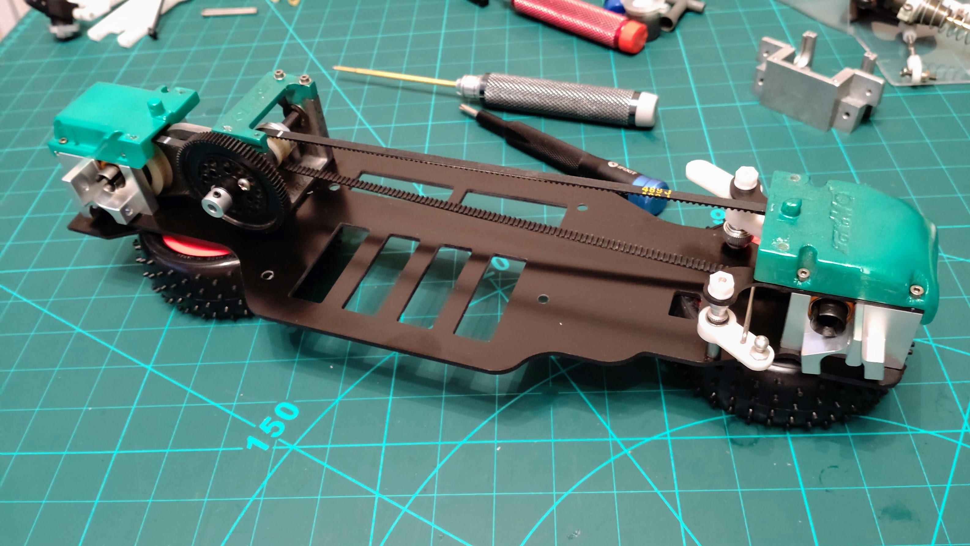

2mm drivetrain installed. The caps are from my original 870c they did not have the upper chassis mounting holes so I had to drill and tap them. They were in quite rough shape having yellowed quite significantly over the years but some Core RC green metallic paint sorted that out. The diffs are from a later YR-4.

Front and rear suspension detail. The shocks are original Associated 0.71 and 1.02 stroke. The Fan RC kit comes with new reproduction shock towers but I used some original Yokomo ones I had. I had forgotten how much of a pain e-clips were...
