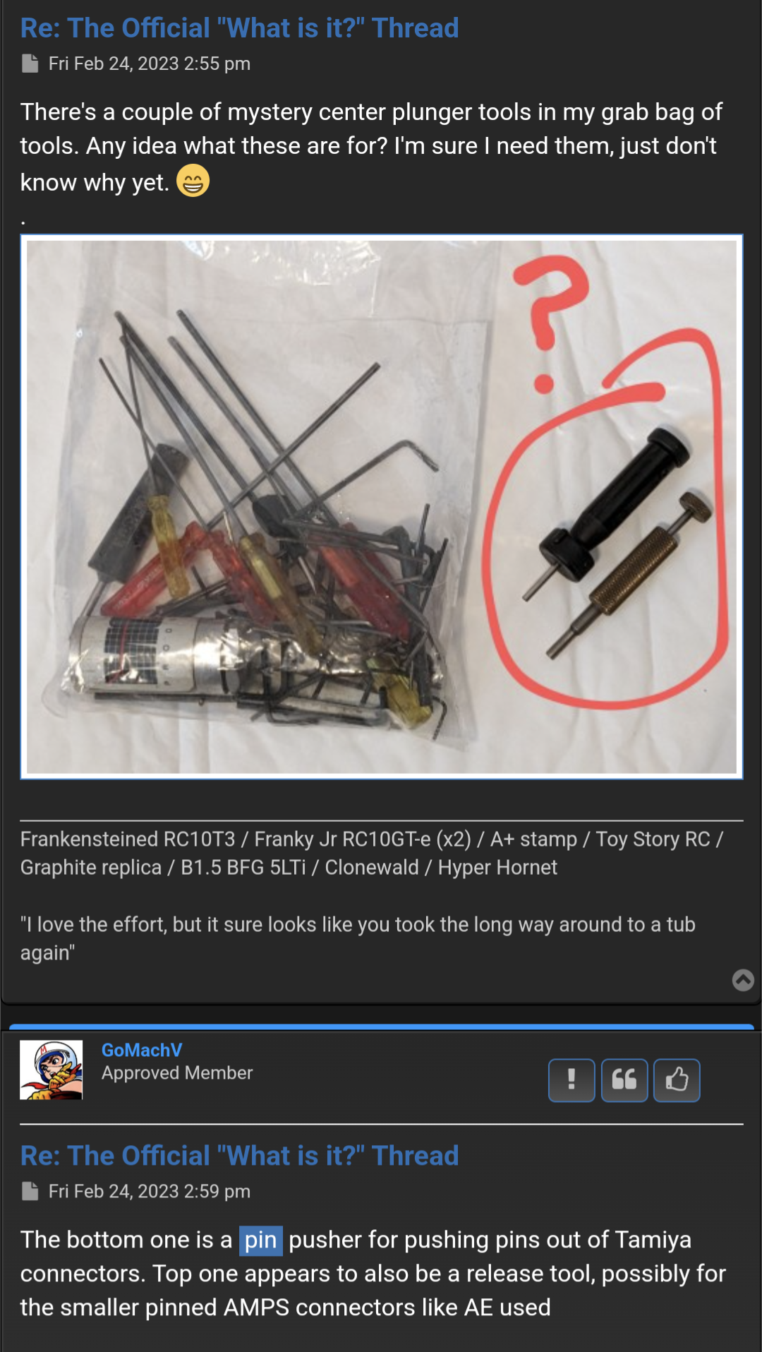

Is there a special tool to remove the Tamiya battery connector?
I need to solder the JST adapter to the Rooster plug, for the BEC. Can't figure out how to get that off without ruining anything.

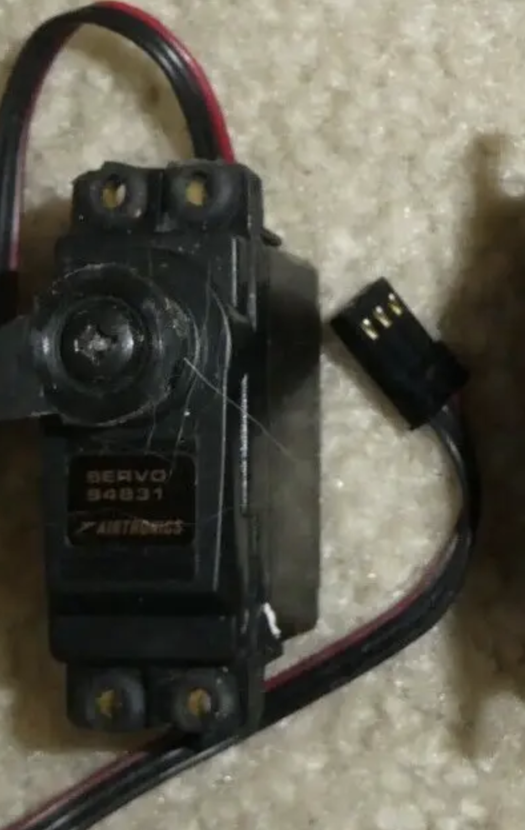

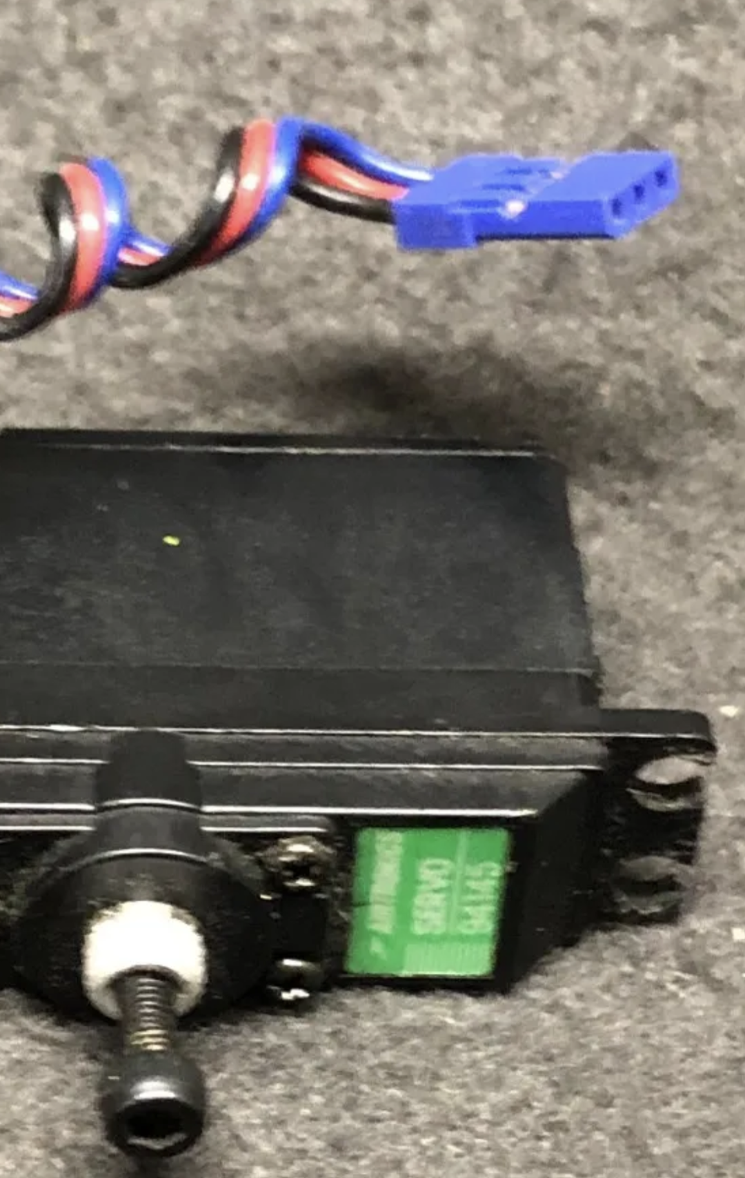

This is the difference in the old vs new Airtronics connector.

GreenBar0n wrote: Sat Dec 09, 2023 7:39 pm Is there a special tool to remove the Tamiya battery connector?
https://www.rc10talk.com/viewtopic.php?p=548015&hilit=pin+extractor#p548015
There is no need. The Rooster has a BEC. It will back power in through its three wire plug.

Frankentruck wrote: Sat Dec 09, 2023 7:43 pm This is the difference in the old vs new Airtronics connector.
Much thanks!
The pin extractor! Nice! That's exactly what I need. Now how to go about getting one :D .
