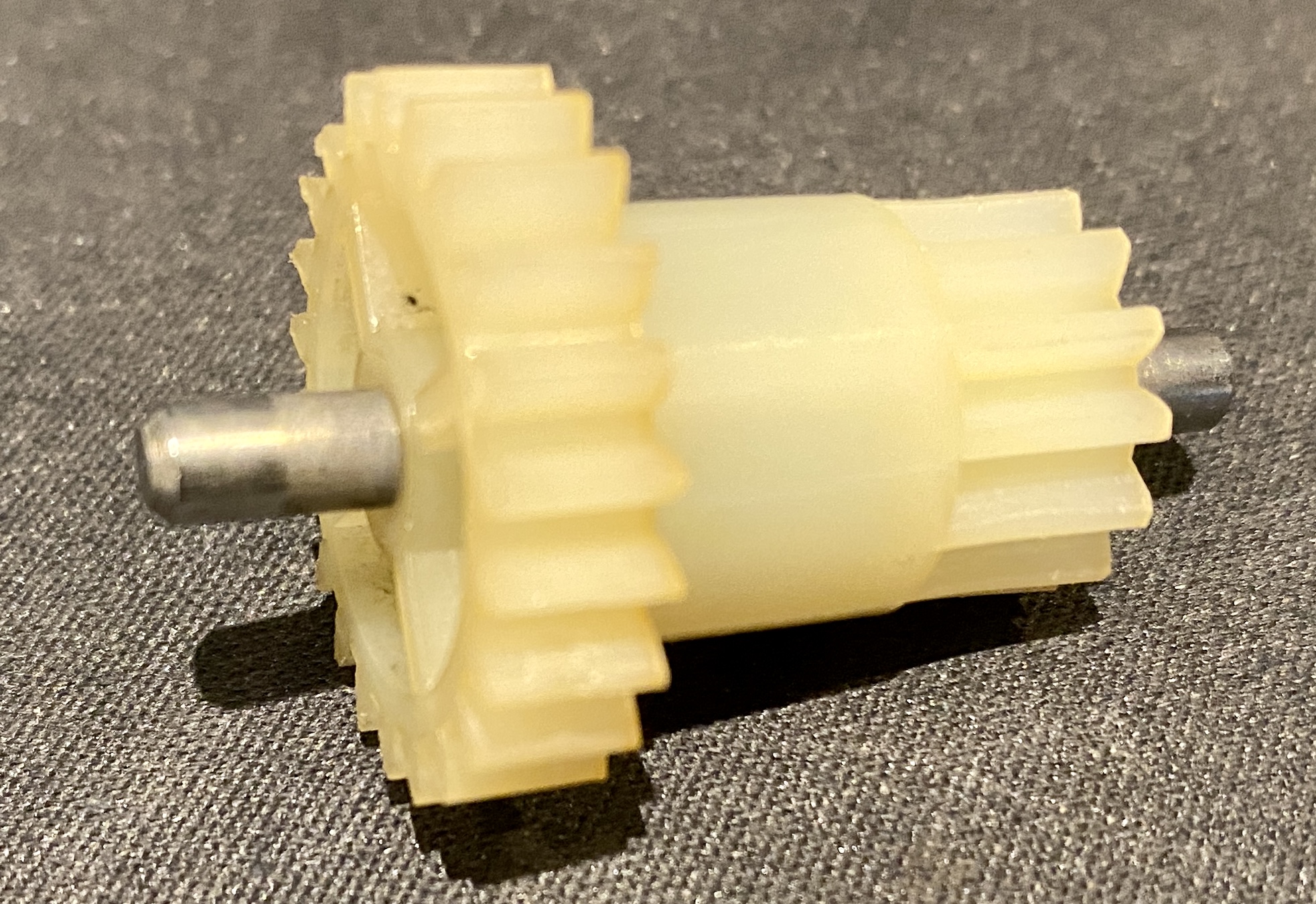

What gear is this?!
What gear is this?!
Shaft length 40.71mm
Shaft diameter 3.92mm
Small gear teeth 13
Small gear end 15mm
Small gear toothed part width 8mm
Large gear teeth 22
Large gear end 24mm
Large gear width 5.6mm
Thanks!

Re: What gear is this?!
Not familar with that car but i'd usually call that an idler gear. Its listed as part T60 in the manual but can't find its name. Someone has the manual posted on this site.Darkmard wrote: ↑Wed Aug 23, 2023 7:07 am IMG_5181.jpeg
This is out of the Mardave Meteor I’m reviving, the larger gear is really worn with the teeth at weird angles in places so I want to replace it, I don’t actually know the name for this type of gear. It’s fixed solid to the shaft, dimensions as follows:
Small gear teeth 13
Small gear end 15mm
Large gear teeth 22
Large gear end 24mm
Thanks!
Thanks, I’d seen the manual but there isn’t a page that talks about the gear box sadly! I’ll hunt around for idler gears and see what I can find though!
I believe that the correct term is counter gear.
An idle gear is a single gear that just transfers and reverses rotation.
Having said that, it is probably called something else on the other side of the world.
I don't think it will be an easy part to find, if you find something you can use then share it please
I've been looking at shimano (and other) fishing reel spares to see if I can find any matches for mardave gears... no luck tho
Also mardave have sold out of ball raced idler gears and a few other meteor bits... bummer!
So I couldn’t find a replacement so made one instead with these two gears
1.0 Mod x 13 Tooth Metric Spur Gear In Hostaform
1.0 Mod x 22 Tooth Metric Spur Gear In Hostaform
On a 4mm steel shaft, the one gear was a 5mm bore so I had to cut a short brass sleeve 5mm OD 4mm ID to fix it together, glued everything as push fit wasn’t tight enough. The ends of the shaft I had to take down a bit to fit inside the bearings. I got the bearings new too, though not actually on the instructions the case is cut perfectly for them SR155-ZZ 3.96875mm x 7.9375mm x 3.175mm
Someone recommended a 17.5T motor, any idea what would be a sensible pinion for this car, measuring the gear it meshes with it needs to be 0.8 MOD but no idea what would be sensible tooth count to use!?
