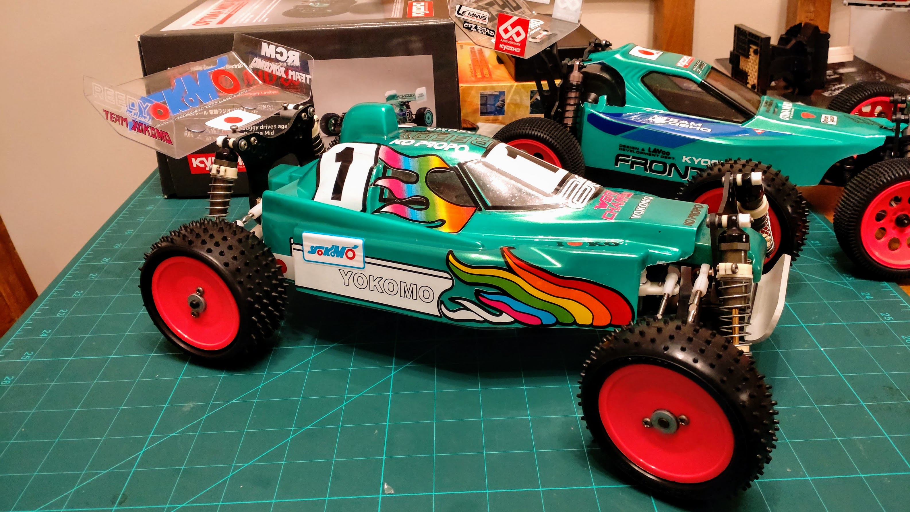

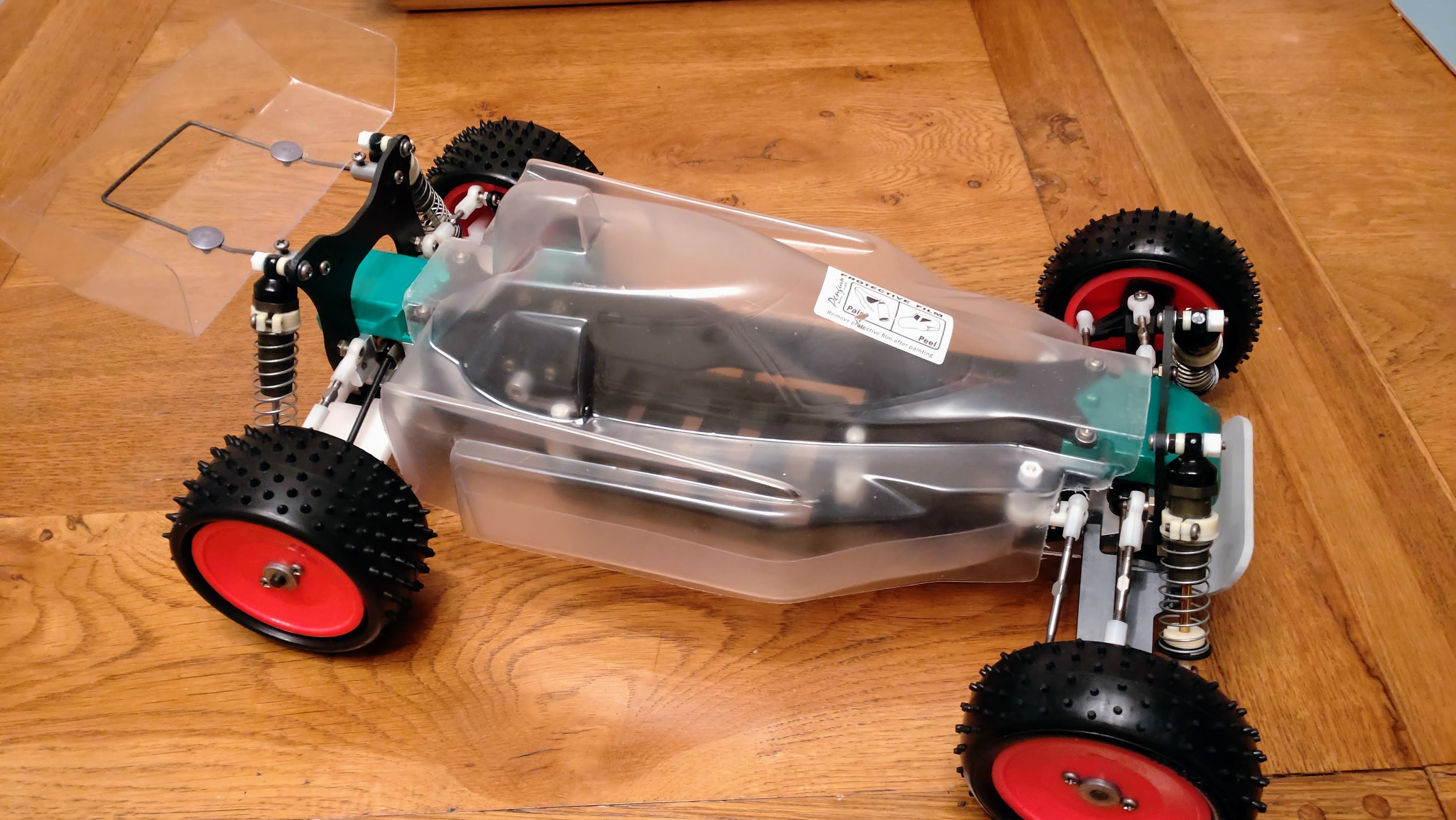

Completed car with body from Penguin, the wing is also Penguin one. I'm unsure about the wing buttons they are a similar colour grey to Yokomo 870c shocks. The wing wire came with I think a Buds wing from back in the day. The tyres are not correct for an exact replica but they are vintage Yokomo Hotlaps, the wheels are JC racing.

Looks good! What did you use for universals front and rear?

Yokomo ZC-422 for both, I had to use spacers to push the shaft inwards on the front to get them to sit correctly in the diff. I think for a runner it would be better to use the ZC-423 later YZ-10 ones as they are slightly longer or you could just run original front wishbones and not the rear ones on the front. If I decide to run her I'll pick some JC Racing or FAN RC ones up or do the arm swap, the cost would be about the same.

Painted, the MCI stickers area bit off but acceptable.
