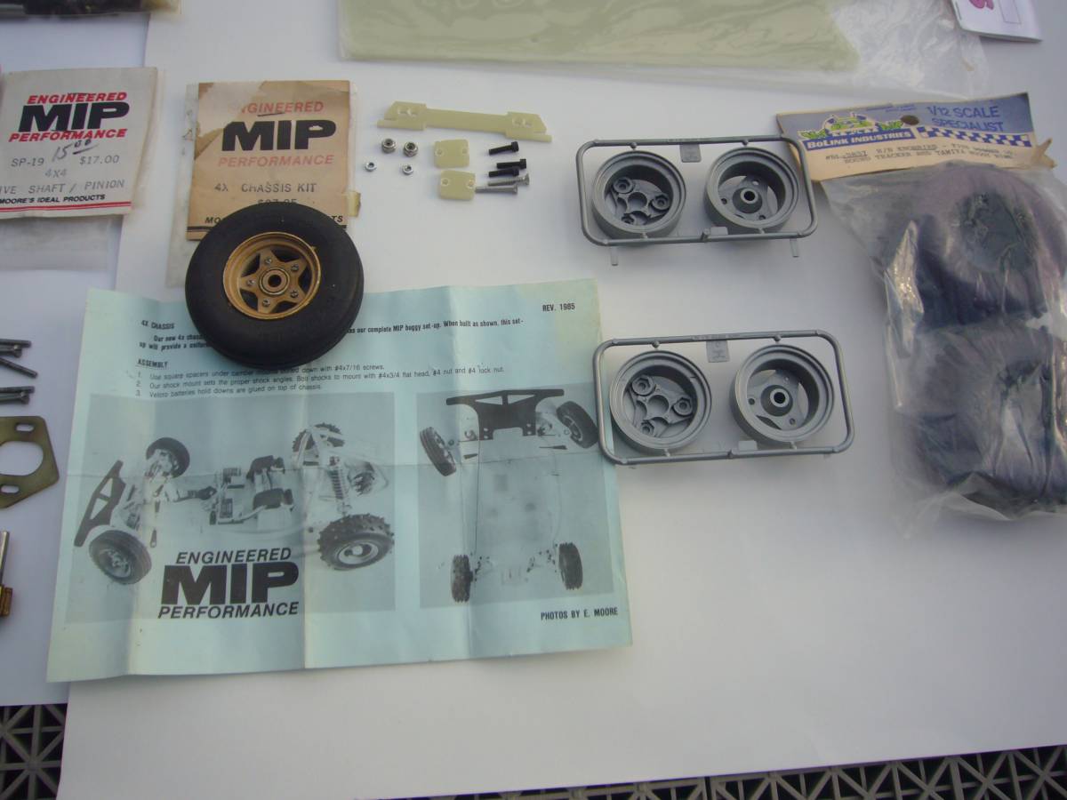

Hi Guys,
I'm wondering if anyone can read the full line of text next to #1 under assembly please?
'1. Use square spacer under.......xxxxxxxxxxxxxxxxxxxxxxxxxxxx...down with #4 7/16 screws'
I'm trying to figure out what to do with the spacers in my MIP4x400 SRB build.
Thanks to anyone with eagle eyes or a clearer copy of these assembly instructions!

Use square spacers under (maybe) camber ####### ########## ######## with #4 x 7/16 screws. Sorry that's all I could make out.

yeah, that word could be camber... thanks... 1 down 2 to go!
I can't find a scan of these instructions anywhere on the web. The photo I attached was from a yahoo auction

I have a clear instruction sheet. "Use square spacers under camber mounts bolted down with #4x7/16 screws"

My next question is what/where exactly are the camber mounts

About 1/4 of the way down this page http://www.toybaron.com/MIPreference.htm there is a red-wheeled color photo (might have been one of Shodog's) that shows that the camber block bar of frp (if that's what it's called) presumably those two little square frp parts as spacers to elevate it off of the chassis? There might be other photos here that help. For SRB's in general (even without the MIP conv) there was a common mod to lower the center of gravity of chassis by putting frp blocks under the tranny/suspension unit and front shock towers. These might be essentially doing that.
