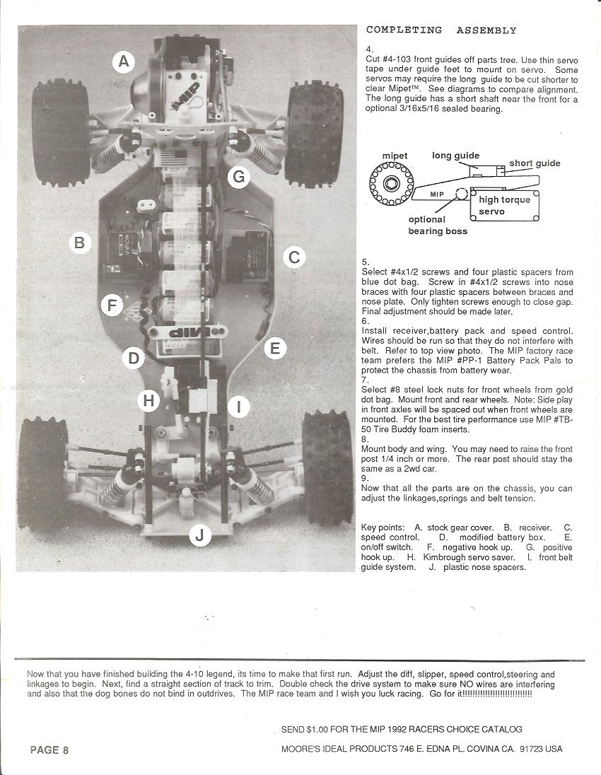

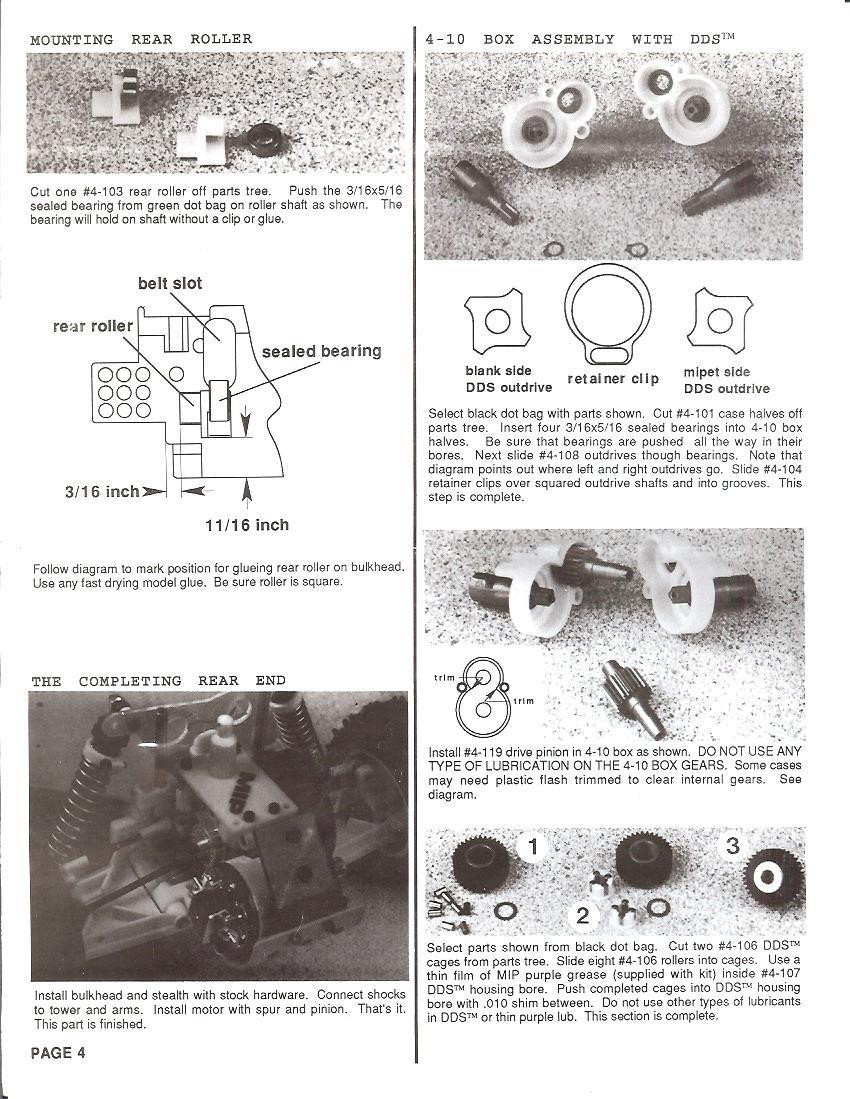

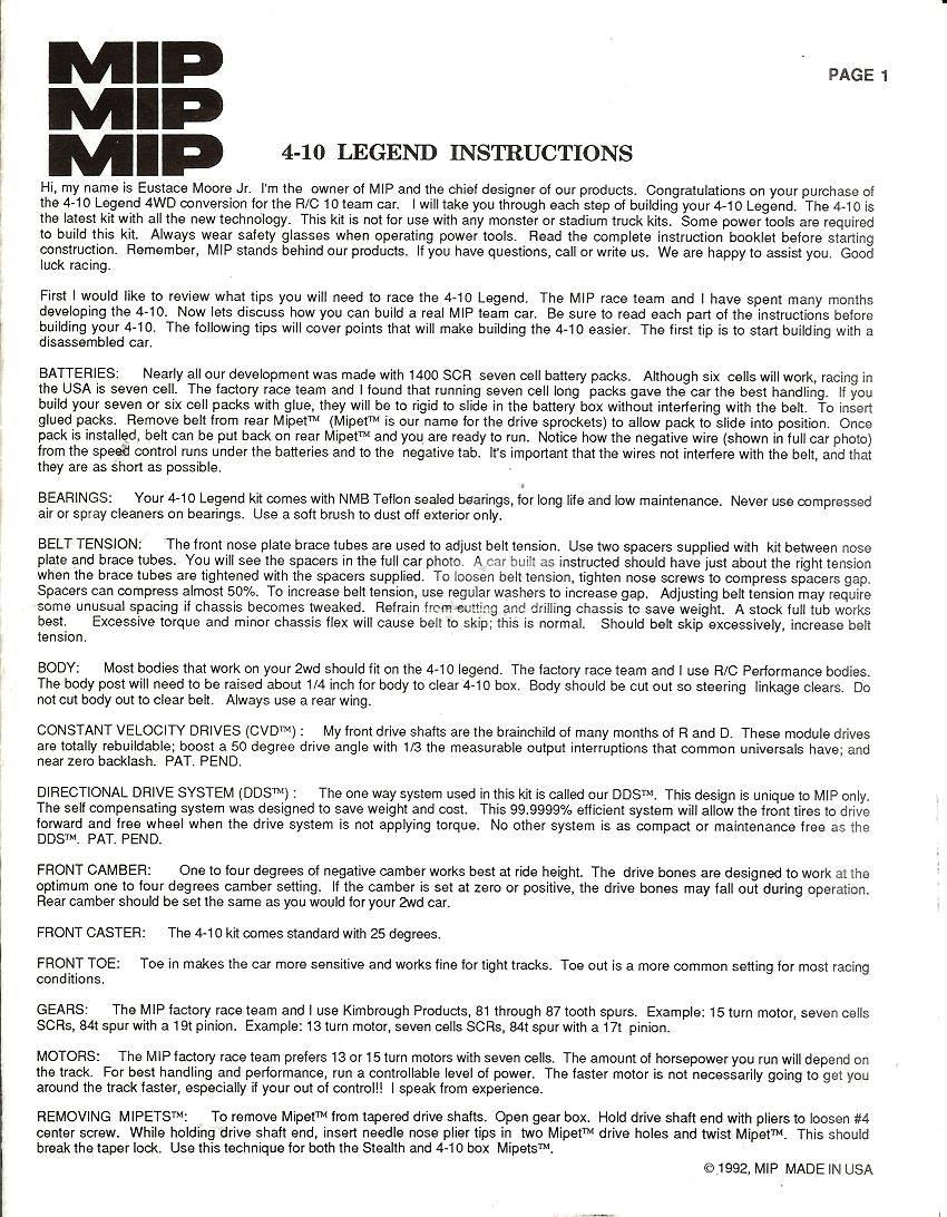

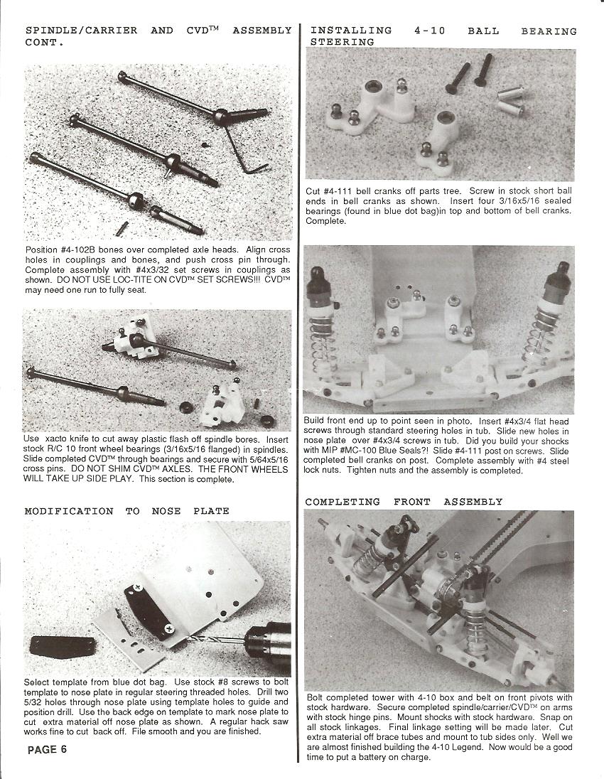

MIP RC10 Legends Installation Instructions
