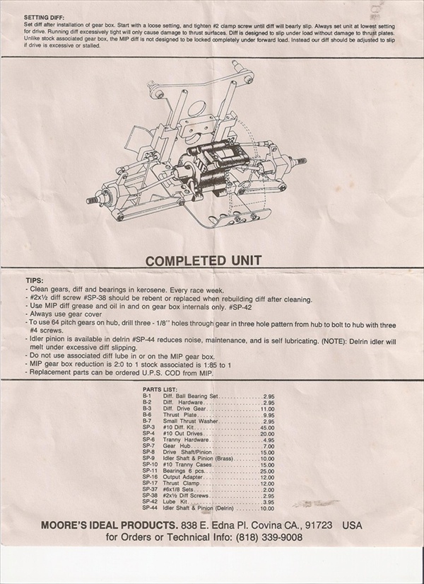

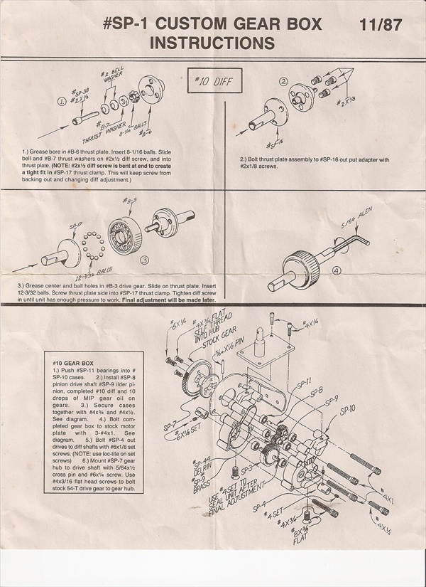

MIP Gear Box Instructions
Post by tizeye »
As always if you require a full size version just pm me..
Pete

Re: MIP Gear Box Instructions
Post by CoalTrain »
Are these the instructions for the gearbox I have? I want to tear it down and clean it up so I can run it again.
Post by mrlexan »
Yeap, that's the same thing.
