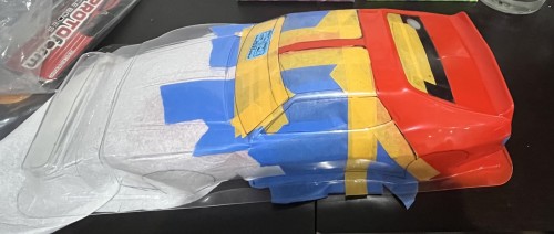

Starting on the paint. Trying to keep it simple.
I’m also making a few changes. I am going to try wide drag slicks on the rear and see if that helps with on power traction.
I also need to add covers for the cvd, I had one fly apart.

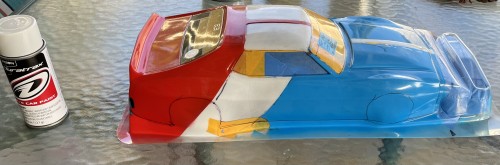

The bulk of the paint is done
Now it’s on to the front end, tail lights and exhaust.- Dangeruss

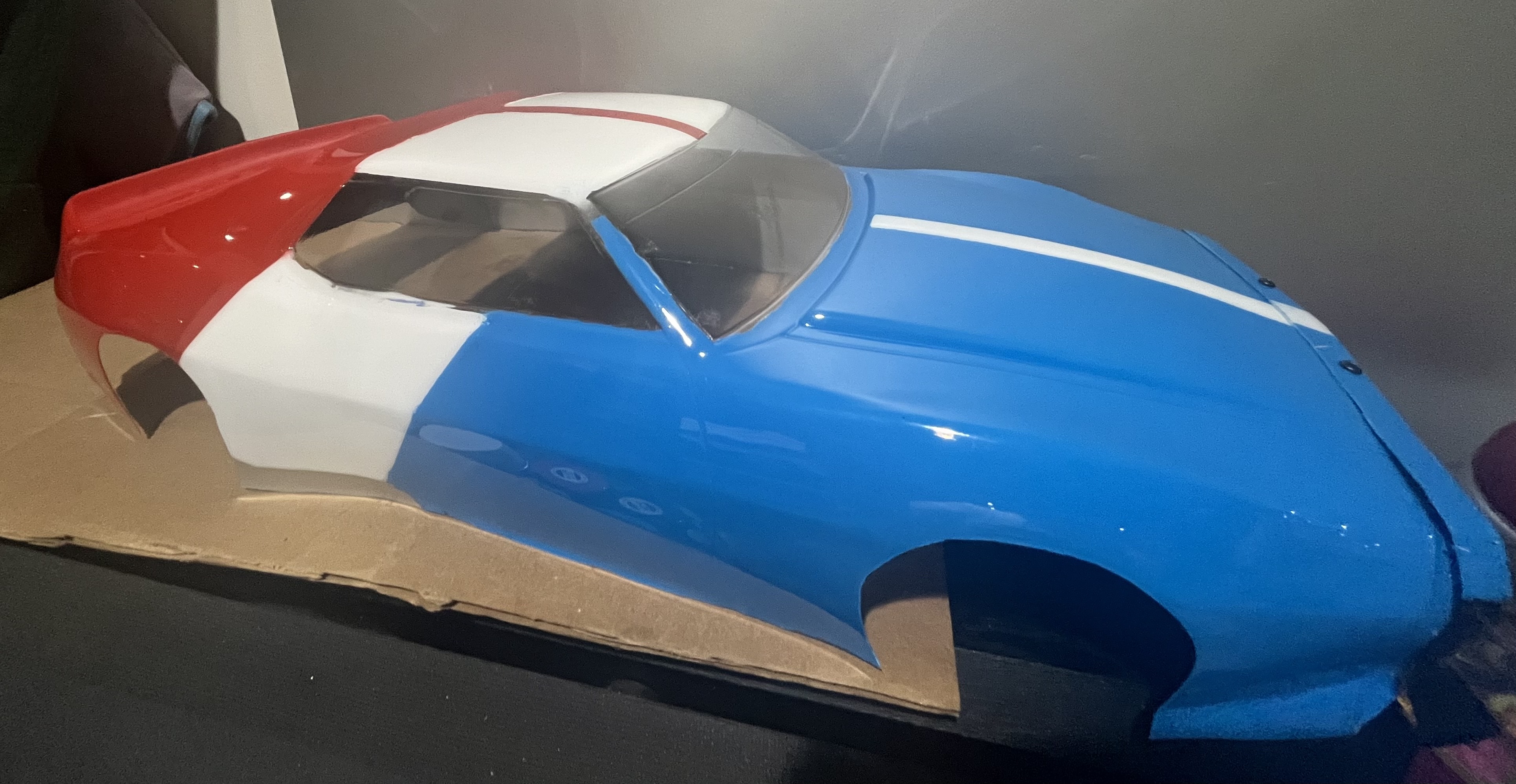

I was really happy with how the paint went down. Masking with tape was challenging. Something went wrong with the masking for the blue, I used magic eraser and was able to remove the unwanted paint. It didn't seem to haze the body. I used many many very light coats of paint. I was able to get into the crevice of the trunk with out drips. That was a neat technique I just heard about.
I still need to work out the nose and the tail lights. It came with an extra nose so that's less stress. There are some nice decals. I may just back them black and call it a day.
