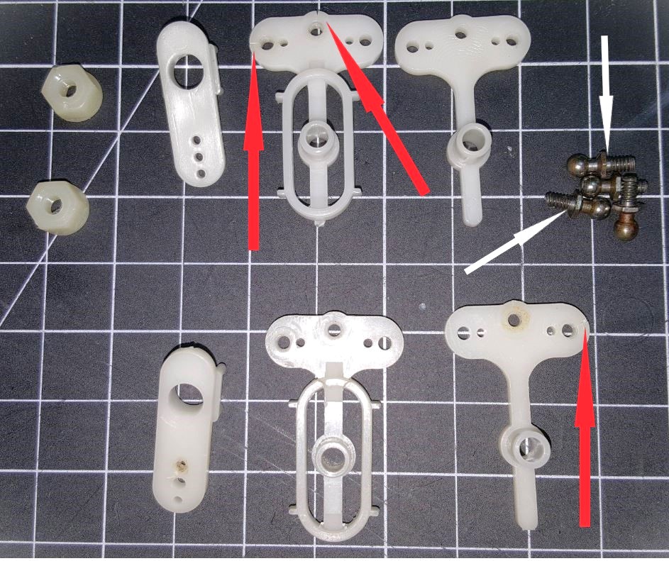

All of the steering parts are cracked in some place. One set is original, the other looks like an early repro, the texture is rough.
Going to order the steering parts, and pack this up for the moment.
I've always wondered if the non-threaded portion of the ball ends ( just under the hex ) tends to add additional stress to the holes that tend to crack.
At least I don't think it helps.
I have used a small countersink and a 4/40 tap on those holes. On the bottom side of the servo saver a thin 4/40 nut secures the ball end.
Hopefully AE will start releasing parts soon to help.

radioactivity wrote: Fri May 31, 2024 7:55 pm
Chuck
It was odd to see them broken in every ball location like that. The 40th parts seem to be not as brittle, I'll try those and put the originals in a bag.
Thanks guys!
Chuck
I think you're right about that Chuck.
And prepping them as you've described is a great tip.
I have the FanRC set and although they are very nice, the color isn't quite right (too beige) so they stand out as non-AE parts.

XLR8 wrote: Fri May 31, 2024 9:07 pm
Chuck
Just ordered the Fan RC steering assembly last night, you're right, it is really beige instead of white, in the pics.

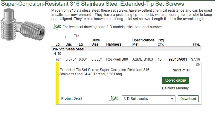

But the notch in the Bud's #2110 Diff Ring, is not wide enough for a 4-40 set screw.
Going to have to drill the Bud's rings a very slight amount wider and taller, in order to get the set screws to sit flush. Tightening the set screw now, only lifts the ring up off the hub. I followed the instructions as close as can be, not sure what happened here, or if this is a set screw from China, that exceeds tolerances of when the guide was written. Will pick this back up tomorrow.

This may not be the answer but an answer.
There are several tip types for set screws.
McMaster-Carr shows one of a couple that could possibly work. The .075 being the tip diameter.
Probably several other methods to solve the fitment issue.
I can't remember if I ever ran across this years ago, not saying I didn't, just don't remember.

radioactivity wrote: Sat Jun 01, 2024 2:58 pm This may not be the answer but an answer.
Chuck
Those look quality. I'll see what I can do with what I have here, and if I can't get it to go, I'll pick up the ones you linked to, thanks for that!
If the requirement were to just keep the ring from spinning on the hub, I think I have achieved that so far.
But if the set screw has to be exactly flush with the ring face, I'm off a bit.

This seems like a good application for a roll pin.
It could be pressed through the hole then cut with an abrasive wheel slightly proud of the ring mounting face.
No threading necessary and the pin's cylindrical shape would provide a good fit to drive the notch in the ring.
Anyway, Jim was a master at building world championship winning RC's so I'm certain he consider all options before landing on the set screw idea.
