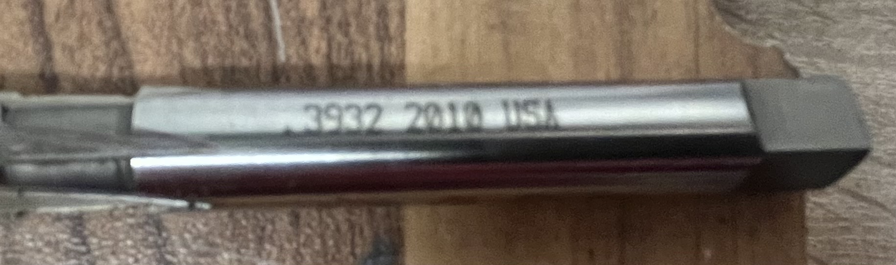

JosephS wrote: Fri Jul 16, 2021 12:02 pm For anyone curious. I did one block using a drill bit as out lined and was unhappy with the fit, though it did fit and work. I tried a 10mm reamer next.
I will confirm using a 10mm reamer on steering block will not work. It removes too much material from the rear of the carrier to seat the metric bearing. It fits and is smooth but the rear bearing has no support.
For making 10mm bearing holes I use a .3932 inch reamer which translates to 9.9873mm which makes a niche tight fit. I’ve also used 9mm OD bearings with approximately 2 layers wrapped around to fit into 3/8” bearing holes. Saves the need of drilling.
