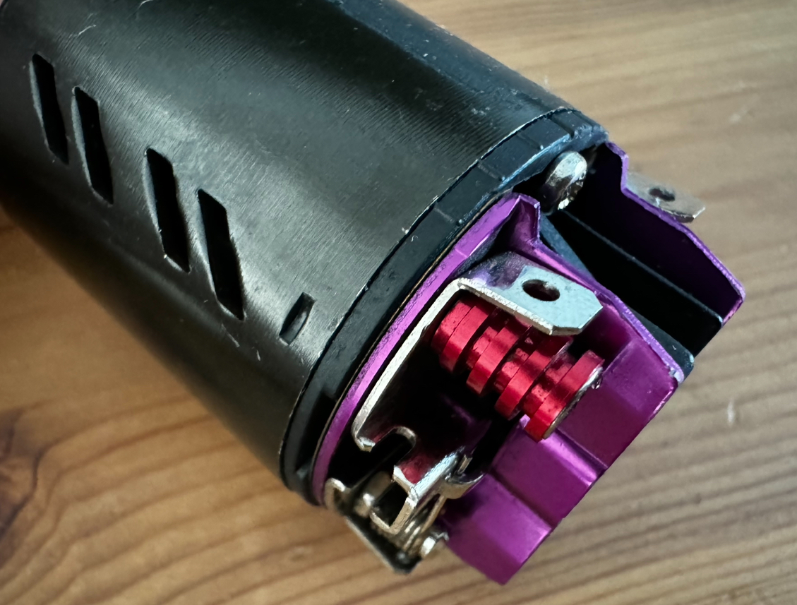

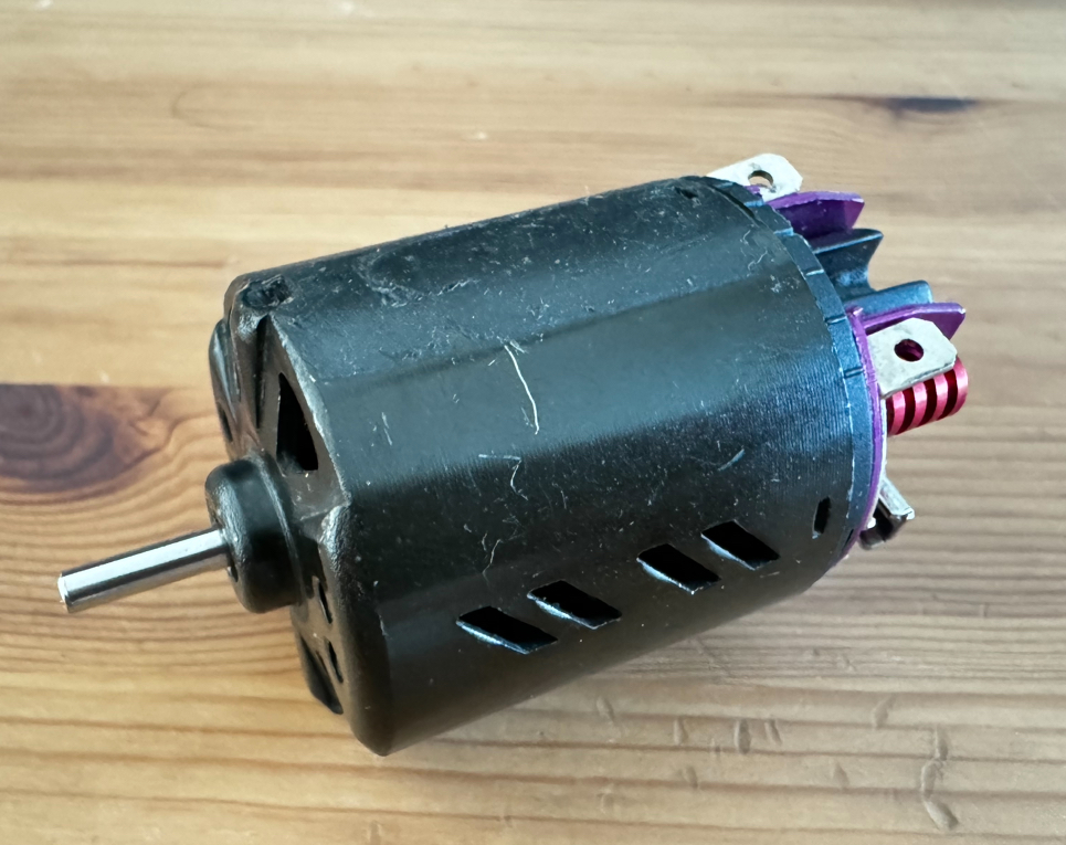

Can anyone ID this motor?
Post by Lizardking »
Its a single wound. Its missing the label.
Posts: 3540
Has thanked: 269 times
Been thanked: 2095 times
Re: Can anyone ID this motor?

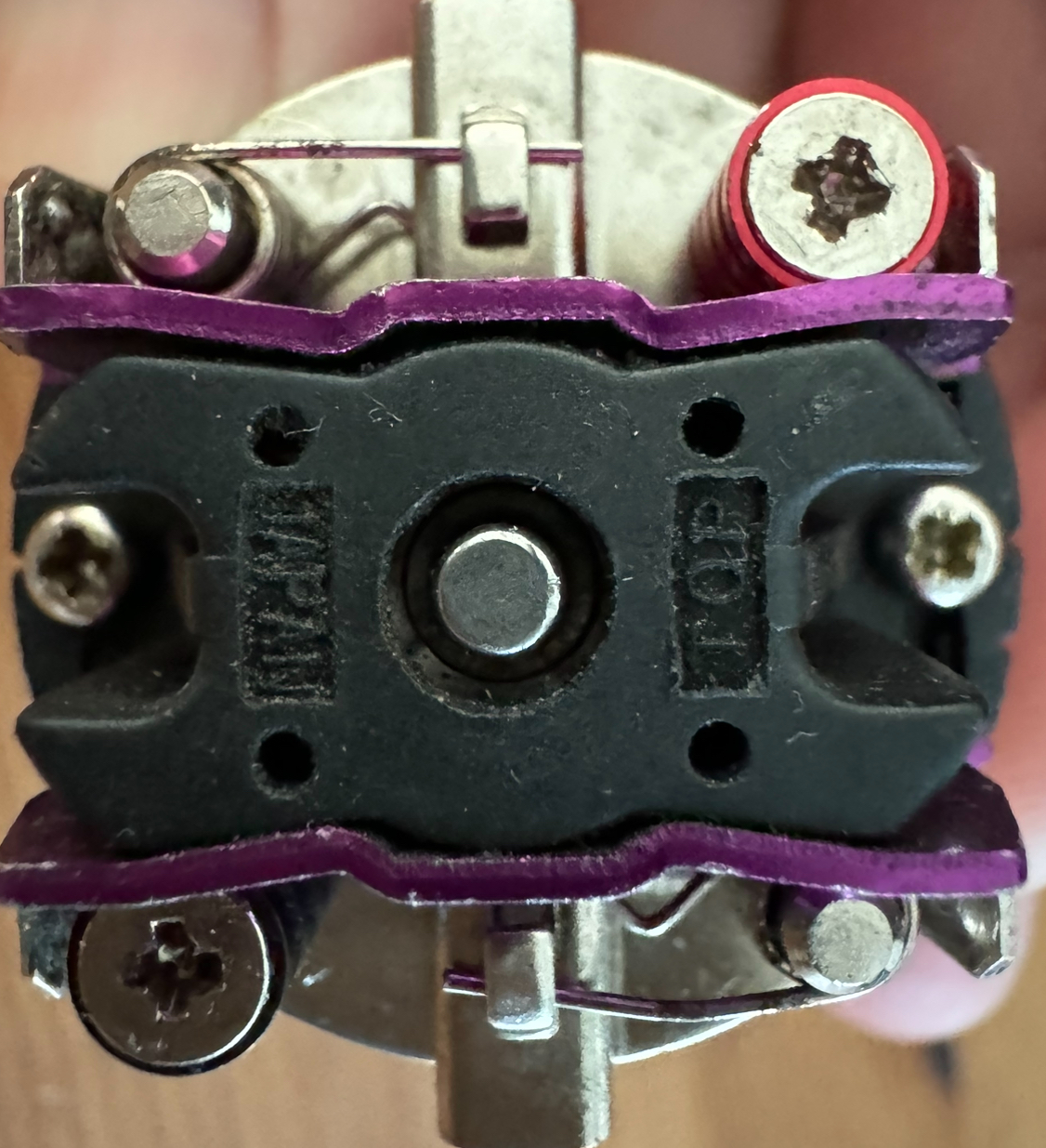

It is a Team Orion/Peak (TOP). I have several, with different color heatsinks. Lots of different labels.

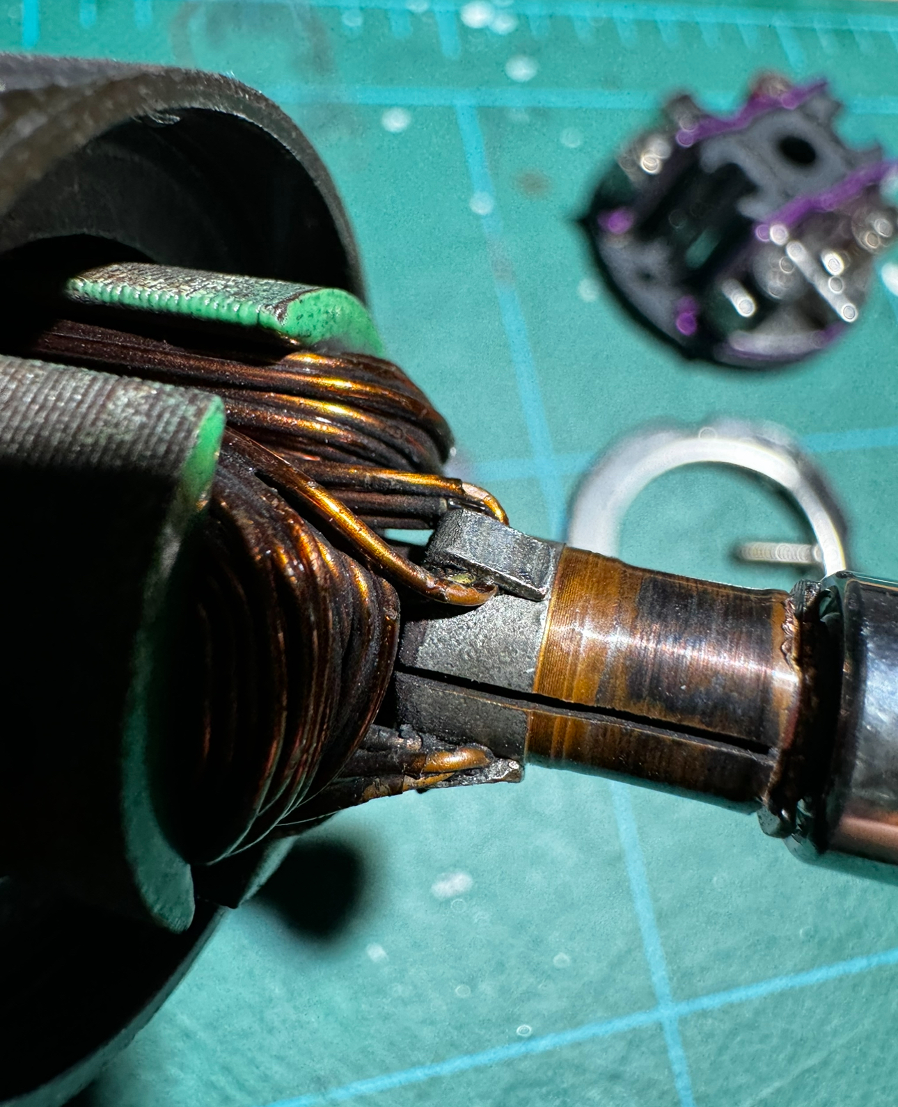

Opened it up and its not a single like I thought, its double wound. Maybe 16 turns? Idk. Commutator looks very worn.

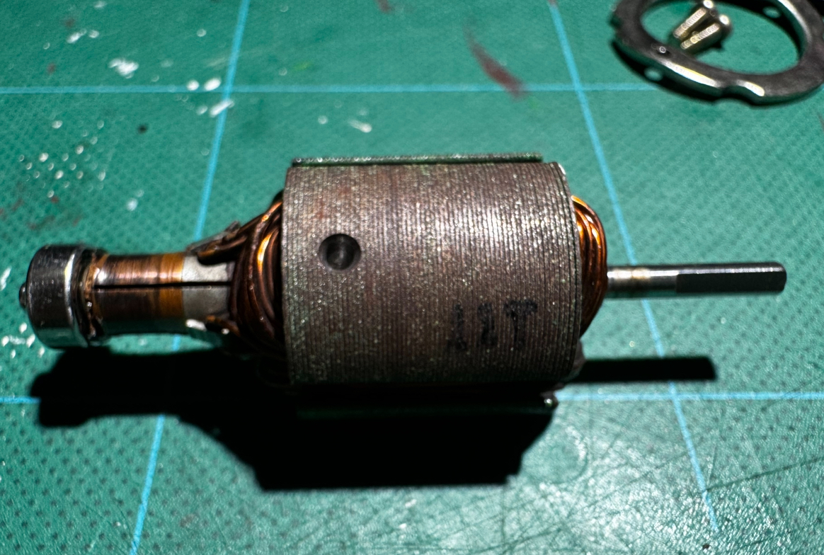

I pulled the rotor out and its is marked “12T” which I guess is 12 turn. (I was way off lol). A 12 turn is a pretty hot motor. Lowest I ran back in the day was a 16turn.

Lizardking wrote: Fri Aug 16, 2024 7:43 pm Commutator looks very worn.
Yes, it is near end of life.
It "might" survive being cut on a lathe, depending on how well the copper was cladded to it. I've seen some that could be cut until the end and others that started peeling and flaking away.

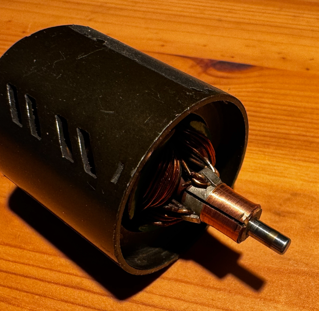

Ok not ideal but put the rotor in a cordless drill at high speed and put a bit of 240 grit sandpaper against it.
Posts: 3811
Has thanked: 2606 times
Been thanked: 2980 times
Maybe polish it with a strip of 1000 grit wet/dry sandpaper.
