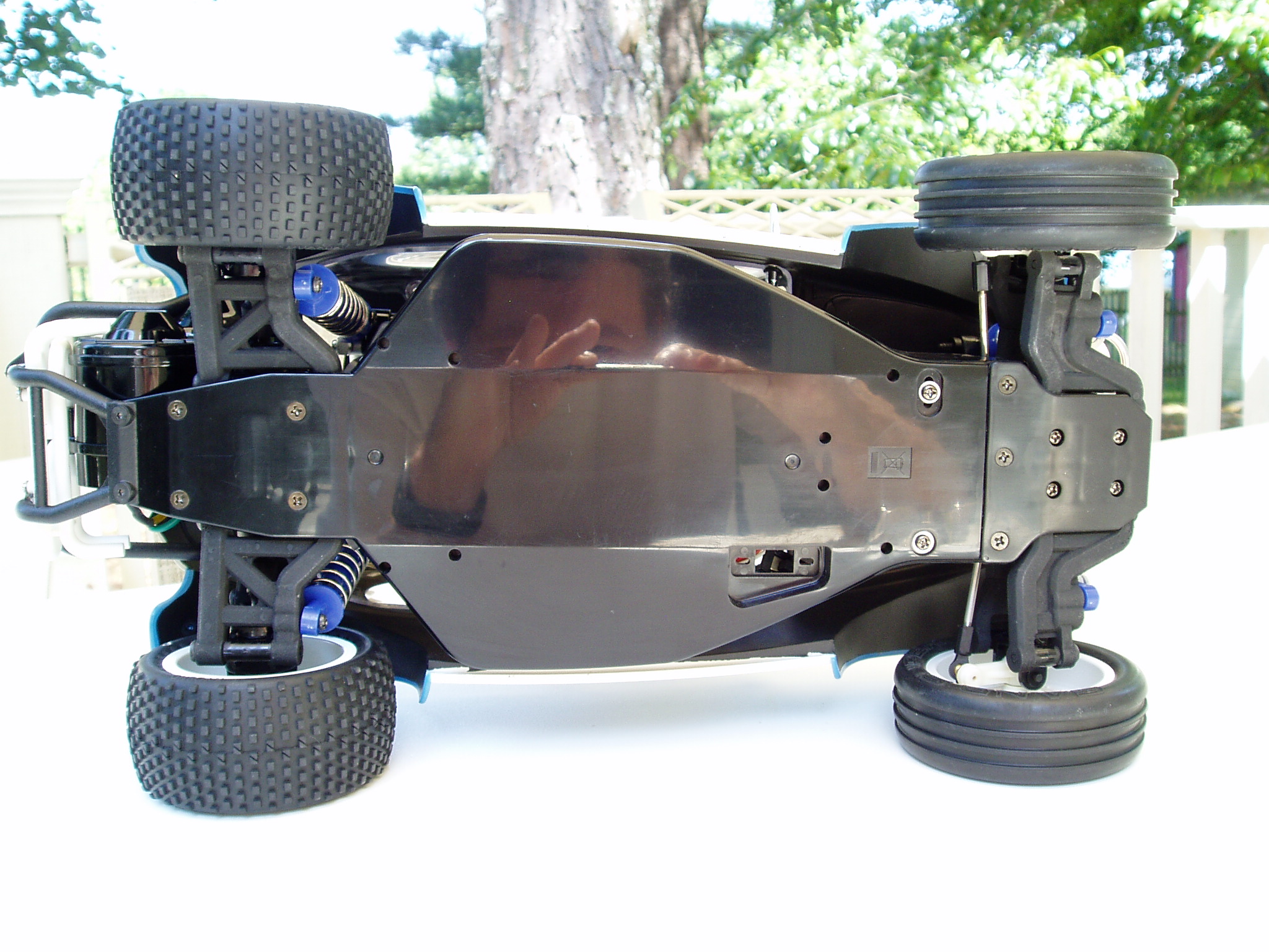

Hmmm, I'm wondering if a Tamiya M06 chassis would fit your DC body.
The M06's wheelbase is adjustable: 210mm, 225mm, 239mm - is that still too short?
For width, it measures 5.9" across the wheel mounting faces on the hex drives. That leaves ~0.8" per side - might work if you mount wide wheels with plenty of offset and maybe some wider hexes?
The M06 has a buggy style rear mounted motor - just like a VW.

The MST TCR-M is about the narrowest 1/10 touring car I know of at 164mm (optionally 173mm) but, even with their optional 245mm chassis plate it comes up about a half inch short of the Apex2's 259mm wheelbase... which looks like it lines up with the wheelbase of the body, yeah?
Other options exist, like XLR8 suggested, in Tamiya's catalog of cars... possible one might meet the width/wheelbase needs of the body.
Though, do you know the offset of your wheels? Both the 26mm and 31mm were available in 0mm offset and wider 6mm offset. The 6mm offset wheels allowed 190mm cars to run 200mm bodies... If you have the 6mm offset wheels then finding a set of 0mm offset wheels would solve the problem.
Some other thoughts...
Thinner hex drives could be a solution. Might need to clearance the steering/camber blocks if they're too close. 3mm narrower hex's gets you the 1/8" you want per side... provided the factory hex's are 5mm or more thick.
Also like how they make adjustable offset wheels to widen the track, RCaidong, Hobbysoul, etc, make them to narrow the track width as well... from 0mm to 6mm out of the box, which would make them up to nearly 1/4" narrower per side:

The DC body is 260mm wb, and my M-06 is 239mm, I tried to fit it in as many different ways as I could, M-Chassis are a no go with the Touring body.
On my M-06 Bus kit, I was able to fit the HPI 31mm +6 offset wheels, behind the skirts and with no rubbing, but I had to do that old ugly trick they do on real VW's when they go too low - negative camber.
Hard to tell, not too extreme, doesn't rub.
Last night I tried to buy the Tamiya 911 RSR Touring kit, it comes with the cheapest TT-02 chassis and the 911 body. I offered the guy $120, and he declined, will up the offer to $125 today, he wants $128
To get the DC body to work, I'm going to have to get the TT-02, or play with negative camber to get behind the wheel skirts.

Okay, let me make another suggestion.
You've chosen a chassis with the correct wb BUT track width is wrong. Let's adjust the track width with a custom set of arms.
I've done that here with this Scorcher project. This build was based upon a DT-02 chassis but the wb and track was wrong for the Scorcher body and wheel/tire package I wanted to use so I corrected it with some purposed designed and printed arms.
Shop around and select the exact wheel/tire package that looks best with the DC (don't worry about width or offset), shoot me the wheel dimensions and desired track width so I can design a set of arms that will bring everything together.
I have the TT-02 digitized so adjusting the arm lengths will be quick and easy - no cost whatsoever. I can send you the files and you can have them printed.
I use iMaterialize for printing - they'll accept my files (no need for conversion) and their prices are competitive and turn-around is quick.
I very much enjoy doing this kind of work so I'd like to help if I can.

Negative camber is not bad thing though, this is how it's done in the VW world, for decades now. It's hard on the spade axles in the real world, not too much risk at 1/10 scale.
Too extreme of negative camber is goofy looking, but in my Northern CA high school in the mid 80's, there were more than a couple of the beetles with extreme negative camber, with license plates like SlowNLo.
My real Bus is lowered, not slammed, I put a Squareback Type3 transaxle in it, and removed the Bus reduction gear boxes, so it sits level with no negative camber, and will do 80+ mph.
Thanks again for the arms offer on the TT-02! Need to decide on the 911 body and cheapest TT-02, or the TT-02R.
