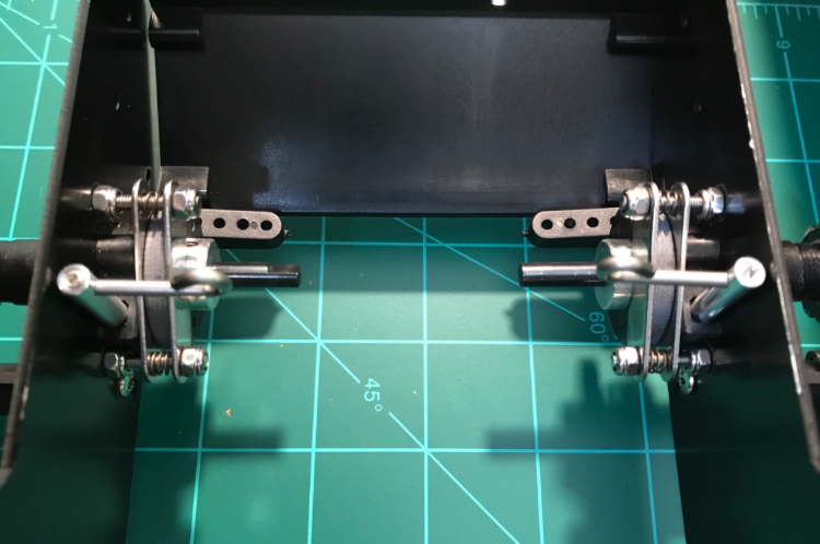

@BattleTrak
Nice tracks! Now I want to build a Pistenbully with those. Also, your steering horn and linkage are really well done.

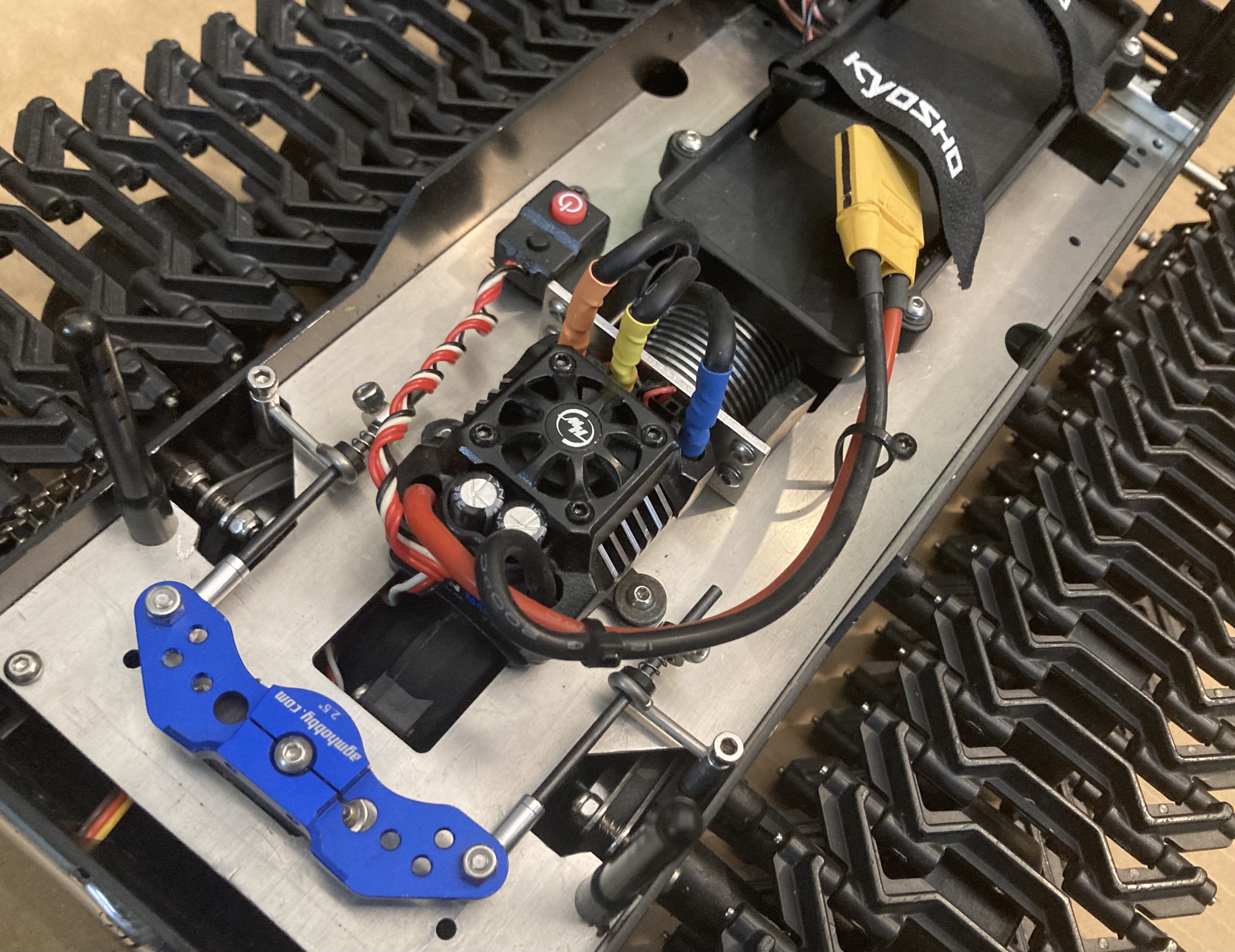

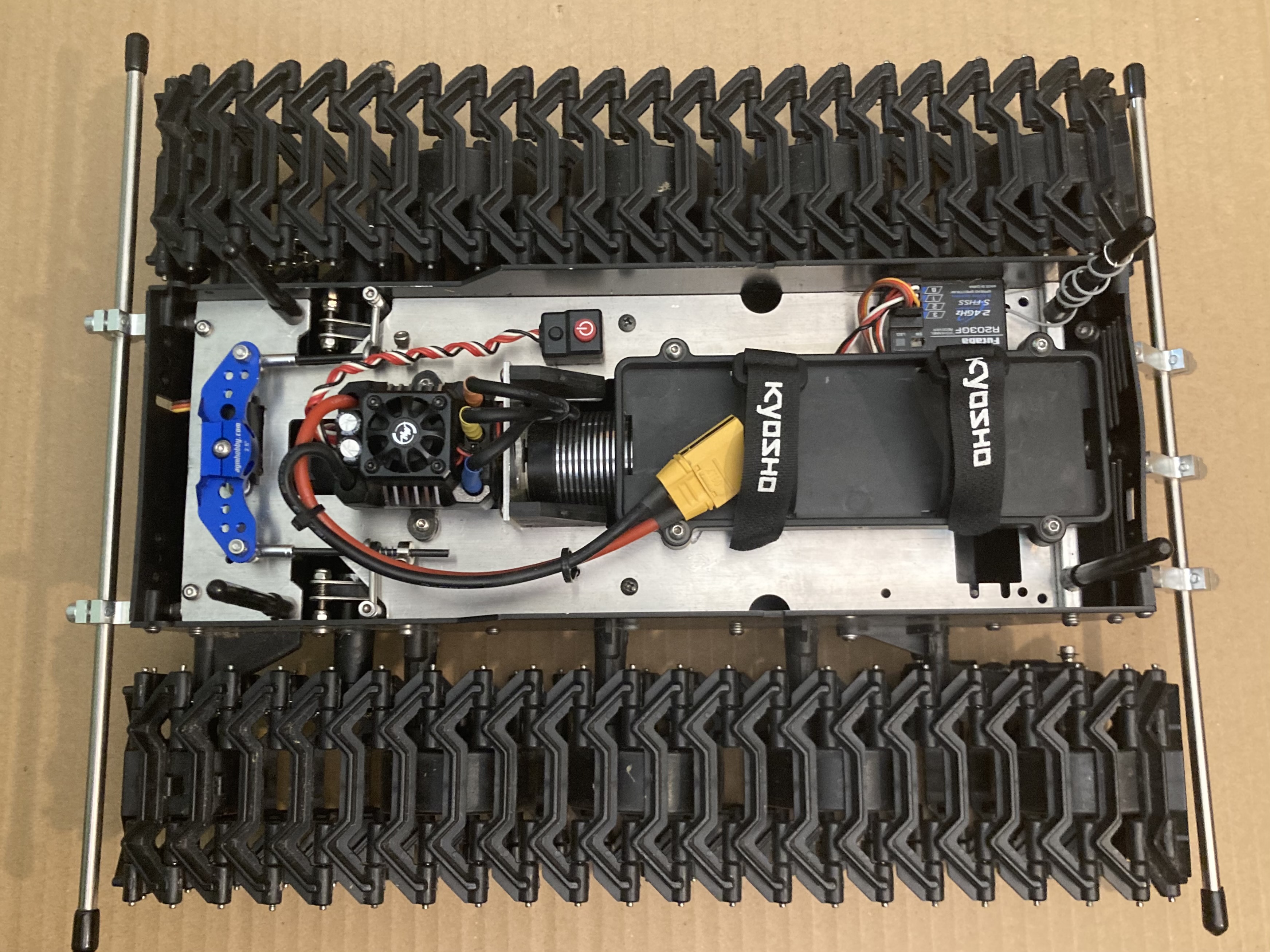

From my experience..pushing 30mph…. the soft, flexible stock tracks are the biggest speed/power limitation. They will easily peel off and/or get damaged if you turn too fast or catch a stick in the yard..no matter how tight you adjust them. The tracks I have on that modified are the Spyker injection molded ones, which are awesome, but unfortunately no longer available.
The fragile suspension parts are another obstacle…
My front brake setup has carbon discs and are finely adjusted so that just a micro servo is all that is needed..also notice the springs between the brake pads to prevent dragging. It really doesn’t need much effort to steer and you don’t want them to be too strong because it will cause a wipeout or cartwheel which will damage all 4 corners of the suspension..which is why I have the wide stainless steel rod bumpers.

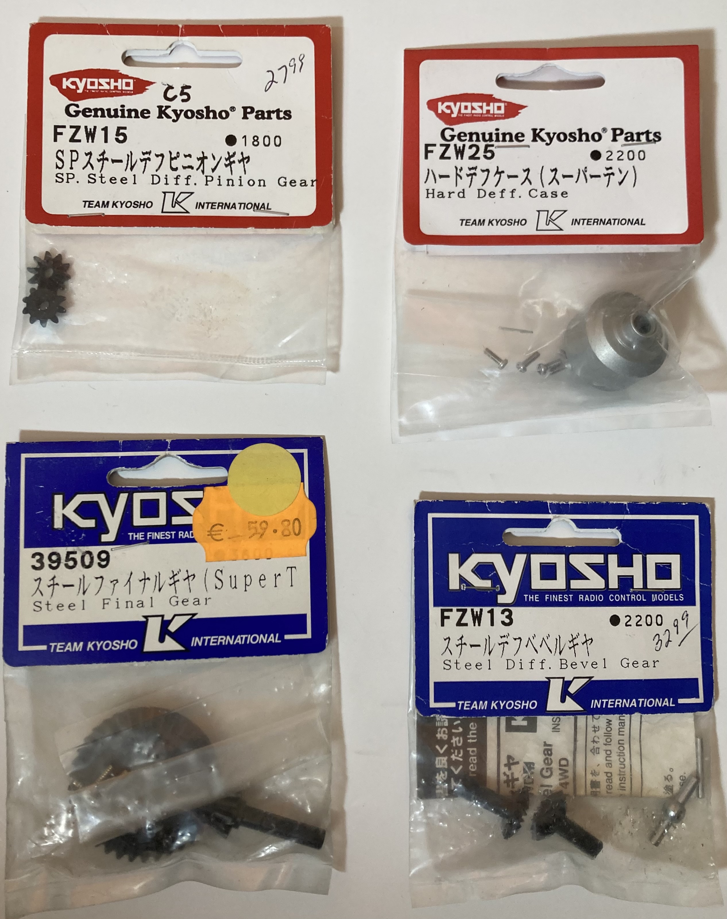

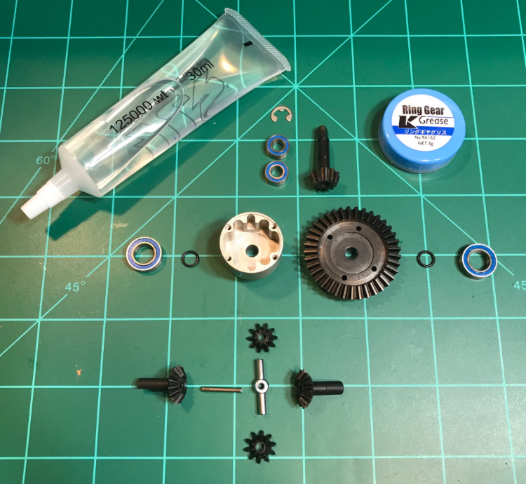

These Blizzards also share the same diff components as the Super Ten and can be upgraded with steel gears and aluminum diff case.
Kyosho 39509 - FZW13 - FZW15 - FZW25
-Brad

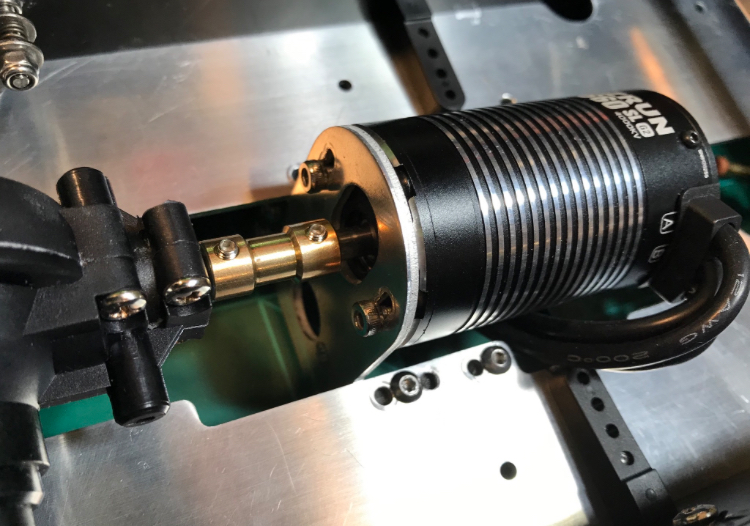

It has the Hobbywing EZRUN Max10SCT-3660-4000kv combo direct driven to the diff. I was originally wanting to use a 3S Lipo but there is so much violent power there, I cut it back with a 6 cell Nimh. Even then..If you go full throttle from a stop it’ll flip on its lid like a turtle! Any wipeouts at those 20+ speeds will destroy the BL6 & BL7 suspension parts..which is why I have the bumper rods…and I’ve tried carbon fiber, aluminum & titanium rods.. only the stainless rods can handle the abuse.
