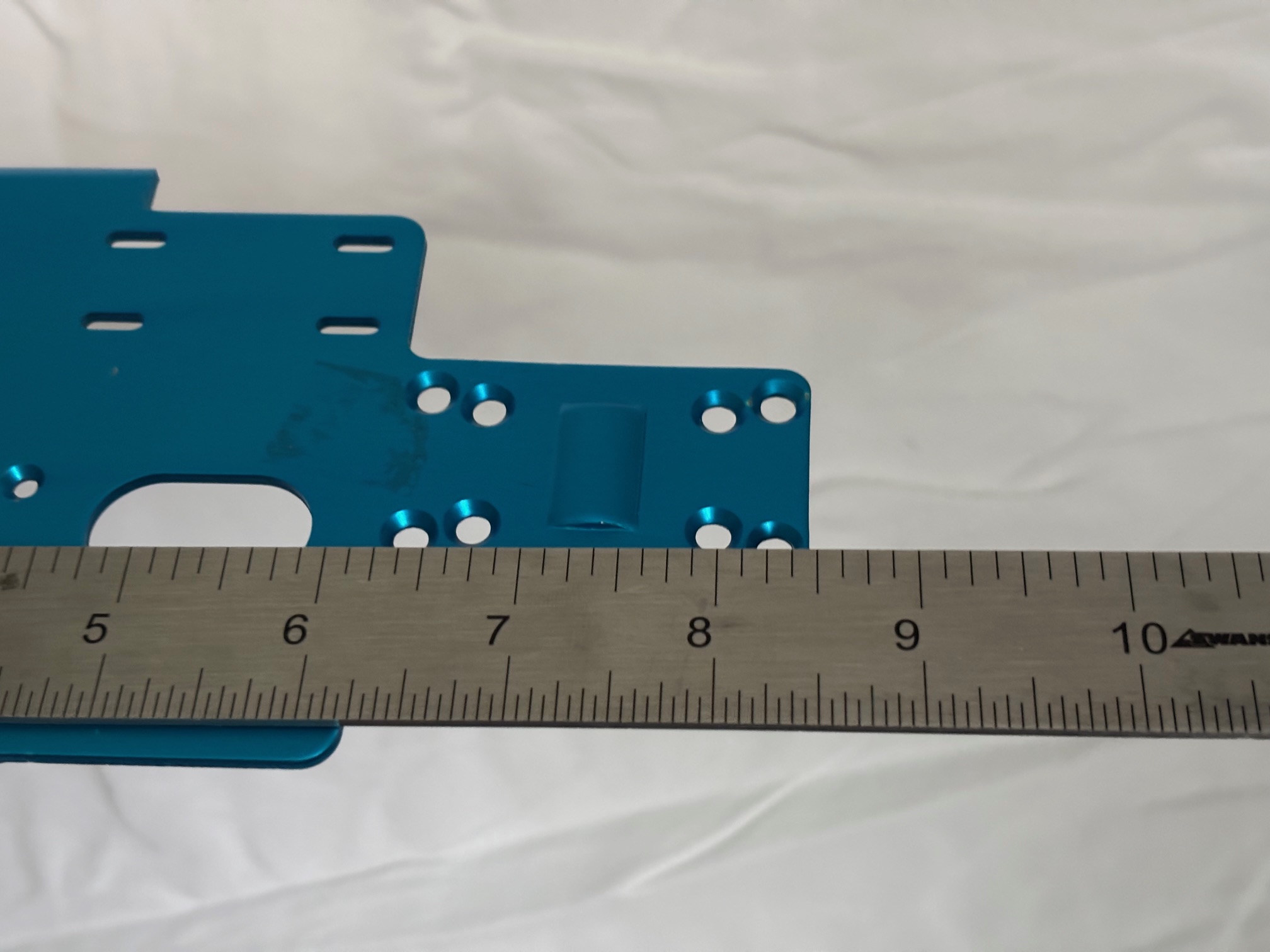

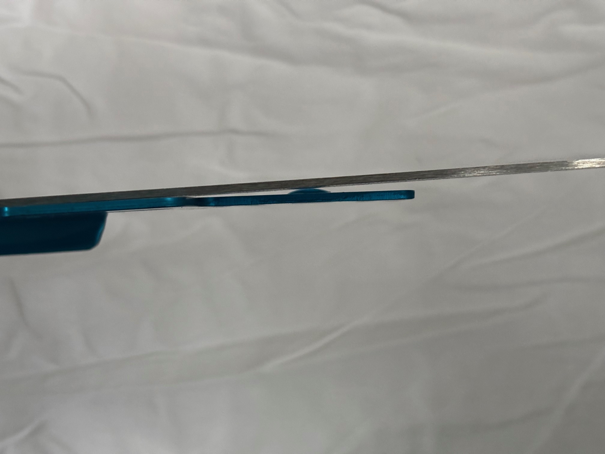

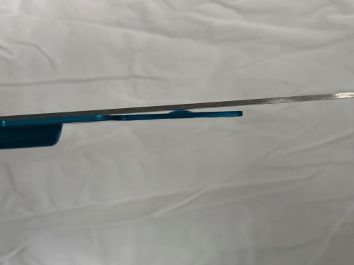

Re: Outlaw Rampage Pro Team - electric conversion rescue
Got a good deal (or so I thought) on a chassis on eBay.
Should I try to straighten this or return it? The bend angle is identical to the protrusion in the tail. I am guessing it got stepped on or something similar.
- RogueIV
- Posts: 1165
- Location: W. Mass
- Has thanked: 2139 times
- Been thanked: 1100 times
if it was me, I'd just unbend it. heck it might even straighten out when you mount the transmission. I'd probably add a brace back there too if one doesn't already exist.
- Dangeruss
- Posts: 1478
- Location: Surf City USA
- Has thanked: 425 times
- Been thanked: 1411 times
Does anyone have one that isn't bent? I swear it was a factory option.
Jokes aside, I think the tweak was intentional so the bulge for the diff gear didn't hang down below the rest of the chassis.
- Posts: 49
- Joined: Wed Apr 16, 2025 5:27 pm
- Location: New Jersey
- Has thanked: 38 times
- Been thanked: 18 times
I’m probably being too picky. However, I do think it is supposed to be straight.
