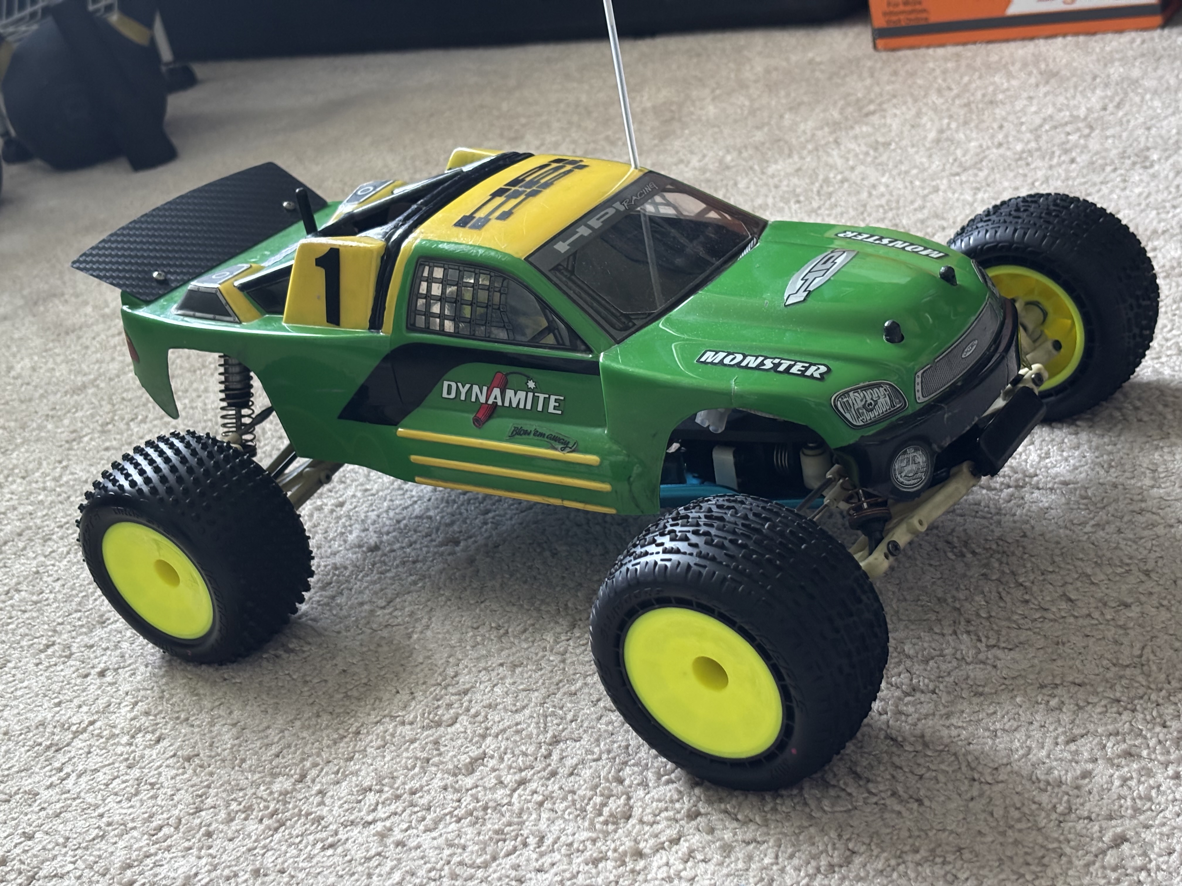

Some updates:
New rear body post
New motor (Holmes Retro Sport 21t)
New gearbox case
New esc and motor decals
New 3D printed battery tray and antenna mount
I have figured out these gearboxes. I will do a separate detailed write up soon.
The decals were printed by a friend on a Cricut.
The battery tray is designed for lipo packs. I have the stl file if anyone wants it.
The previous owner had eliminated the factory torque arm so it had slipped my mind. It is definitely necessary as the tail is very floppy without it. That is the next and hopefully last project other than the body.
New rear body post
New gearbox case

Another small updated. Re-profiled the wing and added numbers to the number plates. I also fixed the rear suspension blocks. The previous owner had them installed backwards. The arm angle was wrong and also caused toe-out. I wonder if this was on purpose?
I also updated my post on the wheels. Based on my research, TLR wheels should have closer to factory offset than the more common Associated wheels.
