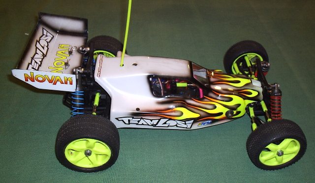

Here's my pride and joy...

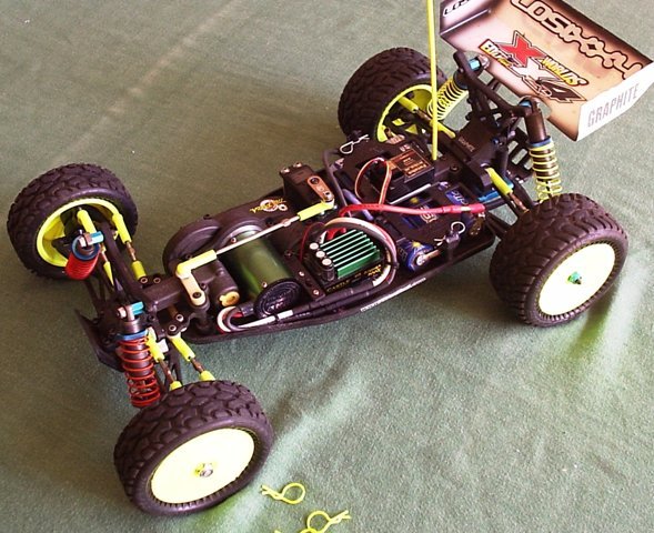

And another...Sure wish I could find a new pair of front 5-spoke wheels-I love 'em.

Nice XX4 Fasterlouder , I was unaware a stick pack can actually fit in there. My local lhs does have a Trinity motor mount left , is this a good upgrade ? My motor does seem to run rather hot.

The Trinity motor clamp is a good upgrade,I don't have one...Yet. :wink:
The Trinity motor mount I do have and since installing it,I've found my motor is definitely running cooler.
I don't have a 'Hot Weather' body,that has a few more air scoops,so it's been a good thing.
If you ever snap or replace a belt,make sure to replace the pulleys,too.
I find after a rebuild,it's a good idea to spend a pack just on getting the clutches set just right,also.
Out of all the cars I own,or have ever owned,my XX-4 is my favorite.
It is my pride and joy and no expense is spared on it-time or money wise.
It loves the brushless system and puts the power to the ground so well.
