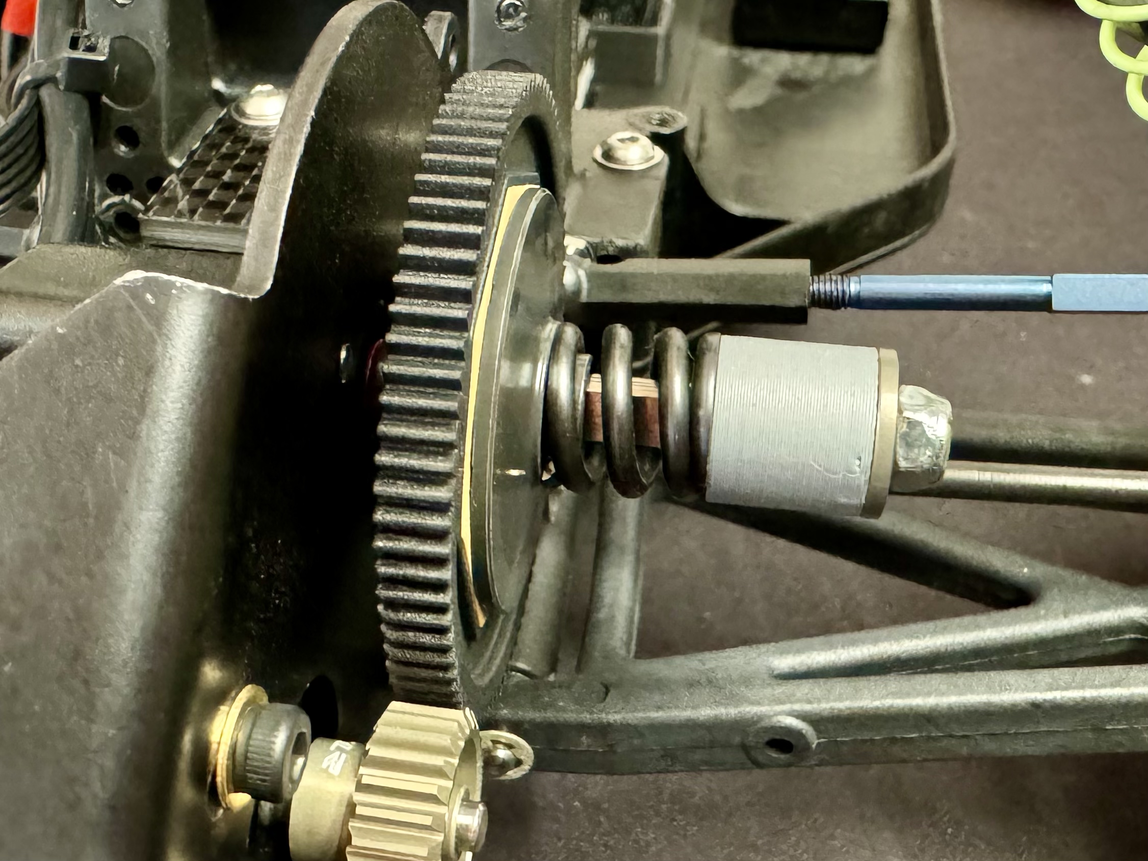

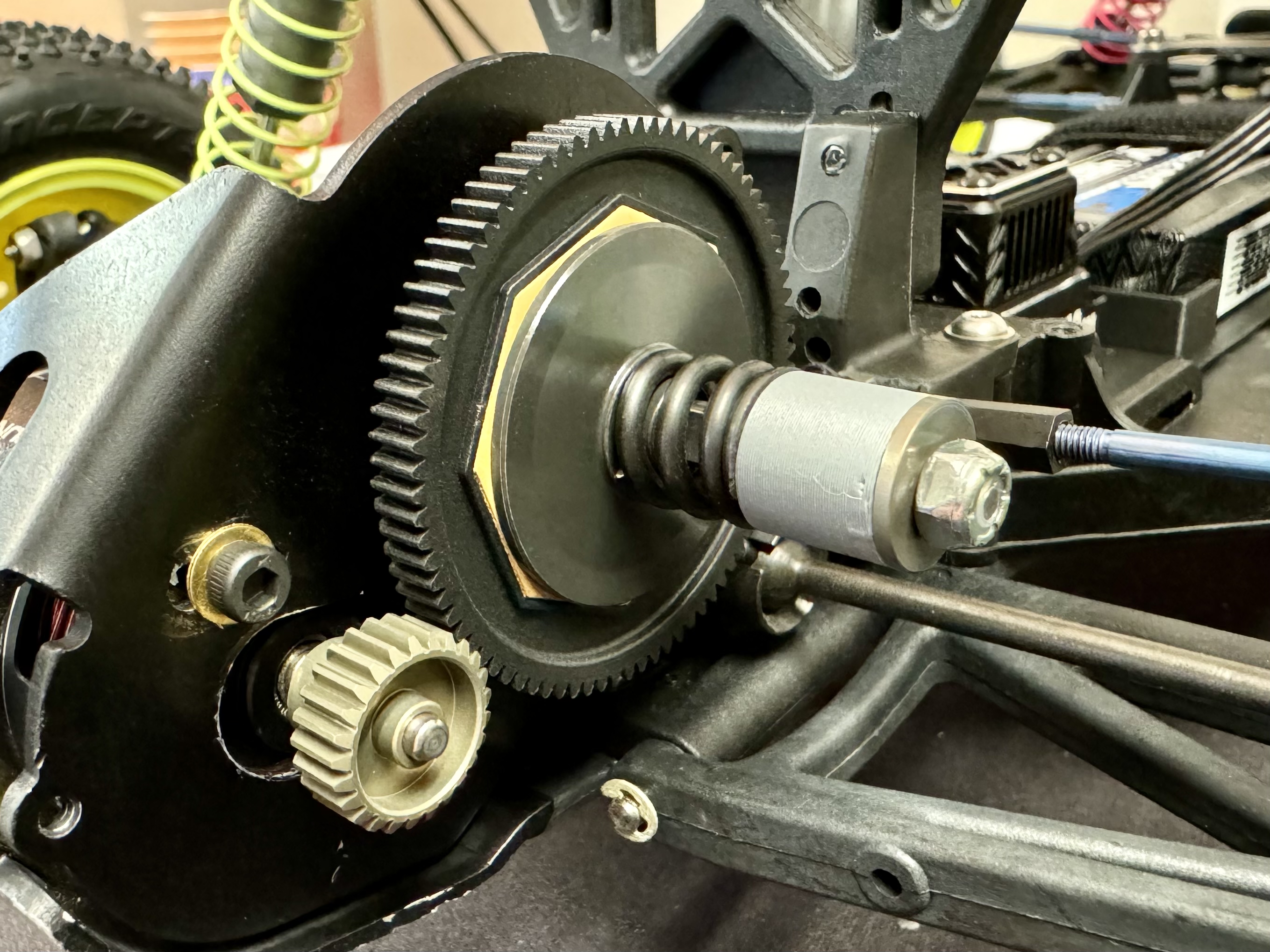

Created a small adapter to allow the Losi 22 5.0 SDSH Slipper (p/n: TLR232085) to work comfortably on the top shaft of XX/XXT transmissions.
The adapter adds 10mm of space between the spring and washer/nut so you can use the full range of compression on the slipper spring without interference or slop in the parts that stack up.
Installation is simple install the slipper plates, pads, spur and spring from the SDSH kit as show in the kits instructions. This part goes between the spring and washer (p/n: TLR232083). The washer will press fit into the conical side of the adapter. Then install the original 4-40 lock nut on the shaft after the washer.
You can download the model to print from the Cults3d project page, https://cults3d.com/:2317927.
