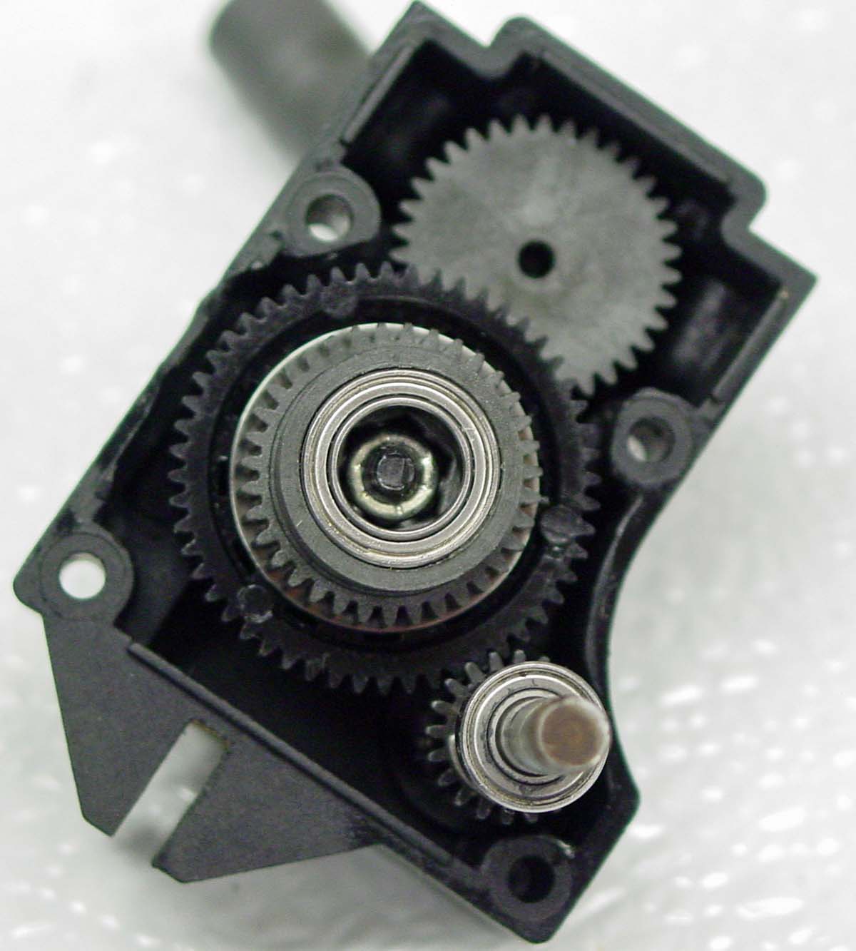

I have a bunch let me know they make 2 different ones, one has a bearing in the center one doesnt which one do you need??

Re: Restored LXT
Oh boy, Now I,m confused.I spoke with a guy named Bill, at Losi a couple year s ago about these parts, & he sent me 3 of those A-3006's, & their not the right ones. Their too thin & a smaller dia. [48teeth] He told me that part way through the production of that truck, they changed the gearbox, and the new one had a gray case. Might these be the gears for that one? .......... Help

This is the gear for the stock 6 gear transmission its the only 2 they made. the LXT used the six gear or the XX retrofit, the Retro fit takes the taller wide gear. does you diff have the outdrives on it or a gear on each side? 3 gears or 6?

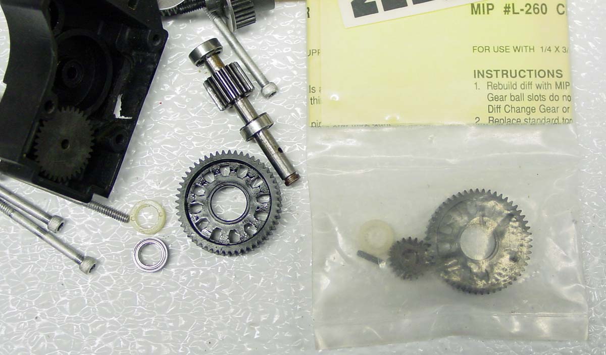

The mip change box comes with a thin plastic spacer to be used with the standard bearing. this will allow you to use any ball bearing style diff gear.
here are a couple pictures of the change box setup, I happen to have one sitting in my parts bin waiting for a home.
Note that #1 says "ball slots do not have stops to keep balls from falling through" I found that out myself before reading the instructions
Luckily I was able to locate all 12 balls to get this back together after the photo.
I opened my nip change kit to scan the instructions. This has the replacement parts list at the bottom.
